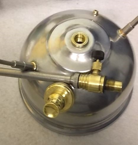

    Hi All,

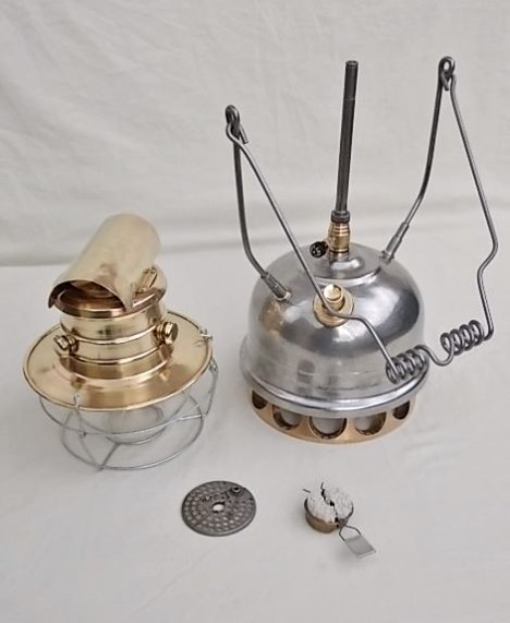

    Unfortunately, I just lost all of an hour of careful photo loading, with my first Tilley PL53 fettle & assy. I loaded 6 good pictures, then the software went ballistic & it all just disappeared on me :-k . Not a pleasant experience, though this fettle was muchly enjoyed.

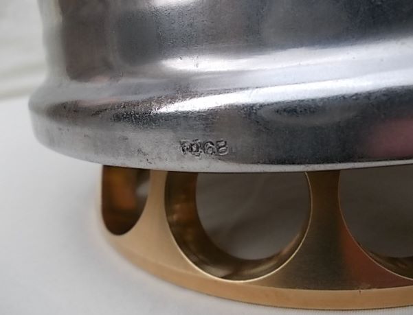

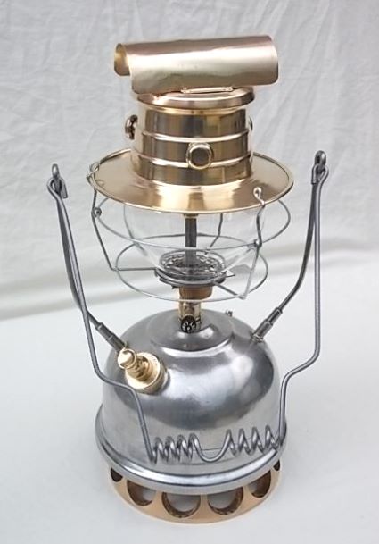

    It's a build, from two Parts PL's I bought from Ebay. The hood/ cowl, came with the second 'buy', & I don't think it's the correct type of top for this 'possible' RAF service lamp. The tank is stamped with some numerals I cannot decipher, so maybe some one could let me know of any dating, from the shot's I'll now load up ?
    The Vaporizer is possibly the wrong size, as the majority of the PL53's I managed to refer from, seem to be equip with the longer seven inch vap ?
    Looking real healthy' now, I still find it difficult to believe, I turned a two parts finds, into such a 'hip & quirky' looking lamp light.
    I hope it's enjoyed, I can't say it's a 'proper or accurate' rendition, but all the work entailed with this re-build, was extremely enjoyable & rewarding.
    I keep putting off the first lighting attempt, though I'll possibly just try this, with a test hood & burner . . . .(don't know when though) ?

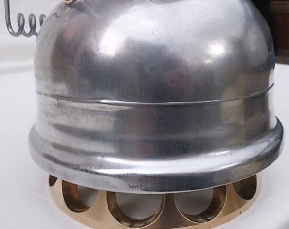

    Then the unusual 'two part' seam weld, to the tank .. . . .
    The tanks on these models are very strong & robust, when I finally got to revealing the steel, behind the dirty grey or blue paint coat, I could then just see how 'special a fettle & polish up', this one would turn out to be.
    Cheers :thumbup: ,
    Jon.

    Well fettled Jon! :thumbup: :clap: :clap: :thumbup:
    It should have the 169 vapouriser and in my opinion the hood is earlier than the lamp, but it's difficult to be certain with the wartime lamps, as Tilley were using whatever they could get and what was in the stores to fill their orders, that was because of shortages caused by the war.
    I may have seen that double rim before and the number is probably a Tilley registration number.
    It's a handsome lamp.

    Well Jeff,
    I was thinking the tank was maybe older than the hood, as quite the majority of those I saw on sites, seemed to be shown sporting the brown/ red enameled hood. Upon saying that, I still have no real idea or theories; but for sure though, the replacements or straight swap overs, affecting a lamp or lanterns durational use (even given the lean War years/ material shortages) still seems just too difficult to fathom or follow (but hey, that was then, this is now, Coooorhh, what a looker . . . again at last) !
    Cheers for info with the Vap's true stats, though the tank's as hard as a butchers dog, it'll be not only marginally safer, fitting a 7" proper, but'll help to make it look 'that bit more taller'; I'll look out for one, I'd prefer the mantle, resting at a more elavated position. :thumbup:

    That number is what remains of the Designs registry number 681681. Dates from around 1923 and was valid for 7 years with an oprion to renew for a further 7 which means it should be stamped on lamps fropm 1923 to 1937 although I suspect it was still on some founts later than that and possibly into the 1940s. ::Neil::

    If I remember correctly the "dirty grey of blue paint" would be RAF colours and the steel tank also points to it being of WWII era when brass supplies were erratic to say the least.

    The info on those 'over stamping numerals', is interesting, & 'yes', that's quite a window of margin to consider (maybe pre-30's, possibly before the out break of WWII & then even maybe into a good part of the 40's).
    To understand those numerals (I can see that they are double stamped, one trailing over another below, ect) & my eyesight isn't so bad yet, they might just signify 'in factory personell' or material roll batch's, but they do seem very untidy & vague, as ID !?

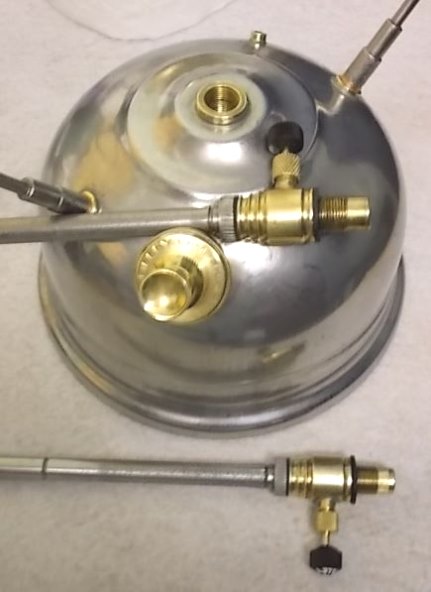

    The outward inclined lower handle rods indicate later variant PL53, Likewise GF control cock was used 1940-62, How deep is socket for control cock ? The steel tank I am led to believe was later WW2 40 - 45+ when brass was in short supply.
    The ridge around tank I think was a result of the lead/solder coating of tank running as base was soldered into the tank. G..P

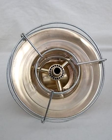

    I took some shots of the lamp again, showing the two control cocks. The one on the tank, belongs the PL53 we're on about, the other on the matt, is for another build, I'm yet to start, as I'm knee deep in US lanterns ATM :) .
    The only difference between the two, as far as I can see, is the small filter dish plug, showing its more of a knurled circumference, than the one resting lower down (this one's all smooth, possibly a newer design). You will have enough info there, to see its dating, but for sure, the highest stop cock pictured here, is the one that arrived with that tank.
    It's looking like it's as you say (& Neil also), particularly given the lower handle rods style, as indication to it being made, Post 1940. Measuring the sockets depth, the way I arrived home, was a non-starter but good estimation can be deduced here, it appears to be the same depth as the X246A's apparatus ?
    Here's the pic's, with a few extra's :-

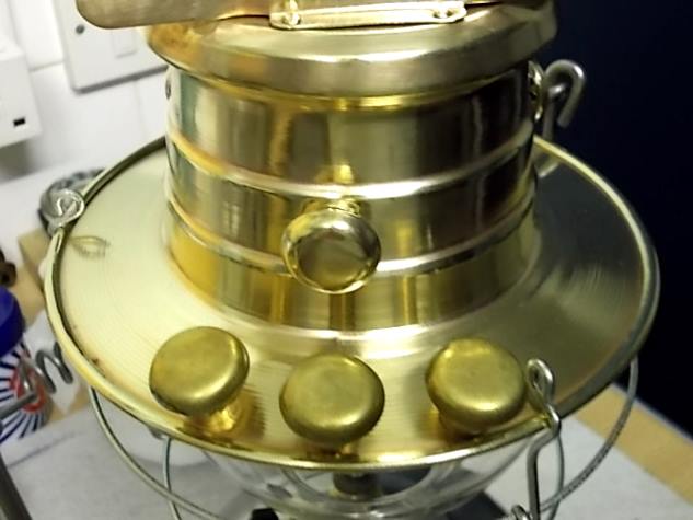

    :-s "More busy bee work", with the new arrivals . . . .

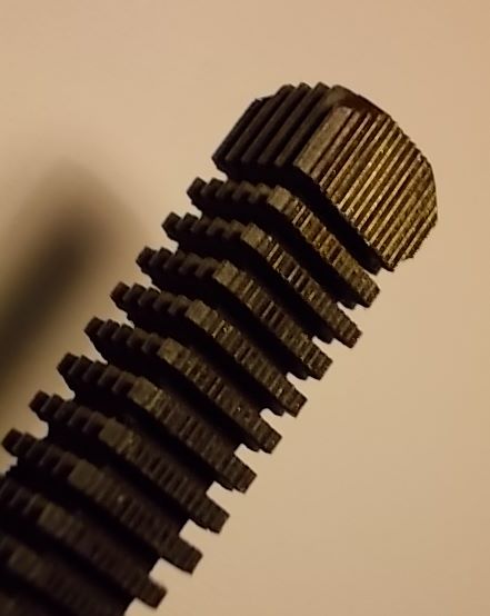

    Then one into the burner. It can't be seen hardly, but you'd have had a fit, doing what was essential, to get it all threading back together again. I separated it all, by many workings, failures, then lengthy repeat soakings, in old motor oil.
    I got the males grooving again, with the tool in the last shot, an excellent hand, it proved to be :idea: .
    "The Stone Slide Key, to an Egyptian Pharaohs Tomb, Wor Danial san" :lol:
    Cheers then,
    Jon :thumbup: .

    Yes, 'thread files' are a very handy tool indeed :thumbup:

    Yes, those thread files are very artistic looking, its a shame they don't chime out "Walk Like An Egyptian", whilst getting into the grooves !
    I can hummers like see what's going on though (during the gyrations & all) it's more of a 'feels like it's there', than anything else. The real old air tubes I uncovered, looked like ticker tape; so when they were newly cut, it's a good bet this was occurring, over the skies of Europe.
    Link : "Public Service Broadcasting - Spitfire"
    Most enjoyable !
    The one I'd borrowed for use, was a metric sizer, but it saved me a few steak joints I could eat again :lol: .
