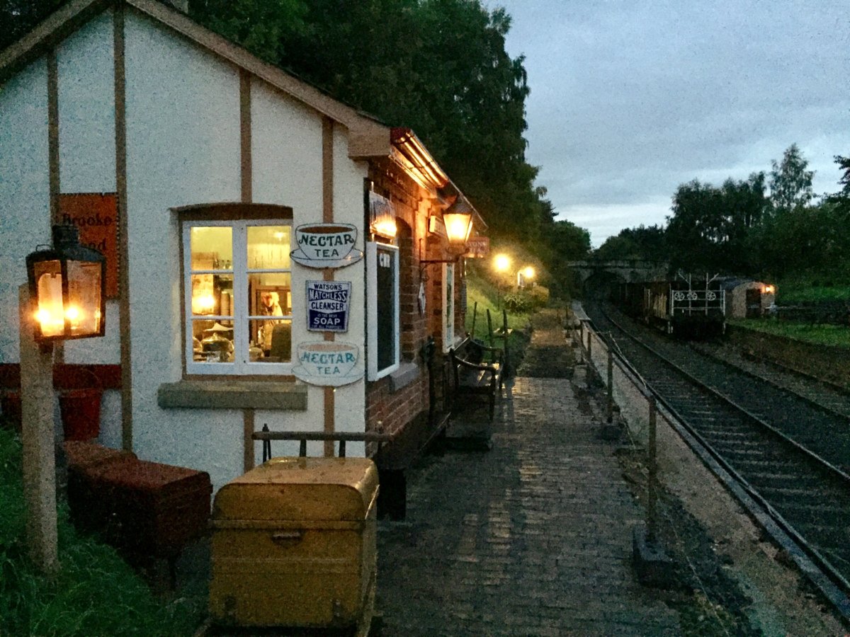

    Thank you, Alex. Indeed, old railway stations can be highly atmospheric. The one at which I volunteer has no electricity supply and is lit entirely by the oil lamps that I look after. It is miles from anywhere out in the Shropshire countryside on the Severn Valley Railway, and pitch black at night. It is amazing how much light a simple 5CP wick lamp emits in pitch darkness.

    that is such a magical photo. Timewarp! I am in Faringdon Oxon, and visited stoksely castle in June this year. Which station is it, and can I come over one evening to take photos? Fantastic. Thanks.

    @Phil Harris A great photo Phil! Many years ago I lived near the Worth Valley line with it’s very atmospheric gas lit stations.....

    Hi Alex and Stevie,
    It’s Eardington Halt, near Bridgnorth, and (sadly) it’s only open to visitors twice a year during Steam Gala special events. Dusk and night-time photos aren’t easy to take - that one was taken on an iPhone 6. A proper photographer with a decent camera could do much better I’m sure!
    If you drop me a Private Message, I can give you more details.
    Phil

    A splendid photograph!:thumbup:

    Thanks, Jeff! That image actually got printed in Heritage Railway magazine a while ago. I need to take a new one because we have rebuilt and widened the platform since then. Incidentally, the waiting rooms are lit by a Tilley KL80, a TL136 and a WL25, and there are two X246 Guardsman lanterns on the platform. All the other lamps in the picture are, to sanitise Neil McRae’s description, “wicky rubbish”...!
    I find there’s a very short time window around dusk when it’s possible to get reasonable shots. The problem with smartphone cameras is the auto iris, which tends to make the scene look brighter than it really is and results in a grainy image. Take the photo ten minutes later and all you see are out-of-focus pinpricks of light in a black background.
    As I said, a proper photographer could do much better. The next opportunity will be the Spring Steam Gala in April 2020.
    Phil
