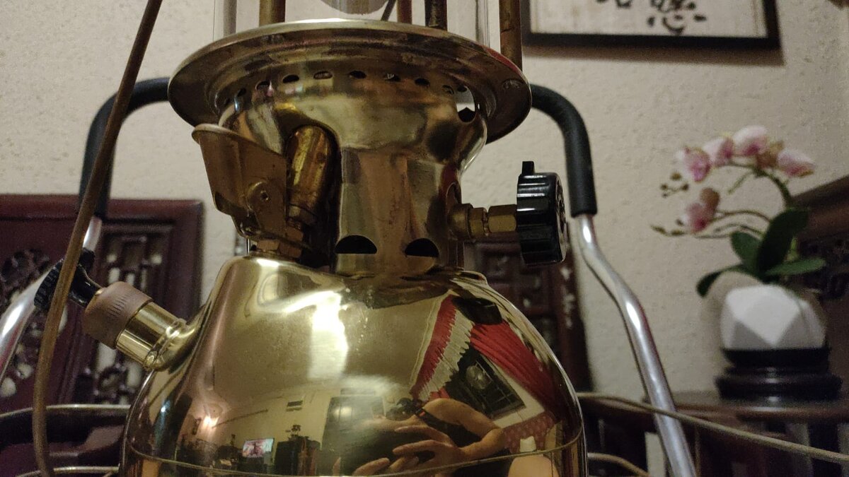

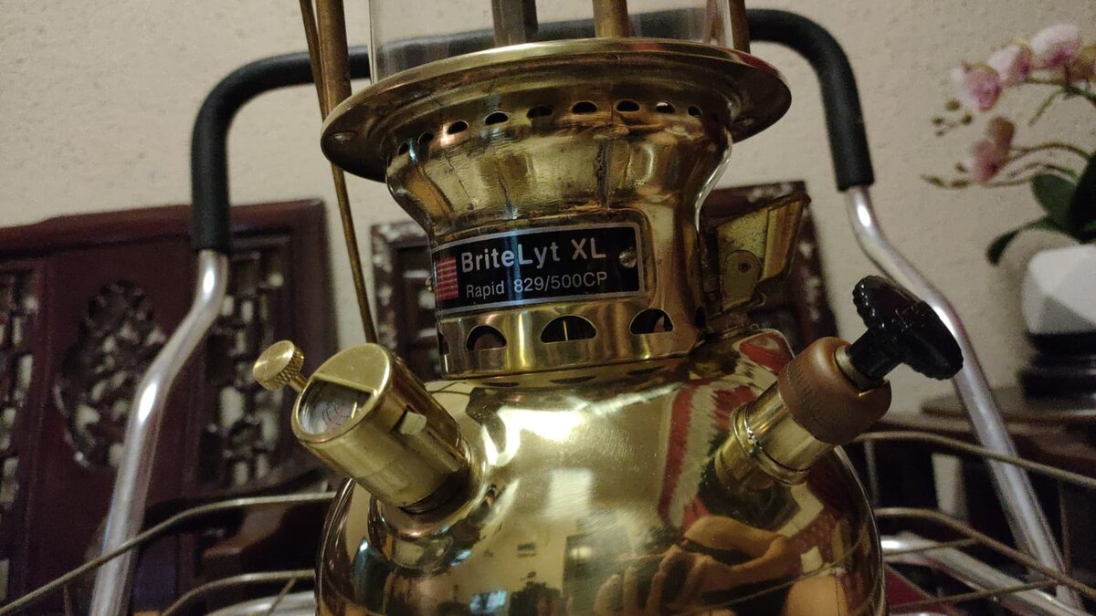

    I go around the house every few months to check on my lamps (I don't own that many anyways). Well, just to check on them to see if they're still alive and they haven't catch the flu bug. Also, due to this trying period, the pressure lamps don't get to see the outdoors like they used to. i've been lighting up the Aladdins and Gaudards.
    Back to the Petromax(s)... they caught some kind of a disease..

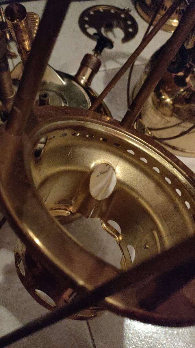

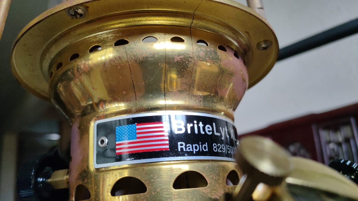

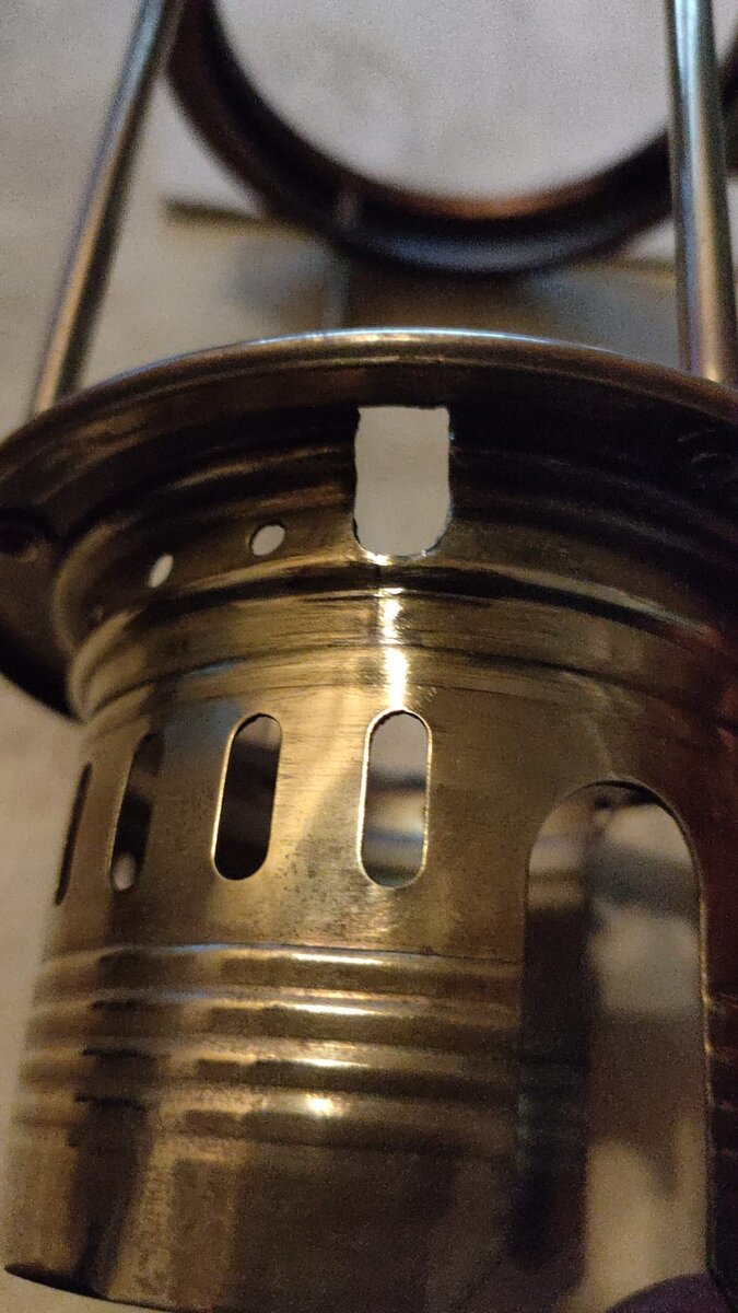

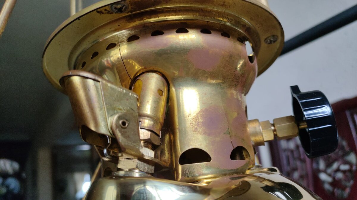

    its worse on this other one
    I've contacted Pmax USA, seems like they're out of biz? No stock for a very long time. This XL version does not take the current Pmax frame collars. its slightly larger and of a thicker gauge.

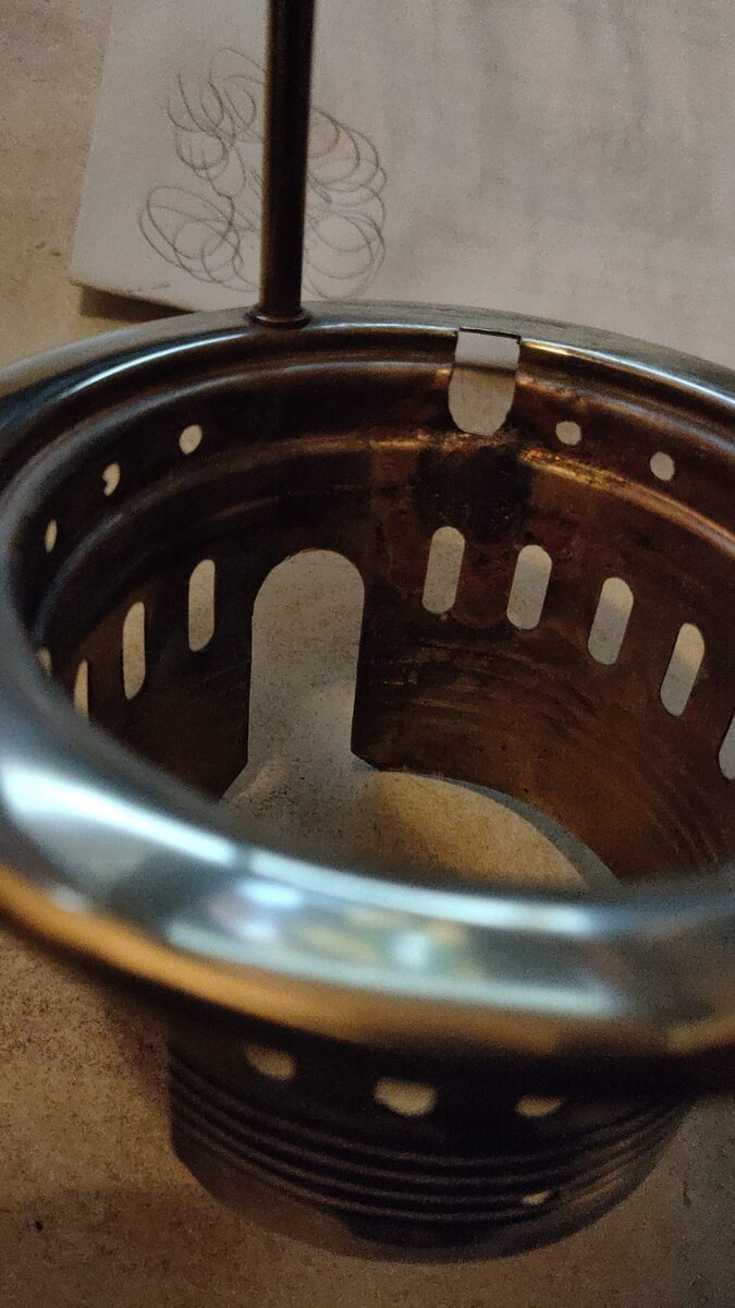

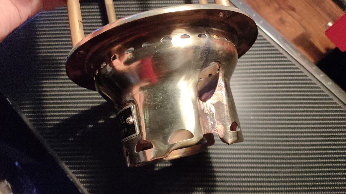

    I gave this a thought, well heck, its broken anyway. Just go on and fix it while waiting who knows how long.
    I guess the area above the badge needs more work

    Funny old stuff, Brass...Stress relieving such as Annealing can alleviate a lot of it, but apparently it can re-occur ..
    Can also be caused by different gases acting upon it (not sure about liquids), but different alloys may cope better?

    The red marks are fingerprints...
    The oil in our skin, when transferred onto certain objects, can over time oxidise the surface.
    In the Spring and Autumn, when the air is heating up and cooling down, you will find that metal objects will condensate...(things like machinery, and Anvils will 'Sweat'...water pours off them)
    A lamp or lantern (especially one with fuel in) can't heat up as quickly so if you had sweaty hands when you last picked up your polished pride and joy, you might find this happening?
    That's why the Museums don't like you touching stuff as your fingerprints can accelerate the aging of things..even furniture and stone/sculpture/carvings...
    As for whether it has helped stress the brass I couldn't say...

  16. ROBBO55
    1,897
    @isfuzzy
    You have done a nice job of fixing the cracks in the collar. :thumbup:

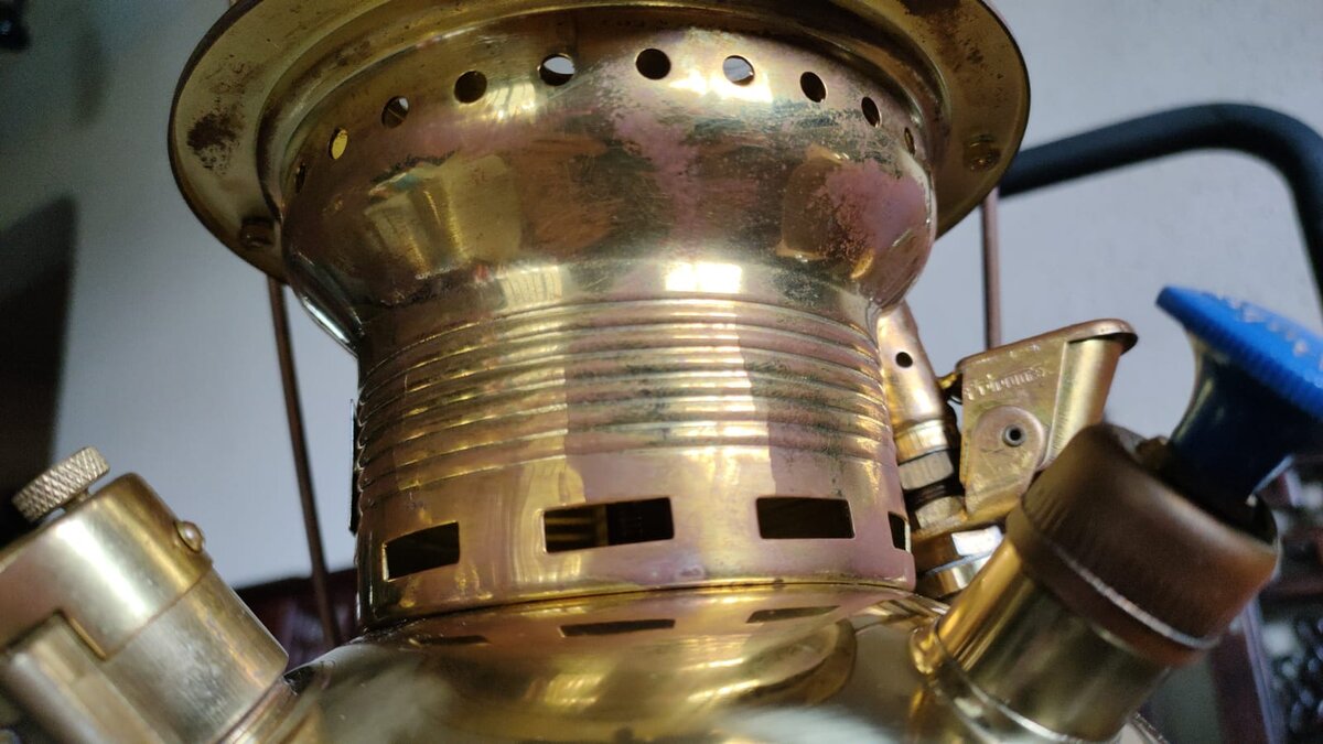

    Well, stress cracks can happen on any metal alloy. Some fare better than others. Which is why some process chambers are still made of carbon steel and not stainless or other non-ferrous.
    I'm rather intrigued with the 2 lamps. To date, I own 3 Pmax lamps, plus I sold 2 in the past and another 2 Asian steel body (Butterfly, Sea Anchor).. This is the first time I see young lamps with such a crack virus. The only lamp part I had a crack was on a Korean made stainless Vapalux shade, there was a small slit just before the folded edge.
    I was paranoid that day I found those cracks, I went around the house to see all the other brass lamps. Especially the Santrax 150CP... One crack her too...
    I don't have condensate issue here in Singapore but the humidity is high, roughly 70%.. However, that didn't affect the x300 Bialaddins, E41 Vapalux, 23 Maxbrite Aladdins and Gaudards I have sitting on the shelves. The 2 sick Pmaxs were kept in their Pmax wooden boxes. If that caused the cracks, the tank and the hood would have suffered too.
    What I realized when fettling with my 150CP Santrax was that the frame collar, no doubt made of brass, behaves more like a clock spring. I resists any form of bending from bare hands, so much just for very thin gauge extruded/pressed brass.
    I chose to braze the Britelyt collar rather than to use plumber solder because braze joints can hold up more forces when compared to solder. There were serious cracks on that thing such that they allow light to pass through them. Solder could seal but will creep with constant tensile forces between the crack surfaces.

    Hi @Nils Stephenson, i did polish off the hoods and reflectors of Britelyt and Pmax. nowhere else. As for the 150cp, yes polish the hood and frame.

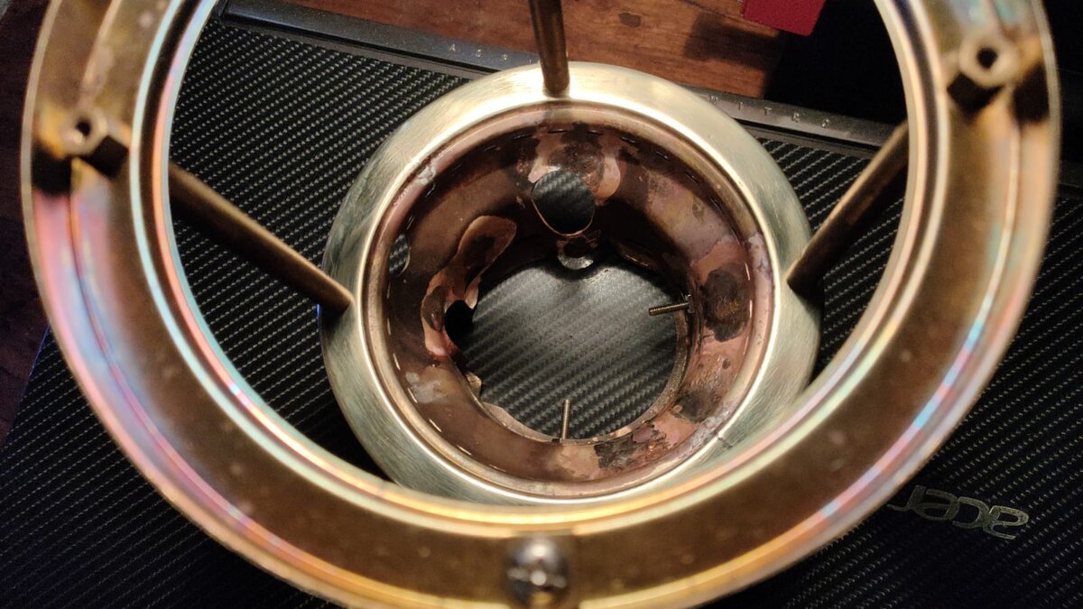

    Anyways I brazed over lunchtime
  20. phaedrus42
    phaedrus42 Subscriber
    1,949
    Very neat brazing! And hopefully the heat will have annealed the surrounding brass to prevent further cracking.

    I think for the Pmax 500 frame, I would heat the part for some time to hopefully anneal it first. Shape the cracks to meet each other getting the proper angle and then only braze. It is very tricky to braze round cracks especially when the metal still has got the springiness in it :roll:
    What I hate so much about the bronze rod is that it turns to a whitish silvery color when done.. Similar to the new out from the box vaporizer joints.. Now the frames looks like reversed Kintsugi artwork (Japanese method art for repairing earthenware)

    Nice brazing there @isfuzzy ,
    A lot of alloy brazing rods would melt and give a lighter or silvery appearance instead of yellow-brassy colour. The shade would depend on the specific alloys, with differing amounts of copper, zinc, cadmium in some cases and of course, silver.
    Some would turn dark or even blackish (purely phosphorus-bronze without any silver) after some use, particularly if its used to braze a leaky vaporizer. These don't last very long on highly heated parts. Others are brighter and might even be a little 'pinkish' after awhile, depending on the copper and silver contents.
    What brazing alloy did you use on that?
    Sometimes the lantern collars had 'work-hardened' too much after stamping or forming on the production rollers. These are usually highly stressed and 'springy'. They might have skipped the annealing step before it goes into the plating bath. Annealing is an energy-intensive step in addition of being time-consuming. Skipping that would significantly reduce production costs. I won't be surprised if that's the case.
    Yes, ammonia or ammoniated chemicals do cause the brass to develop stress cracks later on. It might seemed to have been thoroughly washed-off but ammonia has a peculiar property in that it slowly and gradually penetrates into the brass below the surface, attacking mainly the zinc, leaving the copper behind. That'll create some porosity in the brass, and eventually heightening its chances of developing stress cracks as time passes by.
