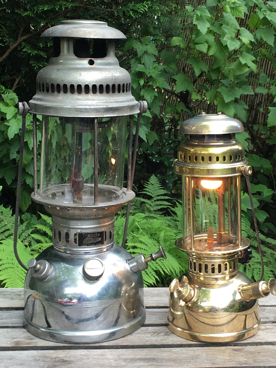

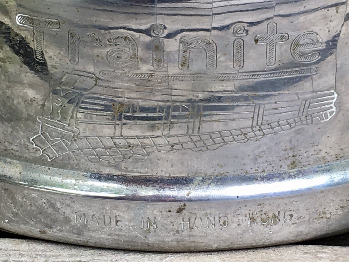

    One of the lanterns is the Trainite (Hong Kong) on the left in this photo.

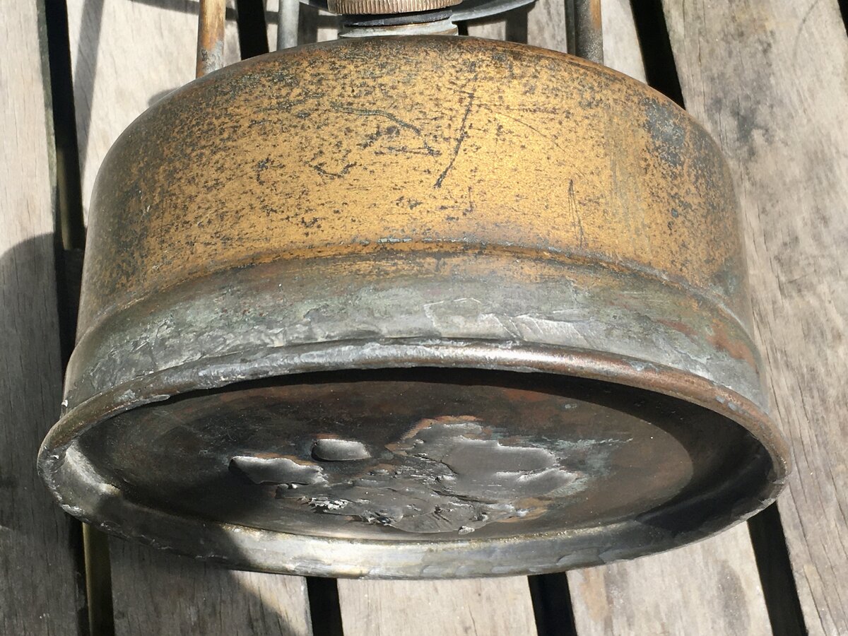

    The other lantern is THIS Tilley 246 on which the brass of the font base had become porous due to galvanic corrosion at some point in its life.
    Not stress cracks therefore and soldered repairs have kept it fuel tight under pressure so far but the POR15 treatment is to provide additional security against the potential for further leaks in future.
    My main project though is a British New Governor camp stove which as a very rare item justifies the POR15 expense. The lanterns are a bonus.

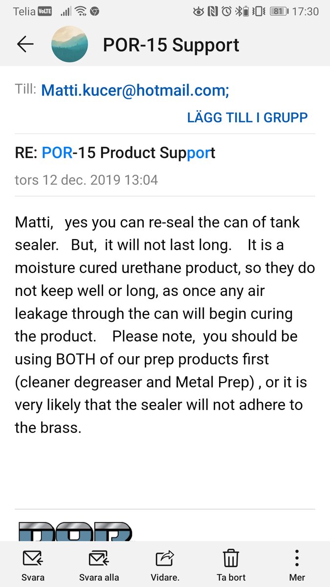

    I contacted the manufacturer some time ago, the answer for POR-15 was:

    It'll be better if the entire tin be completely used up once opened. But,..that is not always practical.
    The key is to keep the moisture out from the start by not opening the lid at all. What @Tony Press did and suggested was quite right on this respect.
    Because once the tin is opened, solvents would start to evaporate while moisture would set in immediately, especially if evaporation cools the contents further and augments condensation. Adding a little naphtha might retard this somewhat but too much it could be detrimental to the product properties.
    Since the product already has the cross-linking agent blended-in, just a small amount of surface moisture would trigger off or catalyzes a chain reaction throughout the entire pack and gel-up the contents eventually.(even after if you re-seal the lid after opening).
