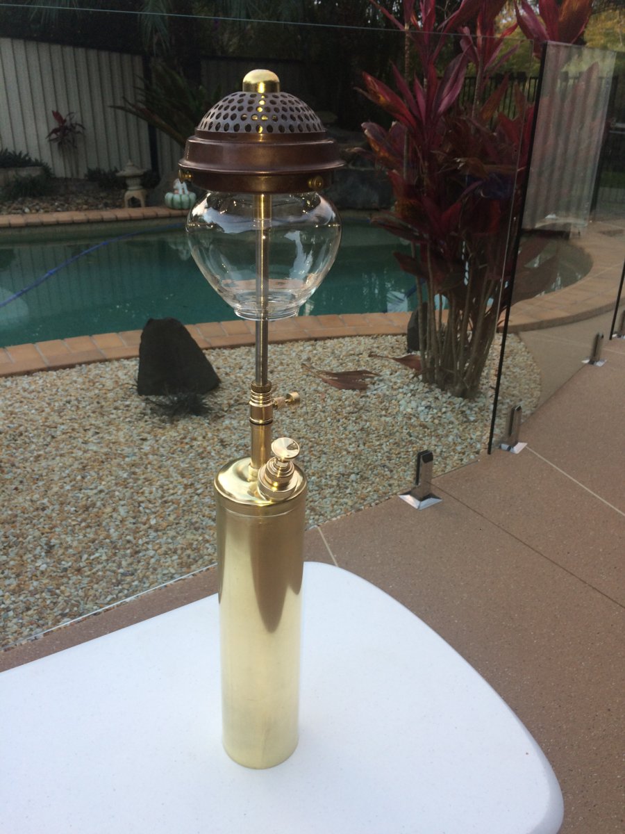

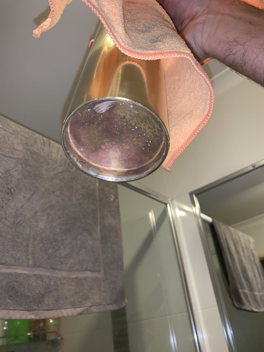

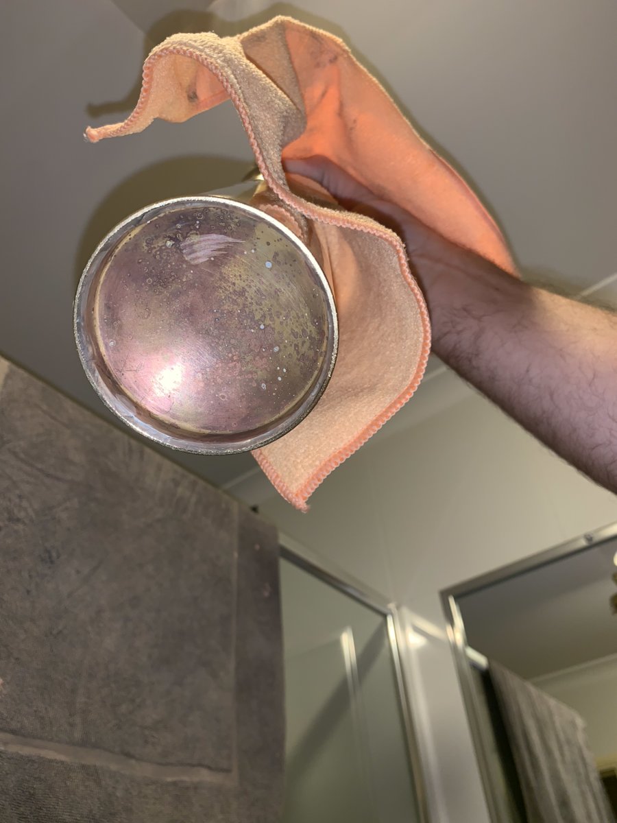

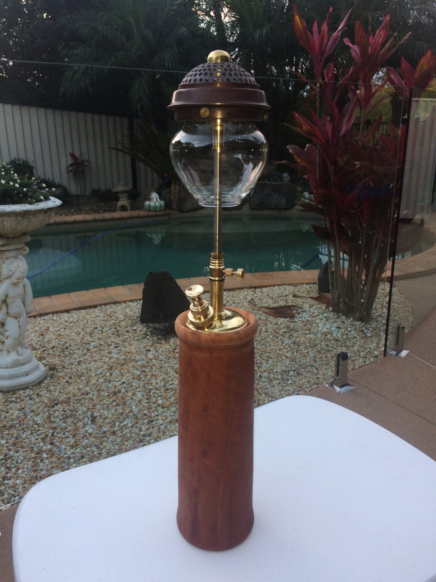

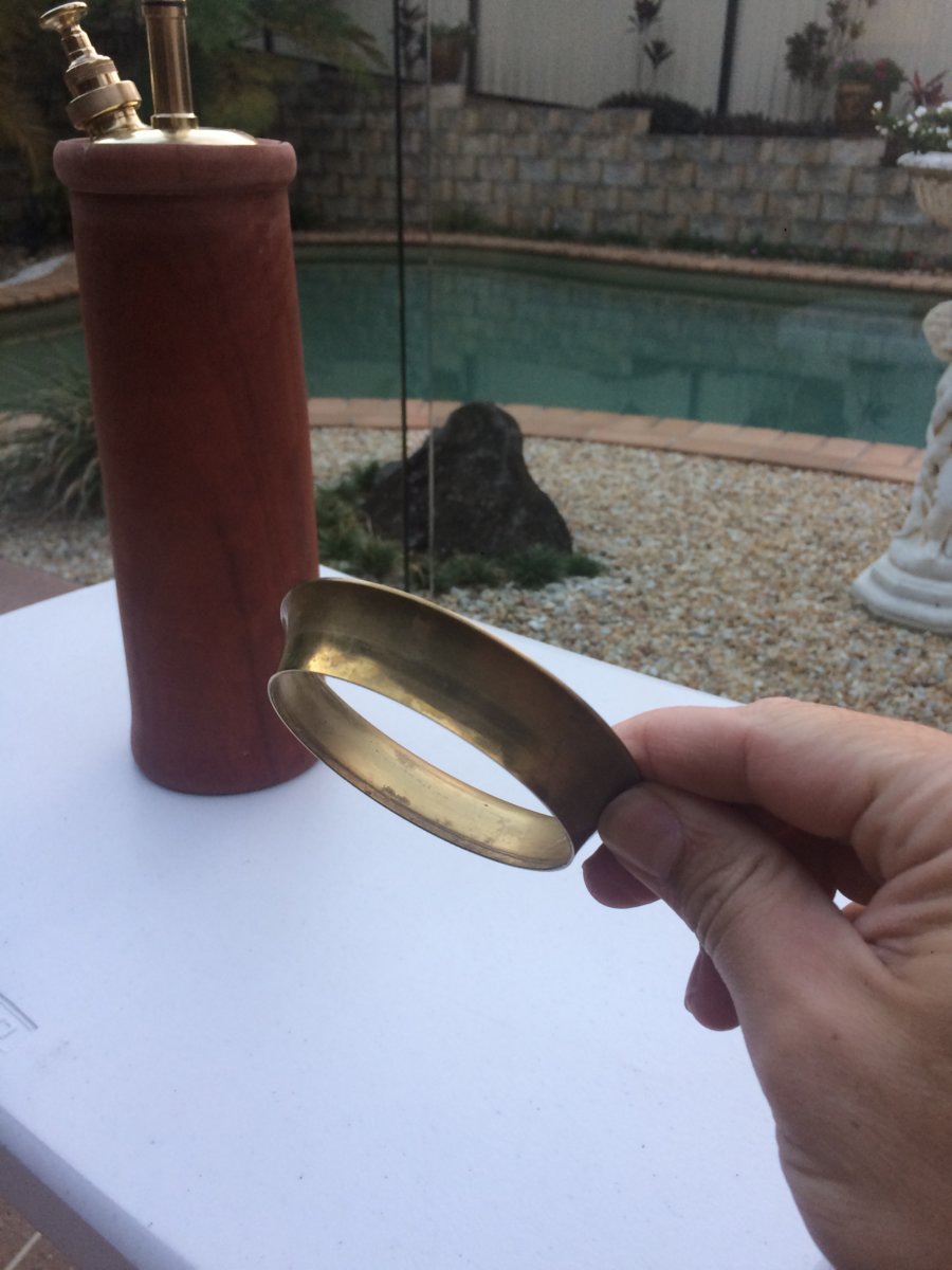

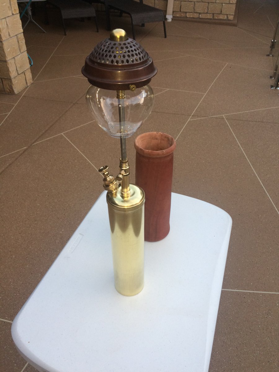

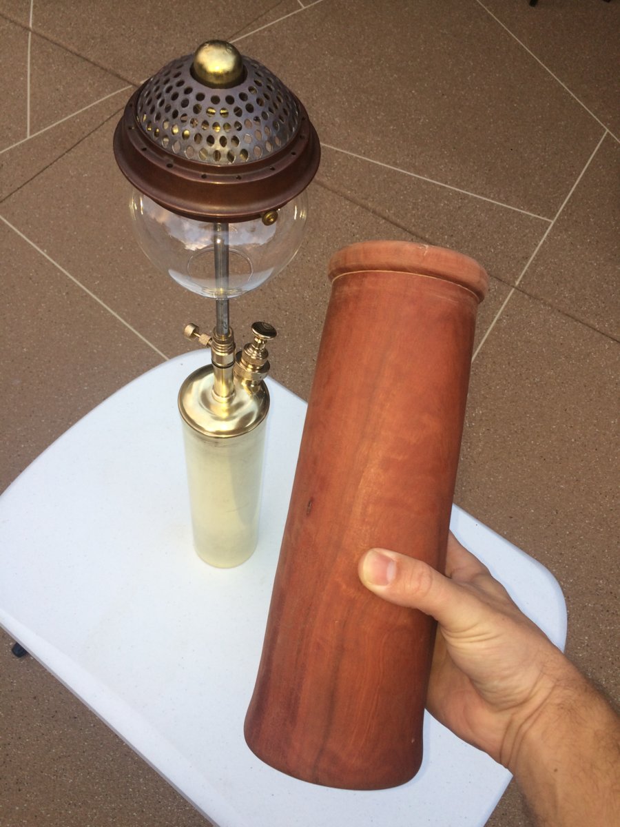

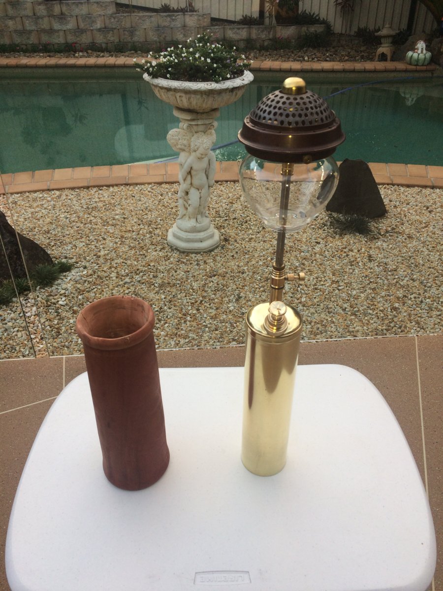

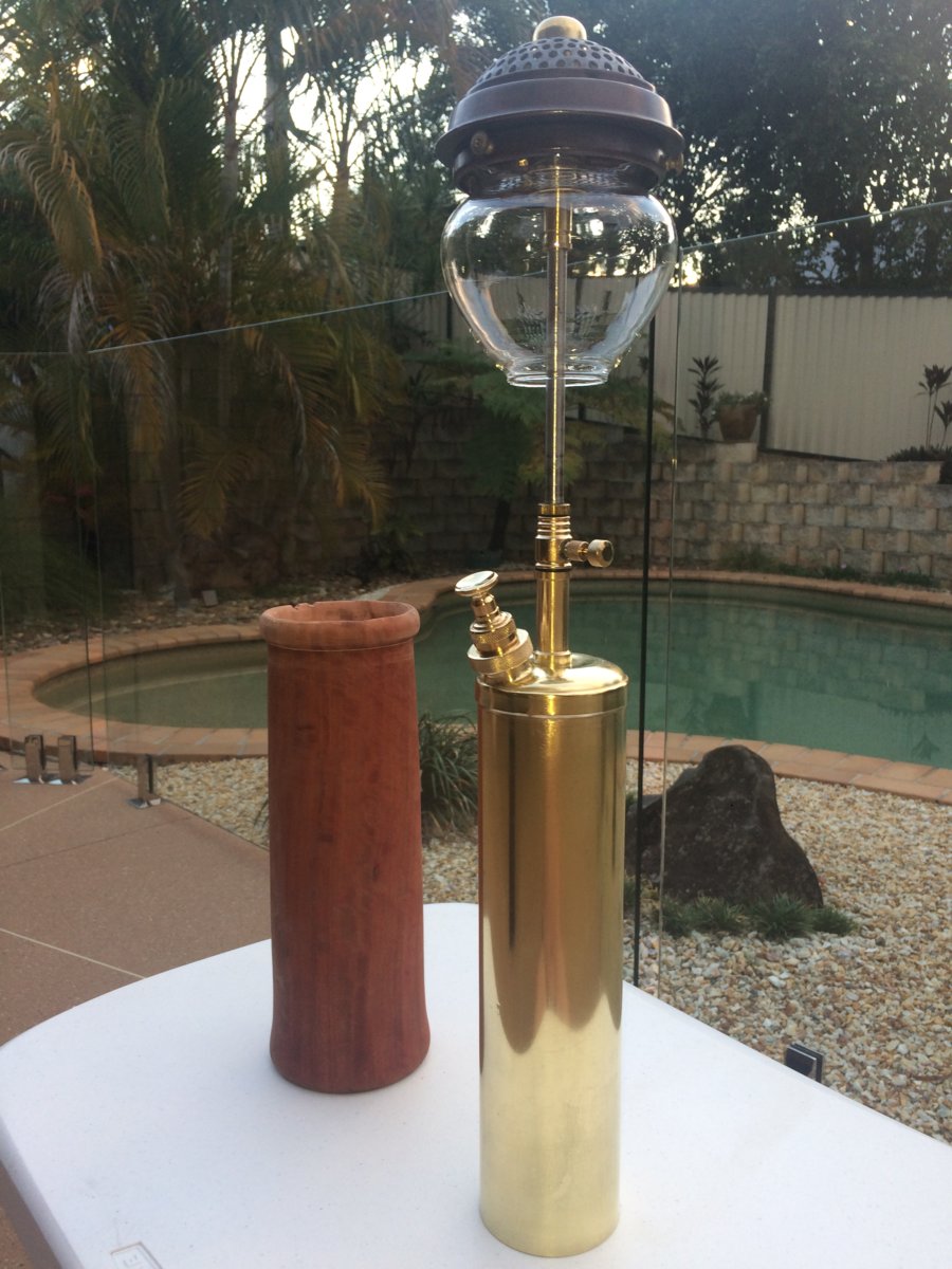

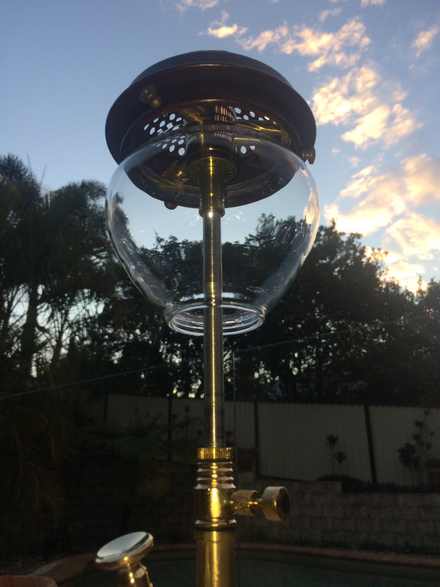

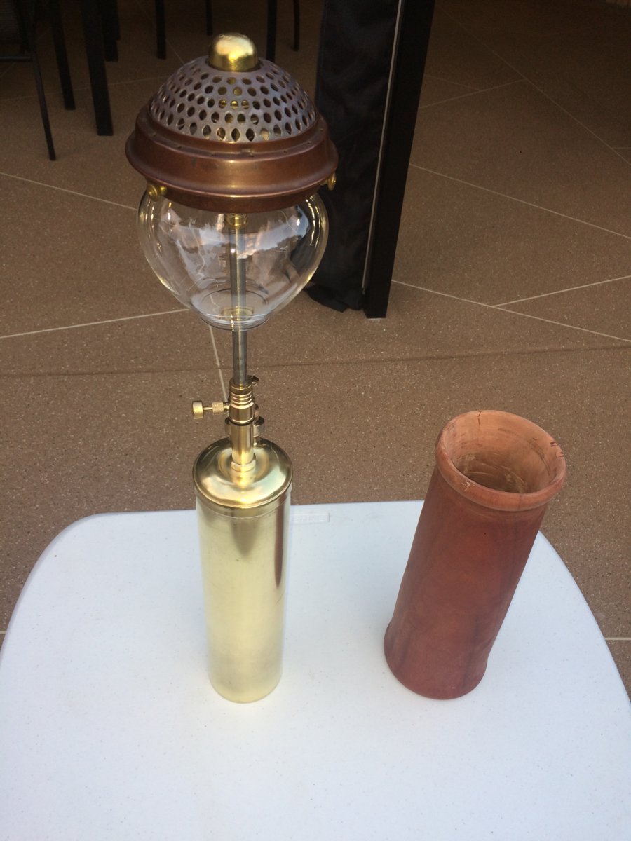

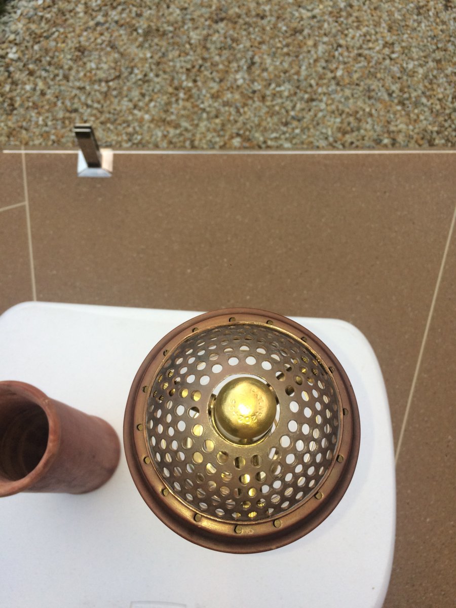

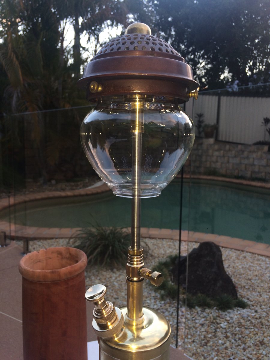

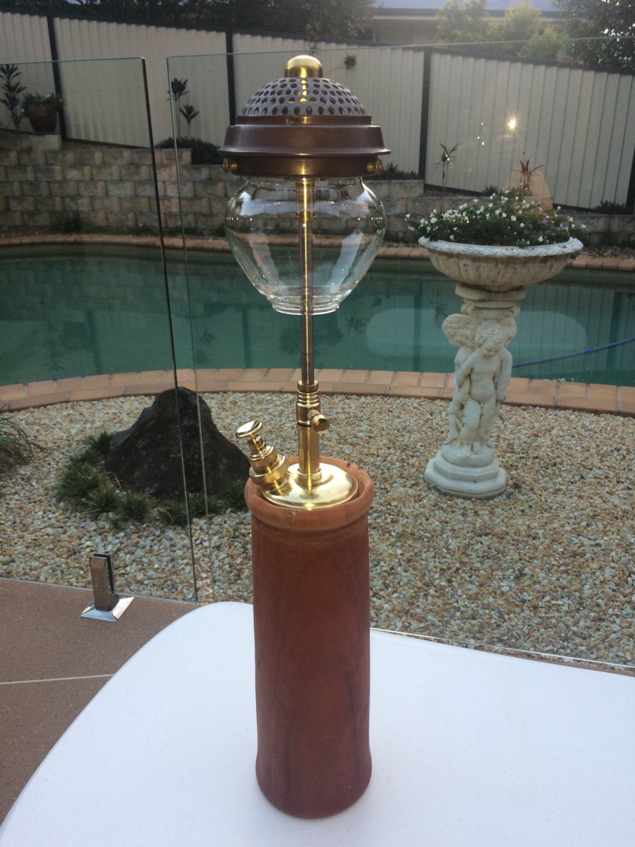

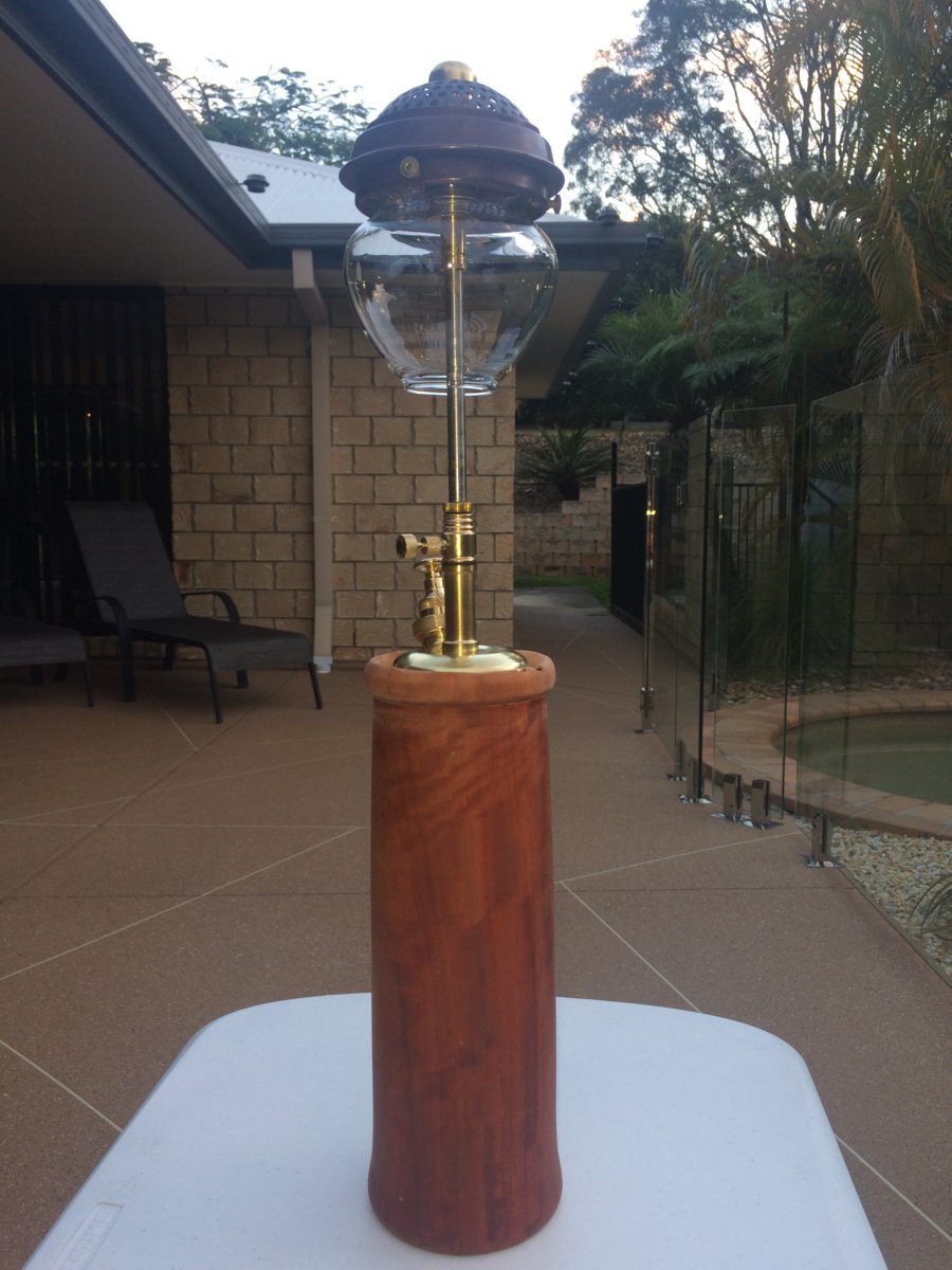

    I thought this was a VL1 but was wrong, its an Even Rarer Vase Lamp called a Kayen, very little is known about these Scarce Vase Lamps. (Apparently Jim Dick was one of the few to have owned one)
    HISTORY: This Very Rare Kayen Vase Lamp was brought from Jim Dicks Private Collection. These lamps are an Aussie copy of the Tilley VL1, this one was possible made in the NETTLEFOLD factory in Melbourne, who was working in collaboration with KOPSEN in Sydney, to produce Tilley copies when they could not be imported from England due to WW2.
    The tank is in nice condition and has been well looked after, i have fitted new seals along with a new old stock genuine 169 Tilley vaporiser.

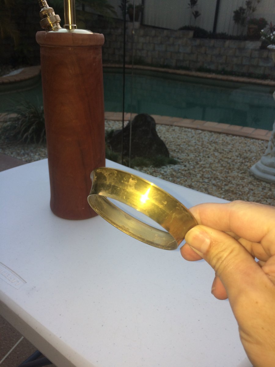

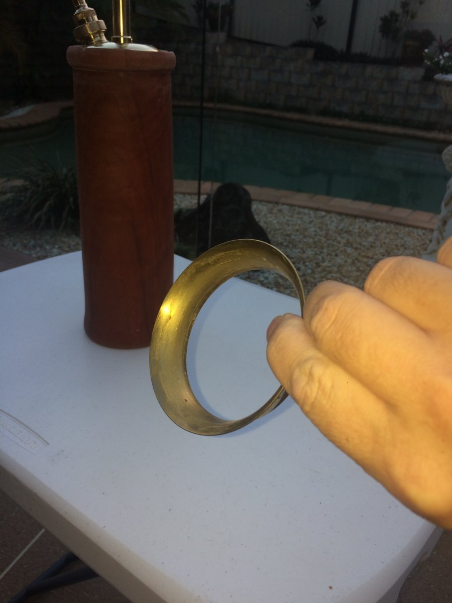

    The lamp also comes with the original brass insert for a vase. Also the lamp comes with a beautiful hand made vase thats not original, made from Australian wood.

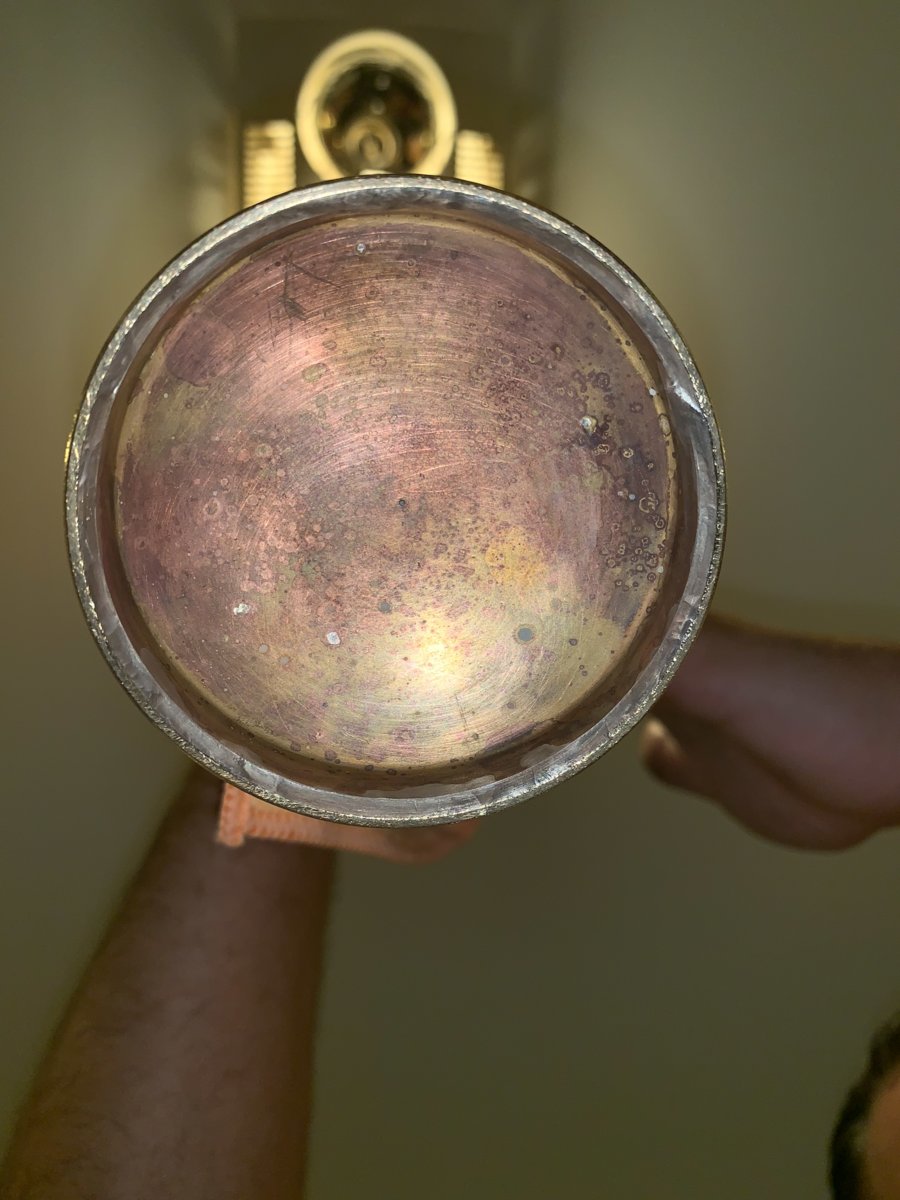

    Its the only Kayen Vase Lamp that copied the VL1 that i have ever seen, also NOT many lantern collectors have seen these to date, even the bottom is different to the VL1, and NO its not a Kite Lamp or knock off.
    I’ve had few experts look into this before posting, open to others thoughts. Note this lamp has no pressure nipple.
    What makes this Kayen different from the VL1 tank is that both Tilley Pumps & Kayen fit.

    That's a lovely looking lamp. I have never seen a vase lamp before
    I wonder why they made the tanks so tall I would have thought it would be a bit unstable. But all that aside, its a very elegant piece.

    So does anyone know what the original Kayen vase was made of, is there anything in print? The tank looks in every way like the Tilley VL one. Are there any old adverts showing this lamp?

    Well we can certainly agree it is not Tilley but having discussed this with a couple of guys I am not convinced it is Kayen either. Several of us knew Jim pretty well when he was actively researching Tilley and he never mentioned this to anyone that I am aware of. That alone rings alarm bells because if Jim had thought it was correct he would surely have told us. We have price lists for Kayen from 1946 to 1951 and there is no mention of a vase lamp and if they sold one it would have to be there. It is always possible I am wrong of course, it won't be the first time that's happened but right now I believe this is a reproduction vase lamp tank and never a production lamp. It is perhaps possible it was a prototype and never made because of the cost and decling sales of table lamps in general but I believe it more likely to be an amateur build.
    Still an awesome lamp to have though.

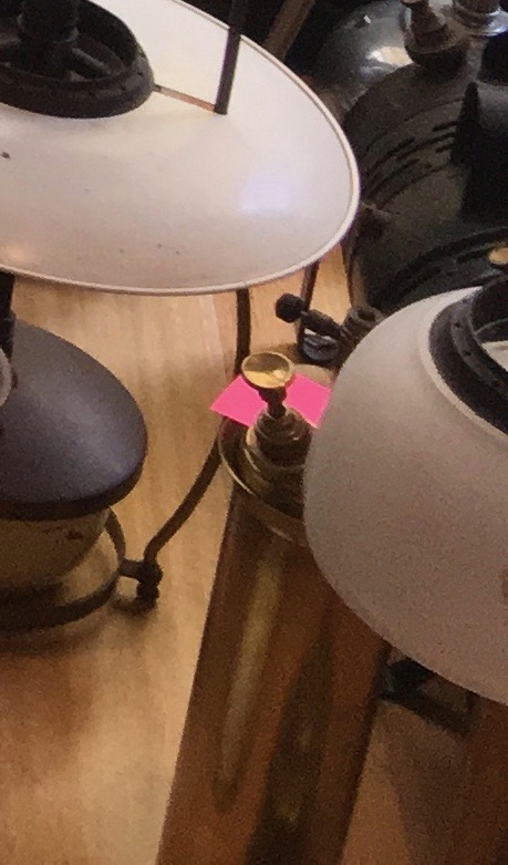

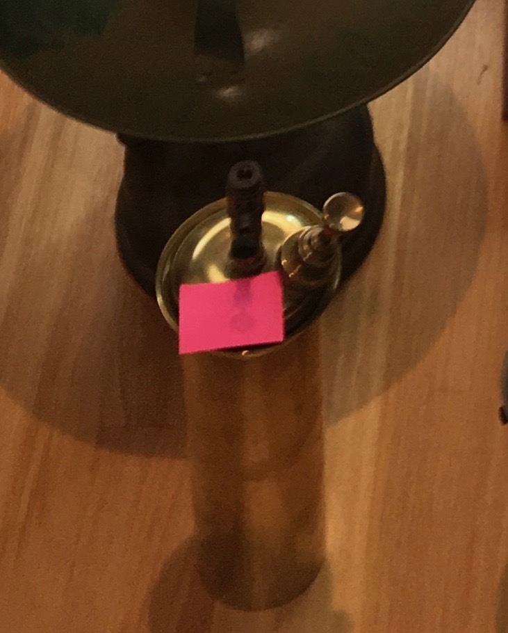

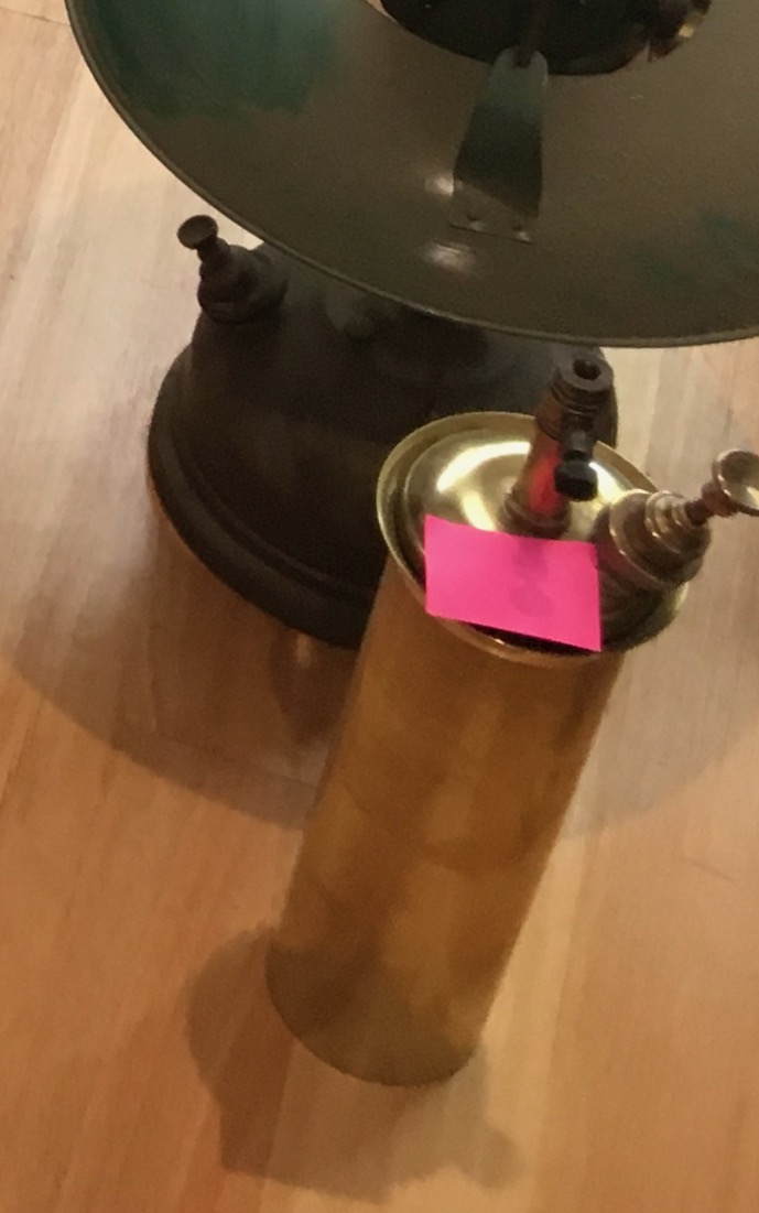

    I saw this tank on 2 March 2019, before it was sold (photo below).
    I am not convinced it is a Kayen, nor a Kayen prototype.
    My reasons for this are:
    1. As per what Neil (@Mackburner ) said above.
    2. There are parts on the lamp are post 2 March 2019.
    3. There is no paperwork I've seen, and paperwork that @Anthony has posted in the Reference Library, that identifies a vase lamp.
    Jim's extensive collection had in it many reproduction parts, such as Kayen/Tilley hoods, and well engineered accessories such as vapouriser extenders, cage extenders, and heater mantles and other well-made brass fittings. I know positively that at least a fair proportion of these were made in Australia. (I am in possession of some of these, and will get around to posting sooner or later).
    The photos below are of relatively poor quality as they are cut from photos of a wider perspective, and not portraits of the VL.

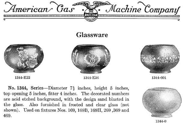

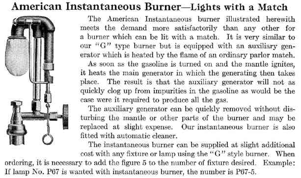

    The Victory lamp is a bracket type and used an AGM burner and globe. So we know exactly what they were fitted with. The burner is the AGM Instantaneous and the globe is AGM part 1344.. ::Neil::

    I am not trying to prove it’s not a Kayen. The absence of proof is not the proof of absence. In other words, I can’t prove it’s not Kayen - and at this stage no one can. If it turns out that it was made for Nettlefold or Kopsen, I’d be as pleased as Punch.
    I can only point out those things that make me think it is premature to say it is a Kayen, or to infer it is likely to be a Kayen.
    1. The lantern, when I saw it on 2 March 2019, was as seen in my photos above. Many other fine lamps of Jim’s were complete and obviously had been proudly presented and displayed. This one was not.
    2. I won’t repeat what I and others have said above, except to say that those who worked with Jim in his comprehensive study of Tilley don’t know of this lamp as a Kayen.
    3. You say that it takes both Kayen and Tilley pumps as an indication of provenance. My Australian-made Stormaster lantern takes both pumps.
    4. You ask “why was it fitted with a Kayen pump”? I can’t answer that because I don’t know, but Jim had many, many Tilley and Kayen spare parts in his collection, including ‘new old stock’.
    5. You said “i am mystified that an eminent collector like Jim would keep a Mongrel Brass Lamp made to copy a Tilley VL1 fitted with a genuine Kayen Pump & Cock with out some in-depth knowledge of its origin”.
    I am not so presumptuous to presume anything about Jim or his collection, except to say that I saw, in detail, a great proportion of it. As have others. Jim had a fine collection, and it included reproduction.
    I know that Jim has a complete Tilley VL1 with original vase.
    At this point in time, given there is no evidence that Kayen ever made a vase lamp, I would assume that this vase lamp is a reproduction.
    Here's another shot of the lamp on 2 March 2019:

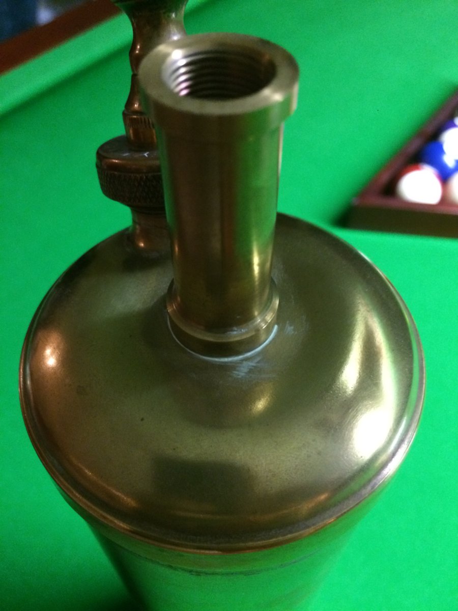

    In this picture from the other thread, the top of the riser where the cock screws in is machined flat. Tilley as far as I know always cuts grooves in that surface where the washer could bite into. I was just wondering if Kayen lamps usually had a similar feature?

    Thanks, Matthew. I'll check.

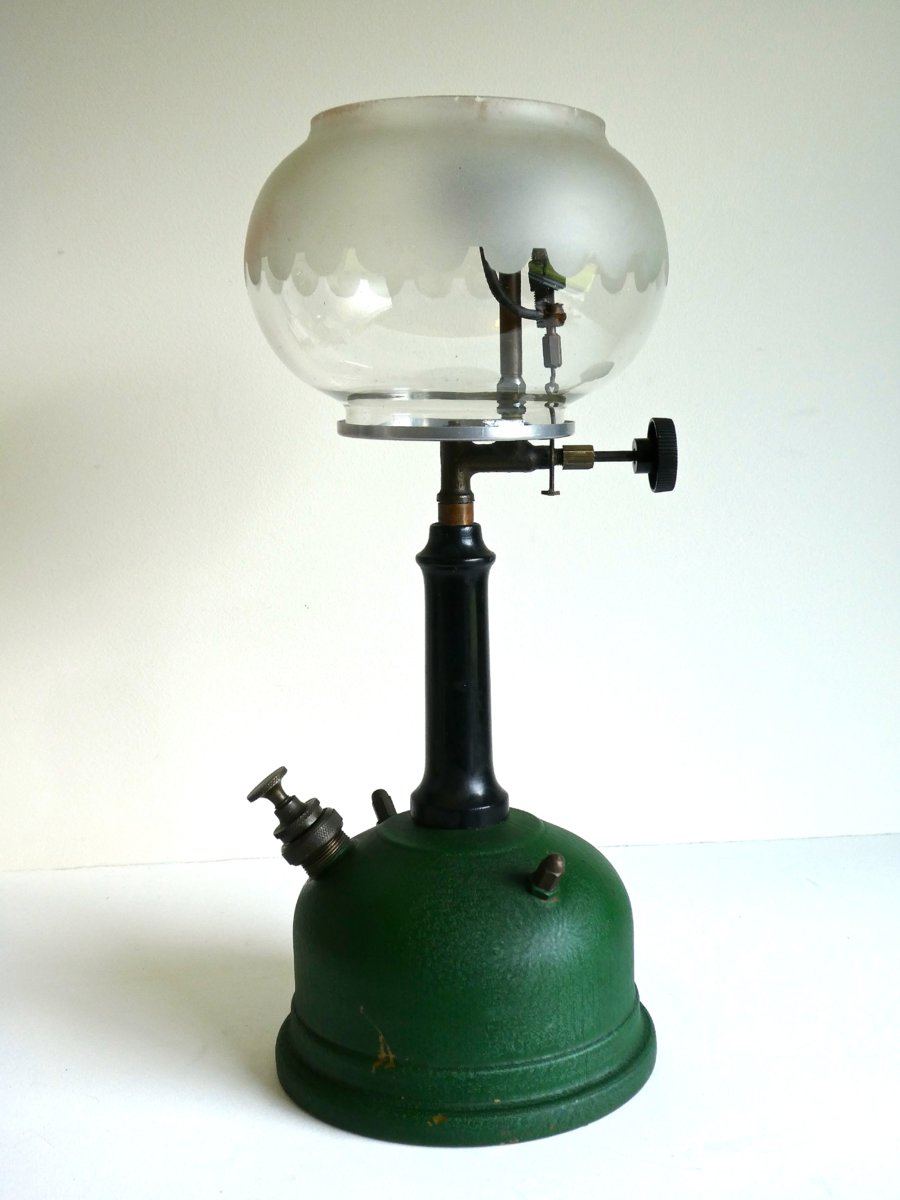

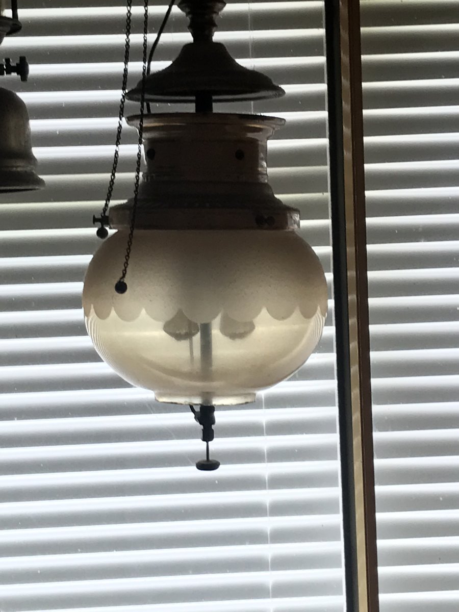

    The globe I was referring was this one:
    It looked to me, from memory, similar to the one on my Quirk’s:
    Bernie and I were discussing that the globe on my Quirk’s is similar to globes that appear on Australian Wizard lamps. Looking more closely at the photo of your lamp, I’m not sure the globe on my Quirk’s has a pronounced enough ‘lip’ to take a hanging fitting.

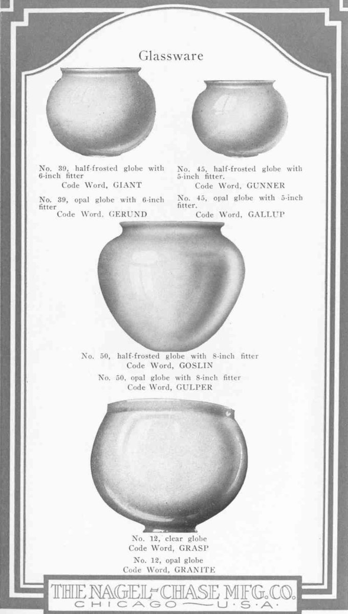

    Oh I see. That is a standard Nagel Chase globe. and the fitter is 6 inches with a quite deep lip which makes it NC globe No 50. Here are all the NC globes from the 1923 catalogue. They don't show the frosting well but the illustrations of the lamps in the same catalogue do show the scalloped design. Wizard are kinda NC style lamps and perhaps might be considered as Australian NC product so not really a surprise to see an NC type globe on another Aus lamp. ::Neil::

    Neil, Surely you mean globe No. 39 ?

    Ah yes. I was looking at the wrong pendant in the catalogue. The 50 fits on the model 173 600cp version but my pendant is a model 150 300cp so you are right and the globe is part 39. Same as, just different sizes. ::Neil::
