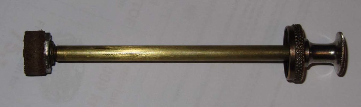

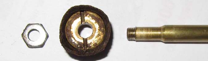

    For Primus, the pump leather is tightly fitted to a 'carrier' which is then loosely fitted to the pump rod. The pump rod has a narrower section where this carrier fits with a tapered section to the larger diameter. When on the compression stroke, the carrier pushes back against this taper sealing the pump and on the back stroke the carrier pulls away letting air through the centre of the carrier around the pump rod. I'll try and take some photos when I get home from work.

  11. Nils Stephenson
    2,199
    Here are a couple of pictures of the Primus pump rod.
  12. AussiePete
    920
    Hi @Nils Stephenson I see now, I think Primus pressure stoves have a similar setup.
    Maybe @Peter has a problem in this area, coz I have seen where previous “fixer uppers” had mistakenly packed the leather cup carrier from moving back and forth on the shaft ...... rendering the pump almost useless.
