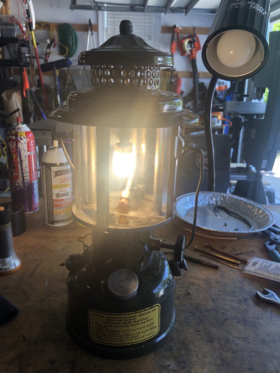

    13275673-6275-43FB-9EF9-BDA492D01D2D.jpeg Waiting for my acupuncture needles I became impatient. Although my new generator is clear and passes fuel, neither of my jets will pass fuel. As an experiment, I installed a jet from a 220 generator. Supposed to be much larger. With a bucket of water ready, fire extinguisher, safety goggles, and welders gloves, I pumped 3 pumps. It lit immediately, flamed a bit for, then turned bright. It has been running now, seemingly happy, for ten minutes on 15 pumps.
  15. BradB
    Apr 17, 2017
    25
    After nearly an hour it seemed the lantern had dimmed just slightly. Ten more pumps brought it back to full roar. I am calling it a win! Brad

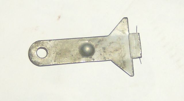

  20. Henry Plews
    1,992
    So why are they still listed ? Milspec Wrench - 184
  21. BradB
    Apr 17, 2017
    25
    Good question. I thought I heard these were missing the pricker. I ordered one anyway, so we will see. Thanks, Brad
