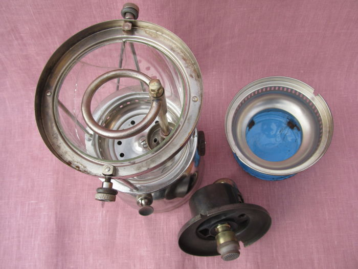

    I have always loved these bluehooded Primus, but the are as difficult to find as tears in the rain.
    Now I can cross that off the list.
    I got lucky here as the lamp has been fired 1 or 2 times and the condition is very good. As almost all these Primus, the strange hood looses enamel where the connections is made - a constructionfault I beleive.
    The cage has a single stress-crack, but so do I :lol:
    450 cp is not often seen on a lamp ;)

    Thanks fellow lampers.
    According to Nils Stephenson, then this lamp was listed from 1952 to 1954, short time.
    This and the bluehooded Primus 1084 tends to show up in Danmark.
    The 1084 probably shows in DK because the largeish telephonecompany KTAS bought them as work- and emergency light amongst other lamps. The 1084 often carry a KTAS-stamp, but.....
    if that is the same with this 1082 - I have no idea, but then they stopped stamping the lamps.
    Maybe Nils S has better knowledge.
    Any way - they are pretty hard to find and thats too bad, fore as you say they look nice O:)

  6. Nils Stephenson
    2,889
    Congratulations on the lamp Claus. There aren't many of these around, so well done. I havn't found any geographical connection with these 'S' models as the few around have been found in almost as many countries as the number of known lamps. The 'normal' 1084 does tend to turn up relatively often in DK, because of the KTAS connection.
    I assume the 450cp was a more accurate conversion from the 500hk used in Germany, rather than just saying they were 500cp.

  11. Nils Stephenson
    2,889
    I think you might be confusing the 'normal' 1082 (no blue top) and 1084 (normal shaped blue top) with the 1082S and 1084S (both with this special blue top). There was no difference in cp (300) between the 1082 and 1084, the only difference was that the 1084 had a quick start. The 1082S and 1084S both had 450cp with everything else being the same as the 'normal' models.

  13. Nils Stephenson
    2,889
    The standard 1084 was always a 300cp lamp according to the catalogues. If you have one with a 500cp jet, then this must be a later replacement. That was the whole idea with Primus releasing the 'S' version, as it gave them a lantern with a higher cp.
