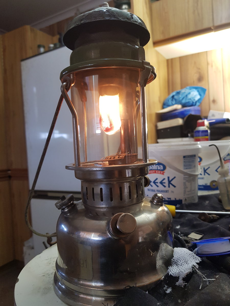

    Hi fellas, can i get some advice on what may be wrong with my lantern,
    I have the orange flare around the mantle,
    When i stipped cleaned and put back together, i replaced the small pricker and the jet bought from the bay, for primus 991, it all fires up ok but it dosent get any better than this.
    Ive used big and small mantles.
    The air tubes are not blocked or obstructed.
    The original jet and pricker were flogged
    Its seems to be a fuel air mixture thing but im open to suggestions.
    Thanks
  2. AussiePete
    2,033
    Hi Darryl
    I’m not familiar with this breed of lantern but it looks to be running too rich. That is to much fuel for the air mixture.
    First thing I would suggest is to put a thread sealant paste or similar around the jet before screwing it in. I have had a lantern recently, with a new jet, that was getting too much fuel, burning just like yours. The extra fuel was escaping the generator from around the jet’s thread. Sealing the thread solved my problem.
    Second, as I said I’m not familiar with this breed, however does it have a screw in the “J” tube just above the where the jet shoots it’s fuel. If it does this screw operates a butterfly inside the J tube, like a carburettor on a car. You can adjust the butterfly’s position to alter the fuel/air ratio mix using a screw driver and twiddling the screw.
    I’ve also heard that the height of the J tube’s opening from the jet is fairly critical. It can be adjusted by loosening the J tube clamp, lower or raising the J tube and retightening the clamp. Maybe others can help here.
    Hope this helps.

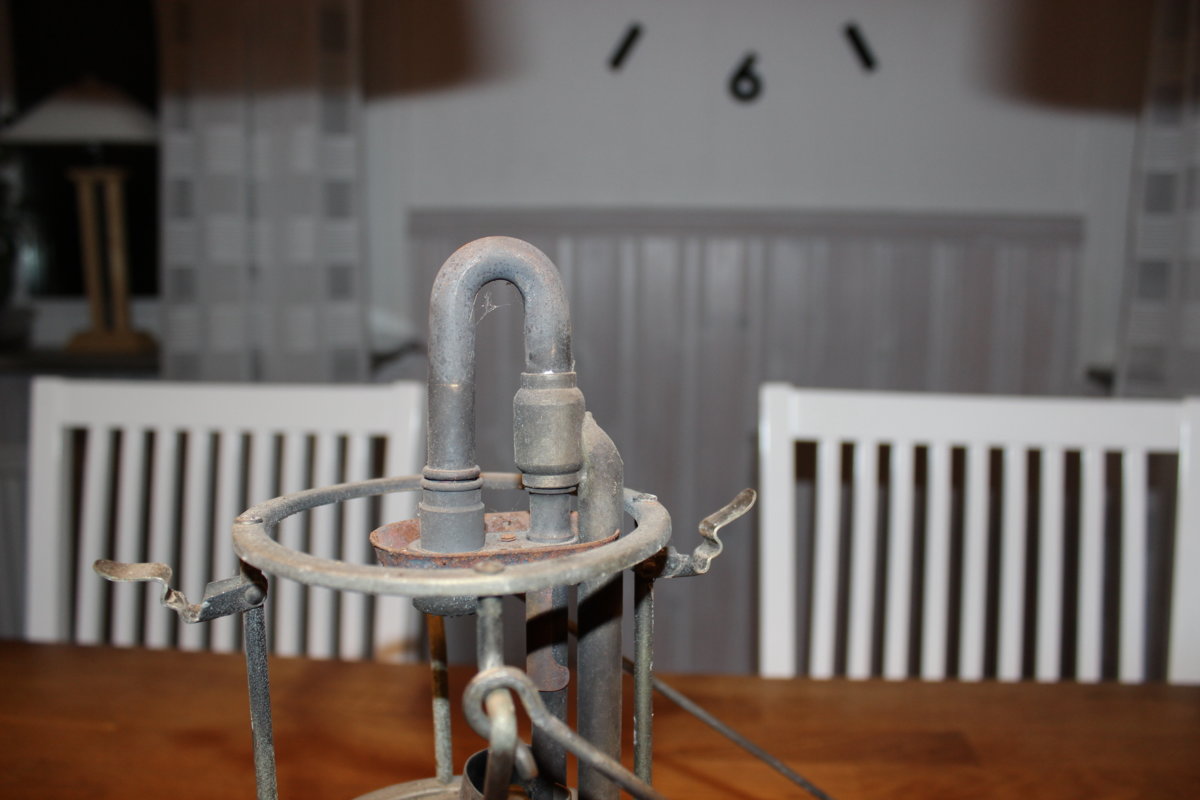

  3. Matti Kucer
    Matti Kucer Sweden Subscriber
    Mar 4, 2018
    161
    Sweden
    Hi!
    It looks like this, so no adjustments as far as I can recall.

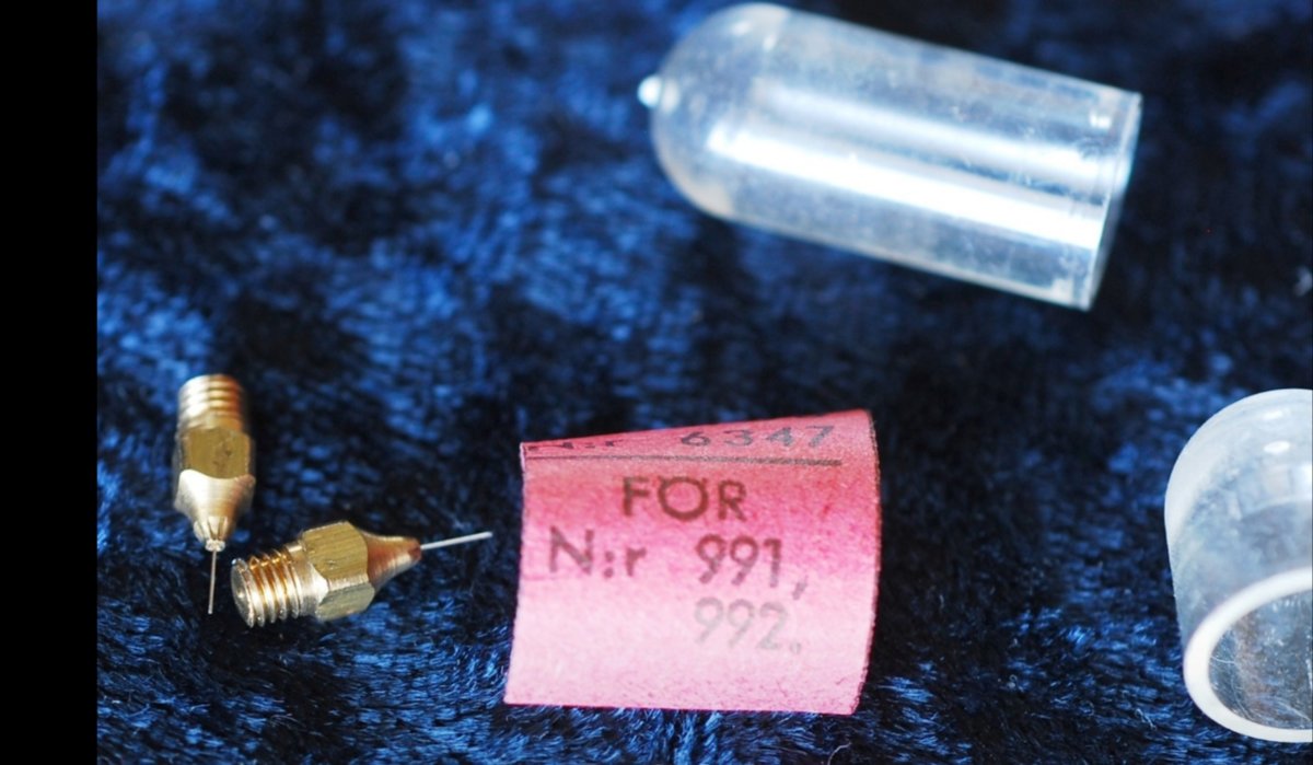

  7. Nils Stephenson
    2,334
    That certainly looks like it is running too rich. Where did you get the new jet from? I'm wondering if it was a jet for the 981 instead. The part number for the 991 jet is 6348 whereas the part number for the 981 jet is 6438. Easy to mix up as the thread is the same.
  8. Matti Kucer
    Mar 4, 2018
    161
    Sweden
    And the needle is part 6347.
  9. MYN
    1,220
    If the parts are right and the problem persists, you might want to check if the jet is shooting out a sharp, vertical stream of fuel. If its shooting sideways or at an angle or spraying/dribbling a little, you'll get an inadequate fuel-air mix. Usually due to some dirt blocking the orifice.
    Or if the J-mixer/air intake unit is a little bent or not in-line with the vaporizer/generator, it brings about the same effect as the above-mentioned.
    If you really need to adjust the air-gap for an 'unadjustable' design, you could try fitting in a piece of suitably-sized washer at the end of the vaporizer around the jet as a spacer before re-assembling the J-mixer cum air intake unit.(this could only increase the air gap a little, which might or might not be helpful to get a leaner fuel-air mix).

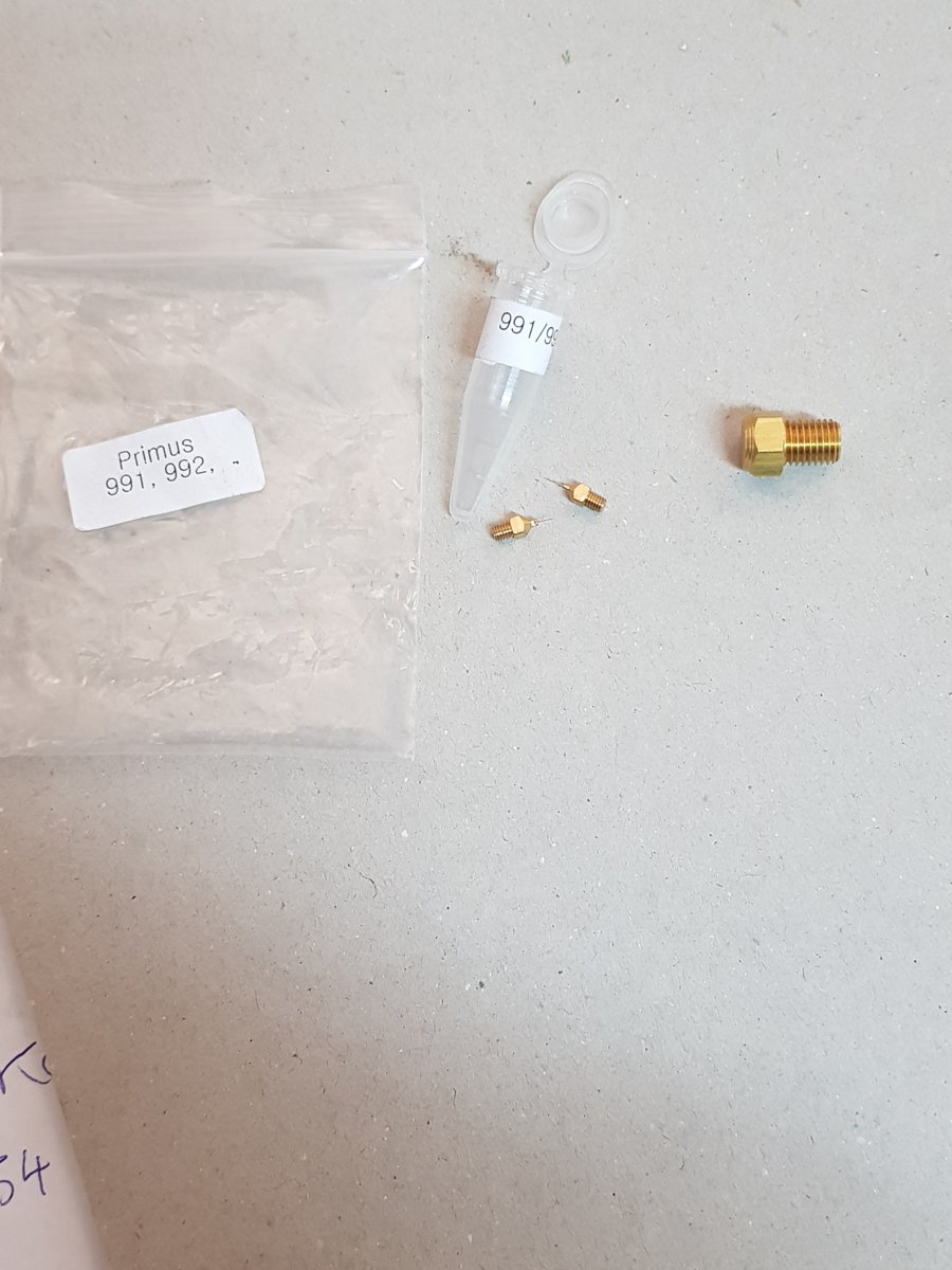

  11. Darryl Durdin
    494
    Hi there, this is what i bought of the Bay, said
    Jet and needle for primus 991/992.
    It has no more detail than the packet.
    Ive followed the tips from above and i have a slight improvement, it started out a bit rich but did settle as it got hotter, no orange flare but the mantle did not brighten up it was dull white.
    It seems to lack the pressure hiss , its there but not distinct.
    It has a good stream of fuel , i even pulled it apart when hot just to see the vapur and that looked all good.
    There dose not seem to be any obstruction in the fuel pick up in the tank.
    The air tube can be unscrewed raising the J tube buy a few millimetres but that did not improve matters,
  12. Nils Stephenson
    2,334
    The jet and needles must be new production. They look well made but it is hard to know what size the hole is. From memory it should be 0.17 mm. Definitely not bigger. Screwing on the mixing tube will not change anything. The height is fixed by the construction of the top of the air tube. The screw adjustment is only to make sure that the air tube and mixing tube sit flush where they press in. In my experience with this type of burner, it is either the jet or the air supply. Are there any serious dents in the air tube or mixing tube? How snugly do they press into the burner?

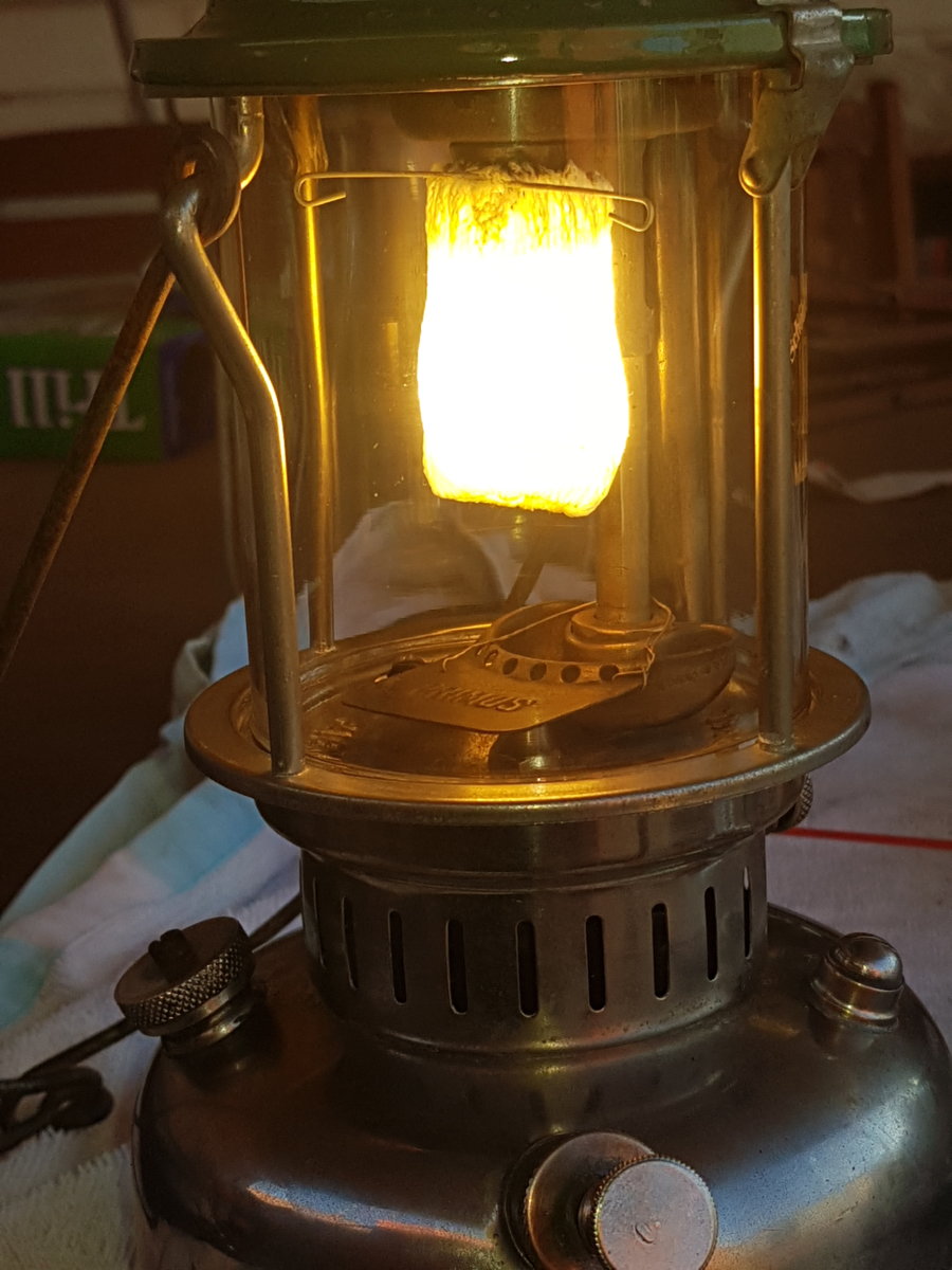

  18. Darryl Durdin
    494
    Hi fellas, i followed your tips and advice, it now dose not orange flare, i thoroughly cleaned the fuel uptak, generator needle rod, i cleaned it with firearm solvents , snake cleaner, wire brush, and a bit of hydrochloric acid,
    Ive used a long mantle to see if this helps vaporization,
    I may have to check out my leather cup pump, i seem to be doing alot of pumping, the NRV is working, im thinking maybe not enough pressure.
    Joy, joy to be had

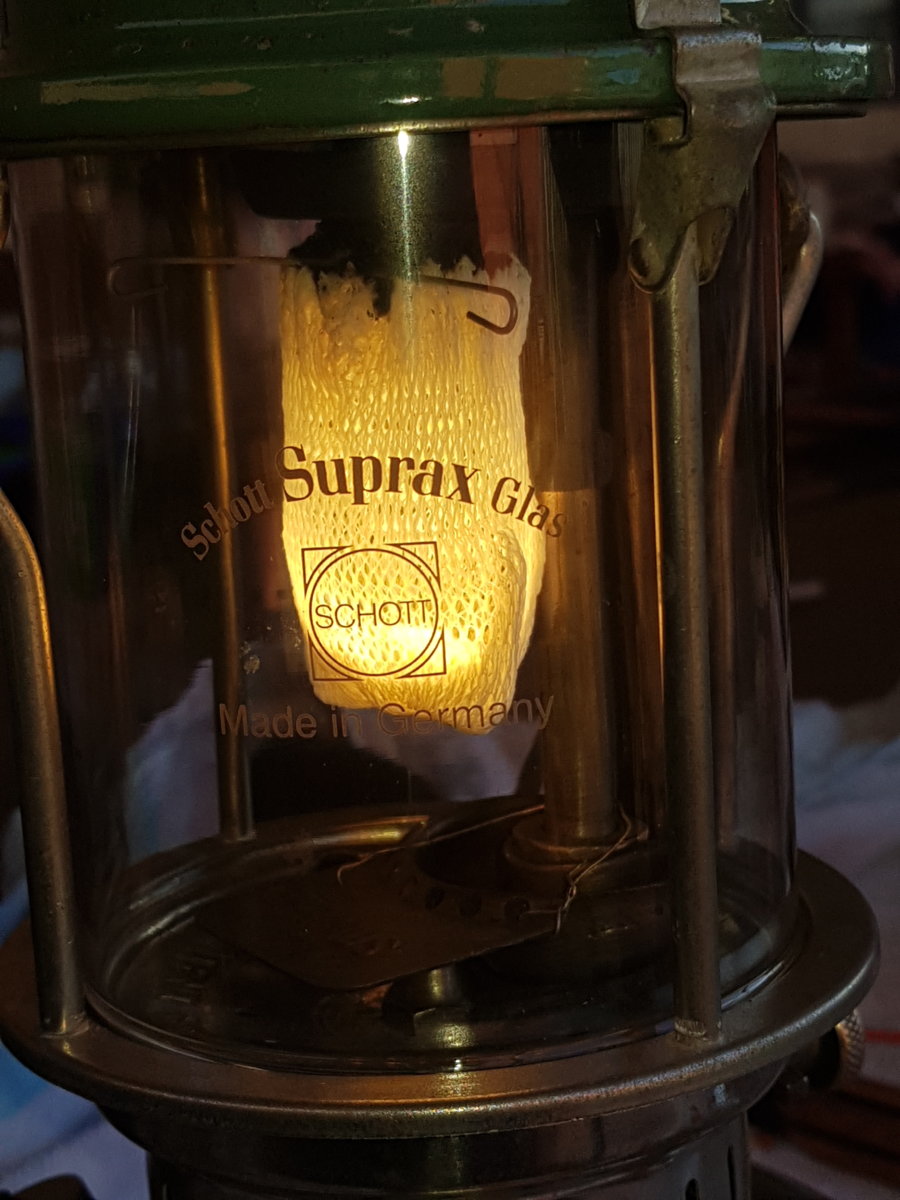

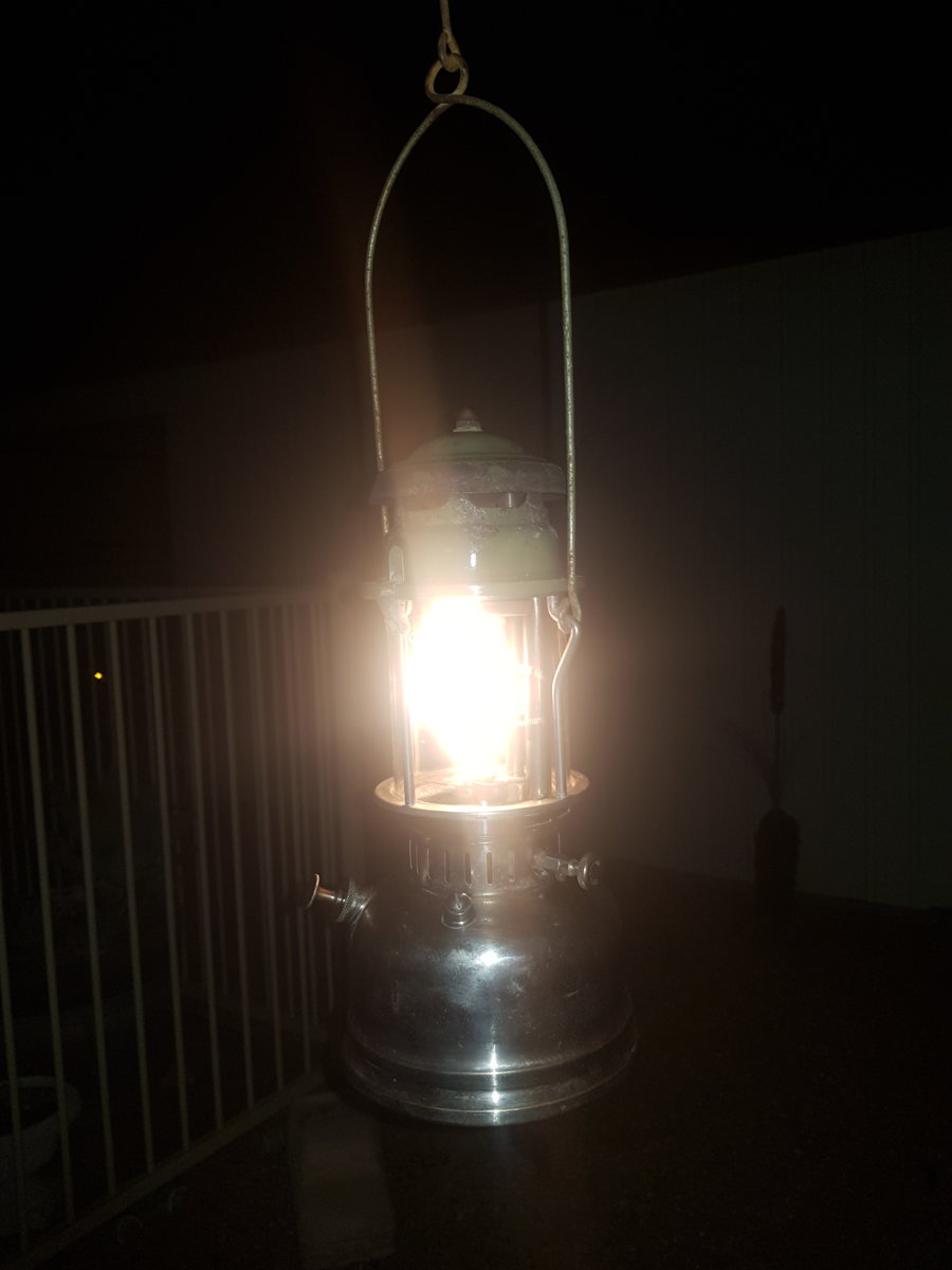

  19. Darryl Durdin
    494
    Hi fellas, itz been a journey but i think i have it.
    I revered the leather cup, put it back in and now what a difference with the pressure. 20200221_184759.jpg
    Thanks fellas for all your tips and advice.

  21. Darryl Durdin
    494
    And now the money shot,
    Im very impressed with this little beauty.
