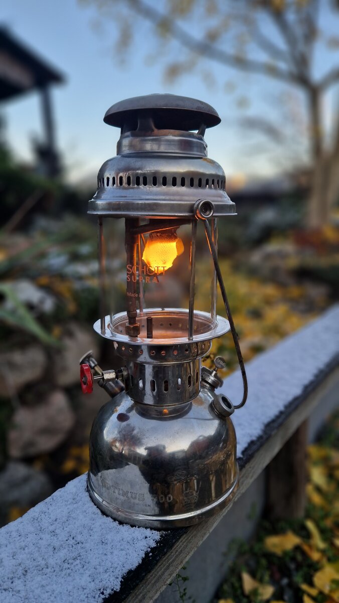

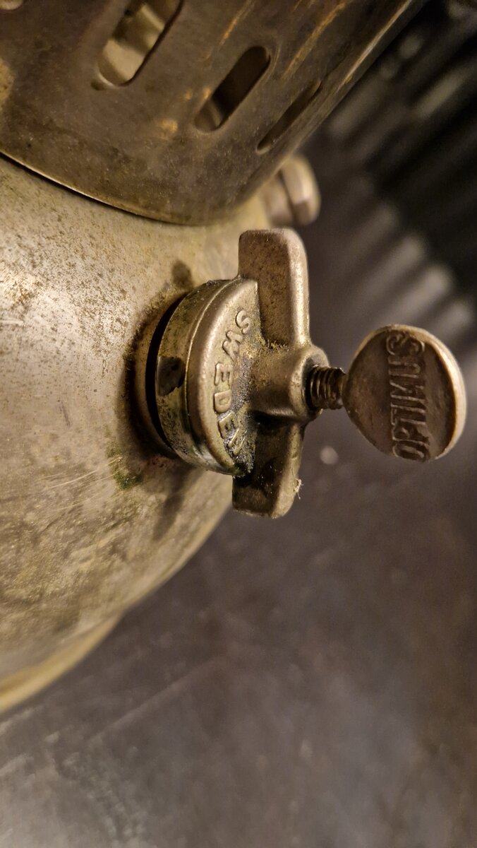

    I picked this one up today (my first one), I think there is alot of work in it, but it will be fun. I Hope I can make it shine again. Can anyone tell me how old it is ?
    20221108_181741.jpg 20221108_181755.jpg 20221108_181809.jpg 20221108_181828.jpg
    Best regards
    Thomas
  2. presscall
    1,502
    Lancashire, UK
    No ‘P’ after the ‘300’ designation, nickel plated and not red enamelled top. 1940’s as a rough guess. @Nils Stephenson
    John
    15,438
  4. Nils Stephenson
    3,271
    Hi Thomas and welcome to the forum.
    Your lantern is from the mid to late 1940s. Everything seems to be there so should clean up alright and work well.

  6. presscall
    1,502
    Lancashire, UK
    People seem to have their favourites, but a diluted citrus solution gets frequent mention. Over on Classic Camp Stoves long-time fettler Kerophile makes up a mix of wallpaper paste with the dluted citric acid and applies it to components to take effect over an hour or two, then rinsed off with warm water.
    Personally, I first strip a lantern or stove down to component parts and wash them in a warm, mild detergent solution, often using an ultrasonic cleaning machine. Whatever residue is left is removed with the wallpaper paste laced with citric acid.
    For final polishing the usual tip is to avoid cleaning liquids or pastes containing ammonia (not good for brass) and those that are significantly abrasive.
    John

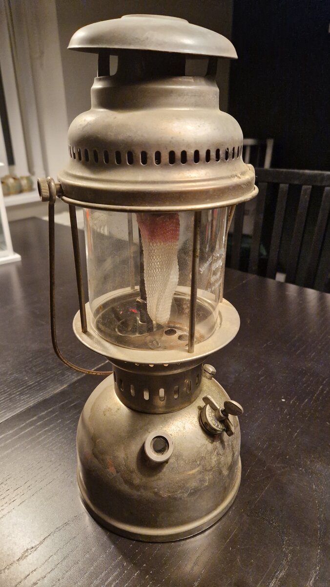

  8. Grundsoe Denmark
    Nov 8, 2022
    10
    Denmark
    This is how it looks now, still having some trouble to make it burn right ;)
  9. Henry Plews
    2,816
    The mantle doesn't look to be properly formed. Perhaps the lamp needs more pressure.
  10. Grundsoe Denmark
    Nov 8, 2022
    10
    Denmark
    @Henry Plews what is the correct way to form the mantle ?
    Best regards
    Thomas

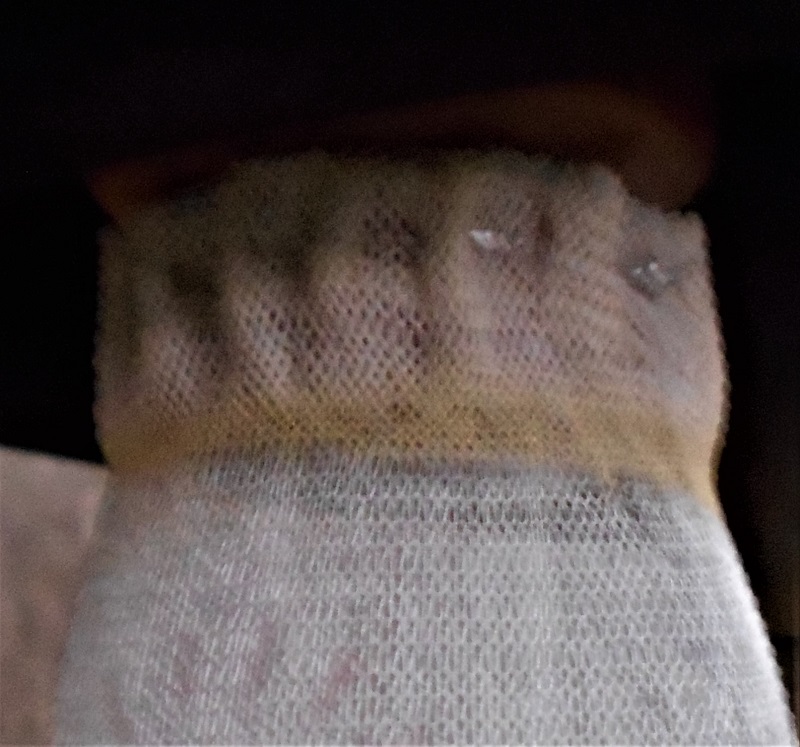

  11. Henry Plews
    2,816
    It helps if the folds are evenly spaced
    but basically, plenty of pressure. Because your lantern is an Optimus, you should be able to pump it until your thumb hurts.
  12. presscall
    1,502
    Lancashire, UK
    @Grundsoe You certainly made a great job of the cleaning.
  13. Grundsoe Denmark
    Nov 8, 2022
    10
    Denmark
    @Henry Plews you where right ;) new mantle and more pressure, and it runs perfect....thanks

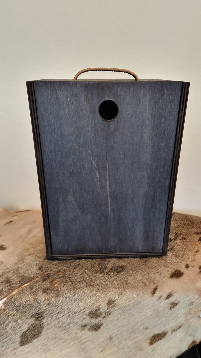

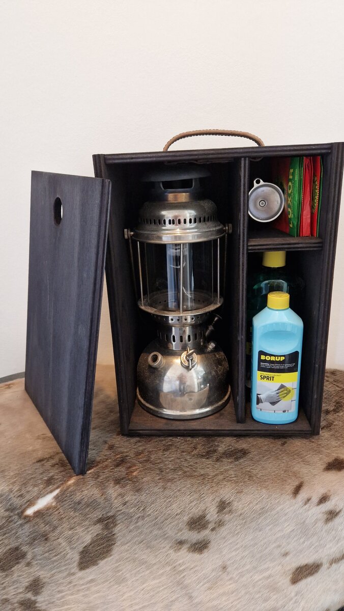

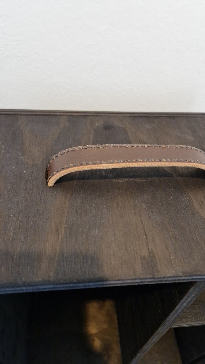

  17. Grundsoe Denmark
    Nov 8, 2022
    10
    Denmark
    Made this box ;) 20230311_104748.jpg 20230311_131658.jpg 20230311_131703.jpg 20230311_131938.jpg 20230311_132026.jpg
  18. Jean J
    2,760
    Nice job and that lamp looks great.
  19. Paul Burnell Ireland
    May 12, 2023
    120
    Ireland
    I love the box....great kit. Everything in the one place, very practicle.
