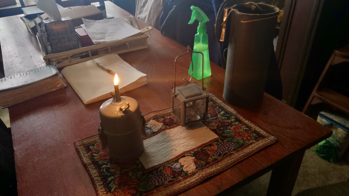

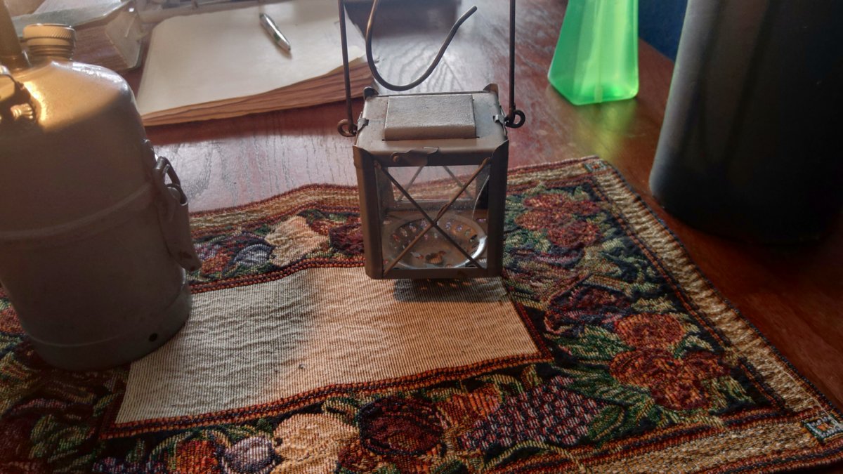

    Already here's three pictures of the lantern and I decided to take a look at the burner again and I gave it a little bit more effort trying to take the burner off and it does unthread and I think it wasn't coming off easily the first time because I'm guessing the lantern is kind of new-ish so the paint must have still been on there keeping it stuck or something but it does come off and will be easy to replace if I can find another burner that is.
    Ray
  10. Carlsson
    3,487
    That's good news! Then everything is normal.
    Yes it's good to be able to swap the burner. The soapstone they are made of is soft, and after some pricking, the two holes will be too large.
    They shall be of a pretty loose fit, hence the extreme taper. It's part of the safety system. The burner shall pop if the pressure inside gets too large, and too large in this case is very small since acetylene will explode if compressed to only around two atm.
    Normally they just recommended some soap for sealing the threads of the burner.
    And you got the little case for it too!

    Well the picture that I showed you with it lit was going for ~ few hours and I only filled the carbide chamber about half of what can be filled... the chamber shows a Mark that you do not go beyond with carbide I filled it halfway to that mark. I'm assuming everything is fine with the lamp because when I went to empty the carbide chamber all of the calcium carbide that I thought was still usable was actually a sludge and not usable so I'm assuming it was all used up like it should be. It's just kind of hard judging how long these lanterns should last on a charge of carbide... I'm not really sure per say especially with these kind of lanterns.
  14. Carlsson
    3,487
    They should easily run for five hours when filled to the mark, and at nominal flame. It all depends on which burner you got, of course, but since yours probably is the original (I think it was a 14 l/hr burner), the five to six hour run time should be pretty close to the truth if you use it on nominal flame. You probably ran yours a bit lower.
