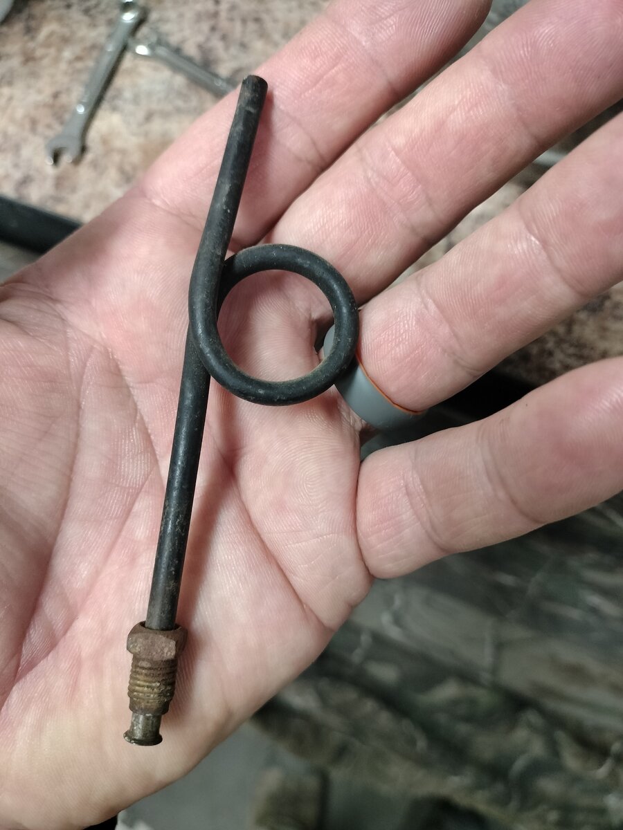

  7. My29cq329
    My29cq329 United States Subscriber
    Mar 10, 2024
    48
    Ne Ohio
    Fireexit1, I don't see any stamp on mine having a q or v?(After looking closer it does appear to have threads inside still left so that's a good thing but it will not pass any air through it so it probably needs heated and quenched if I'm lucky) 17106827852888733336453956147267.jpg
  8. Fireexit1 United Kingdom
    3,441
    The stamp is on the jet tip. I mentioned it as the tip is shared among several different generators. However if yours has no threads then I suspect it is junk. As you are in the US these guys may be able to help : Old Coleman Parts > Categories
    Very often CQ lanterns were "upgraded" by fitting a R55 "roto" generator as it has an inbuilt pricker wire. It should fit as it has the same threads and same vertical height, and the same diameter gas tip. Old coleman parts have R55s on the website and some tips for the Q99. But if you have no thread...
    This lists all the CQ parts. Old Coleman Parts > 131 and Higher > Model "C" or CQ Lamp

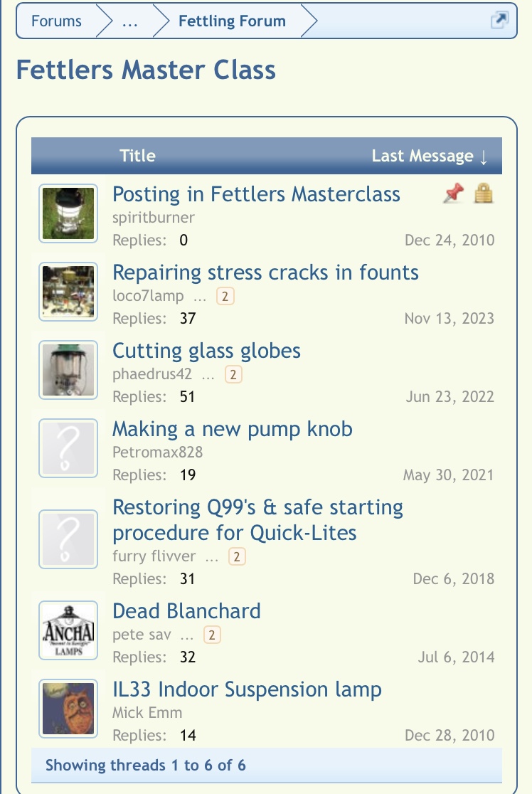

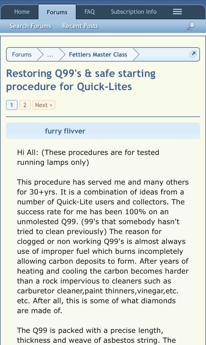

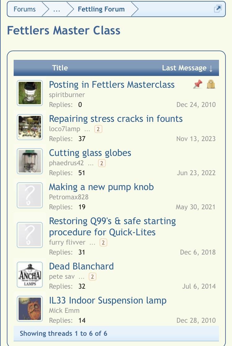

  9. podbros
    3,614
    @My29cq329
    there is a post about restoring old Q99 generators in the Fettling Forum?
    Click on the Fettlers Master Class…
    It’s the 5th one down…
    If you have already found it then my apologies
    regards
    pb
    edit: the thumbnails are a bit blurry but clear up when you click on em
