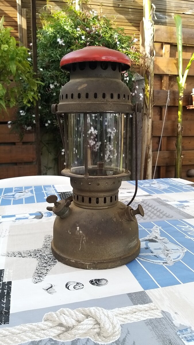

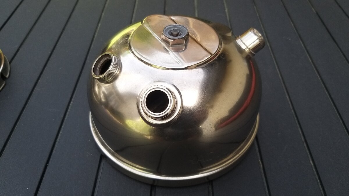

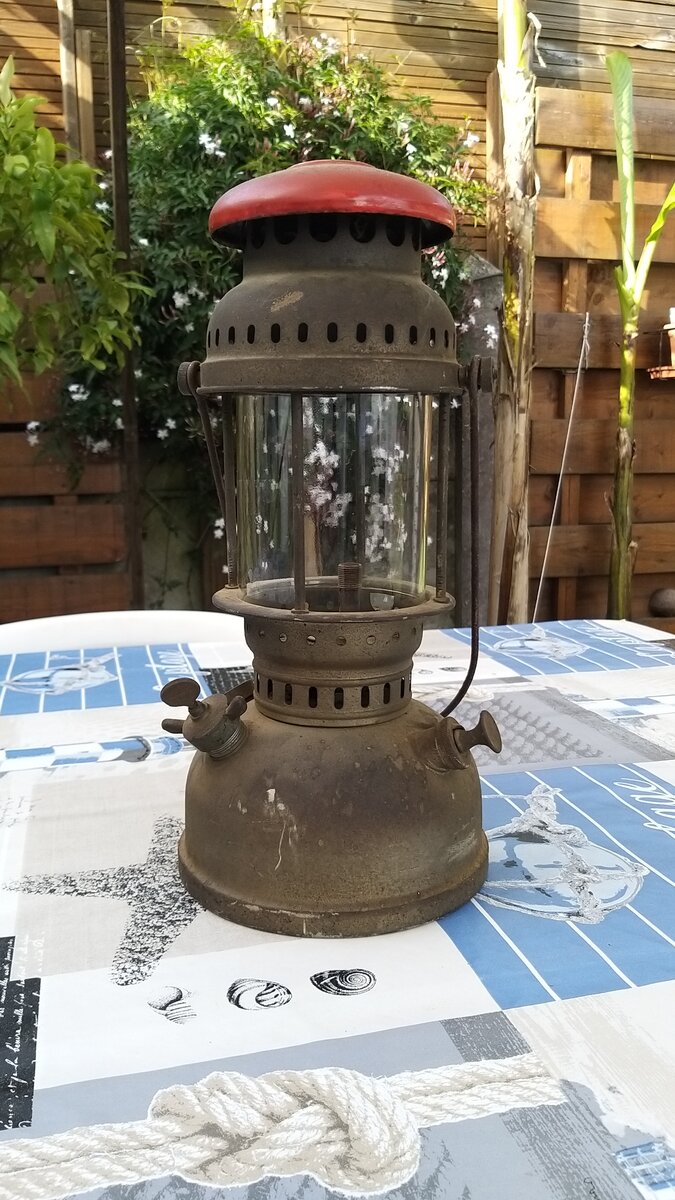

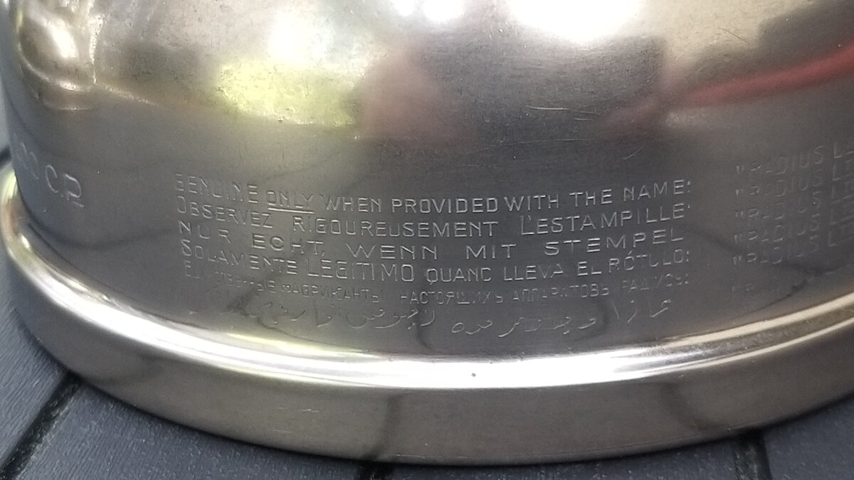

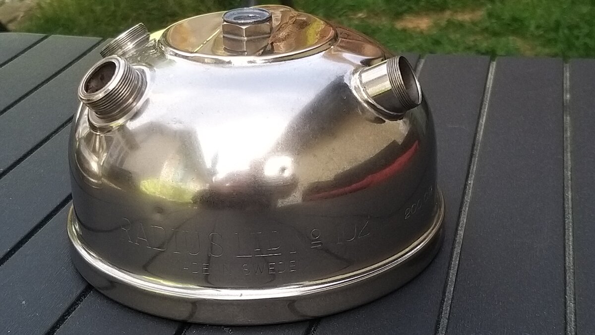

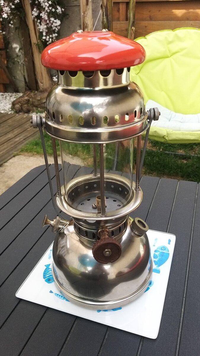

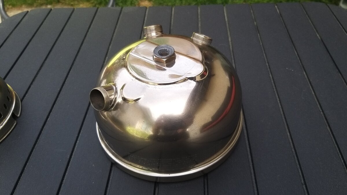

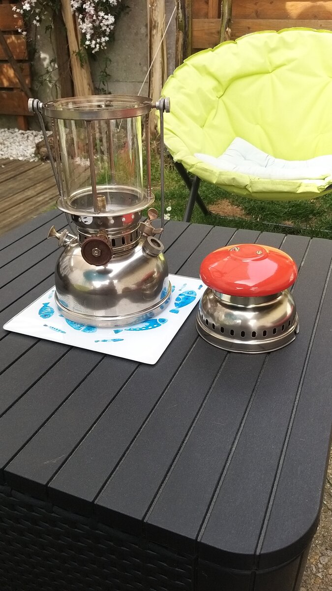

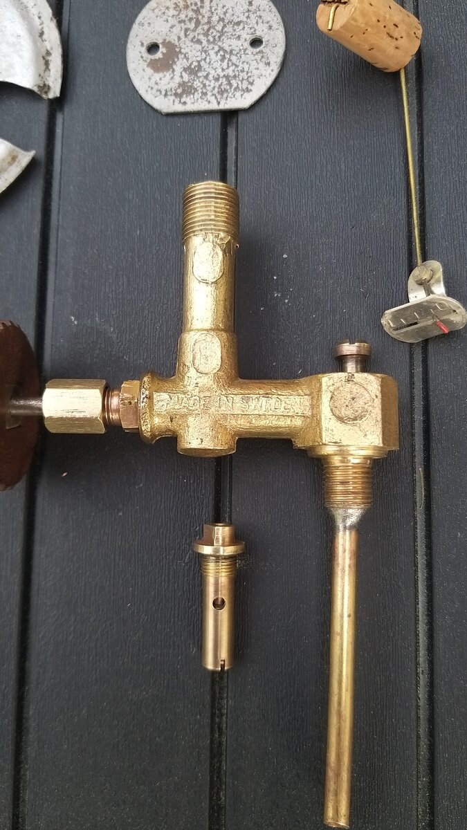

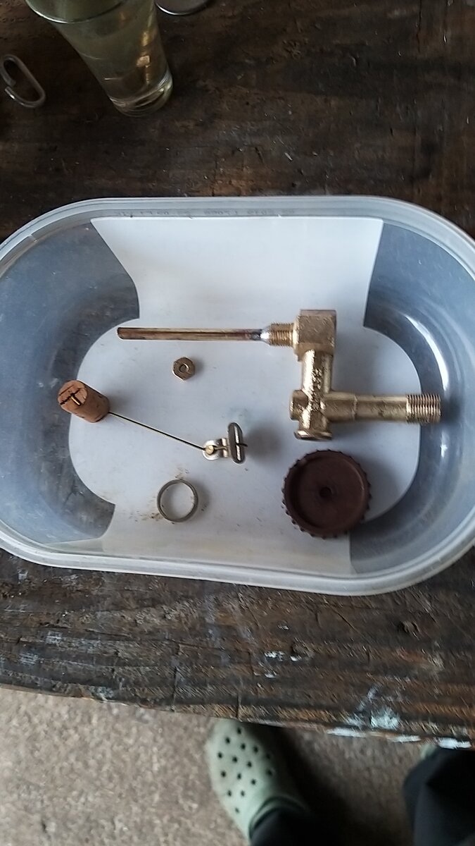

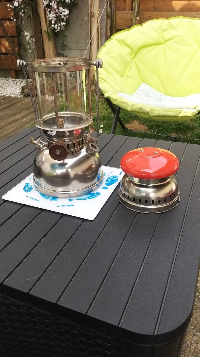

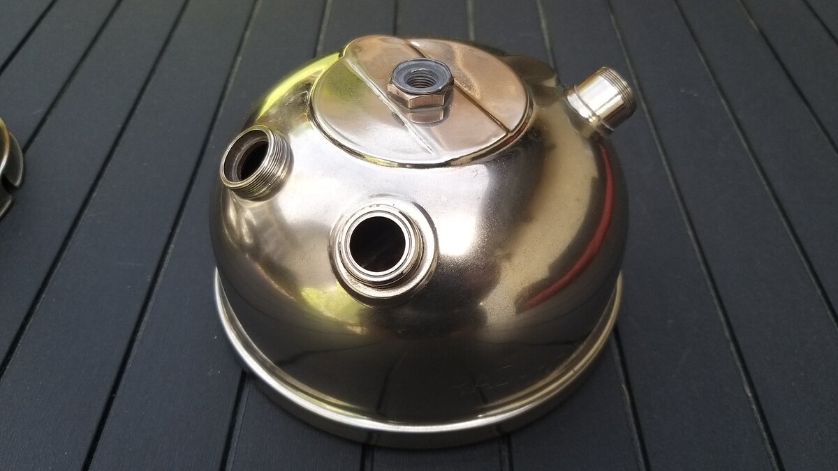

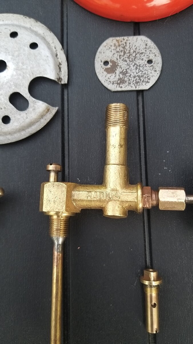

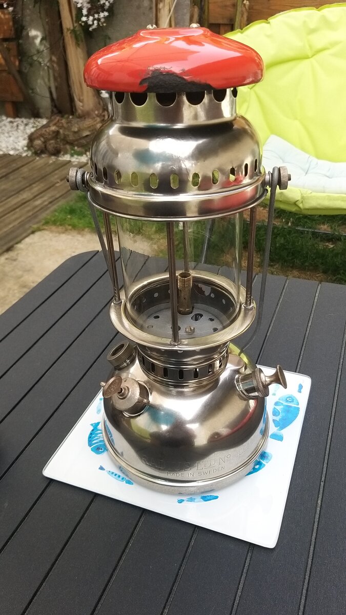

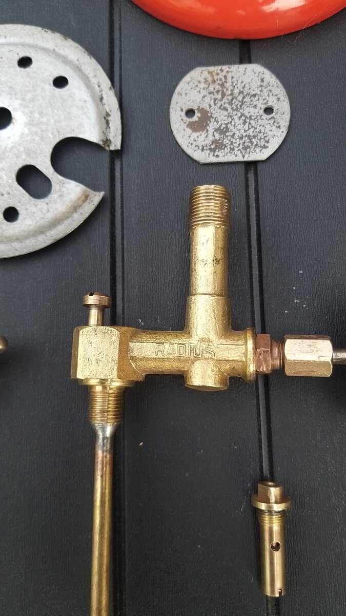

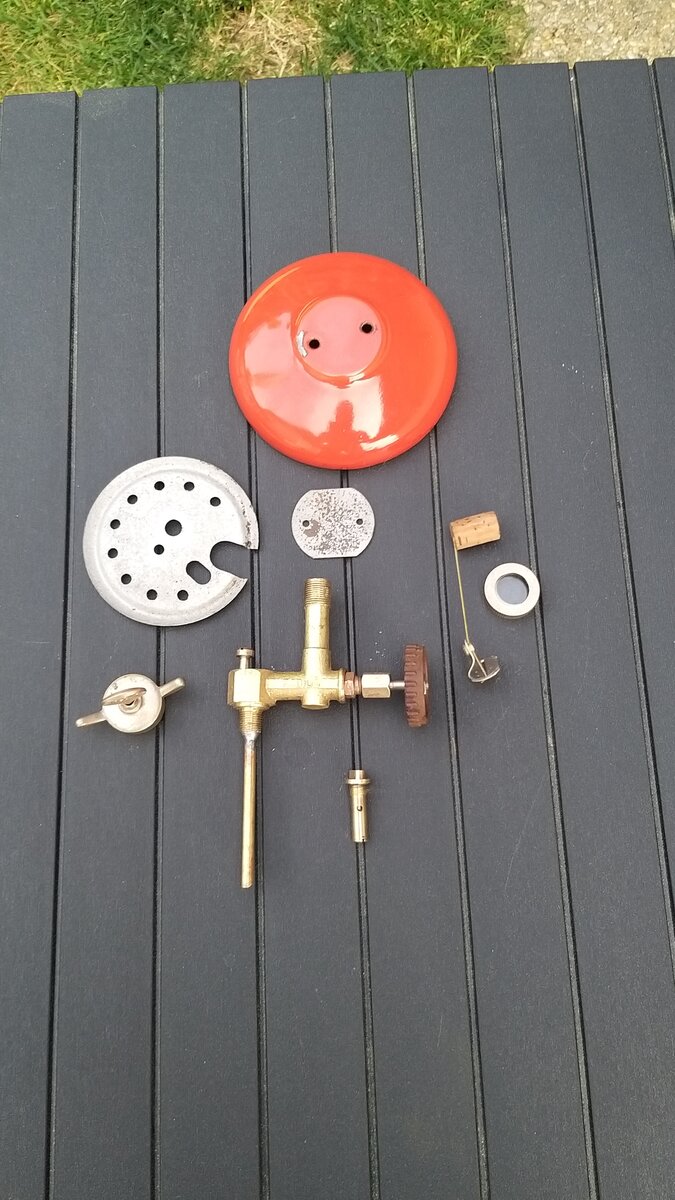

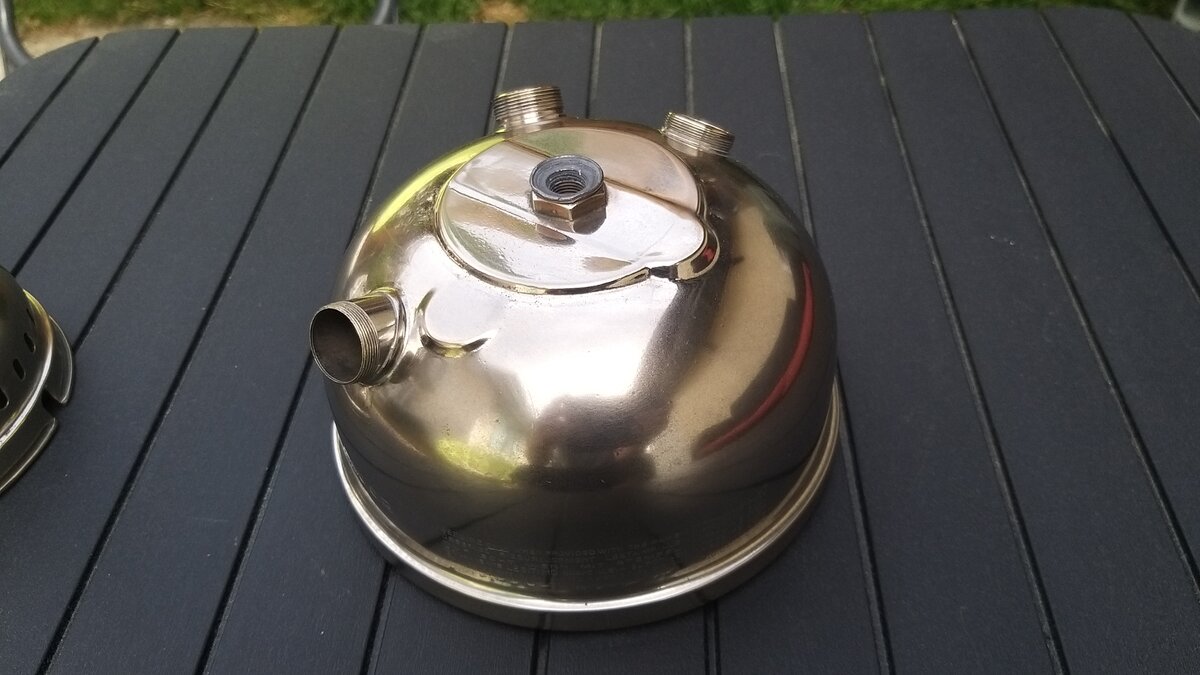

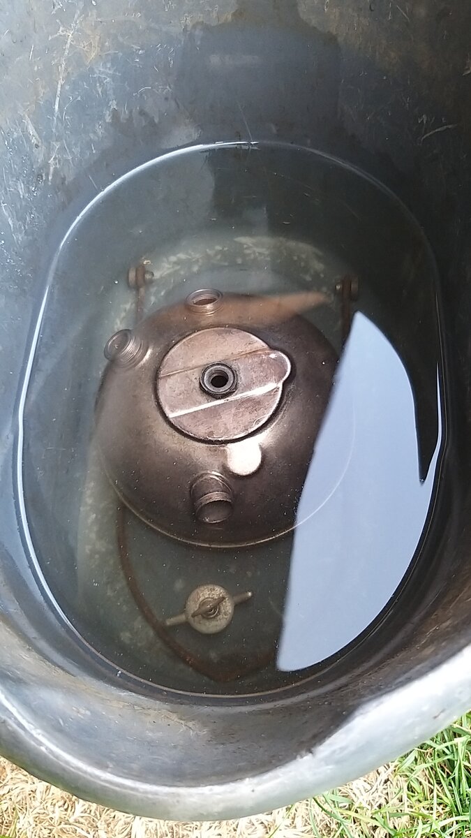

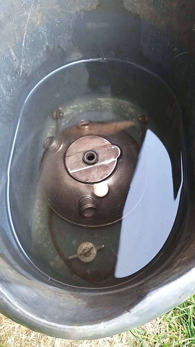

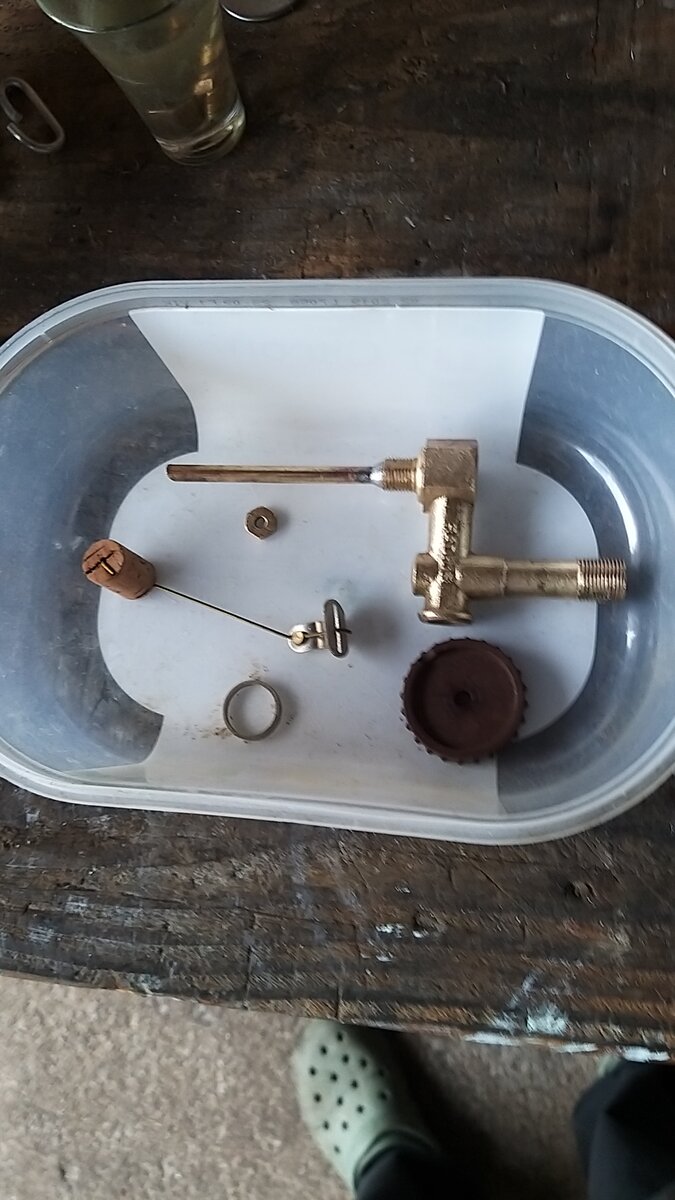

    Gleaned a few months ago as a wreck (all the upper part of the carburation is missing, and the preheating cup too)
    After a bath and cleaning :
    20210330_193004.jpg 20210330_194228.jpg 20210401_120646.jpg 20210401_120701.jpg 20210401_120710.jpg 20210401_120717.jpg 20210401_121503.jpg 20210401_121509.jpg 20210401_121517.jpg 20210401_145925.jpg 20210401_150251.jpg 20210401_150305.jpg

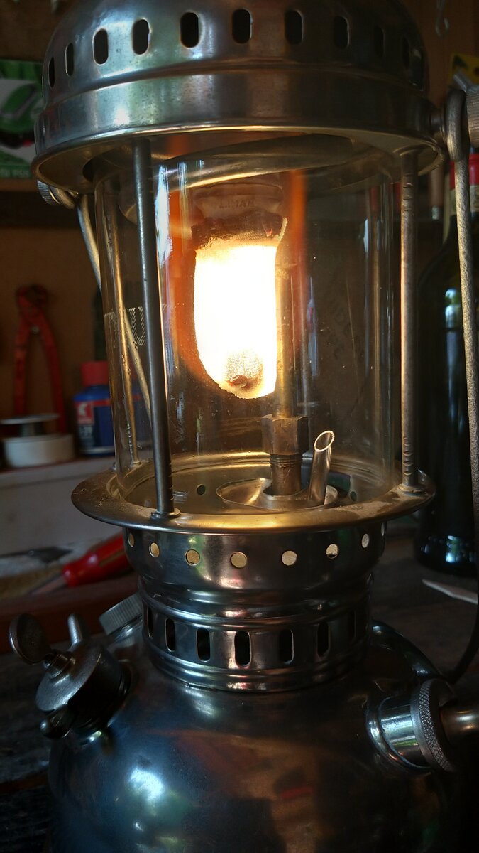

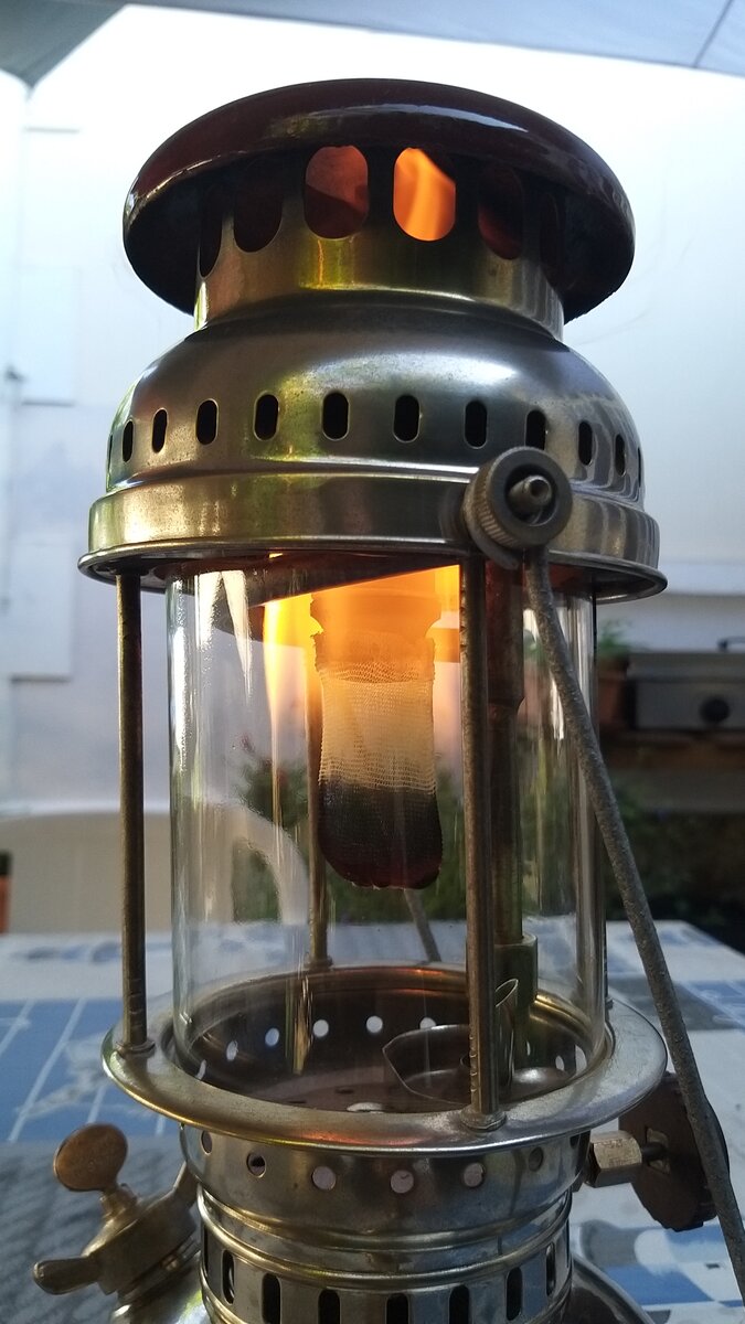

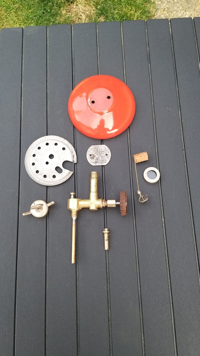

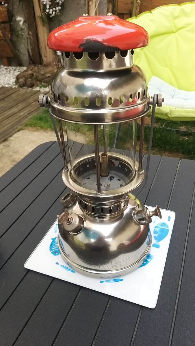

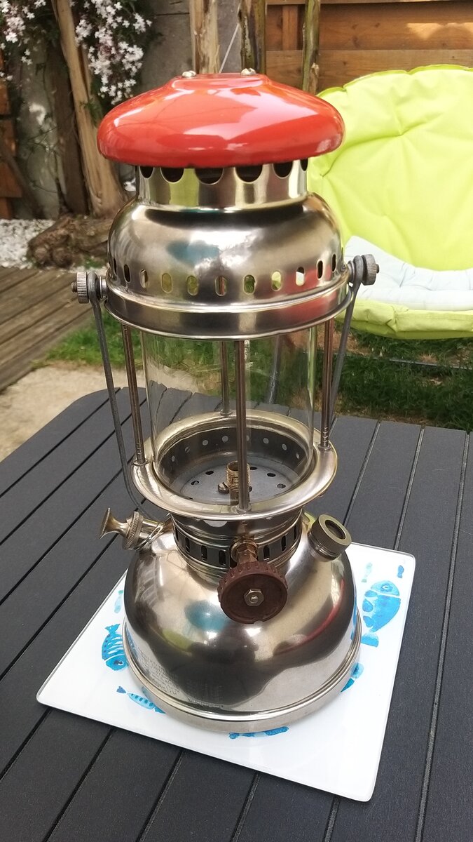

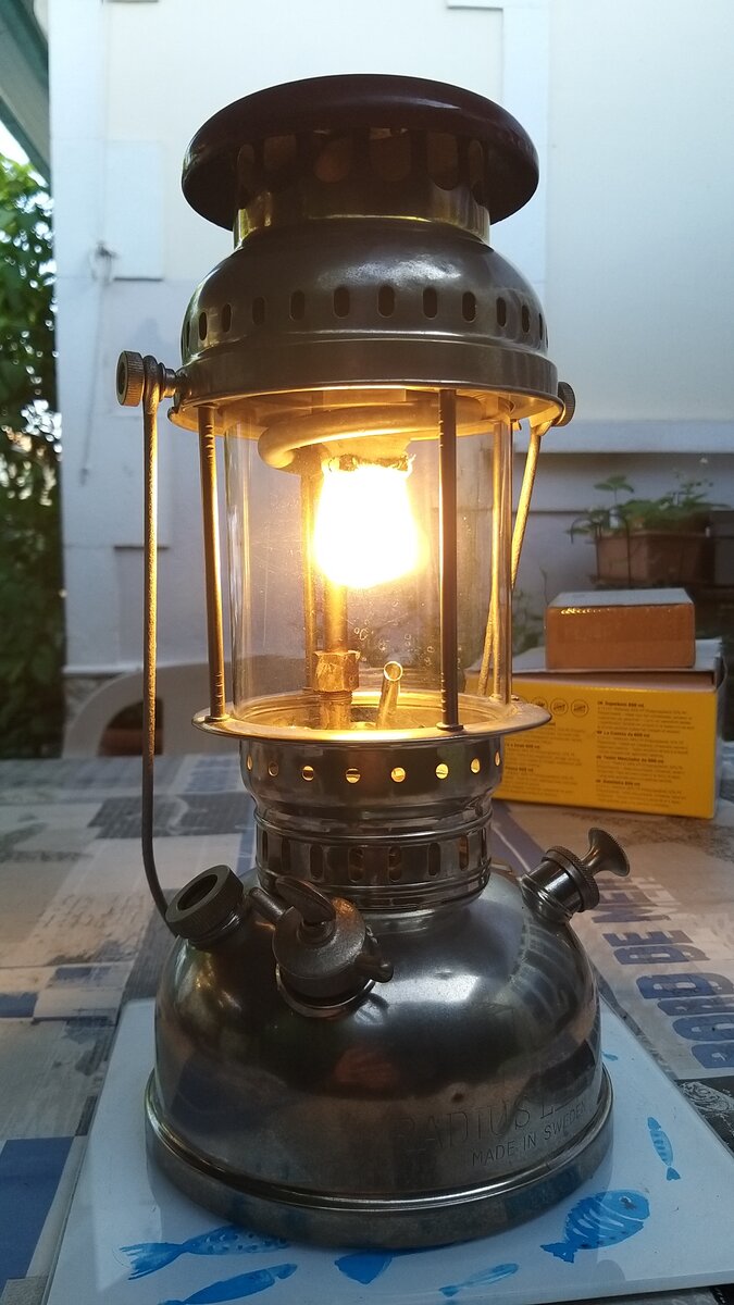

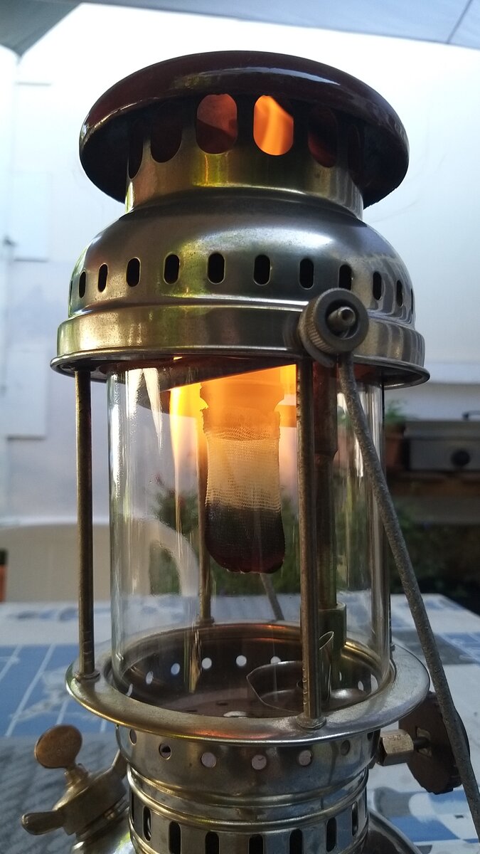

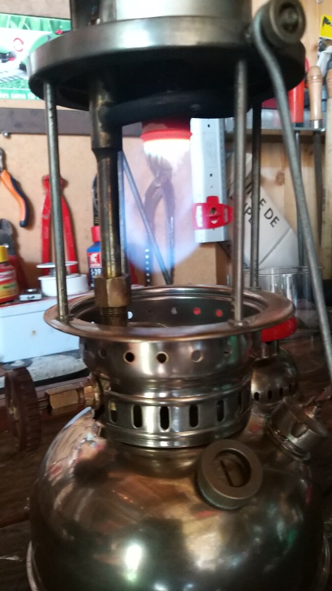

    Yesterday I received the missing parts from Fogas.se, first run :

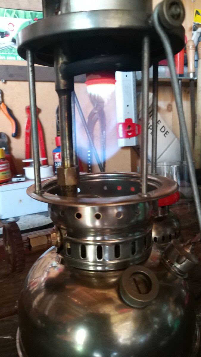

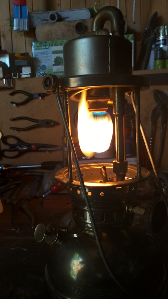

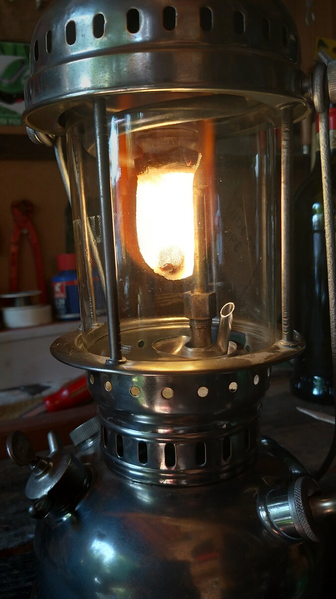

    "Hello Houston, there is a problem" !!!

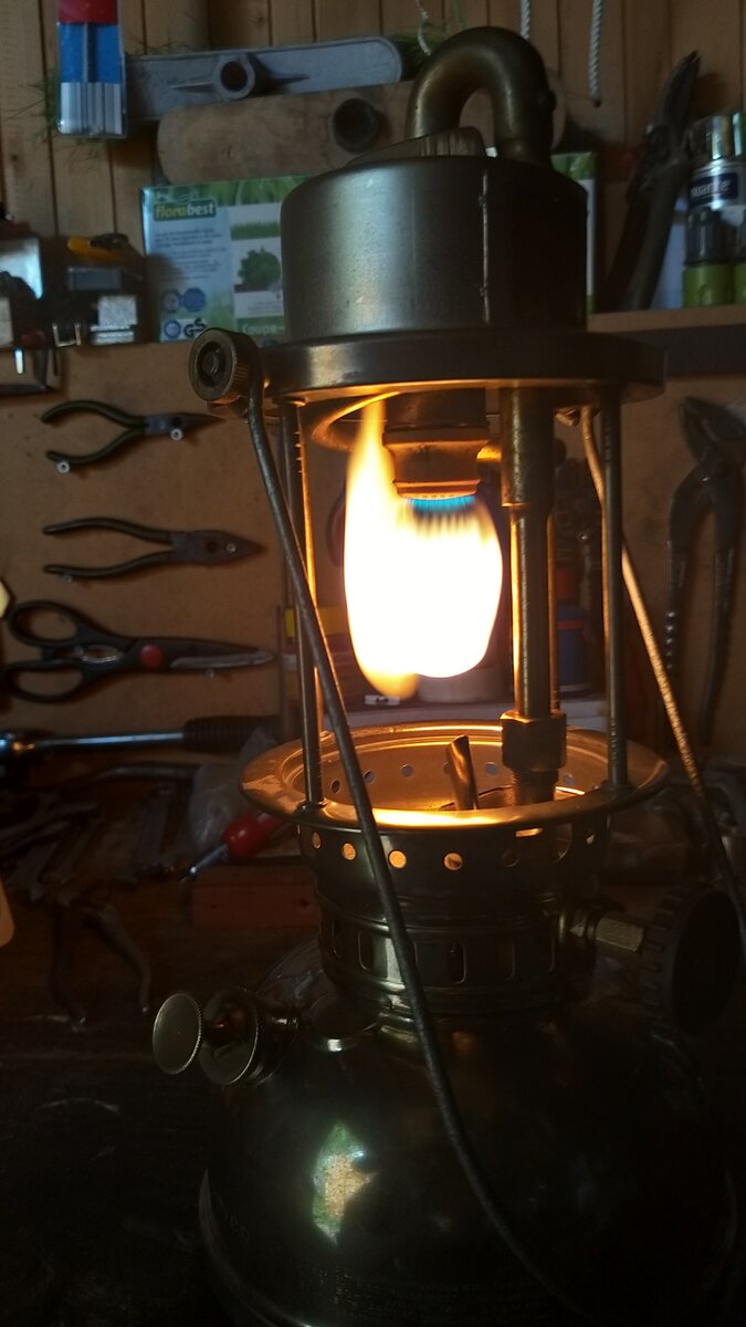

    A nasty hallo around the mantle, then a huge carbon deposit !!!

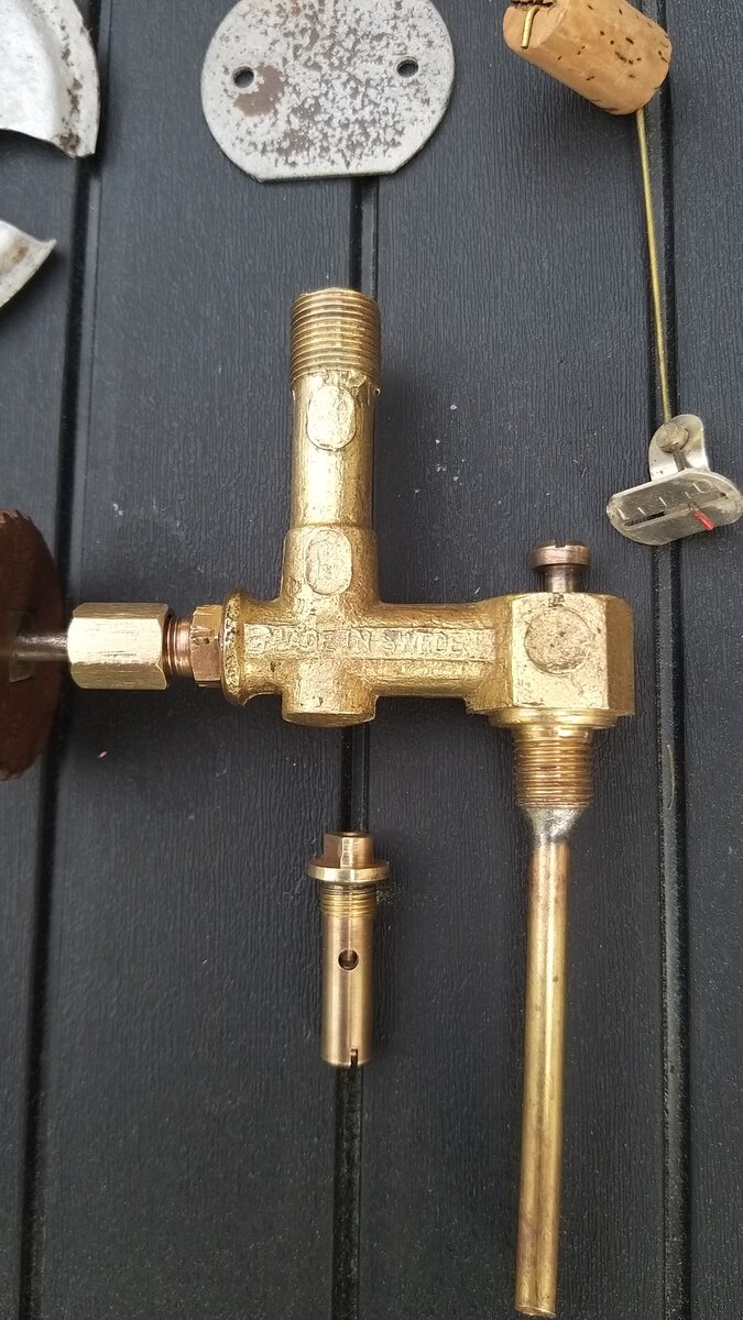

    After investigation, it turns out that the 200/250 CP jets supplied are calibrated at 250 CP.
    Not compatible with a 200/1200 CP Optimus burner.

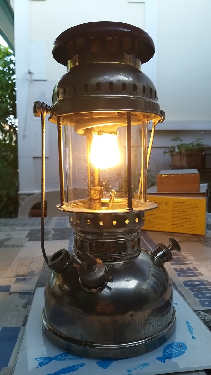

    With the right jet and needle, everything is back to normal !!
    A new rescue achieved.....
