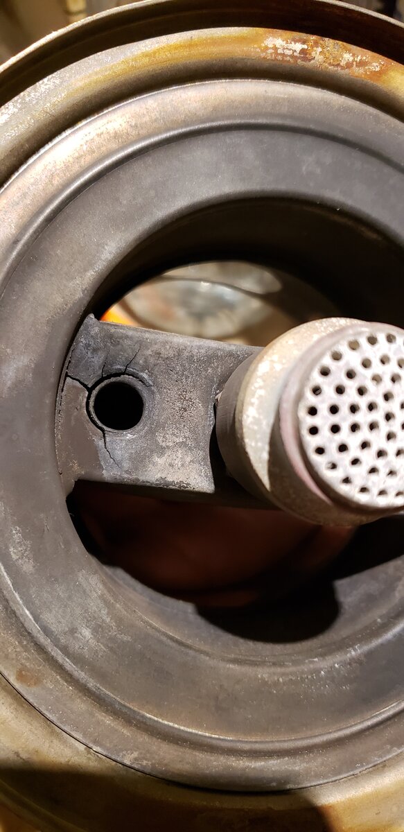

    I just received a Radius 119 today and unfortunately it has a cracked inner chimney which the seller neglected to mention.
    I'm guessing this can't be used safely until repaired / replaced?
    I ordered some JB Weld (high temp adhesive) to try and fill in the cracks.
  2. Henry Plews
    1,318
    Personally, I'd get it repaired before using it. I have no experience of any JB Weld products so can't comment on your choice. Have you considered silver solder, or are the cracks too wide ?

    The cracks are quite small. Unfortunately I don't have a blow torch or high content silver solder, just a soldering iron and fairly low temp solder - I'm guessing around 200C.
    Would using one of those old paraffin powered blow torches be sufficient?

  5. Nils Stephenson
    2,631
    I really dont think the performance of the lamp will be affected by the cracks, but it would still be a good idea to fix it. I would straighten things up a bit then silver solder it. Maybe you know someone who has the gear to do silver soldering.
  6. Rangie
    Rangie Subscriber
    Dec 8, 2012
    230
    I would agree with the thorough cleaning/light acid clean and silver-solder repair technique suggested.
    Perhaps you can find someone to do this for you.
    Alec.
  7. Mackburner
    6,290
    I would clean it and silver solder. JB Weld Extreme heat paste is supposed to be good up to 1300C. Not a product I have ever tried but may be OK for the job as I doubt the part gets much over 400c. A low temp solder will not work in that location as it will surely melt. ::Neil::
  8. george
    2,448
    JB Weld "might" work... that's a lot of heat though. I agree with everyone else, I would silver solder it. Regular solder won't hold it. I've been there, done that!

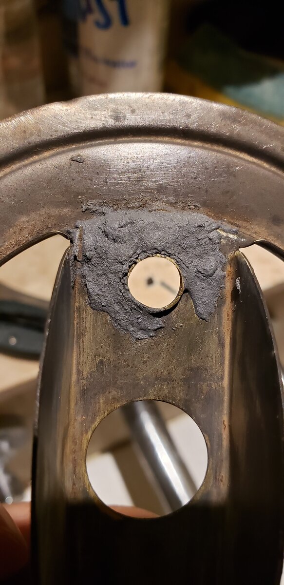

    Thank you for all the suggestions. Taking the chimney apart, I could see that the cracks were caused by pushing onto the top of the vapourising tube which seems to be half a cm too long, thus causing the deformation.
    Since the chimney part is fairly thin brass, I managed to push it back, however fitting it back in caused it to deform a little again.
    I checked the well where the vapourising tube sits and could see an old lead washer stuck in there but nothing else that would cause this issue, so possibly a incorrect replacement vapouriser or the gallery is a replacement and not long enough. The former seems more likely. The tube itself was slightly bent so I straightened it a little.
    Taking apart the inner hood, I could easily access the top of the hole and I used some of the JB Weld paste. It required 2 applications as the first attempt cracked after replacing the hood and caused some deformation:

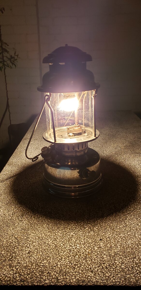

    I waited 12 hours and lit it. I haven't changed the existing nipple and needle, which seemed ok. It is very bright with a slight hiss:
    I will check the JB Weld after a few uses. And yes it is the extreme heat version which can tolerate temperatures up to 1300C.

    Tony - thank you very much for the offer. I fear a replacement would suffer a similar fate to the original part unless I can troubleshoot why the vapourising tube is too long.
  11. JEFF JOHNSON
    10,322
    Well saved!:thumbup::thumbup:
  12. Tony Press
    6,482
    It’s looking good, so far.
  13. AussiePete
    2,847
    Well done, looking good so far.
  14. george
    2,448
    Just wondering, would it have been even necessary to do anything with this other than straighten it just a bit?
