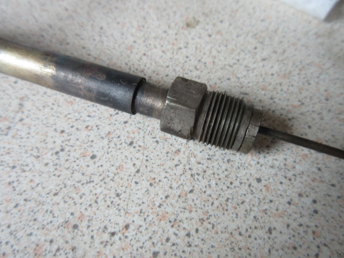

    Good day all.
    I've just started trying to sort out a 119, and in its history the cleaning rod has been broken off just above the eccentric block. Whilst it seems financially feasible to replace this with an aftermarket rod from one of the Korean chaps, I'm a bit stuck as to how to remove the remains of the old rod as it's stuck pretty fast. It moves but only a couple of inches. Can't tell if its soot holding it.... There's no needle in the holder, and no jet, but it's hard to decide whether it pushes up and out or withdraws at the bottom. Last thing I want is to break off the jet cleaner holder off the other end of the rod or leave it stuck inside somewhere... Maybe someone can offer guidance on all or any of the above please! IMG_3612.JPG

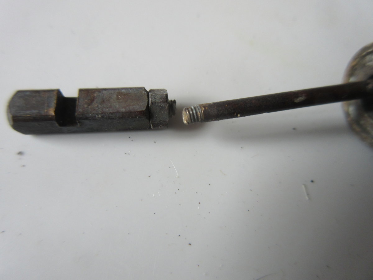

  5. Carlsson
    3,565

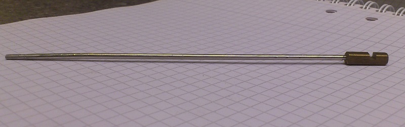

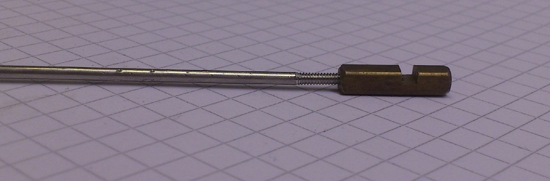

    Yes, the cleaning needle rod for the 119 is extremely easy to make. Anyone can make one.
    The threads are M2, though, so you will need to get an M2 die.
    I have made several of these out of a 2 mm stainless rod. The type you use to add material when TIG welding. They have different sizes, and 2 mm is one.
    Length should be 127 mm, and the threaded part at the bottom is about 8 mm. The upper part where the needle attach via the coupling sleeve is about 4 mm.
    It's most likely that sleeve that are the cause of your troubles in getting the rod out. Since it's much thicker than the rod, it tend to get stuck in the carbon deposits that has formed up in the vapouriser. It's just to keep on heating and quenching. Heating and tapping. And attempt to pull the rod. Eventually you will get it all out.
    Here's some pics of one I made out of the stainless pin. The locking nut is not attached to the excenter bloc. It's just to show the rod and it's tiny threads:
  6. ROGER BAKER
    ROGER BAKER Subscriber
    May 27, 2017
    72
    Derby, England.
    Thank you very much for the advice and the pictures. I've pal who worked at Rolls-Royce who has all manner of machine tools so he may well be able to help with a 2mm die.
    I wonder if you have a picture of the needle holder at the other end please so I can see what I'm trying to dislodge? I'm going to have another go at heating this up later. It struck me that maybe there are some deposits on that holder itself, and it might not have got enough heat on it as it was loose inside. I reckon if I get it "lightly stuck" at the obstruction, perhaps the heat transference might help if it's in contact with the outside. There is a join, and a narrowing in the vaporiser just above the gland nut, and I wonder if that's the internal restriction I'm struggling to get it past. Pic attached.

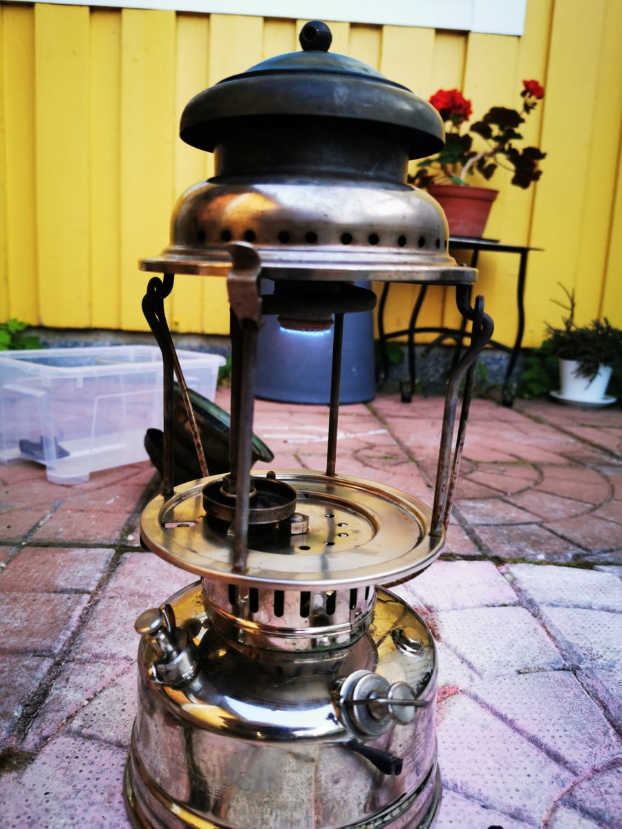

    Hi guys! I did it to :( break the rod, i mean.
    I know that the post is little older but... I was searching for wire 2mm and found that is seling also bras wire 2mm diam(about 4 usd/euro for 3m lobg wire, postage about 6-7 usd) . In this way is possible to make it as original.
    The other way i found, and is gonna be the way i go for now, is that the bicycle rod has 2mm diam. So i'm going to a bike repair shop and, maybe, i can make also the thread.
    Best regards, Frank

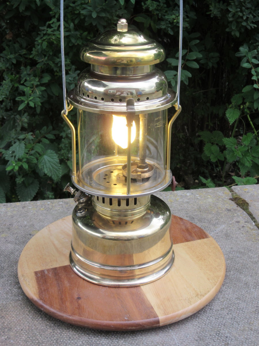

    Hello Frank. Sad news, but I think breaking them is seemingly not uncommon. Mine came broken, and without the jet or cleaning tip, so I had to buy those from love lantern in Korea. I also bought a brass cap as that was missing too, but from a different seller. I have a "tame" ex Rolls-royce engineer friend who made the new rod for me out of brazing rod. He turned it down slightly and used a BA die to thread it as he didn't have a 2mm one. Worked out very well, and I now have a spectacular golden oldie. I hope you find a way to get yours up and running. Love lantern does sell these rods if you get stuck.
    They have a most companionable "chuckle" unlike others that just sit there and hiss ! I'm getting more attached to them as time goes by and they don't guzzle paraffin as fast as some of my other regular choice, table centre pieces.
    All the best, Roger.
