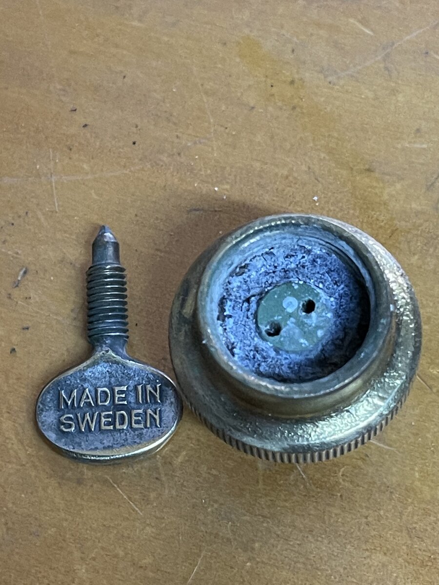

    Hi fellas I had this radius 119 proudly sitting on my top shelf in my office for a few years, it was a good find, no glass. I had bought jet , needle and the fuel cap pressure seals, I came across a radius globe the right size it has import on it,
    The lantern looked all brass, it had the usual patina and surface grime and dust.
    I would look at it up on my shelf and say I’ll get it going one day, so I did and here it is.

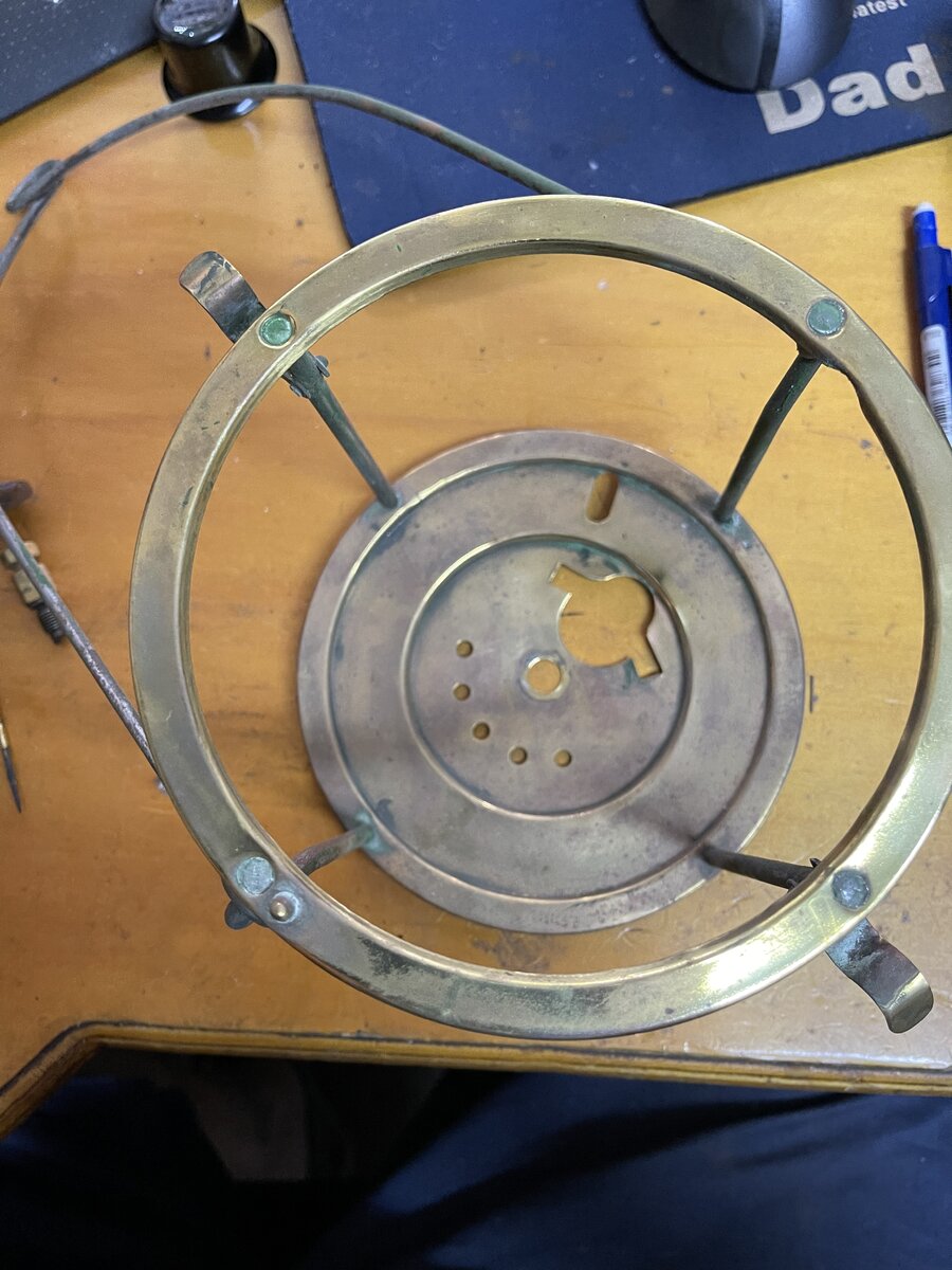

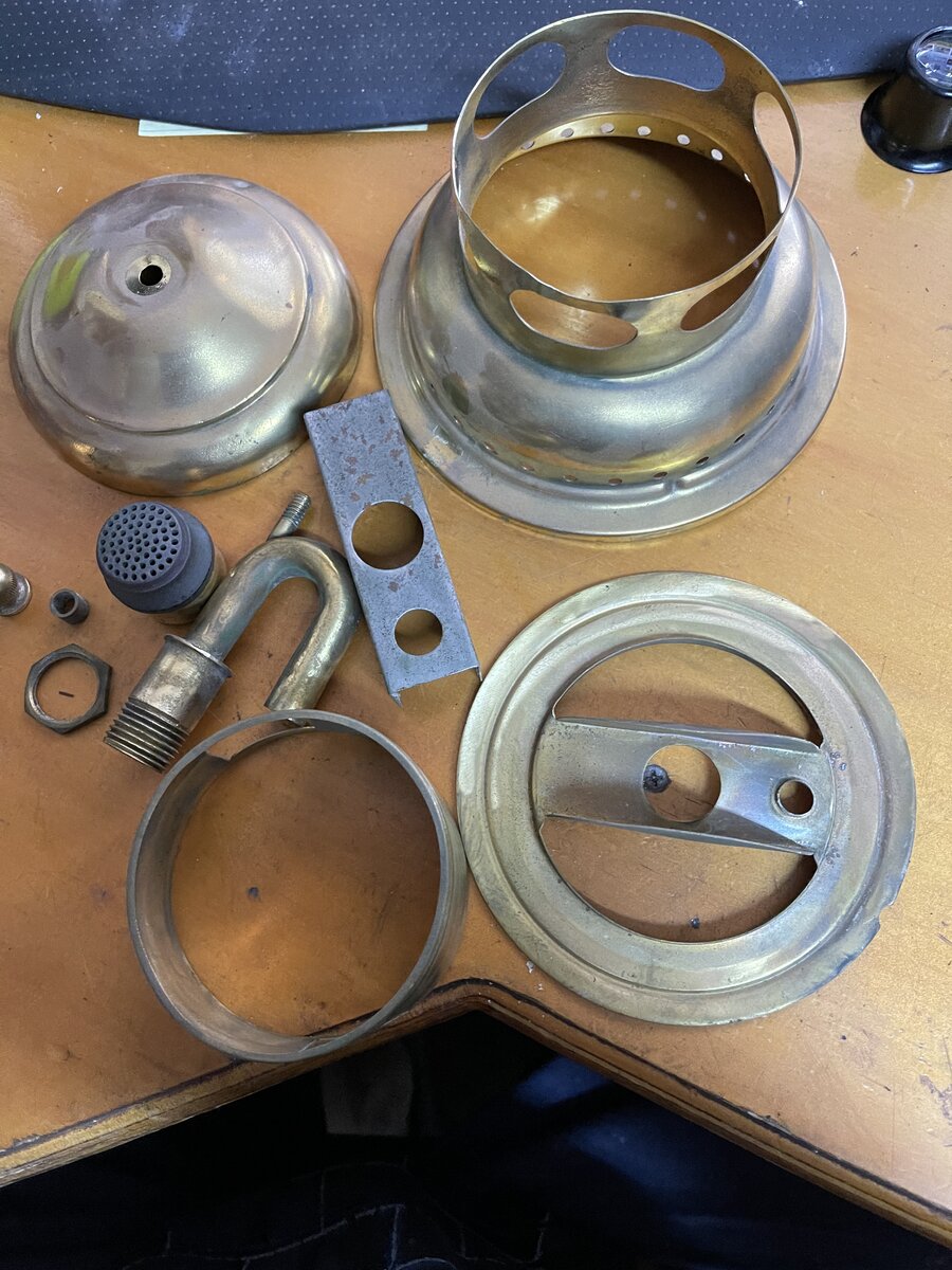

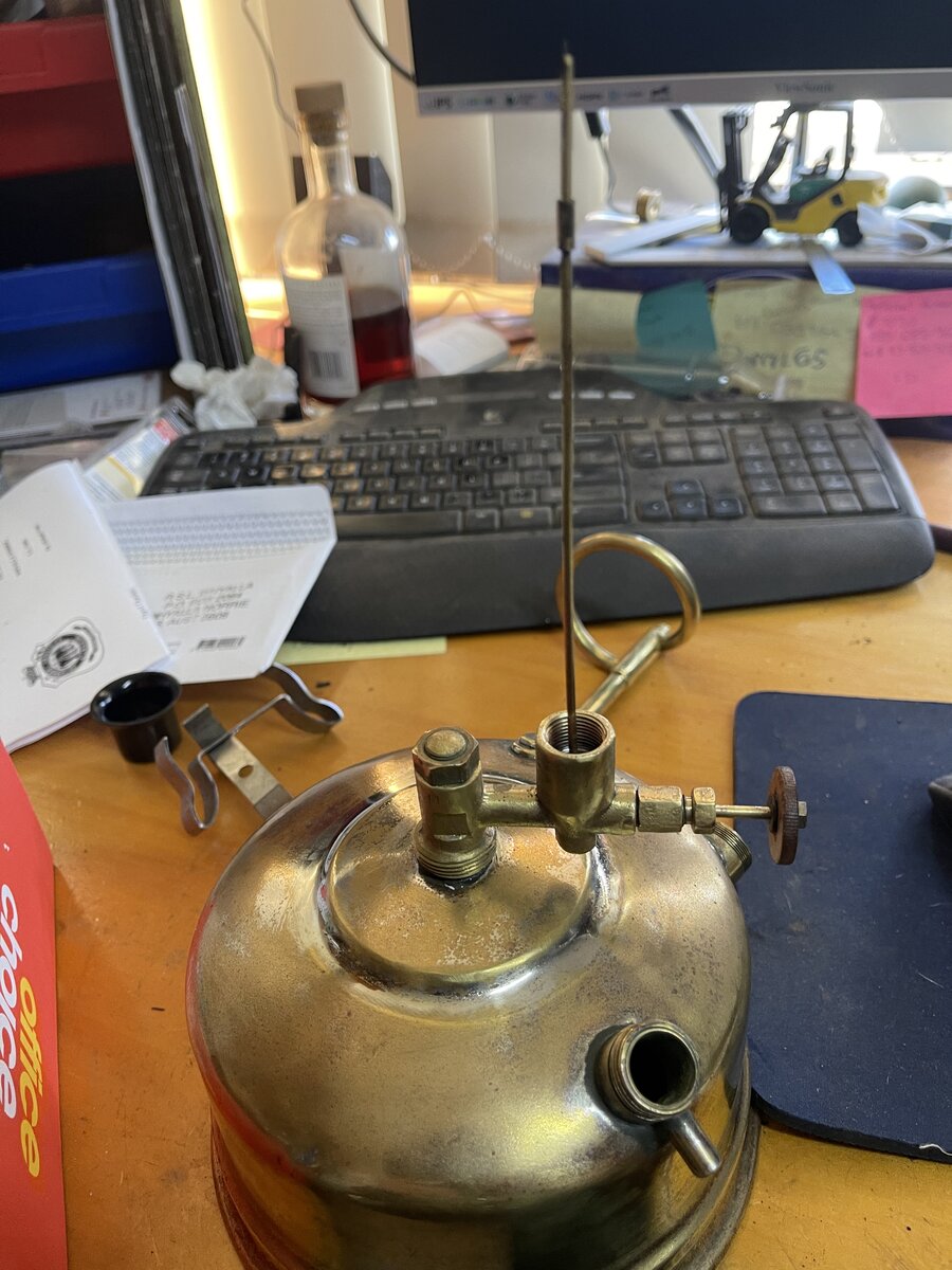

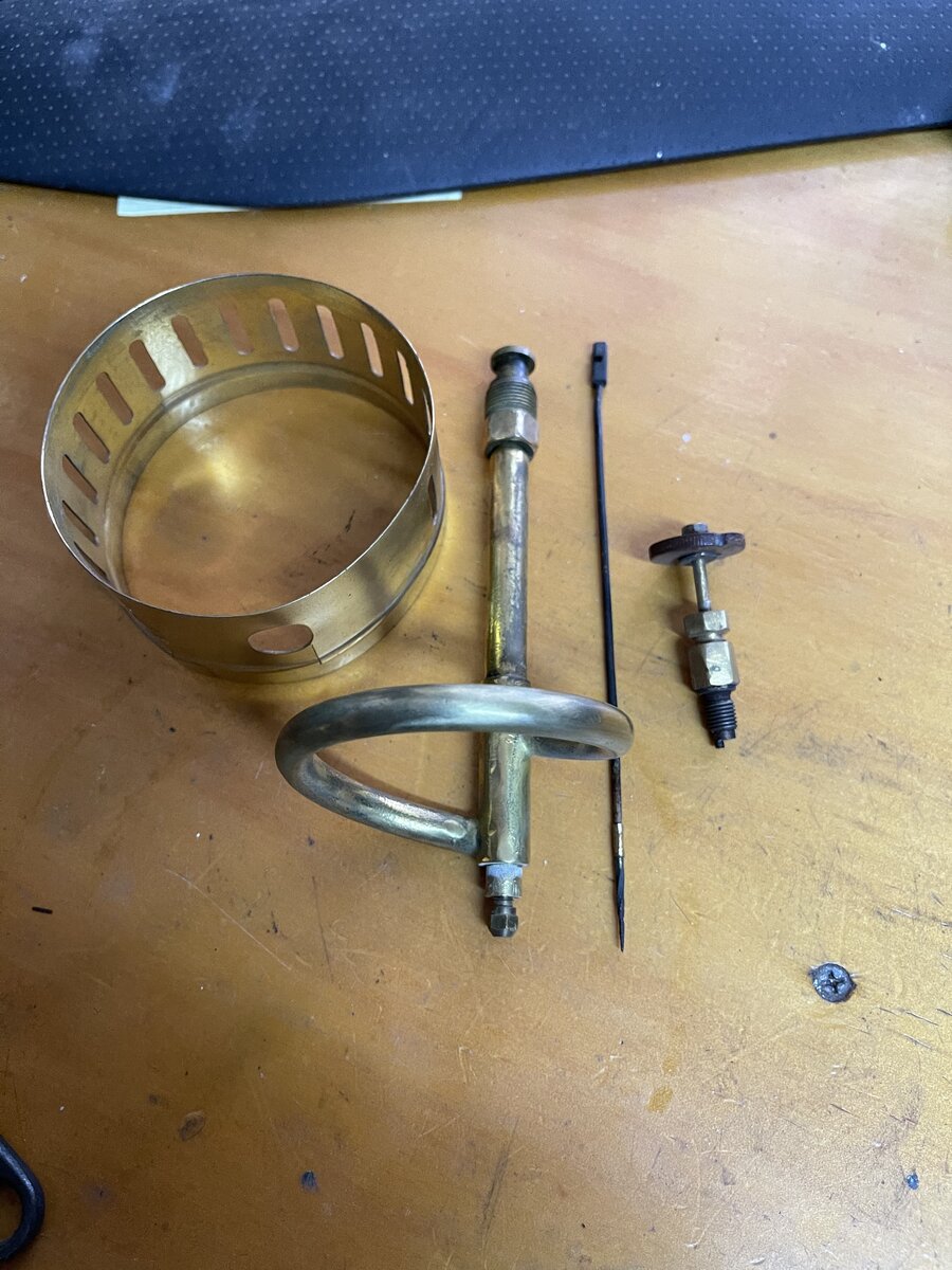

    I stripped it down. The parts I washed in hot soapy water, a bit of polish with 0000 steel wool, it all came up good clean with as much patina as found,
    89ED82A3-FDB0-4CC3-A1A1-7C245AE12B20.jpeg 77DD570A-169D-44D4-8AA9-F677C8F5536F.jpeg FA0FA681-7984-4F3D-A435-62348625D83E.jpeg CDB3F6B4-A800-43EA-843D-BF35D5FBC97F.jpeg AB74FC7F-EE5C-42EB-BBB9-27C9F30DF2D0.jpeg 4CB1A006-B552-47D4-9025-32C1281FA007.jpeg E898F163-5C37-4210-B448-7C99FF9900F8.jpeg 89C68767-6DC8-47C8-9538-8C9D9B529ABF.jpeg 8487453F-8DCD-4945-8D9B-ED21A5C96BEF.jpeg

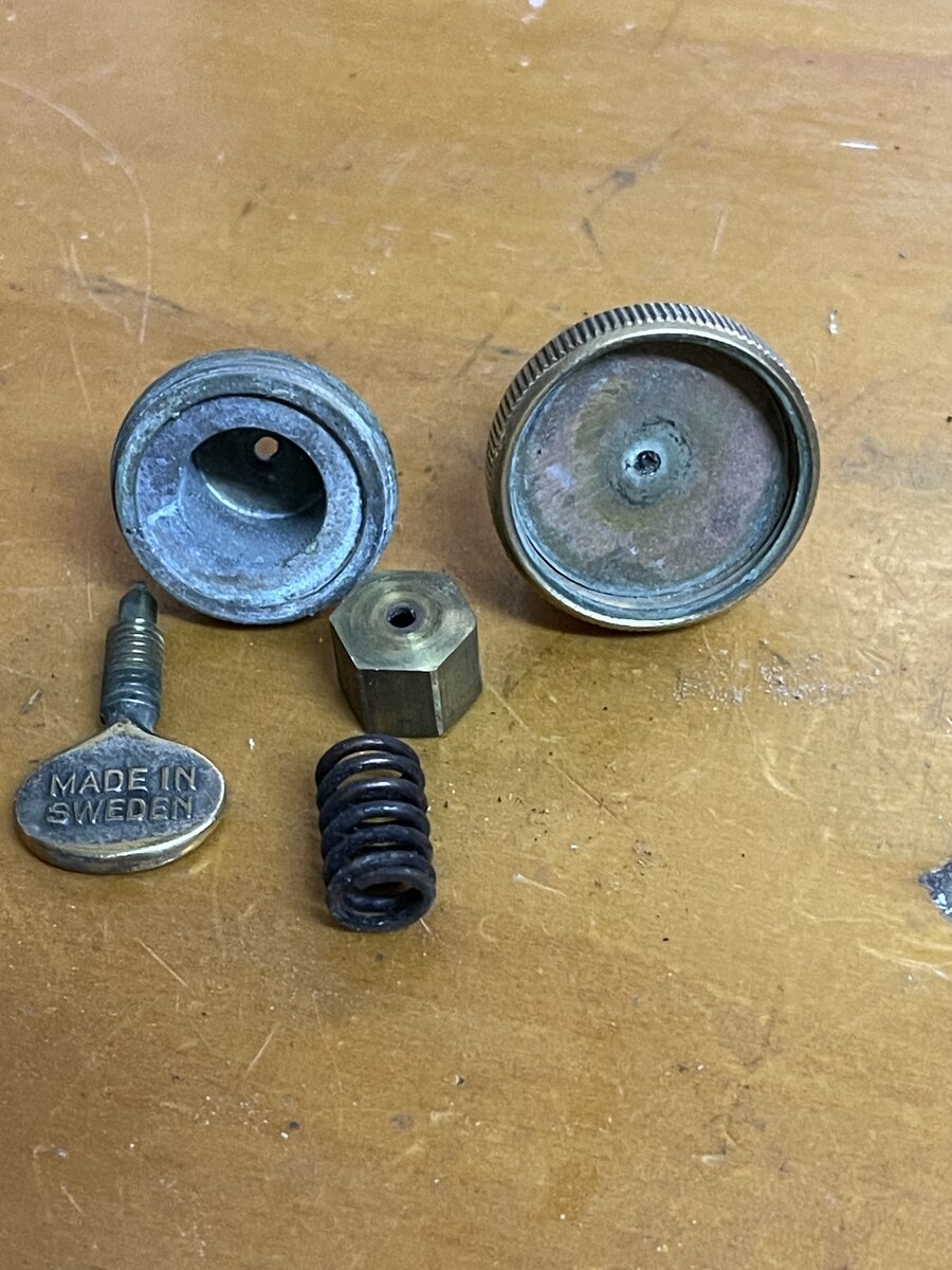

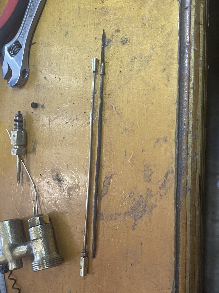

    the pricker was a bit out of the ordinary it has a spiral taper, I have not seen anything like it before. ABBA9285-2814-48E7-874C-422F8E972BA5.jpeg

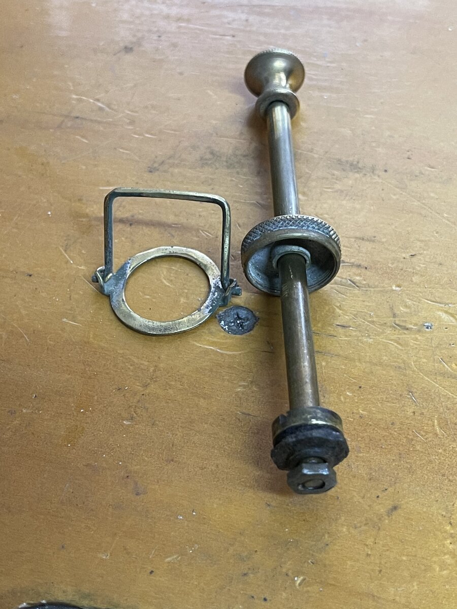

    The Preston loop generator was choked I lean it out with the heat and cool a few times, the I used a long drill to drill it out it was quite blocked. I used break cable to clear as much as I could from the loop.
    I used the original eccentric block a pricker rod from an 1 A Aladdin perfect for the job.
    new pricker and jet.
    I maid a new generator seat seal from lead, new graphite packing in the pricker control
    some fine tuning on the pricker length, the reassembly went well.

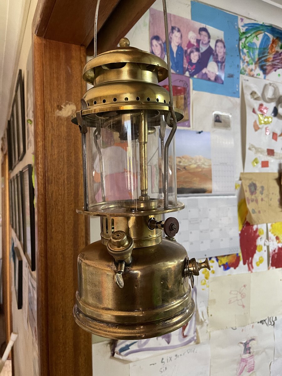

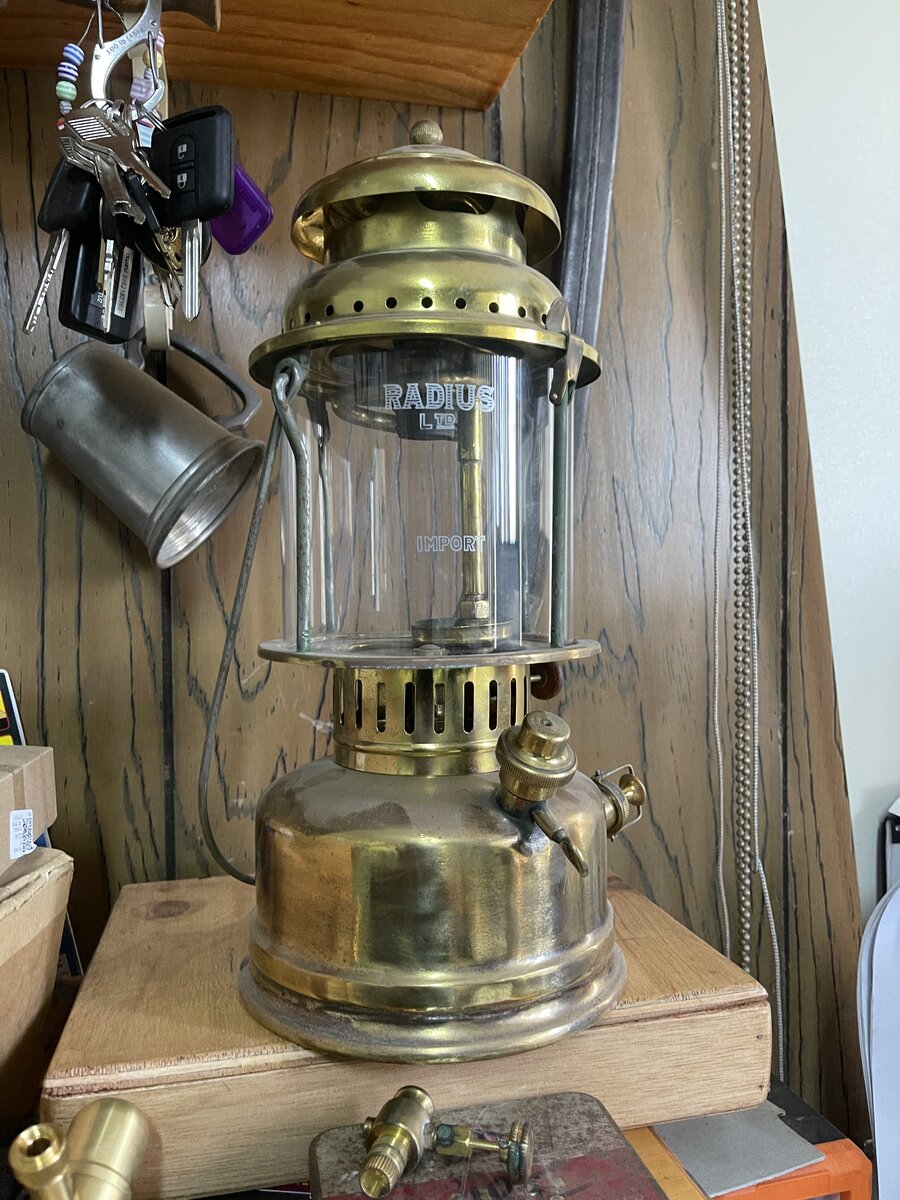

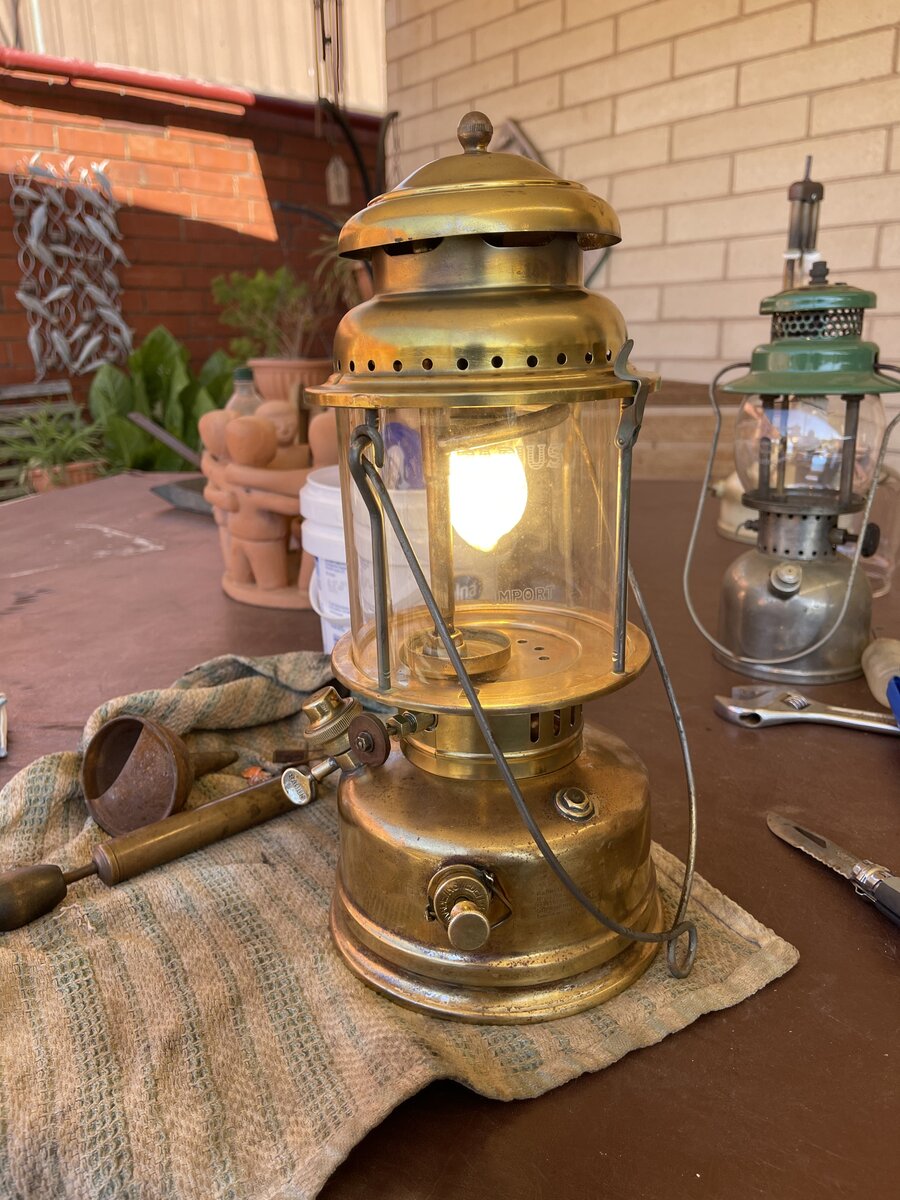

    Finished looking good, dunk test was good.

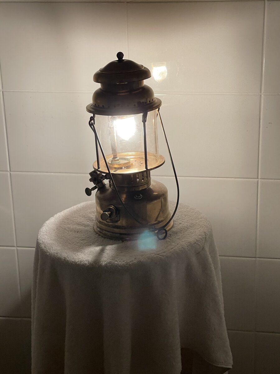

    test run B662356F-0E7D-4BAF-A9E9-C94C5ABF5F65.jpeg 8A2B7F91-826B-494D-8474-19106697F594.jpeg
    the money shot.
    Very happy with my work, learnt about new pricker being different, there was either a disaster or someone has good work skills.
    A very cool bright lantern in my collection C6857839-268B-49B5-99BC-22E3CD81467D.jpeg
