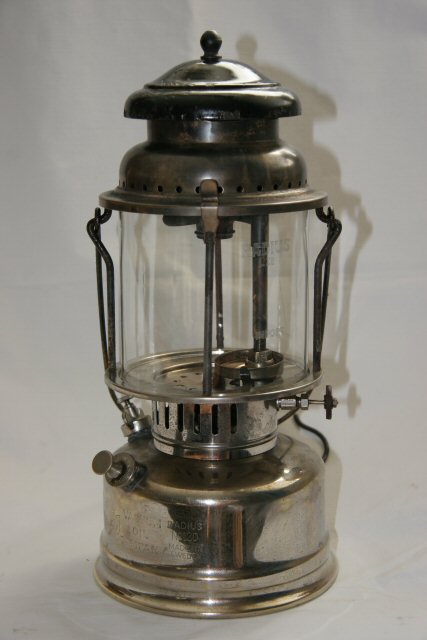

    This is a lantern I acquired recently. A Radius 120 in itself is not very common, but this one had stamping on the tank that looked interesting. It turns out it is made for the Sunflower Vacuum Oil Company. I had never heard of this company, but found some information over at CCS here.
    This lantern is in reasonable condition and has most of the usual 120 features such as the black enamell top hat, the small loop in the handle with a hook, no locating pin for the hood on the globe cage top edge and the pump mounted on the 'edge' of the tank. Unfortunately it has had the vaporiser replaced with one from a 119 at some time. Probably a sensible modification from a users point of view.
    The lighting wasn't the best for these photos, but hopefully you can see the relevant features. The lantern is fitted with a 'modern' Radius glass for the photos.
    1305569536-Radius_120_Sunflower_front.jpg 1305569545-Radius_120_Sunflower_back.jpg 1305569556-Radius_120_Sunflower_logo.jpg 1305569564-Radius_120_Sunflower_logo_left.jpg 1305569572-Radius_120_Sunflower_logo_right.jpg

    From what I've found, Vacuum Oil Company (of New York) sold their kerosene under the name 'Sunflower'. The company merged with SOCONY (Standard Oil Company of New York) in August 1931. I'm not sure if the Vacuum Oil Company name continued after this, but I don't think so. That would put the date of this lantern at 1931 or before. This fits with a Radius 120, which I would expect to have been produced in either 1930 or 1931.
