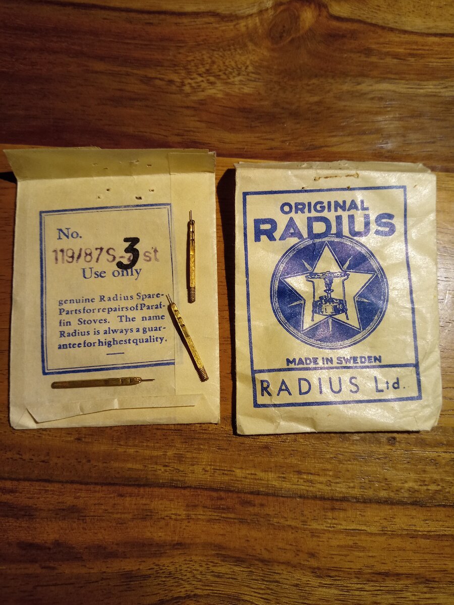

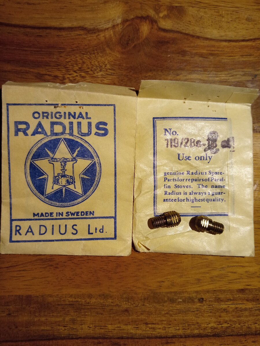

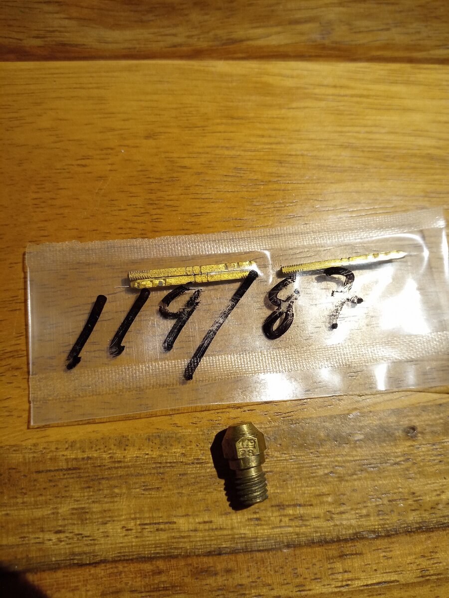

    Last year I bought some strange looking jets with horizontal cuts (these are not threads). Now I have a Radius 119 spare kit and these jets are for Radius 119 Spirit – part no. 87S in paper envelope.
    Needles for Radius 119 Spirit were included as well – part no. 28S in paper envelope.
    Petroleum jet and needles were in plastic (no. 87 and 28).
    Spirit and Petroleum jets are clearly different, but also needles can be recognized - petroleum have additional three cuts in the middle.

    The outside threads, on the top side, on the alcohol jets are for the restrictor to screw on to
