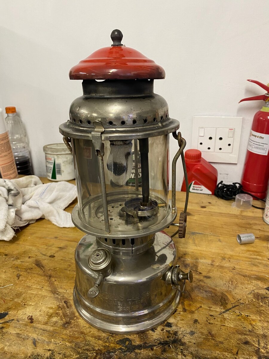

  1. Pdebruyn
    Jul 26, 2020
    7
    Namibia
    I have been fortunate to buy this well-used, but cared for Radius No. 119 (300cp). The glass is original and it appears complete. I have dismantled and cleaned it out of old insects nests. The pressure release valve was opened and cleaned and appears in working order. I have fashioned a new leather plunger washer for the pump that works. The pressure release valve was found to be leaking air between it and the tank, so I installed a fiber washer that has cured the problem.
    I am still using a double-tie mantle as I have been able to find a single-tie mantle. May this be the reason for the lamp failing to start up? It burns softly with smoke.
    Could the reason be that the lamp is getting too much fuel to the mantle? The jet hole is open. I suspect that the red adjustment knob or the needle inside the generator may not be set up correctly.
    What is the correct sequence to starting up the Radius?

  2. Fireexit1
    1,618
    Welcome.
    I am no expert in Radius lamps but they follow standard lighting procedure. Pre-heat with Meths/Alcohol with vent open. When heater flames just dying down close vent and pump. Should go "pop" and light up.
    Chris
  3. Henry Plews
    2,056
    Hello @Pdebruyn and welcome to the forum.
    A double tie mantle will be O.K. but the bottom string must be tied as tight as possible so that if there is still a hole, it is only very small.
    Yes, it is possible that the lantern is getting too much fuel. Usually, this is because the hole in the jet has become enlarged. The red wheel is not for adjustment, it only works the cleaning needle. When the notch in the wheel is at the top, the needle should be down, when the needle is up there should be between 0.5mm and 1.0mm poking through the jet.

  4. phaedrus42
    phaedrus42 Subscriber
    2,019
    What Chris says. Fill fount with paraffin. Fuel cap closed, pricker control wheel down, air release screw open.
    Fill alcohol pre-heat cup (ring shaped) with methylated spirit from a spirit dispensing bottle with a spout and light it. Wait until the spirit is almost burned out, close the air release screw and then start pumping slowly and steadily. The lamp will light. Continue pumping until the lamp burns brightly and the hissing sound becomes a bit louder. This could take approximately 30-50 pump strokes. Rotate the pricker control full circle quickly to ensure the jet is clear. The pump uses a standard primus stove type leather cup and non-return valve.

  7. Pdebruyn
    Jul 26, 2020
    7
    Namibia
    Thanks all! Will try the process again, I suspect I have also not build enough pressure. With the pressure release safety valve now cleaned and checked I should be OK. The cleaning needle does not protrude when I turn the pricker control. Is the needle assembly adjustable in length and should one try?

  8. phaedrus42
    2,019
    The needle may be bent over or could have broken or rusted away. Unscrew the jet and have a look. The Radius quality control and parts tolerance was quite good so all needles would have been very close to the same length when new. You can screw the conducting rod in and out of the eccentric block but you would not normally need to do that when changing needles. You will need to remove the upper vapouriser and also the control wheel assembly from the lower vapouriser to take out and adjust the conducting rod assembly length.

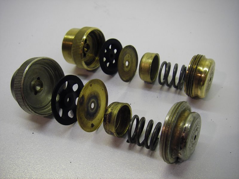

    My most immediate problem is that I have managed to break the plastic "washer of the filler cap/pressure release. I have two questions:
    1. Is it possible to make one? I would not be close to a place that stocks spares
    2. IS the sequence and position of the parts correct in the photo. "Note to self: take pictures as you take things apart!"

  18. presscall
    681
    Lancashire, UK
    @Pdebruyn
    Since contributing to that post on CCS on Radius seals and after swapping thoughts with BernieDawg on the topic, we’re agreed that the seal needn’t be ‘dished’. They’re likely to have been punched out of flat sheet and ‘set’ or harden into that shape as a result of heat and pressure following extended use.
    (Those black discs with the radial holes in my photo)
    John
  19. Nils Stephenson
    2,874
    Well I make them out of 1mm flat sheet and they work fine. The spacing of the holes might be a bit off, but it still works. I think the important part is that the brass shim is still in good condition. I have seen some where it is cracked and falling apart.
  20. Pdebruyn
    Jul 26, 2020
    7
    Namibia
    Hi all. Been a while but my Radius No.119 service kit finally arrived. Most issues now resolved. The problem still remains that even with new jet for 300cp lamp fitted, I still get flames outside of the mantle, it burns with a sort of "halo". Several different mantles does not solve the problem. Included in the service kit I received a graphite type bush, about 5mm in diameter and 5mm high. Where does this go?
  21. phaedrus42
    2,019
    Have you made sure that the upper vaporiser is clean inside, including the preston loop? The halo can be because of poor vaporisation due to a blocked or partially blocked vaporiser.
    The graphite ferrule fits around the pricker control spindle inside the jamb nut.
  22. Pdebruyn
    Jul 26, 2020
    7
    Namibia
    Radius is up and running. The generator loop was completely clogged. Had to drill 2 holes to clean the carbon out, both the holes were closed with brass plates brazed over.
    How would one go about determining year of manufacture for a Radius 119? Picture of lantern is earlier in this thread/discussion.
  23. Fireexit1
    1,618
    Well done sir! Pictures of it running in the lamp action gallery always appreciated :thumbup:. A close-up of your drill/patch fettle might also be of interest I think.
  24. Nils Stephenson
    2,874
    Going by the picture, it is from the first half of the 1950s.
