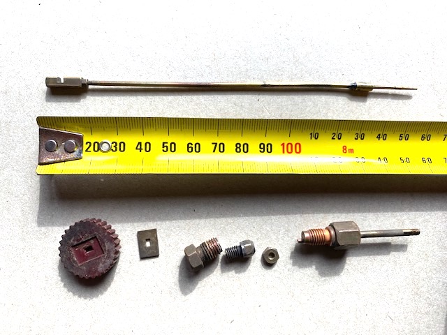

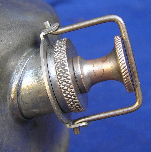

    Been trying to identify this... looks like a Radius?
    [​IMG]
    I rather like it, dunno why. Only problem is that the pricker is U/S. I'll need to either repair it or get a replacement (hen's teeth?).
    Shall I enter the arcane world of pricker-fix?

    Oooh yes they're SO similar, maybe it's an Aladdin. Strange that there's no branding on it. (Not that I can see anyway).
    What should I do about the pricker? I have 008" guitar strings, but maybe that's a thou or two too big.
    8,988
    @Julian Whittaker
    Late model Aladdin 1A have a decal on the tank that can disappear through use, cleaning etc.
    Can you photograph the whole pricker rod and pricker, and the pricker itself in more detail, please?

    Here's a pic. The pricker end (about 25mm long total, -about 20mm showing in pic), has a very fine thread, so it can be unscrewed and removed. And obviously the fine wire needs to be present, which it isn't.

    That looks like a homemade pricker wire. In my A1 the wire just screws into the rod and doesn't look anything like the above.

    Well, there's no evidence at all of 'home-made' alterations. All looks pretty unbodged under the magnifier.
    You say the "wire just screws in..." -Do you mean the wire holder section screws into...etc? Mine screws in, it's just missing the actual pricker wire right in the end.

    My thinking was the wire holder in your photo was used as the pricker wire because the end looks so sharp. I thought the previous owner had simply improvised a wire.

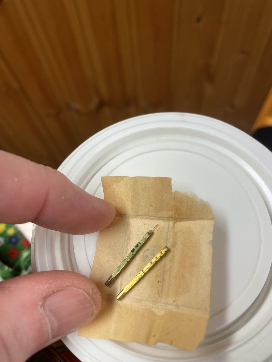

    5D8B1CA7-800E-4496-AF11-1965F9E82919.jpeg 9FB1CBFC-8BD7-4EF5-B425-3D76D4EC8AB4.jpeg
    The pricker needle for the Radius 119 looks like this.
    Regards Matti

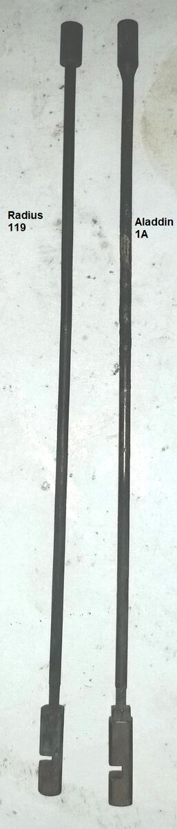

    Julian, The pump is in the wrong place for a Radius 119. It would more in the side of the tank.
    The Aladdin 1A is more in the top of the tank, as is yours.
    The pricker rod to pricker is braised onto the pricker rod. On a Radius 119 it is only screwed on.
    On the Aladdin the brass section of the pricker is 25mm long where the Radius is 22mm long.
    The thread on the Aladdin 1A pricker is 9BA

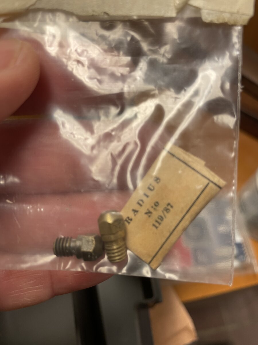

    I’ve just measured the pricker wires on new Aladdin prickers made by TW Sands and NOS Radius 119 prickers, and found out something very interesting:
    1. The Radius pricker wire is 0.18 or 0.19mm (depending on stock) and WILL NOT fit NOS Aladdin 1A jets (too big).
    2. The pricker wire on the TW Sands Aladdin 1A prickers is 0.15m and fit the jet.
    I’ll have to dig out a Radius 119 and check its jet.

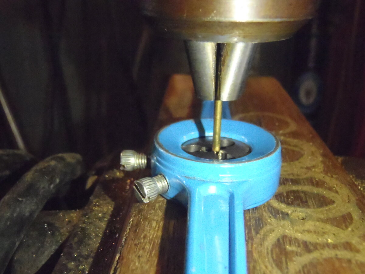

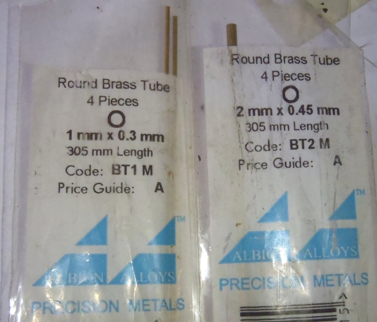

    I have used these tubes to make replacements for Aladdin 1A
    2mm dia with wall thickness 0.45mm
    The 1 mm dia tube slides into the 2mm to reduce the centre diameter to approx 0.4mm. If you want to reduce further use a 27 gauge hypodermic needle inside the 1mm.
    To start and keep the taping running true I mount the 2mm brass rod in a drill press and lay the die flat on the bed. I then turn the chuck by hand.
