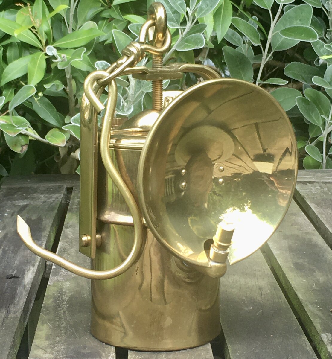

    This was a smaller project, a carbide lamp reflector, during plating.

    So I have a couple of questions @presscall : Did you grease/wax the back of the carbide refelctor to stop deposition all over - or was the way you kept the electrode local and close good enough ?
    The second question is how much polishing did you have to do after plating ?
    best
    Chris
  8. podbros
    2,808
    @Fireexit1 I think he said that he lacquered the reverse to help matters?
    ..swirling the solution around with the electrode in a sort of slow-motion gold panning effect, I imagine?
    : edit : actually it was the small reflector for the carbide lamp that was lacquered, so I don’t know about the Bialaddin..
    I presume that he just had electrolyte in the reflected side.. using it like bowl and carefully swirling it around..
  9. presscall
    1,026
    Lancashire, UK
    @Fireexit1 I didn’t use grease or wax, the reflector was lacquered at the factory front and back and I’d to use paint stripper on the reflecting surface before cleaning and polishing it. I think if I had to mask a component I’d use lacquer, because I’d have concern that the electrolyte and currents in it might lift grease or wax and contaminate it.
    The plating only took place on the reflecting surface of the Bialaddin reflector because that was the only side bathing in the electrolyte.
    Polishing? None on the reflectors, just a wipe over with a clean cloth. @podbros’s description of gold panning is very apt and the gentle agitation of the electrolyte and slow movement of the nickel anode evidently produces a shiny finish.

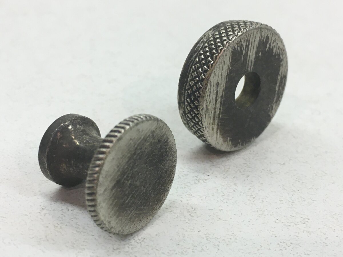

    My first efforts were on a Primus stove pump knob and cap and I had the anode fixed in the jar of electrolyte the components were suspended in.
    I also overdid the duration necessary to plate them, half-an-hour when seconds or a few minutes (depends on the proximity of the anode) is all that’s required. The plating layer was deeper than it needed to be and the parts came out of the plating jar looking like this.
    They polished up nicely though, but the ‘gold panning’ technique saves the bother.
