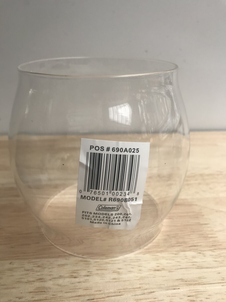

    This technique is not likely to be required very often, and has limited application, but it is useful for Austramax owners.
    In this thread I pointed out that the branding on modern Chinese-made small Coleman bulge globes can be removed using dilute acid.
    Note: The branding is printed, not acid-, or mechanically-etched.
    Here is the technique:

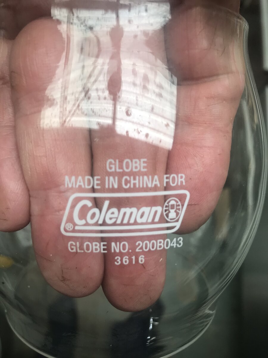

    Printed branding.
    Batch number.
    Printed branding.

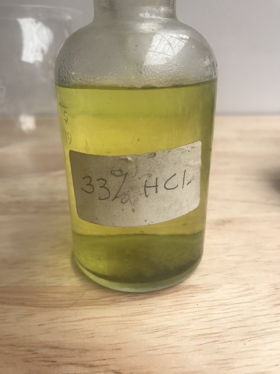

    33% Hydrochloric Acid.
    Dampen a cotton cloth with the 33% HCl, and rub the printing, keeping it wet, until it is removed.

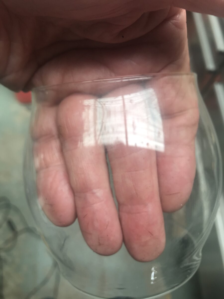

    If you can still see the “ghost” of the printing on the glass, use some slightly abrasive polish like Austosol to polish the glass to clear.

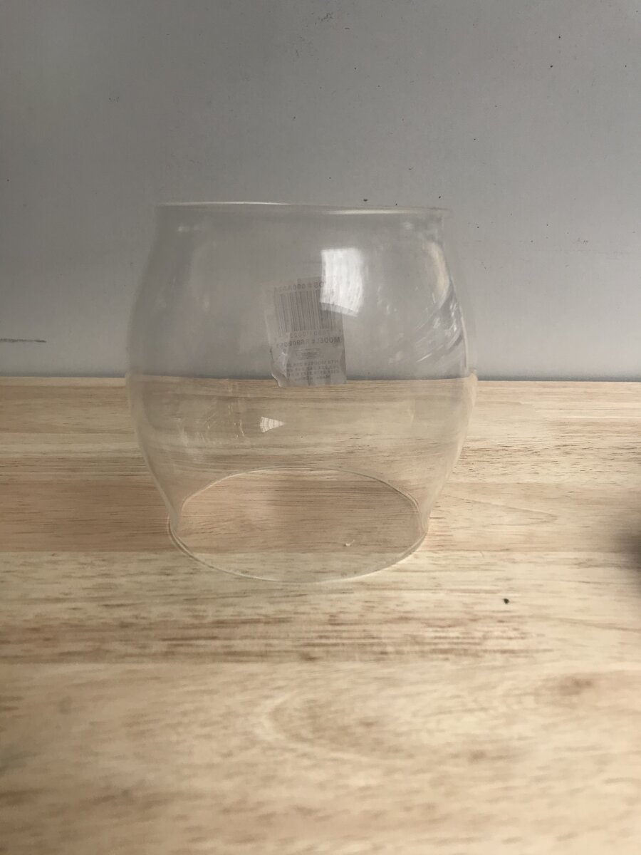

    Final result.
