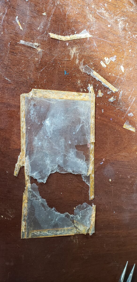

    I got an old mica globe from a 1001 lamp but one of the panes were broken.
    I decided to try and replace it myself.
    I used a scalpel to widen the gap between the metal strips:
    Freeing the broken pane:
    Gaps:
    I then cut a new mica sheet to size. It was sourced from Stove Mica and the sheets were a bit thicker than the original. I'd probably request thinner sheets if I were to do this again.
    Fitting was not easy. Unfortunately I could not get the corners in on one side. I noticed the old sheet had a notch in the corner, presumably for this reason
    Nonetheless these are on the inside of the globe and so not very noticable.

    What exactly does that notch look like?

    Thanks for the encouragement everyone. I decided to post my efforts as I've not seen much online about replacing a mica pane and thought I'd give a little back. Apologies if it has been covered here previously.
    The notch is in the 4th picture where I show the completely removed broken pane. The notch is just the top left corner.
