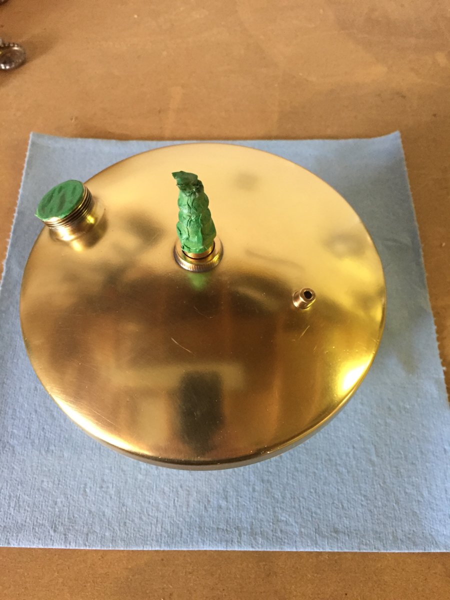

    I have done a lot of work on both the TL120 and the ML93s. Guess the big question of the day is what to use to protect the polished finish on the brass without clouding it up. As shown on the bottom pics, I achieved a beautiful finish on the brass top, until I sprayed it with a Gloss Clear Lacquer, then the finish became very cloudy. I was very disappointed to say the least. I have already stripped the lacquer off one, which is no easy task, even with commercial grade stripper. Please feel free to criticize and express your thoughts. I may try automotive clear coat once I get back to town. The problem is, if that doesn't work, that will be even harder to remove. Maybe I should just strip the clear, polish and leave it. Then use metal polise every month or so to keep them clean.

    OK so that works, these are the 3 lamps I currently have. I found them in the shed of the old house we recently purchased.
    The TL120, I purchased a new burner and gallery, and also a control knob and have that one working.
    I stripped the paint off the bases of the ML93s.
    Painted the base.
    Polish the top to a high shine.
    This is where the major disappointment comes in. Not impressed with the shine from the Gloss Clear Lacquer. What are people using to protect the high gloss polish of the gloss?
  4. phaedrus42
    phaedrus42 Subscriber
    1,643
    The lacquer looks cloudy in the photo, almost like a matte finish. Did you remove all polish residue from the brass with solvent before applying the clear lacquer?

    An alternative to clear lacquer is to wax the brass with good auto wax. It will seal the brass and preserve the shine for a long time. You'll have to apply more wax after alcohol and kerosene spills though.

    Phil, I know, I was so disappointed. Lots of sanding and polishing to get most of the bigger scratches out, at least the hard work is done, with a lot of patience I should be able to remove the lacquer. I have a piece of brass at home, guess I should have practiced on that first. lol

    I use automobile clear coat on lanterns stoves and lamps that will be ‘users’ (the brand here is “Dupli Color”). I bake the finish at 94C. That leaves the brass protected from spills.
    I also use high quality car polish on bare brass and over clear coat.
    Sometimes I’ll use furniture-grade beeswax on bare brass.

    Hey Phil, sorry I didn’t answer your question about removing all the rubbing compound before spraying, I did, I used automotive grease and wax remover and then washed them in warm water with a little dish liquid. They were gleaming before I sprayed them.

    1. I bake for 1 hour at 94C and let cool in situ.

    I wouldn't be concerned about the finish being cloudy. It can depend on how much humidity there is when the clear is applied.
    All you need to do is get a clean, soft rag and polish the clear coat as you should always do. That should bring the clear coat to a nice clear glossy finish.
