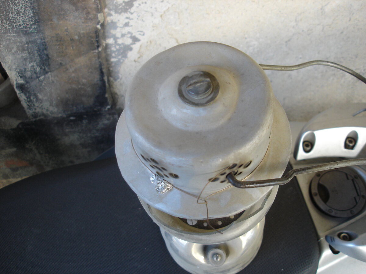

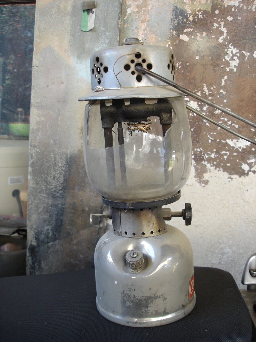

    While walking around town, I noticed a pile of junk in front of an old woodworking workshop, in it was what looked like a pressure lantern. I asked the owner and got home with this poor Canadian 243B that has had a hard life for sure.
    Group shot with my 282. (Hope you are all jealous of my sewage plate)
    Looks like it had the old tin foil reflector hack done at some point. Out in the trash it went.

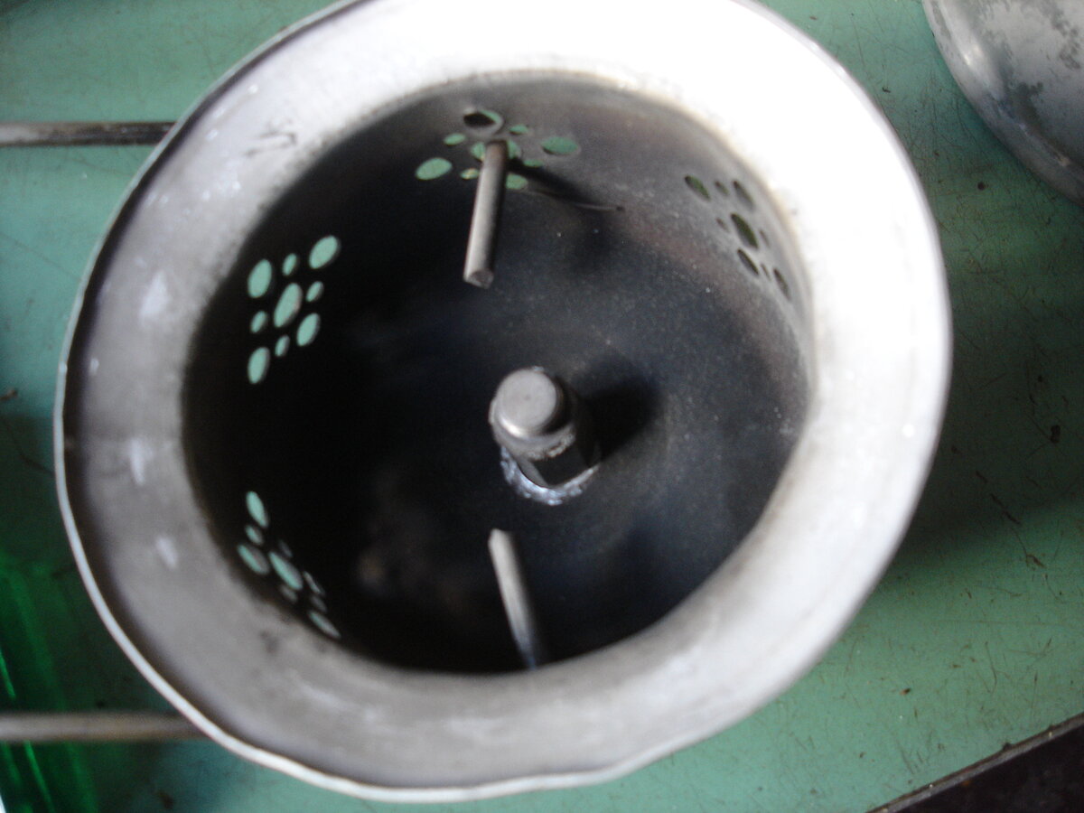

    The ventilator is bent to the point of it being concave, to accommodate the taller globe.
    So the globe is not original and broken, it looks one from a wick kerosene lantern. I Have a type 550 globe laying around. That should fit, right?

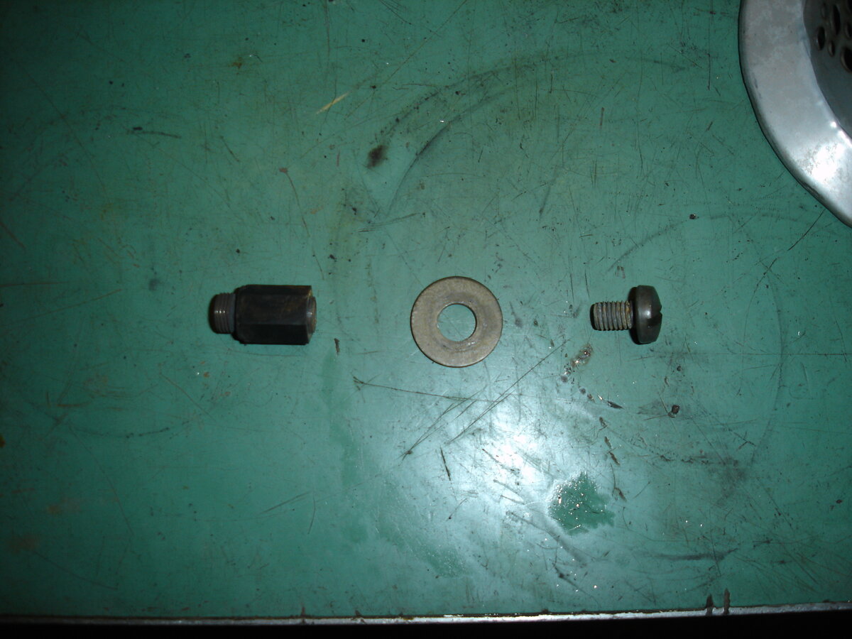

    Also, the ventilator screw goes in this nut/extender thing that screws in the burner. I tried to bend the ventilator back but it still does not secure the globe, by far. Could a 243B owner take photos of the ventilator mounting please? It seems that every photo or video on the web omits this point.

    Thanks everyone, I did more tickling with it and found that if I screwed the weird nut above the ventilator, it looked about good 'nuff for a small country like ours. I tried it with bad pump gas and Lo and Behold! It lit strong and well!

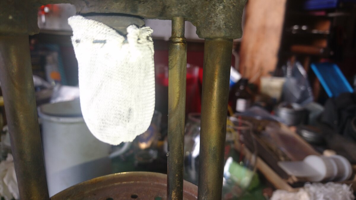

    After time, the generator started glowing red near the mantle, is it normal?

    Can you photograph the generator (cold) where it was “glowing red”?
    Did the light output change?
    You need to give the burner a good clean and make sure the air tubes are clear.
    I wouldn’t use too much ordinary automobile gasoline in that lantern. It will end up clogging the generator.

    Thanks for the answer, here is the photo. You can see the spot just beside the mantle. No output change whatsoever DSC_0083.JPG I already gave it a clean before. I did not see any blockage. I need to find a source for white gas, not very common here.
