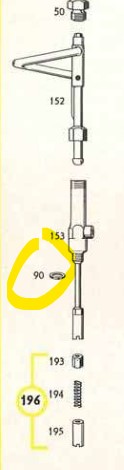

  5. spiritburner
    spiritburner Admin
    1,243
    N.E. England
    Is that part no:90? If so PM me your address & I'll send a couple out. Pretty sure I made a batch a year or so back & forgot about them. You can have them for free - just tell me if they worked!
