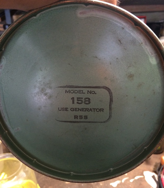

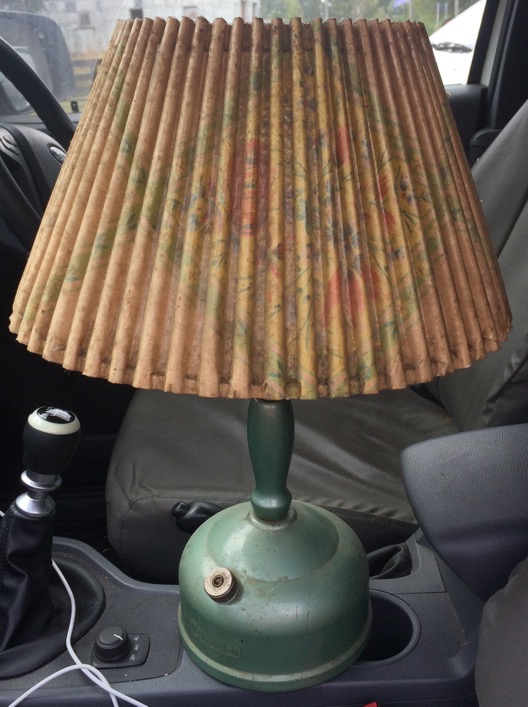

    Found this lamp today, Coleman 158 with original shade and glass. I see there aren't any on the gallery so this may be the first to go up. But first I want to clean it up and get it firing. So a couple of questions.

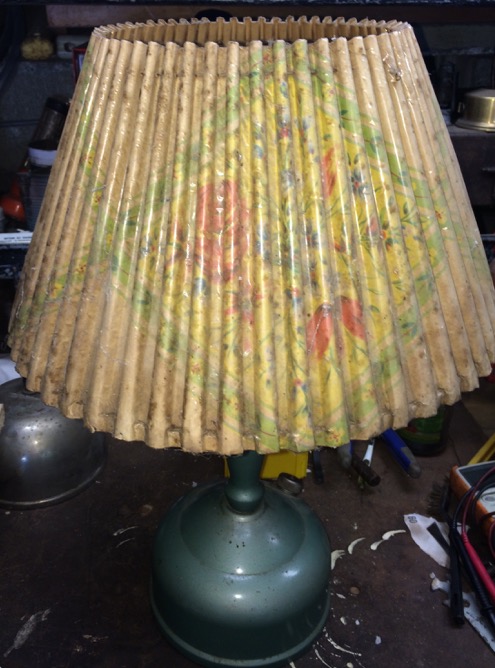

    What is suggested as a good way to clean up the shade. My first thoughts is cotton buds and warm soapy water?
    And secondly I am guessing this is a kero lamp given the pre heat cup. I only own one other table lamp so not an expert on these. How many pumps would I give for priming?

    Great find in that condition.
    I use gas and not kero I mine. Kero might plug up that R55 generator.

    Great find with the glass and shade intact!
    The shade is paper laminated with plastic inside and outside. It is very fragile, especially at the edges and can easily delaminate. A soft damp cloth with a very little warm soapy water can be used to carefully wipe off the plastic outer and inner surfaces, taking care not to get the paper on the edges wet.
    The fuel cap seems to be missing the thumbscrew valve part. You could also use an aftermarket schrader valve fuel cap.
    How many pumps would depend on what pump you will be using :lol:
    You can give it roughly the same pressure as a Tilley. They run quite well on low to moderate pressure and have a remarkably short preheat time.

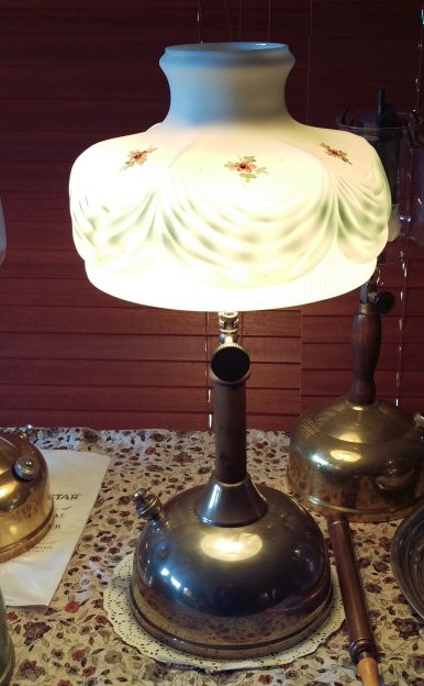

    I know just what you mean. I also found found this hideous old shade the other day to fit my Evening Star lamp.

    Yes, I tend to agree - the Coleman is fine and the Evening Star looks even better! :D :thumbup: :clap:

    Great thanks. Shade cleaned up well. Pretty good condition considering its age. String is intake, no surface rust on frame. Plastic in good condition. The bottom is a bit rough and ther is a bit of staining but over all I would say very good condition. Going to post in the gallery
