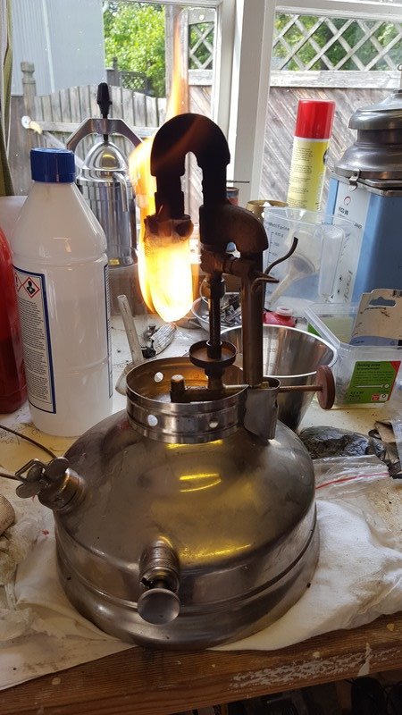

    I have found myself a Sinumbra lantern in quite good looking condition. But I don't get it to burn correctly no matter if it's gasoline or Kerosene, with a mesh in the vapouriser tube or not. If I close the cleaning needle a little then it helps however. That in my opinion says the lamp is burning fat.
    Then I noticed that the air tube is choked/strangled (less diameter) in bottom end, should it be like this?
    I have understood the burner is a AGM type, anyone know if it's an "impossible" model to find jets for, or was it a quite common model?
    Any other Ideas what could be wrong?
    Burning white when needle partly in cleaning position
    Burning bad , guess to much fuel, to less air.

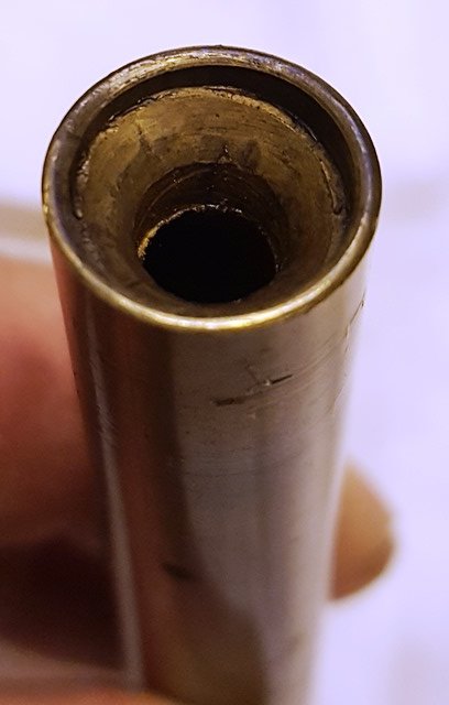

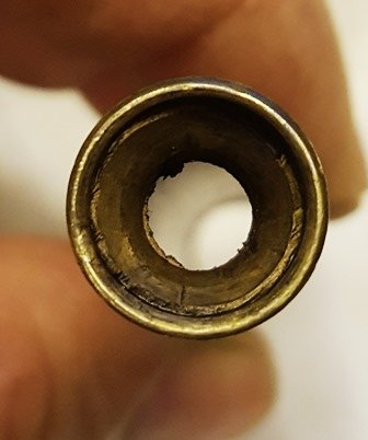

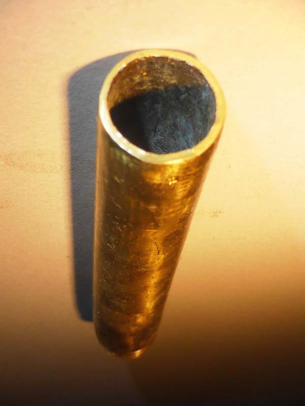

    Thank you all for your answers. I had a bad feeling the jet gonna be hard to find item. Before putting force on the jet (good idea by the way) I will start with trying lamp without the airtube. The reduction looks well done I think. The inner diameter on tube is 10mm , at the reduction only 6mm.
    Kind Regards
    Joakim

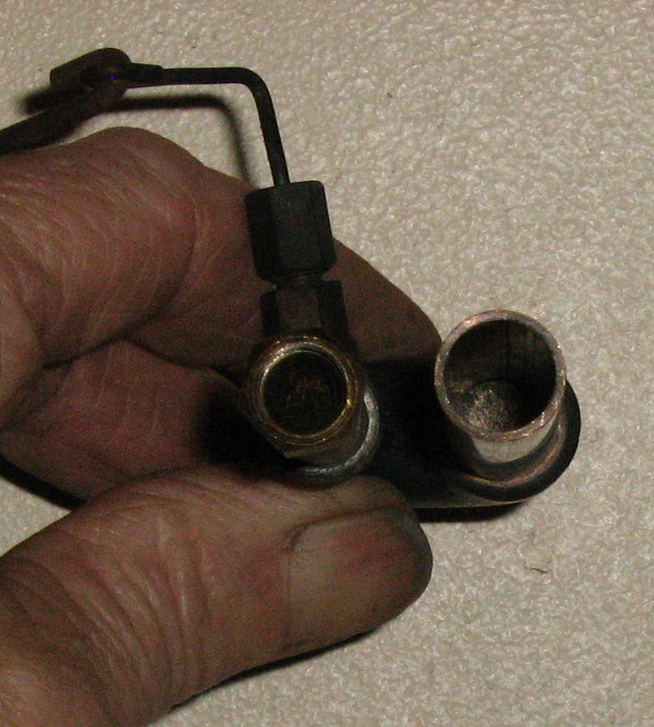

  7. Henry Plews
    1,878

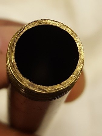

    Good idea. Here are two images of the air tube from my AGM 335 which has the same burner as your Sinumbra.

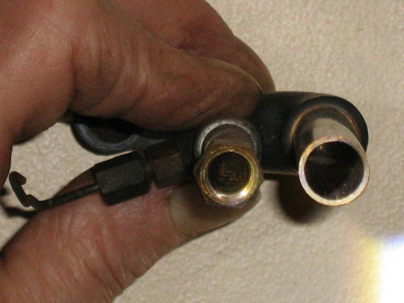

    Hej Joakim,

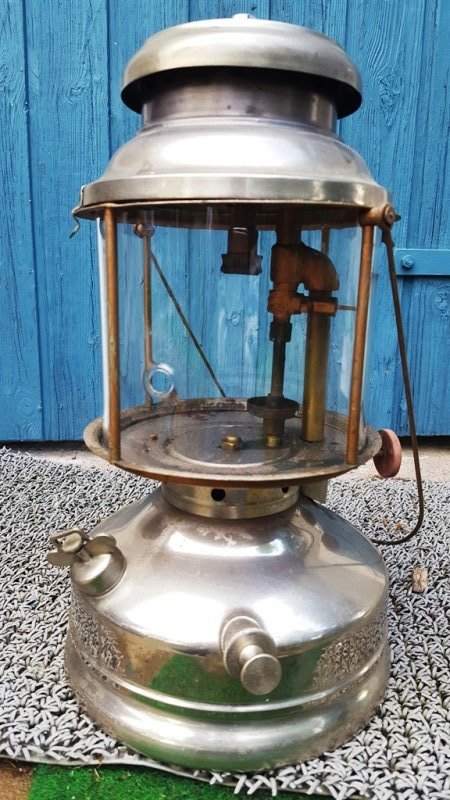

    I checked my Sinumbra lantern air tube and no restriction. Probably the burner on your lamp will perform better without that restriction.
    Looks very well made and may have been fabricated as an option for making it run on alcohol. Mind you this lantern was launched in Sweden during the era of WW1.
    Hard to get fuel supplies in Sweden those days.
    /Conny

    What is the restriction made of?

    The restriction seems to be brass or coppar , same as tube.

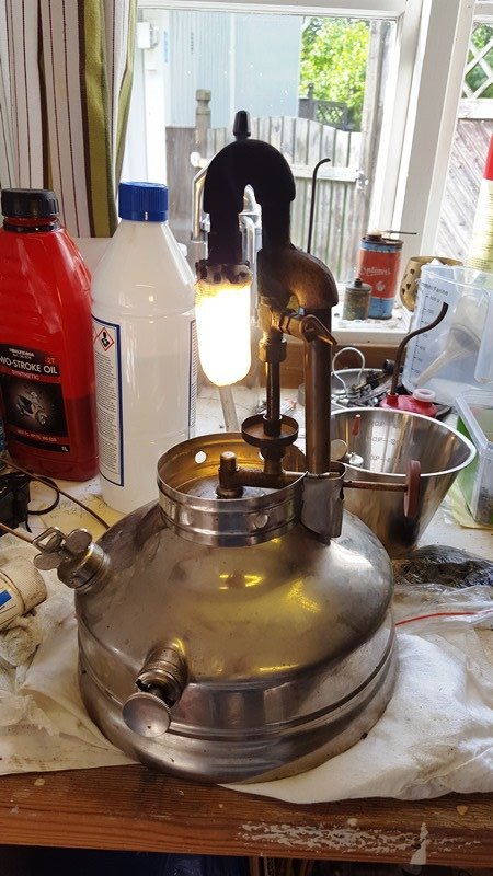

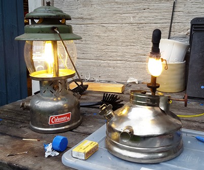

    You were right, the lamp run pretty good with alcohol. tried with no airtube and kerosene/gasoline but with not so good result. So you are probably right , durinh war time they converted the lamp, perhaps you could a buy a tube and jet?
    Here's a picture with alcohol, much better light.
    I'll keep it as a alcohol lamp, even if I personally not so fond of them. But it's hard to convert it back, and it's part of the lamps history.
    Kind Regards
    Joakim
