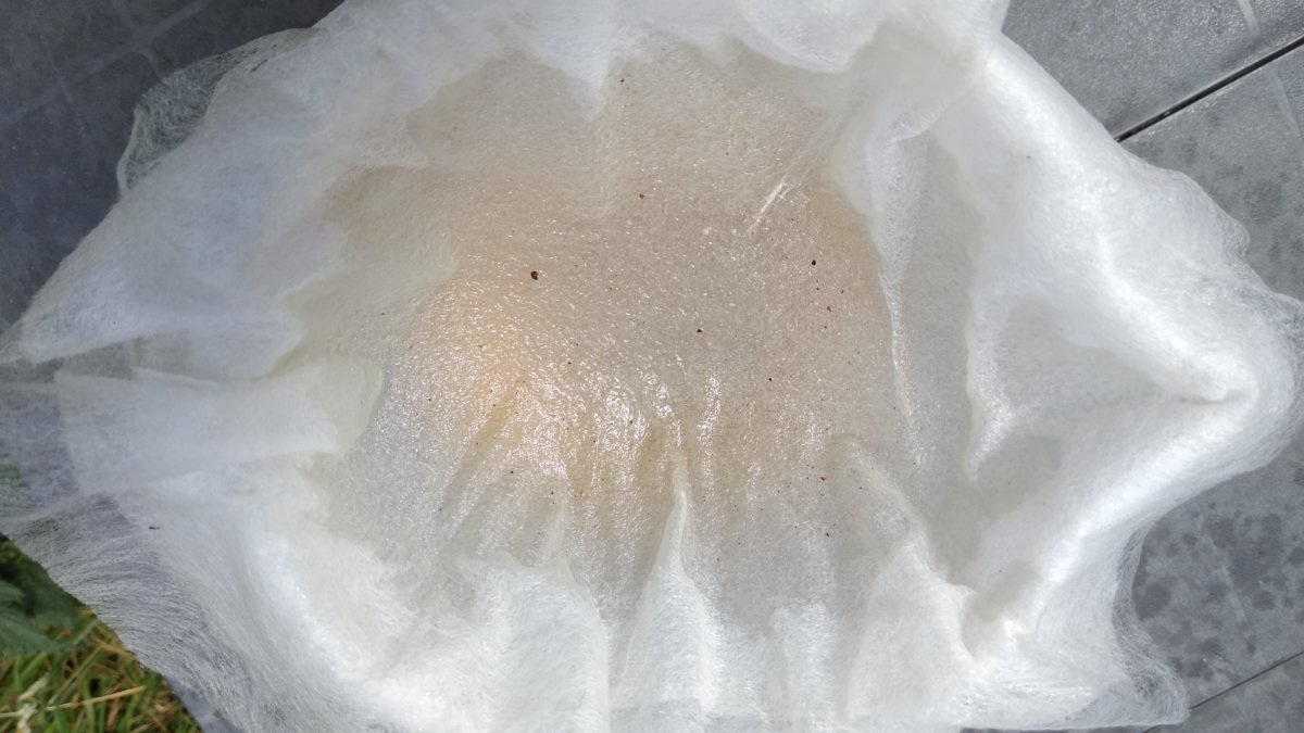

    I am an absolute beginner with kerosene pressure lanterns but have had some success within the past month.
    I recently bought 2 Sea Anchor Kerosene Pressure Lanterns from eBay. Same model. Both work fine. I light both of them using the rapid starter or the ignition device where a jet of kerosene spray is lit up and is directed towards the vaporizer. I use the same kerosene in both. One lantern produces soot around the glass chimney every time I light it up! But the other lantern leaves no soot at all on its glass chimney! It is completely clean! I have emptied a litre of kerosene from the tank of the faulty lantern through a fine sieve and there are hardly any sediment particles in it as the photo shows.
    Should I pour in white vinegar and leave it overnight to clean the kerosene tank of the faulty lantern ?
    Should I disassemble the red wheel mechanism to try to clean the tube leading to the jet?
    Has anyone successfully solved this sort of problem? I enclose some photos. I would be very grateful for you guys helping me get to the bottom of this mystery.
    Soot deposit on glass chimney.jpg Sediment particles when kerosene from tank was passed through a fine sieve1.jpg

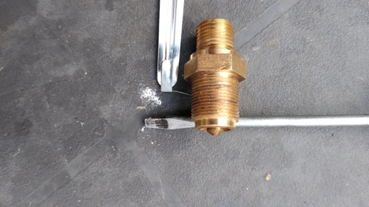

    I have disassembled the rapid starter into its individual parts. See photo. I inserted thin bicycle brake cable in the long tube that dips into the kerosene and found no visible gunk in it whatsoever. I then checked the tiny holes in the jets with the needle tool that is supplied with the lantern. There does not seem any obstruction like fine black particles.
    The other lantern produces a blue almost invisible flame in contrast to the faulty lantern which produces a conspicuous yellow flame especially at the upper half of the flame.
    I remember learning about the bunsen burner in my chemistry classes at school. This burner is a standard heating source in chemistry labs and it will produce a yellow flame when the hole at its side is shut with a sliding metal curved seal but when the hole is partially opened it produces the typical bunsen burner blue hot flame.
    So based on this information, I would say that the reason why the faulty lantern is producing a yellow flame which causes the soot is because there is no air or far too little air reaching the pressurized kerosene before it is ignited. Same as in the bunsen burner yellow flame.
    I have noticed that the rapid starter base has a central hole which is connected to the pressurized kerosene in the tank by a metal tube approx. 11 cms long. But the rapid starter base also has a tiny hole in the 12oclock position (as seen in the photo) for the air on top of the kerosene in the tank to mix with the kerosene in a very small chamber just before it is ejected through the second metal case with a central hole in it.
    So it is possible that the cause of the problem is that I have overfilled the kerosene tank with too much kerosene because this would lead to too little air being available above the kerosene in the tank.

    The second image shows where and what the problem is. There should be another hole for air directly opposite the one shown in the image, check-out the good one and you'll see what I mean. Giving the part a good clean with fine wire wool may reveal the missing orifice. On the other hand, it may be a manufacture fault. Check out the Magnalux & Anchor price list section at www.base-camp.co.uk for a replacement.
    To reduce light output and make your fuel go further, change the jet for a 350 cp. one.
    Henry.

    Thank you Henry for solving the mystery to me. So there should be THREE HOLES in the rapid starter base!! I have checked and scraped with a sharp knife the 6oclock area with reference to the second rapid starter photo. There is no third hole! So I will just have to replace the entire rapid starter mechanism because base-camp online store do not seem to sell a rapid starter base on its own. If anyone can sell me a Petromax-type rapid starter base with 3 holes, please let me know.

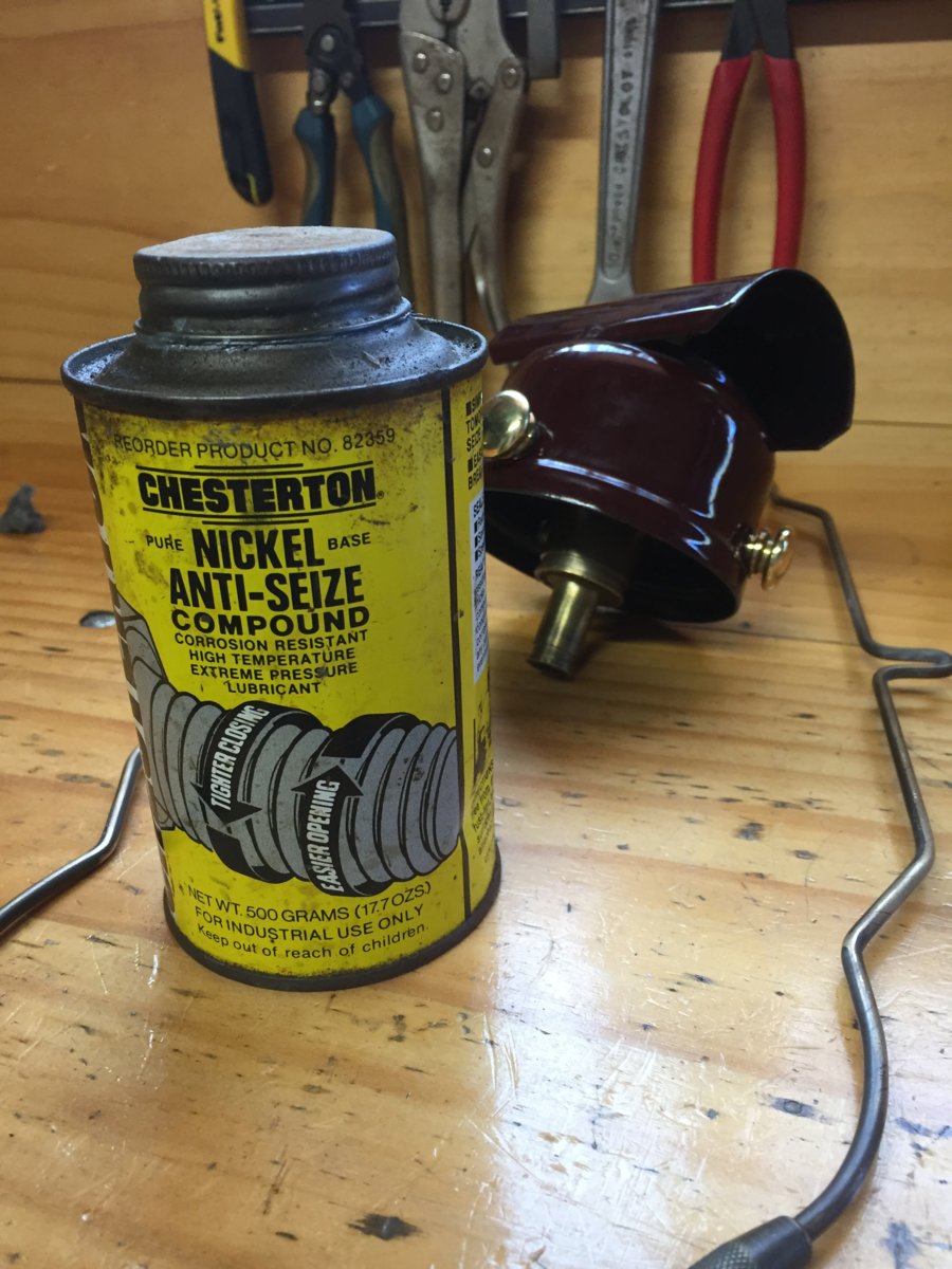

    Would pre heating at a lower tank pressure be worth a try (less pressure = less fuel)
    I have always used Nickel anti seize (it is better at higher temp rating than copper) .

  20. AussiePete
    1,115
    @Tony Press I use a nickel anti seize paste as well.
    This is the stuff.
    I find it works very well.
