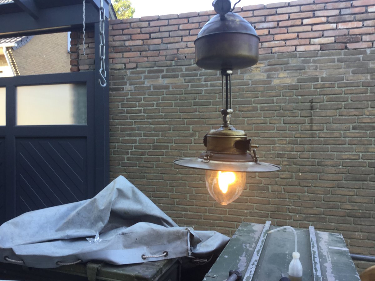

    Hello everybody ,
    I got a Spanish hanging lamp, built 1949 at Klabebisch Barcelona. During the test, I put pressure on the tank, at first it was tight. After 2 minutes, the pressure relief valve has changed. If I close the cap tightly,
    Can I put this lamp into operation without the valve?
    I'm sure someone can give me a tip, thanks in advance.
    Greeting Alfons

    This is a new one to me. I know of Klaebisch but was not aware they had made this. I can't see that it has a pressure relief valve. It has a pressure release valve and I can see a pricker control and an inlet valve. It dioes not appear to have a main control shut off valve. I would assume it is a kero lamp although the catalogue seems to suggest it is an alcohol lamp.
    That catalogue page is very interesting and I would very much like to see any more of that catalogue you may have. I don't have any paper for Klaebisch and it may have information that would be of great interest to me. ::Neil::

    Couldn't it really be a "nearly" gravity lamp that was made for alcohol burning? This would also explain the large/flat design of the vaporizer (the part named "gasificador" on the paperwork). And I also doubt that the even bottom plate of the tank would stand much pressure.
    So it won't need much pressurizing with the pump (bomba, also shown), but uses a safety pressure relief valve (valvula seguridad, also shown) to prevent it from overburning in case the tank would get too hot.
    Ludwig Gebauer from Germany has built some neat alcohol lamps that only need 0.2-0.3bar pressure and function very well.

    It's absolutely meant for alcohol. Atleast if it's identical to the No.425 in the catalogue since it says it's exclusively meant for alcohol there.
    And it has a pump and pressure gauge, so surely meant to be pumped up.
    But I do agree that the tank doesn't look like it's mean't for too much pressure.

    I did not put to much pressure on the Tank in my opinion. Could it be that the lamp got some cracks because of the older? The pressure gauge has a range up to 1.5 bar. (See picture)

    the simplest way to find out is to make a water dunk test: just pressurize the empty fount and put it in a bucket of water. The bubbles will show you where's the problem. And all of the old cork or rubber sealings should of course be replaced, since they will likely have hardened over time.
    Old parts made from brass sheet is often prone to develop stress cracks. If that's the case I'd not use the lamp any more. Even with a POR15 lining a leakage could eventually cause a catastrophic accident. Not only that alcohol is much more flammable than kerosene, the tank is mounted on top of the lamp. So please be extra careful with that old lady.
