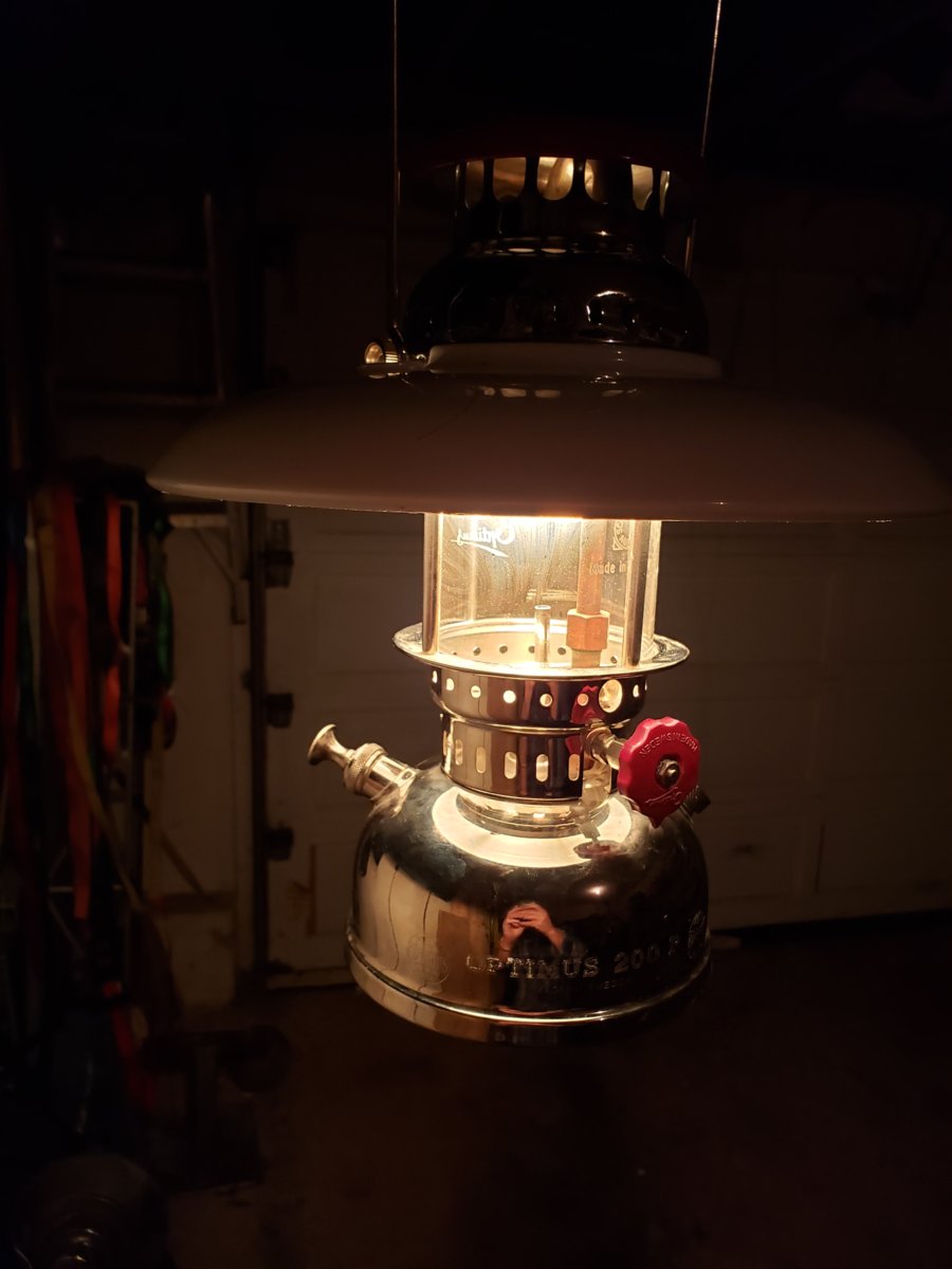

    Hi all. I'm new with kerosene presure lamps, so please bear with me.
    I purchased a NOS Optimus 200p recently. I've replaced the cap gasket, and run two tanks through, and it works great. Tank level indicator and pressure gauge seem to work fine.
    I expect this to be a user lantern, so what spares should I stock? I've an order for stove parts going into Basecamp shortly, and thought I would add some mantles. What else should I include?
    Thanks for your help. If this goes well, there is an old Coleman Quick light hanging around that I'd like to fix up.

    Jets/gas tips and pricker wires and mantles are useful spares to have.

    Ceramic nozzle..

    You might add and seals, e.g. filler cap seal etc....

    Coleman 21A mantles will work fine in that. ::Neil::

    I would suggest a keeping a couple of spare nozzles/jets and a few pricker needles around as you never know when you're going to need one.
    Also, there are some good and cheap mantles to be had on eBay.
    I have used the green sock type mantles found here and I can confirm that they work well.
    The round, ball type mantles found here are also very good.
    I think most people like to have branded premium mantles but it can be very handy to have a a stock of cheaper 'everyday' mantles you don't mind sacrificing if you're trying to sort out a problem. The ball type mantles can also be adapted for use on Tilley, Vapalux and Bialaddin type lamps.

    For the sake of completeness, I would add the following too:
    Pump leather seal
    Pump non-return valve or viton pip for it
    Lead seals for the lower vaporiser and pump NRV
    A piece of graphite sheet for the excenter shaft seal.
    Two viton seals for the fuel level gauge window.
    The ceramic burner nozzles for these are becoming hard to find at any reasonable price. Snap one up if you come across it.

    Best to just buy a a couple of sheets of Viton varying thicknesses, a few hole punches and then a ton of mantles.
    You won't have one lantern for long....:lol:
    Fogas.se are a great source for Swedish lamp parts email in English is ok
