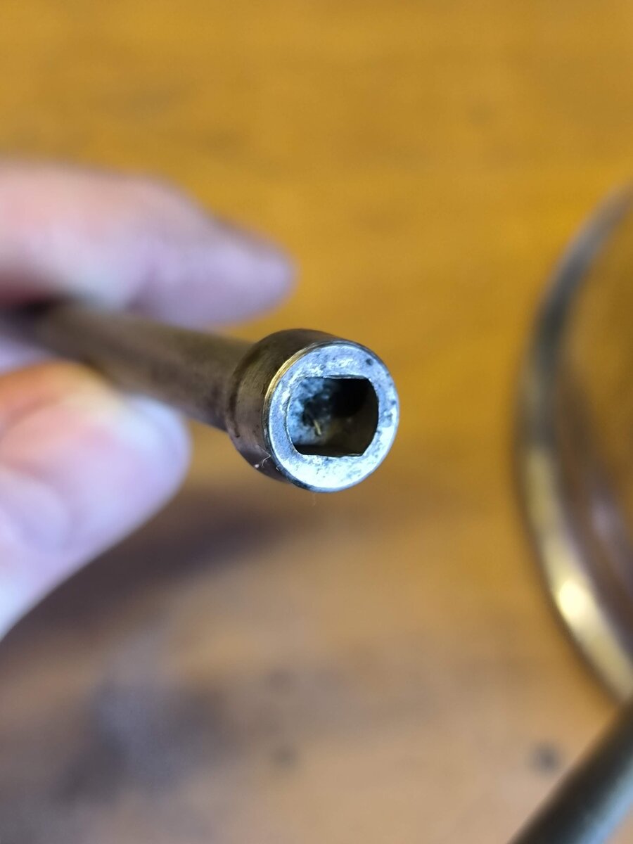

    Even with the right tools and replacement valve on hand I'm stuck and dare not proceed with more force.

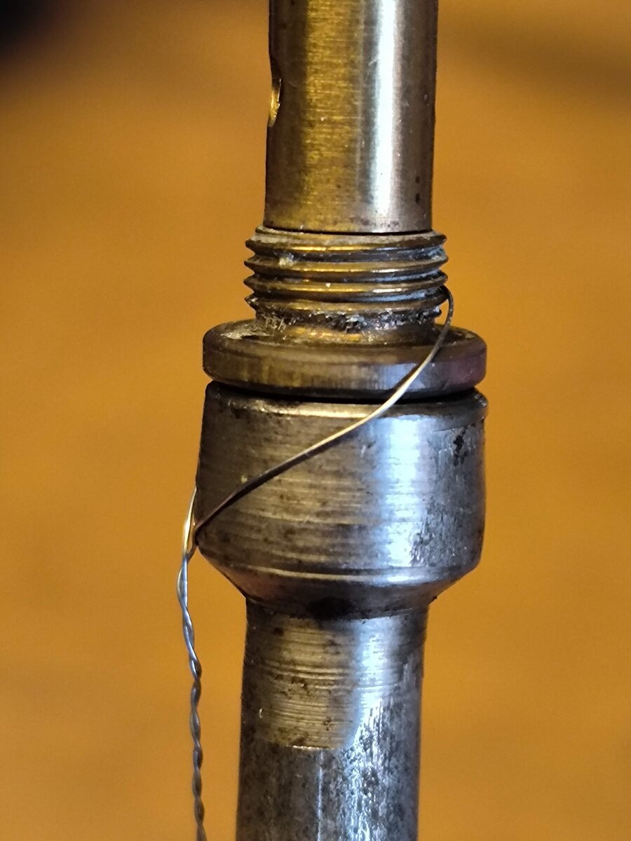

    The valve can be unscrewed and the slight jump of the last tread being wound "too far" is evident through the handle. Still it won't come out! With a thin wire the tool-addition seen below was made. It's illustrated with a replacement valve, obviously. The point is to let the loop catch on the lip of the valve and lock it there by tension.
    In trying it I think it successfuly hooked the valve, but it still won't come out. Turning or pulling does nothing. Even pulling hard is yielding no result, so I stopped.
    My question is this: am I missing something? Should I just yank on it and hope it sorts itself out? :s

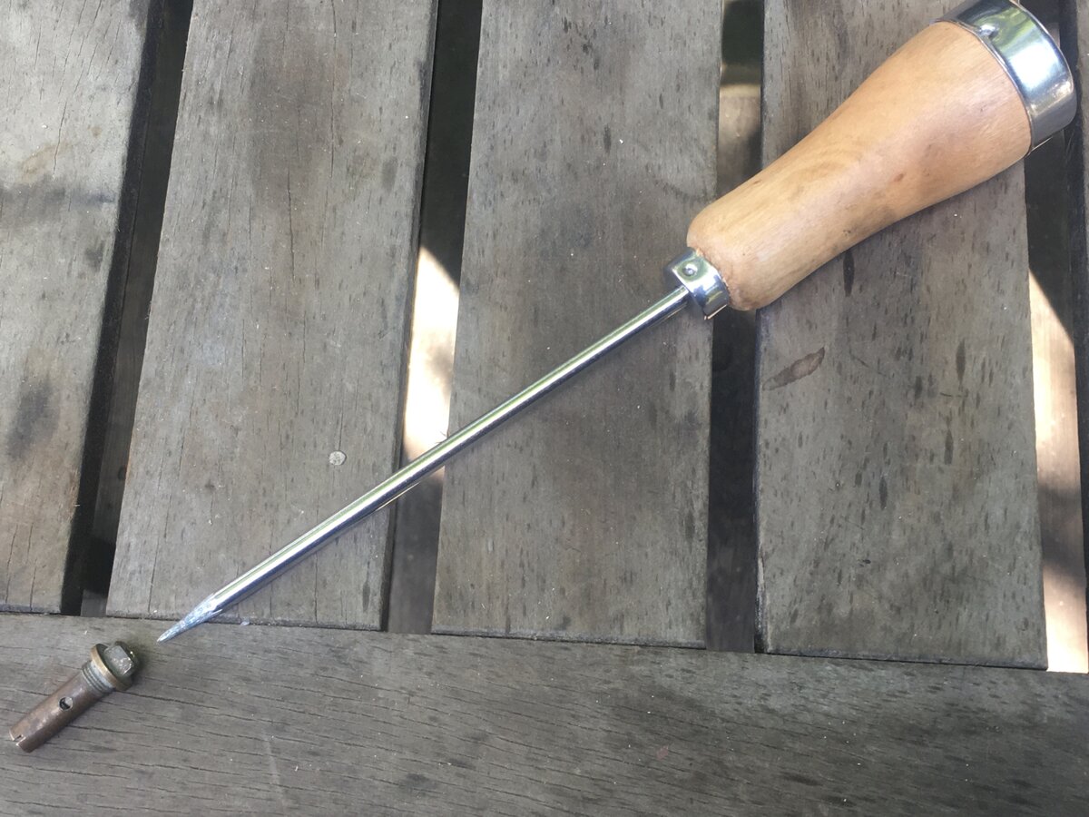

  5. presscall
    1,502
    Lancashire, UK
    A shallow-tapered spike (ice pick here) jammed firmly (but not destructively so!) into the NRV’s air inlet hole works for me.
    John

  9. presscall
    1,502
    Lancashire, UK
    Yes. It’s never failed to remove an unscrewed, but stuck, NRV and has worked for all I’ve recommended it to - primarily on CCS, where the most recent user of the tip said,

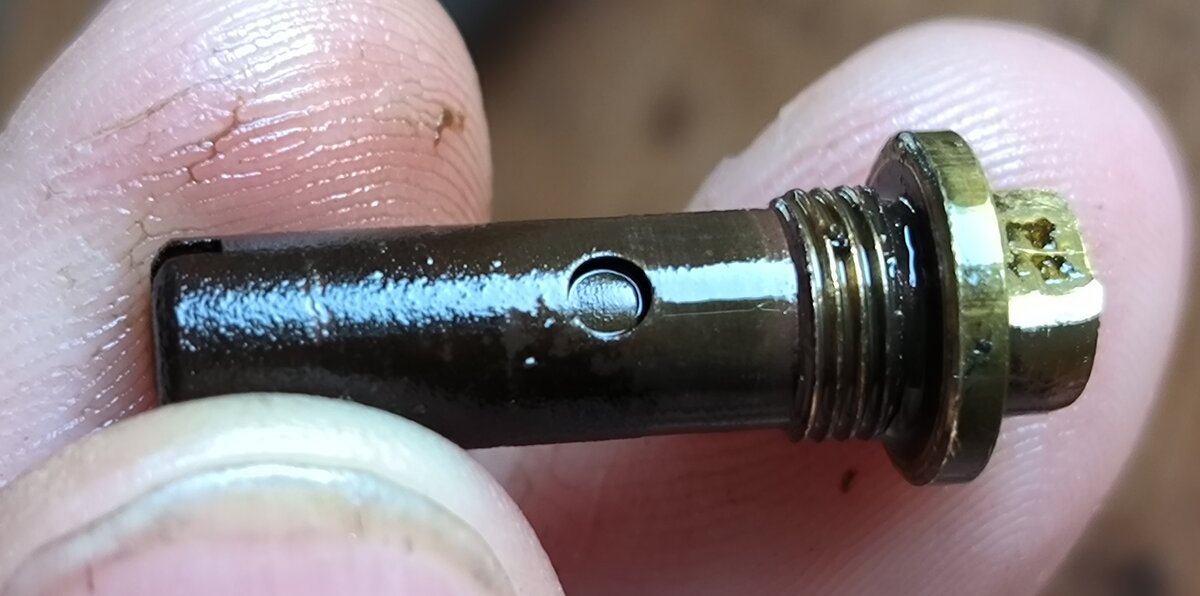

  11. Vigfus Sweden
    May 16, 2023
    9
    Sweden
    Thanks for your insights. The NRV came out with some more violence and jiggling. IMG_20230518_131415~4.jpg
    I guess it was just tight tolerances keeping it in there. There doesn't seem to be anything wrong with it besides being seriously blackened.
