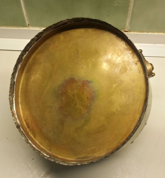

    One problem I have is some vandal has chopped the base out completely, even grinding it flush to the walls of the tank ](*,)

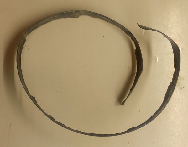

    Nope brass. Here's whats left of it :D
    Any of you blacksmith types know how to make a replacement base plate? Can I fold a lip on a brass plate using a hammer and dolly or do I need to use a swager?

    4,031
    ...Hi James,
    Easier if you have a swager or know of one you can use/practice on, but No, you don't need one....What are your Tinsmithing skills like?.. :)

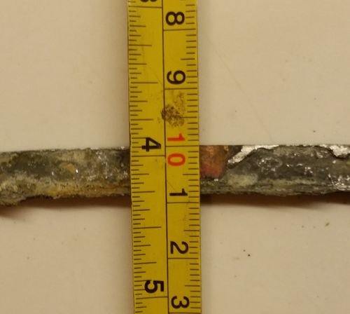

    I cut out a disc out of some scrap copper sheet to measure the O/D. The disc is 149mm in diameter and is a little snug. There is one bit that doesn't quite fit but I think the tank rim may be deformed a little where a hole has been drilled. I think 148mm would be about right.
    The lip is 8mm.

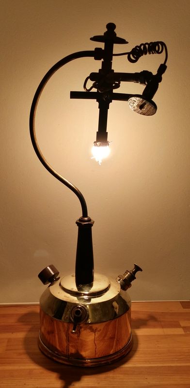

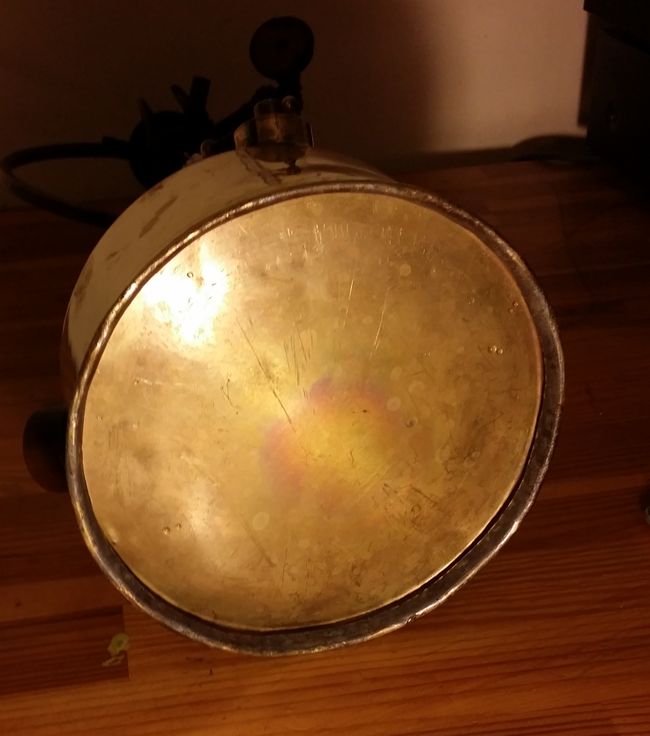

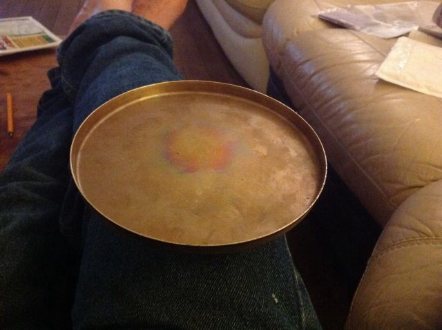

    The tank with the new base soldered in:
    And the rim folded-over (this was the hardest part):
    I added a vapourising coil to the burner to improve the burn with liquid fuel:
    It works:
