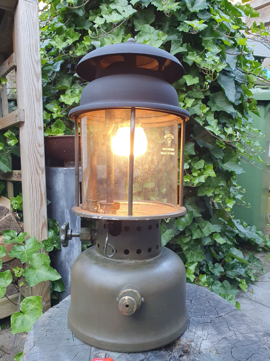

    I'm conducting a small experiment as well with a Veritas P350 hood.
    I used VHT paint (800°C) from a local cheap stuff store (Action). The hood was sprayed in a single coat without any preparation. While the paint was still wet I installed it on the lamp and lit it for an hour to bake/cure it.
    I've given it seven cycles with a total burntime of 15 hours. The paint still looks fine.
    20200622_194823.jpg 20200622_194740.jpg 20200622_195129.jpg 20200622_200048.jpg 20200622_205849.jpg
    I will use this lamp regularly this summer and I will keep track of the paint finish.

    That looks good, @Emiel . Do they have an equivalent in gloss?

    The shop only sold the matt black so I went with that. Not sure it other colours are available. There is nothing to be found online about this brand and its products.

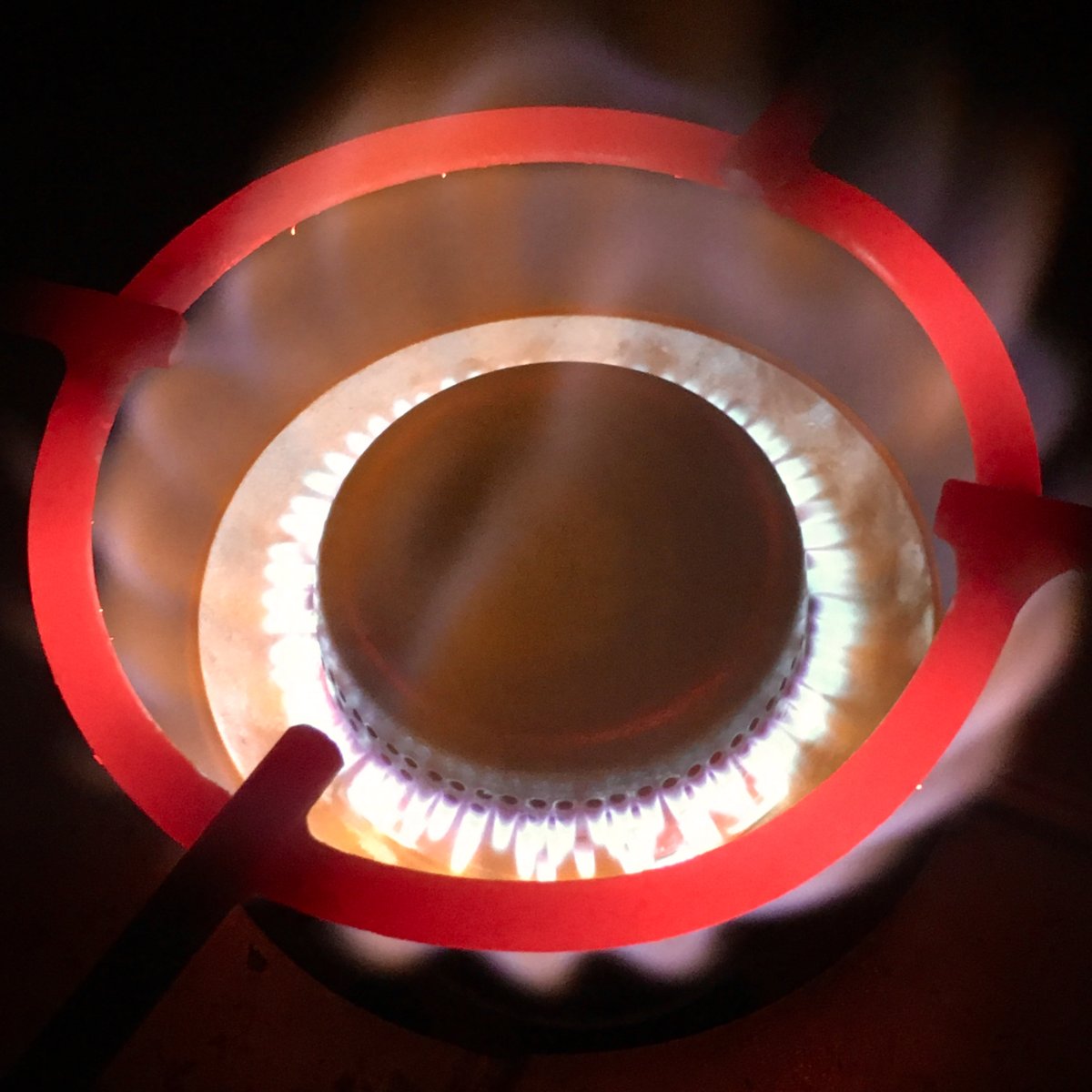

    It puts me in mind of the effect I witnessed on the trivet of my Prim Compact gasoline stove.
    Pristine here after I’d painted it with Thermacure.
    Then some of this ...
    ... and the paint on the trivet was looking a bit absent. Holding on at the outer ends of the bars though, which though not getting to red heat would still be at lantern hood temperature I expect.

    The Spectrum paint looks good so far. As far as what I've seen, all the high temperature VHTs come in matt. They're normally limited to a few colours, namely black, white, grey, aluminium/silver and in some cases, red but all are still matt.
    If its really rated 800°C, I'd say it'll make it. Hood temperatures don't normally get that high, but rather, in the region of 600~650°C at most(from my actual measurements of the zone adjacent to the J-tube of the Petromax). Anything higher and you'll begin to get a dull red glow on the metal. 800°C is sufficiently high to melt most silver brazing alloys.

    I think this matt black really suits this particular model. But for a lamp with a hood that is traditionally enameled with a nice glossy finish it is not the correct solution.
    @David Shouksmith I now have 21 hours on this lamp and the single coat of cheap paint looks like it can withstand the heat. But even a quick re-apply between campingtrips would not have been a huge problem for me.

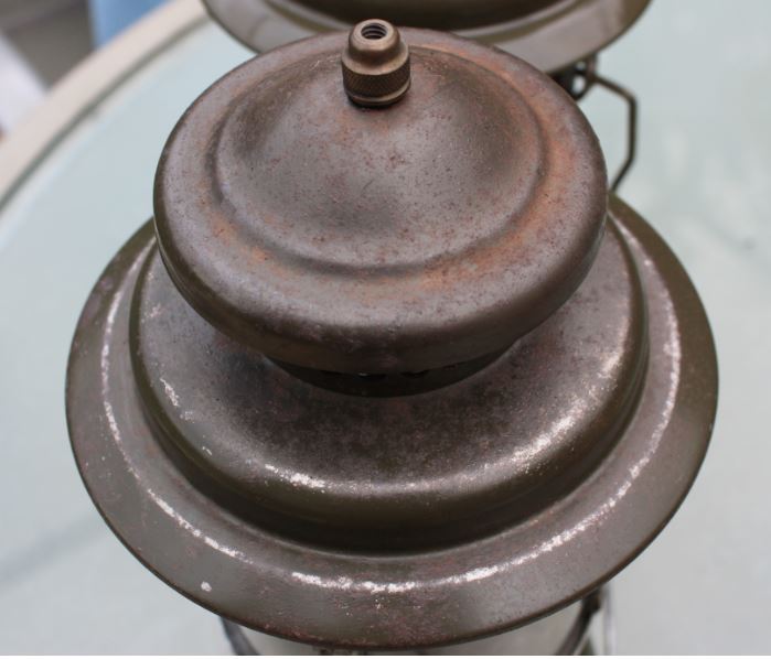

    Jeremy, this may help. Spot the SMP painted hood.
    Left to right Coleman 252 dated 1952, Armstrong Mil-Spec dated 1977 and SMP Mil-Spec dated 1980.
    SMP Hood:

  18. X246A
    1,104
    Norfolk, England
    @Alex Smith
    Thanks for the confirmation, I was beginning to doubt my memory.
    Regards Jeremy

    This sums up exactly why hoods aren't generally painted!
    You can see why they'd do it in wartime when lanterns would probably be considered pretty much expendable - but not for prolonged use, which is, of course, entirely the point of this thread! :p
