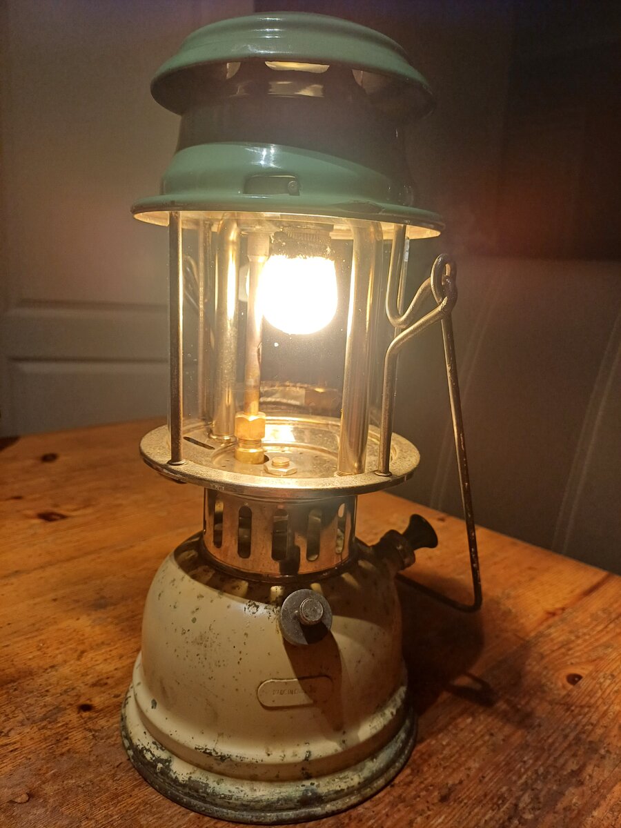

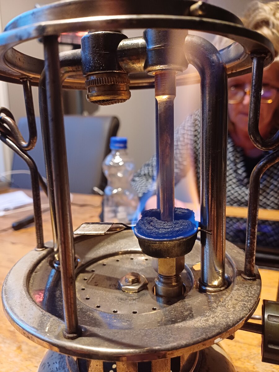

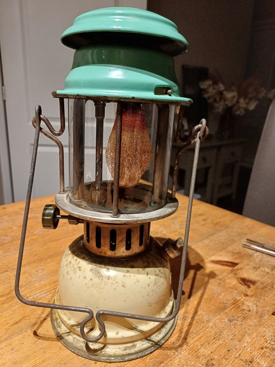

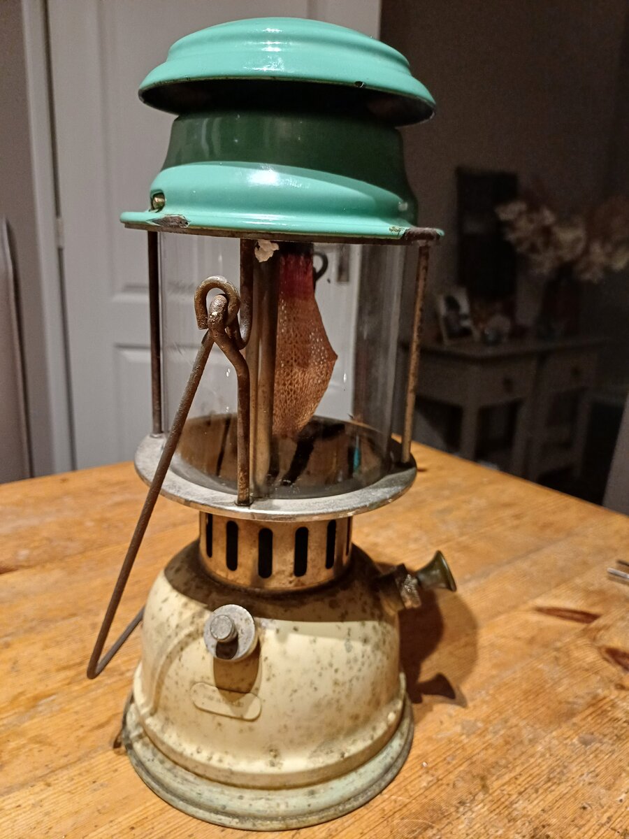

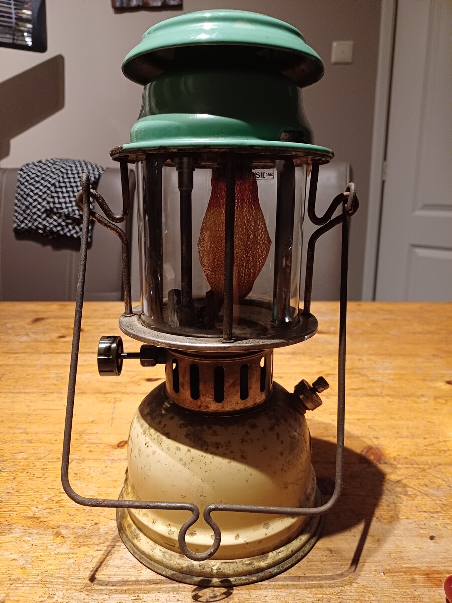

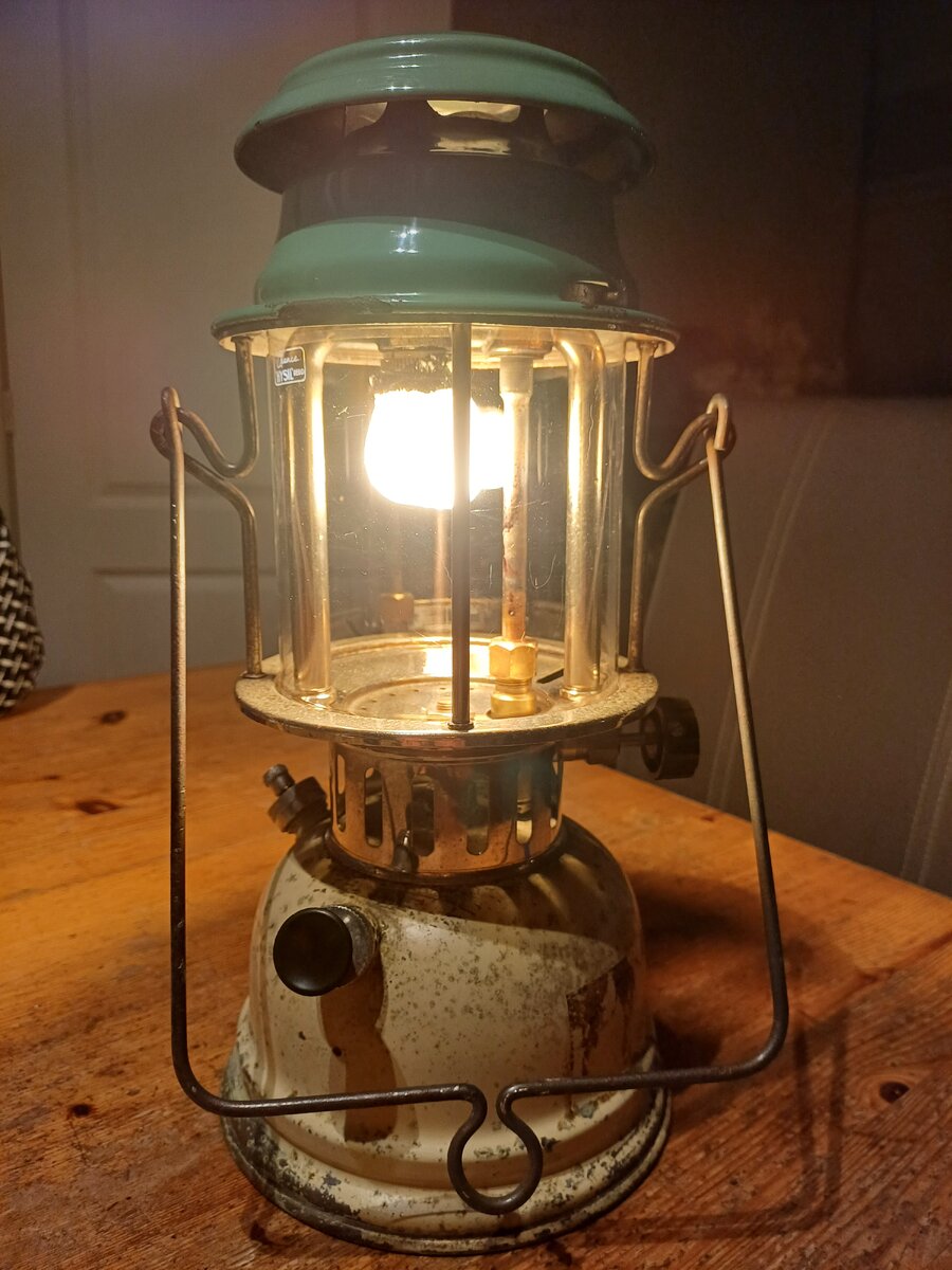

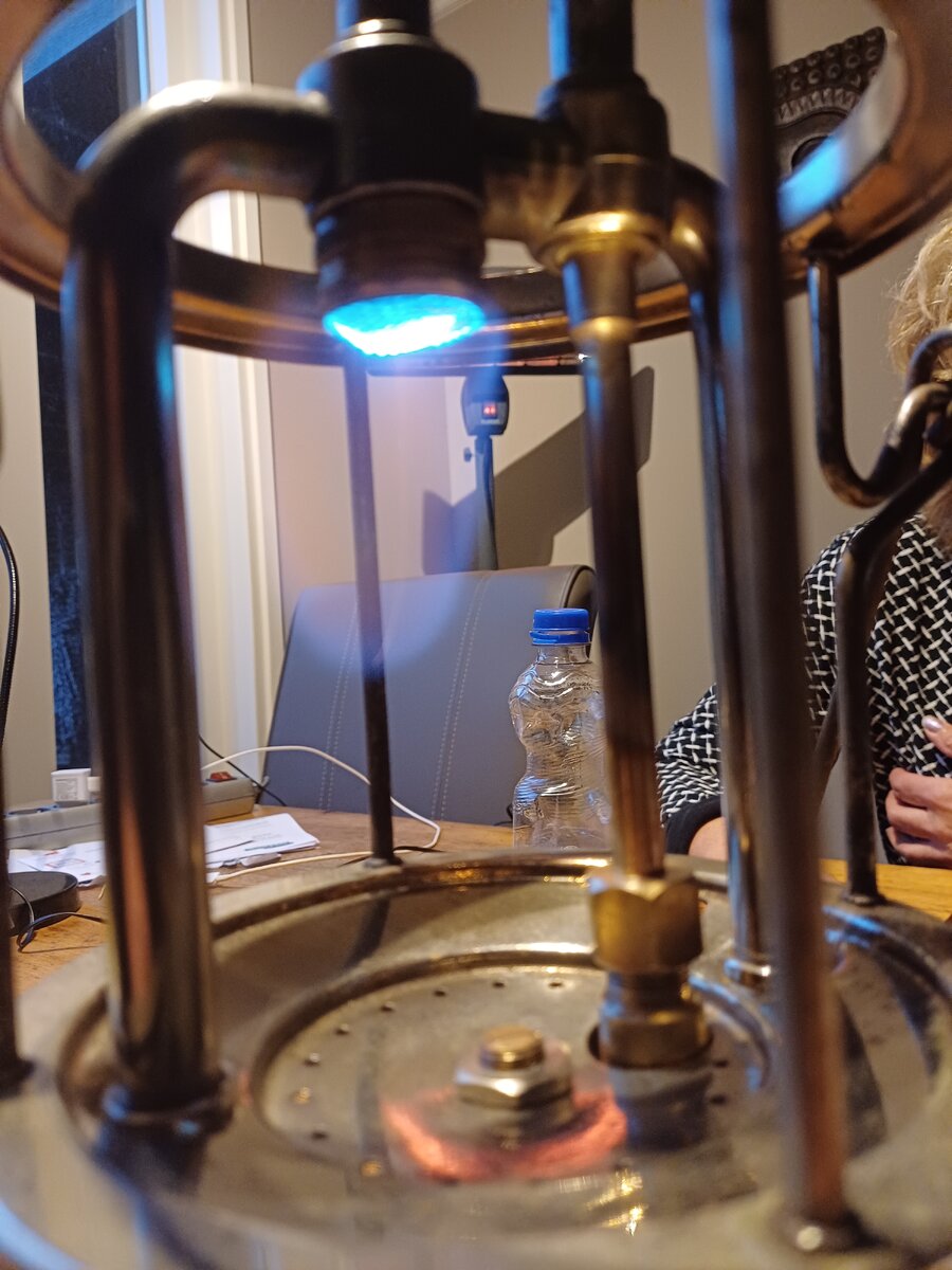

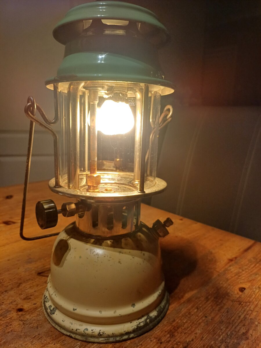

    Here's my latest find, a Thermidor. With the original globe. The spirit cub is missing, and I had to start the lamp with an Tilley pre- heater.

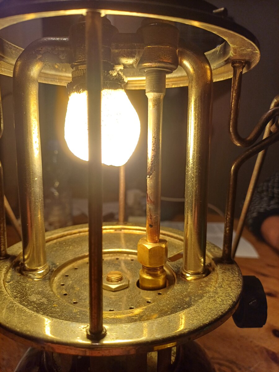

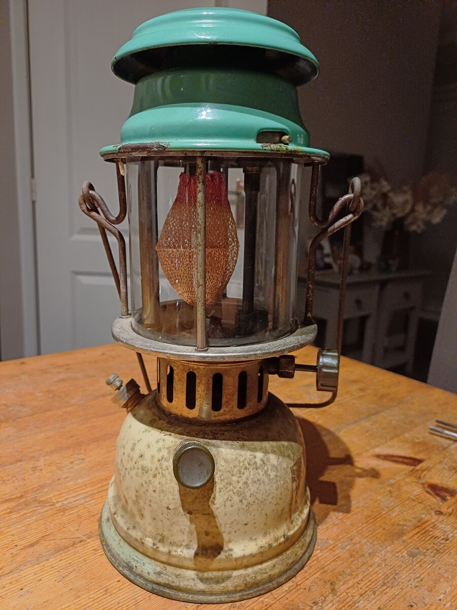

    The first mantle was to small (300-400cp), so after a few minutes, the light started to flicker and flames came out the vapouriser.

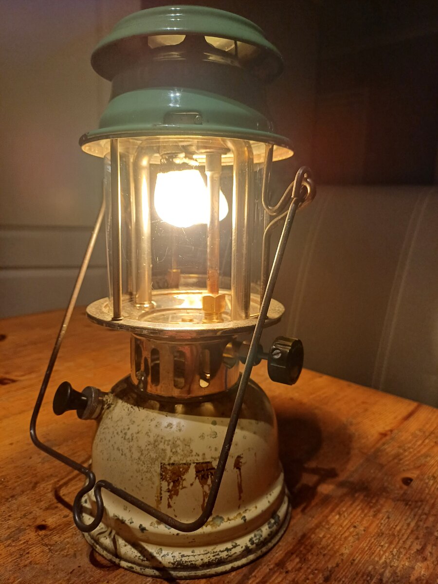

    Then I put a bigger mantle in the lamp (500cp), this one is closer to the vapouriser, and the problem was solved.
