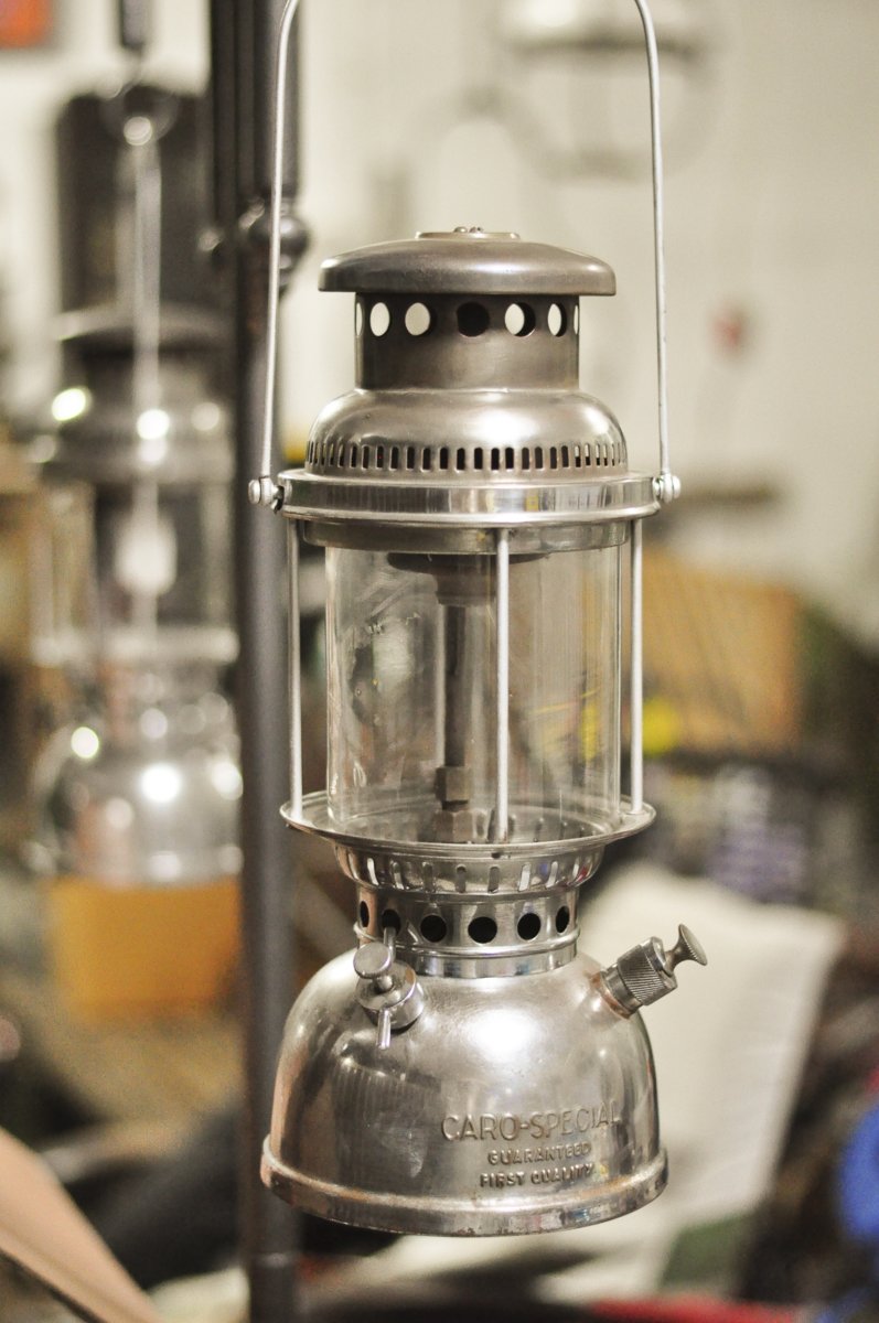

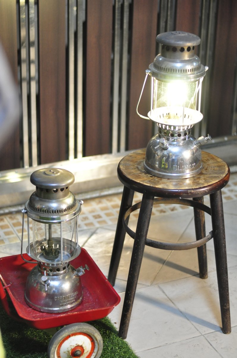

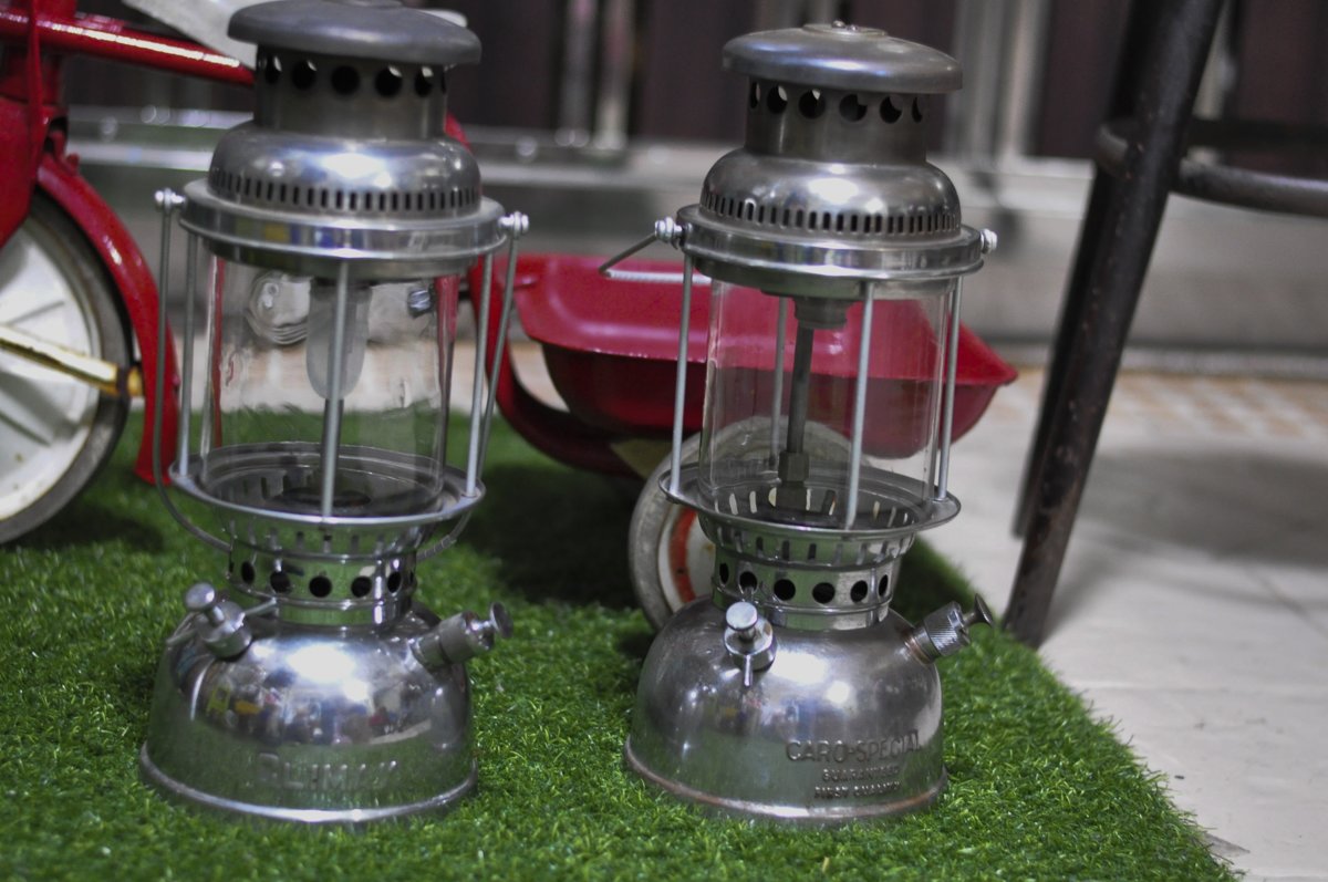

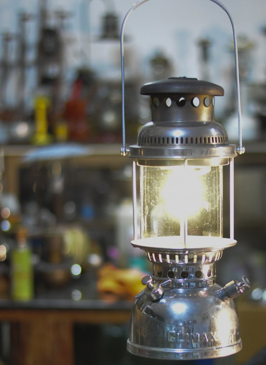

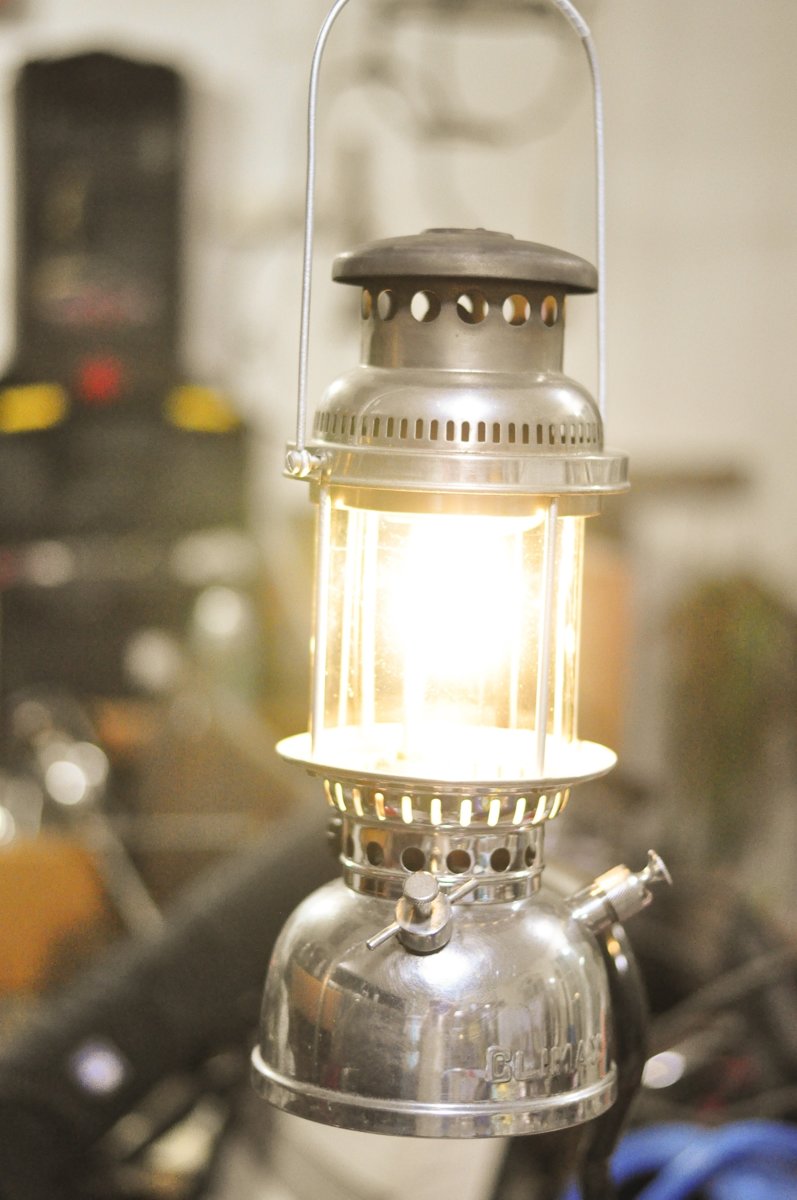

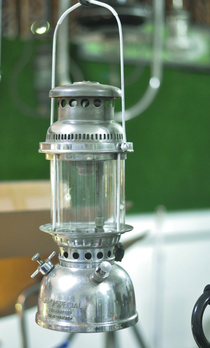

    These two lamps. Who will know where the production of the country. 20180512_180517_0006.jpg 20180512_180517_0048.jpg 20180512_180517_0041.jpg 20180512_180517_0017.jpg 20180512_180517_0070.jpg 20180512_180517_0047.jpg 20180512_180517_0070.jpg 20180512_180517_0010.jpg
  2. phaedrus42
    phaedrus42 Subscriber
    1,936
    Interesting design, with some features reminiscent of old Optimus. The irregular hole spacing in the stamping leads me to suspect India, but that is just a gut feeling.
  3. Martin K.
    Martin K. Subscriber
    Sep 20, 2013
    636
    This design is clearly very similar to Aida 214, but stamped with a different brand. I also suspect that it is a clone because if some minor differences and the irregular stamping job.
  4. eiremax
    eiremax Subscriber
    Jul 5, 2014
    496
    Same thoughts as myself Martin....great minds and all that! Fine looking lantern all the same.

    It might be instructive to see if there is any marking on the brass valve castings. I have seen quite a few copies with different brand names on the castings and the tanks. There is no country of origin marked which suggests they were made in the Far East somewhere. Most cloned lamps are Petromax copies but these are not and that suggests to me they are not Chinese, Indian or Malaysian so perhaps made in Thailand. ::Neil::

    :-k "SPECIAAL GARANTED" ??? Sounds like rubbish to me. Speciaal is dutch (or flemish), but garanted is no language (that I know of :roll: , but what do I know? :lol: ).
    Best regards,
    Wim
  9. David Shouksmith
    7,010
    Well, "speciaal" and "garanted" is nearly English. ;) :lol:
    I suppose they simply reproduced 'Hasag' and 'Made in Germany' from whatever it was they copied and added a bit of their own 'Chinglish' spelling... :roll: :D :whistle:

    The dutch/flemish text may point to (south)Africa or west/east Indies.
    They tend to mix dutch with english and local language.

    With regard to the first two lanterns, 'First Quality' is a phrase I have come across quite a few times in relation products made in India.

    Maybe they mistook the spoken word "Kero" and wrote it as "Caro"
