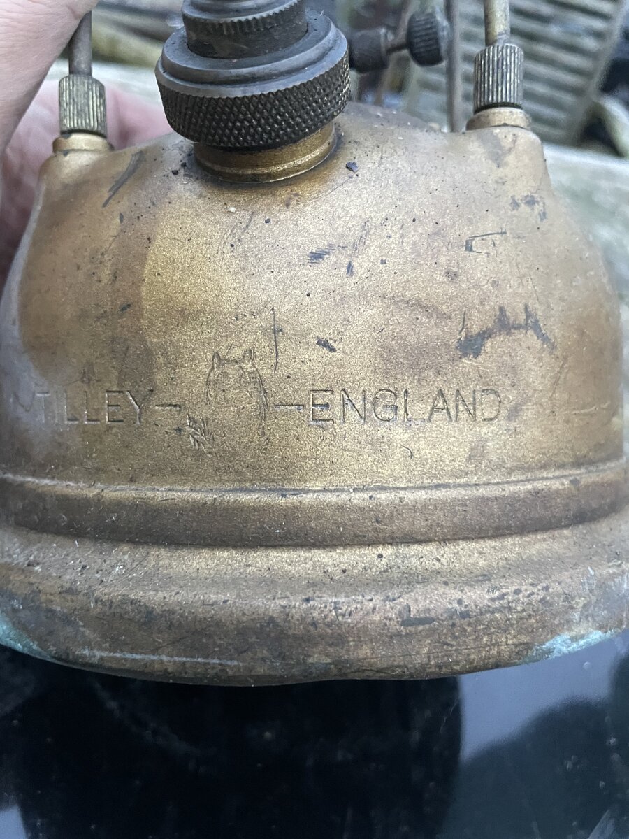

    Help dating if possible and a bit of advice

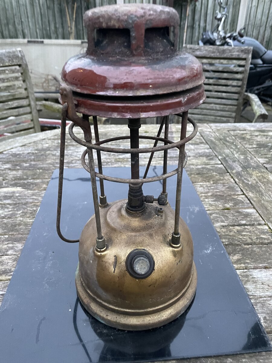

    One of 4 early straight leg bail 246 lamps I have to restore

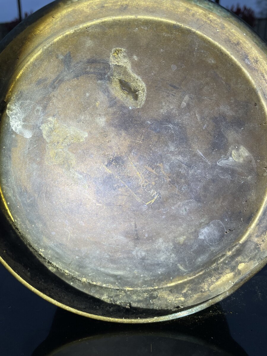

    Tank stamped TilleyEngland … but no Date stamp on the underside just Made in England

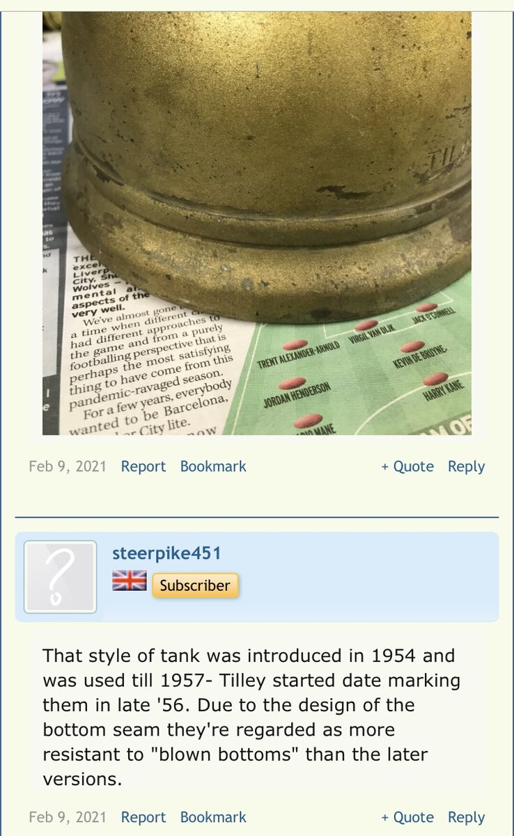

    Grooved tank so from reading @Mackburners posts as it’s not date stamped it’s pre Nov 1956 and as it’s a grooved tank it’s 1954 - 1957
    The base appears to be inserted “lip up” so if I’m right that confirms pre 1957 ??

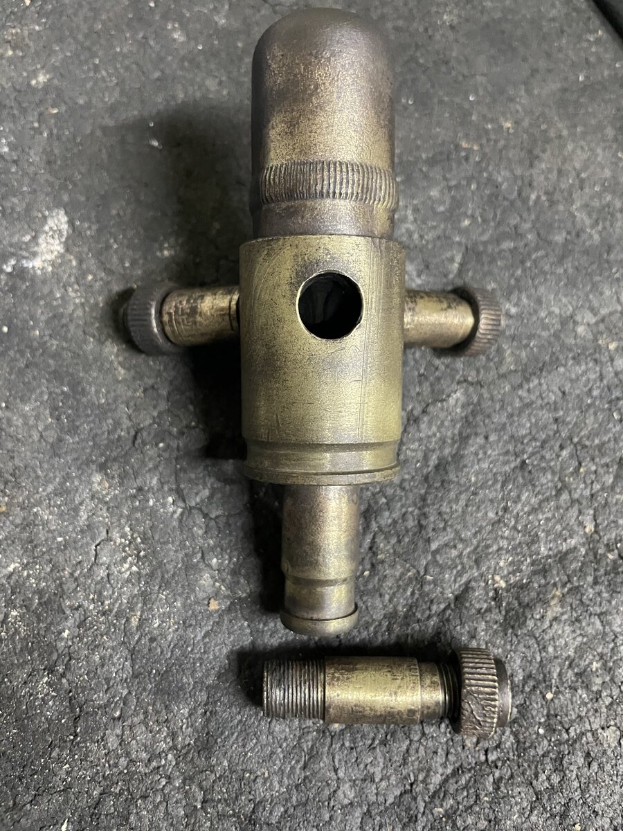

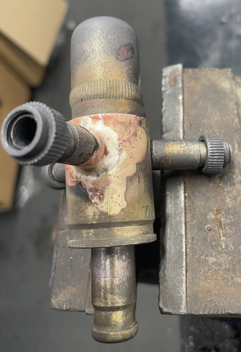

    I’ve started to clean it up and have a question on the burner .
    One of the spigots is loose , it looks like the burner has lost the thread not the spigot , as this is “air in” for combustion , is it an issue to run it just pushed in and not threaded in tight ?
  2. podbros
    4,118
    The air tubes need to be sealed.. even a turn or two loose will cause issues
    repairs are possible .. Tony Press for one has repaired them with silver solder and posted the results or you could source a replacement?

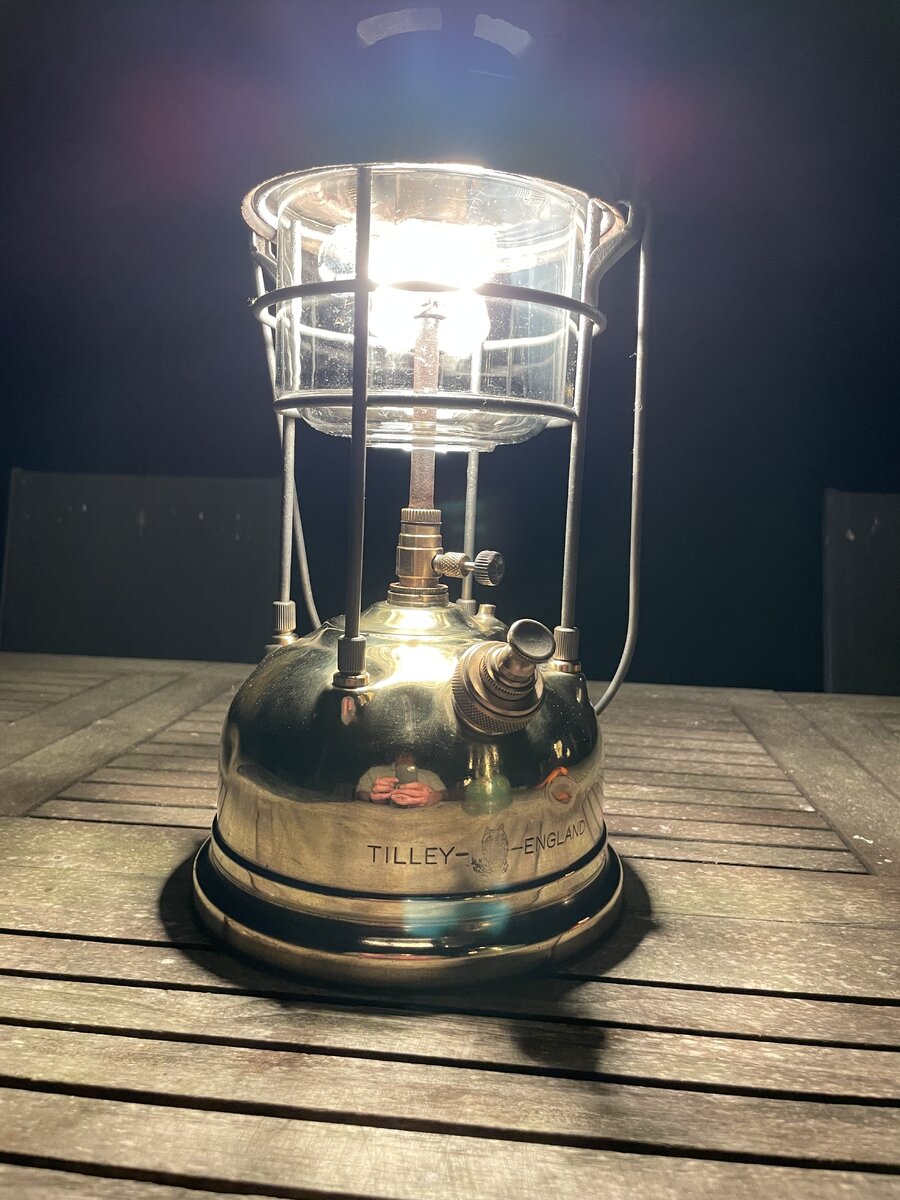

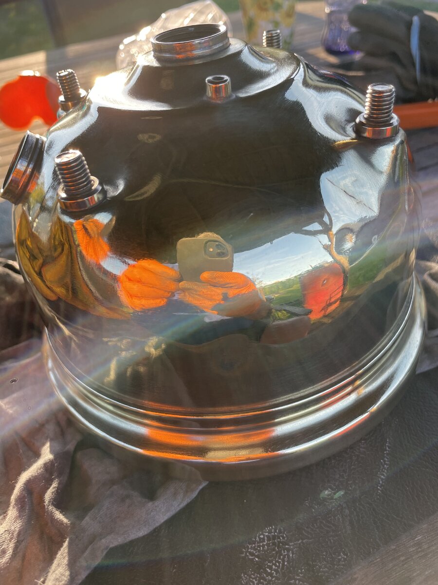

    Completed the resto on this one , not everyone’s taste to polish , but the blemishes remain to tell the history
    16,919
    It's a grand old lantern which works well.:thumbup::thumbup:
  6. ROBBO55
    4,453
    Nice work, congratulations :thumbup:

    Finally got around to doing something with the "scrap" burner.
    Not yet been use in anger , but silver solder to the rescue hopefully
  8. podbros
    4,118
    looks good :thumbup:
