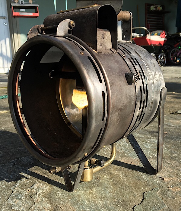

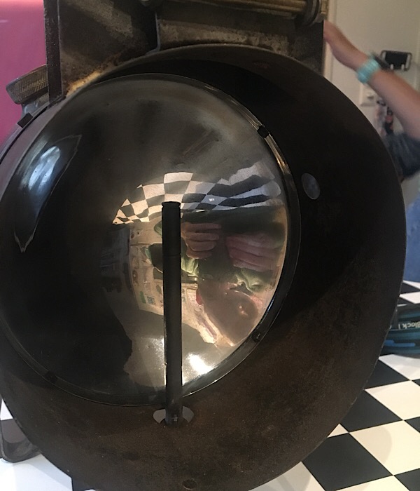

    Hi all

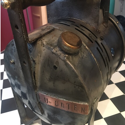

    I‘m new here and want to show you my latest addition.
    I‘m not really familiar with Tilleys but I think it‘s a AL21. Used by the Swiss Railway.
    Unfortunately the complete pump and the burner is missing.
    Are these hard to finde parts?
    Anyone can help me?
    Thanks in advance!
    Pascal

  2. KAB
    KAB Subscriber
    Mar 27, 2016
    493
    South East England
    I am ready to be corrected, but I believe you need a pump similar to those in the Tilley X246 range.
    My concern is why the pump was cut down and a copper plate soldered over it and what looks like a hole in the back of the tank below the pump?:-k?
    More useful advice will follow from other members soon :content:

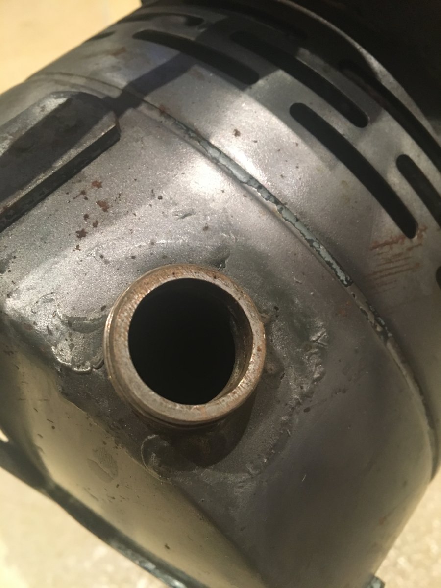

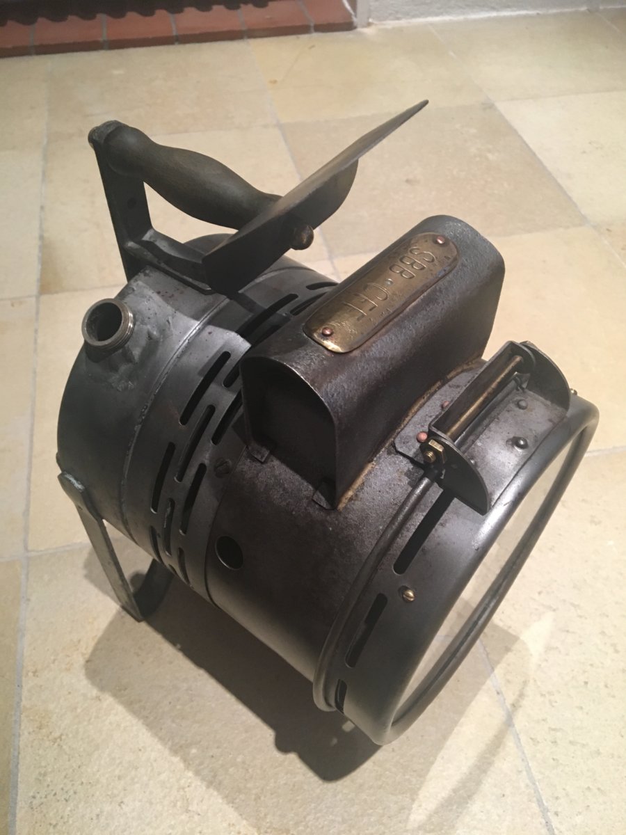

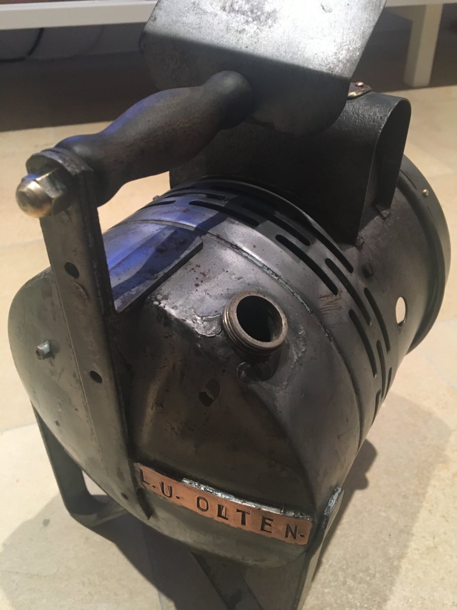

  3. bambulee
    Jun 19, 2016
    15
    Thanks for the reply.
    Here a few more photos..
    There is a filler cup instead of
    the pump.
    My question to the experts,
    looks the hole for the pump original or
    was it modificated?
    I have a 246 Tilley and this pump does not fit.
    Thank you.
    Pascal
    E7AA4A12-597E-4213-B9CD-62A8FDEB7B46.jpeg 53297169-840F-4079-B547-09E3445AD48F.jpeg 656A82C9-C9BE-4DE5-9AF7-08BCB25651DA.jpeg
    16,752
    Welcome aboard:thumbup:
    That's a great find and it needs a pump like the ones which are shown via the link below and they are common, the burner is less common but they do turn up.
    11 Styles of Tilley TL10 etc., pumps.

  6. listertrucks
    listertrucks Subscriber
    Apr 26, 2011
    138
    Looks like a stove blanking cap to me ?
    Al
  7. KAB
    KAB Subscriber
    Mar 27, 2016
    493
    South East England
    Ah, now I see it, the earlier pump with the female thread :doh:

    Hi all,
    finally I have all the parts toghether and the Tilley works as it should :-)
    After it run 1-2 minutes the glass cracks unfortunately!
    It looks like the glass was not original and not heat resistant.
    So the hunt goes on...
    Where can I finde a glass for the AL21?
    Thanks for any help!
    Pascal

  19. Henry Plews
    3,059
    @bambulee
    You could try here: Tilley lamp spares
    Look for: 604 type Toughened Bullfinch glass to fit AL21 £14.95
    I think it may be marked "Bullfinch" but it is the same size as the AL21 glass and it is heat resistant.
    Henry.

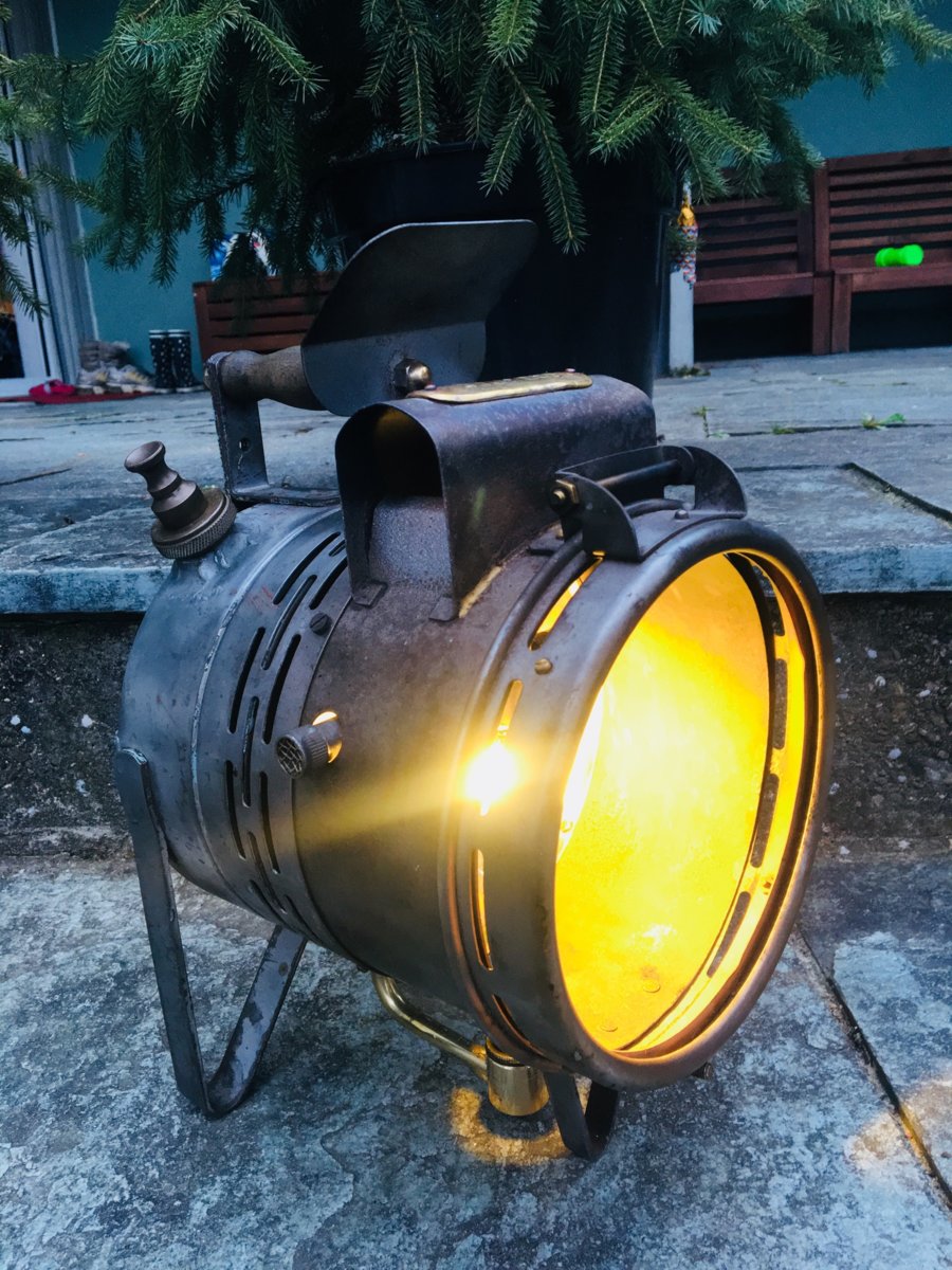

  23. bambulee
    Jun 19, 2016
    15
    the name of the webshop is ‚bisgaardnielsen‘.
    I cleaned finally the reflector.
    Now it‘s a super bright lamp!
    Such a cool toy :)

    Jun 19, 2016
    15
    Yes exactly, I have a few 190 mantle that came with my FL6. Fits perfect and is very bright!

    Jun 19, 2016
    15
    Tilley AL21 project is done.
    I got the glass today!
    Hell yeah!
