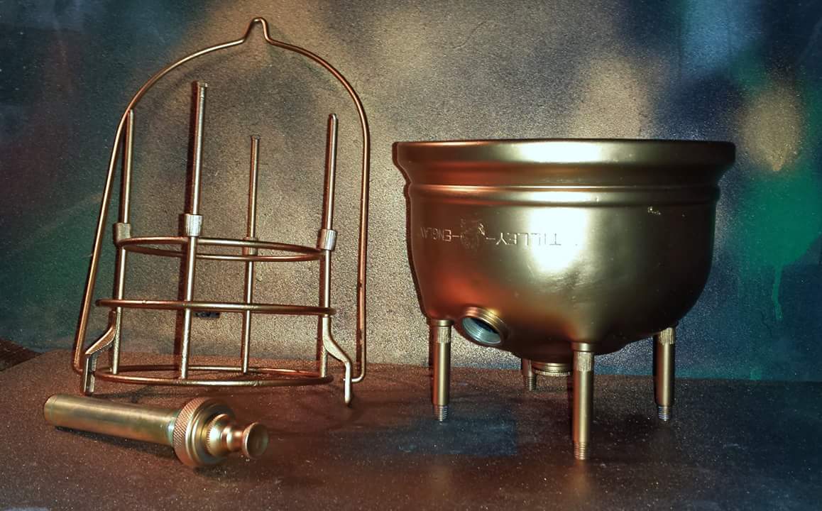

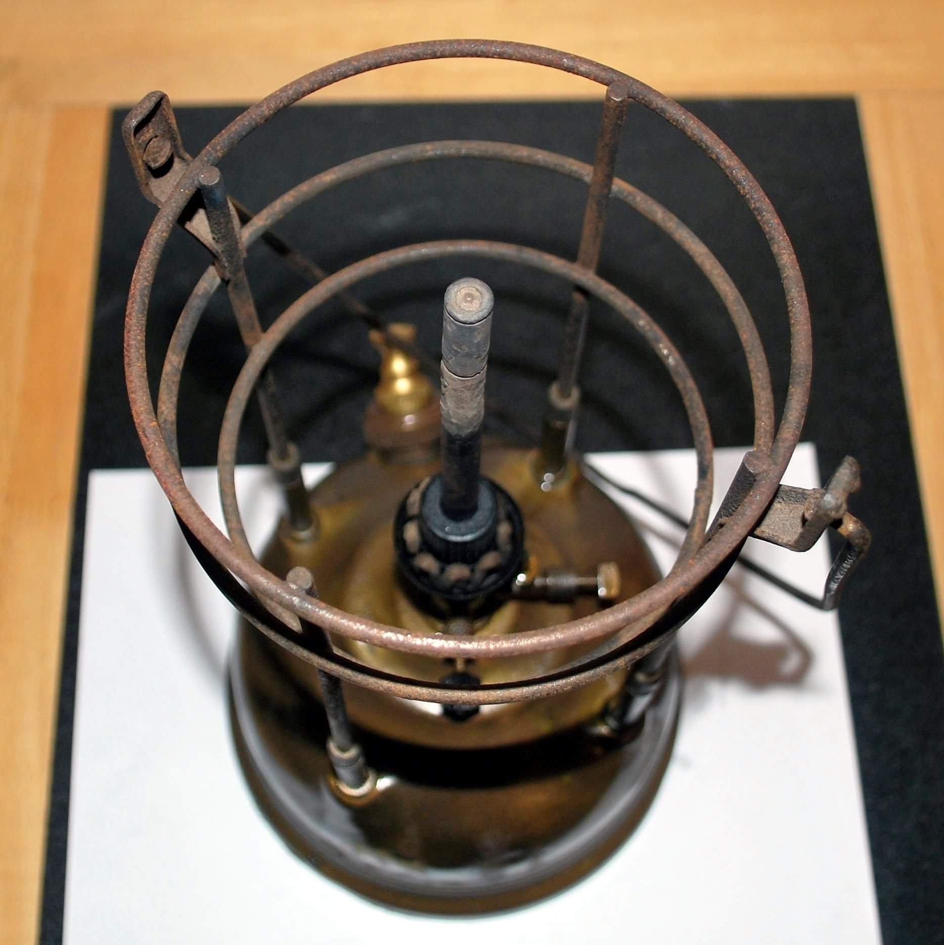

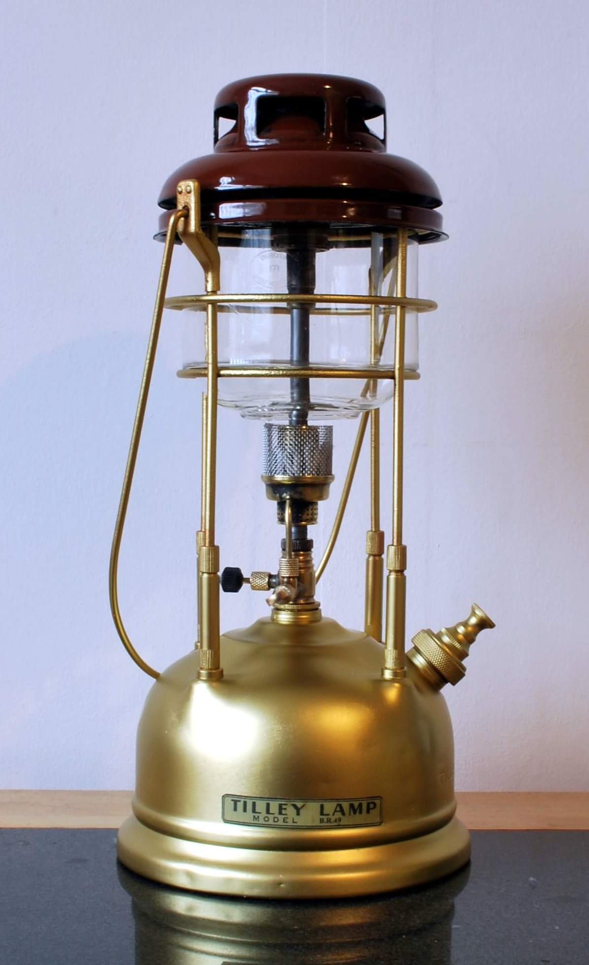

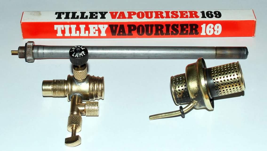

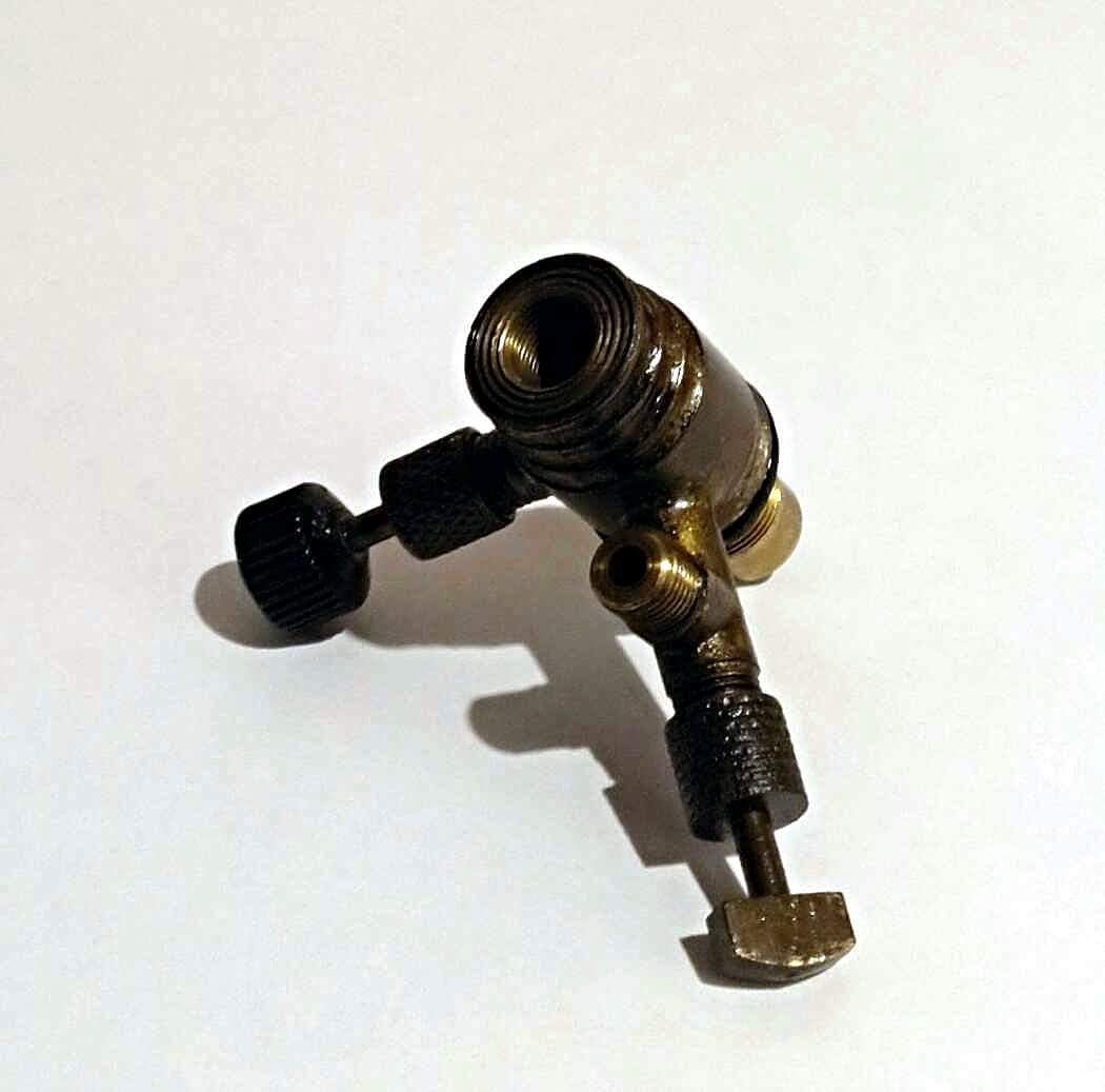

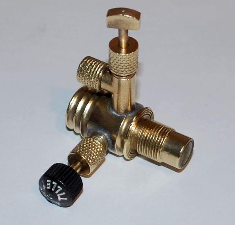

    Managed to get a BR 49 from eBay. Just needed a clean up and respray. Missing the wick cover as is so often the case. Made a stop gap from brass mesh as the lamp is only for display and will not be used. Hood was in good condition for a change. Fitted a new vaporiser purchased from Tilley just in case I change my mind about using it. Though I would still pre heat with me the.

    looks like Stainless mesh rather than Brass mesh :-k guess it's the camera trickery ](*,)
    Nice job though Stuart :thumbup:

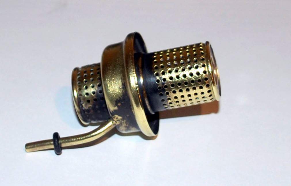

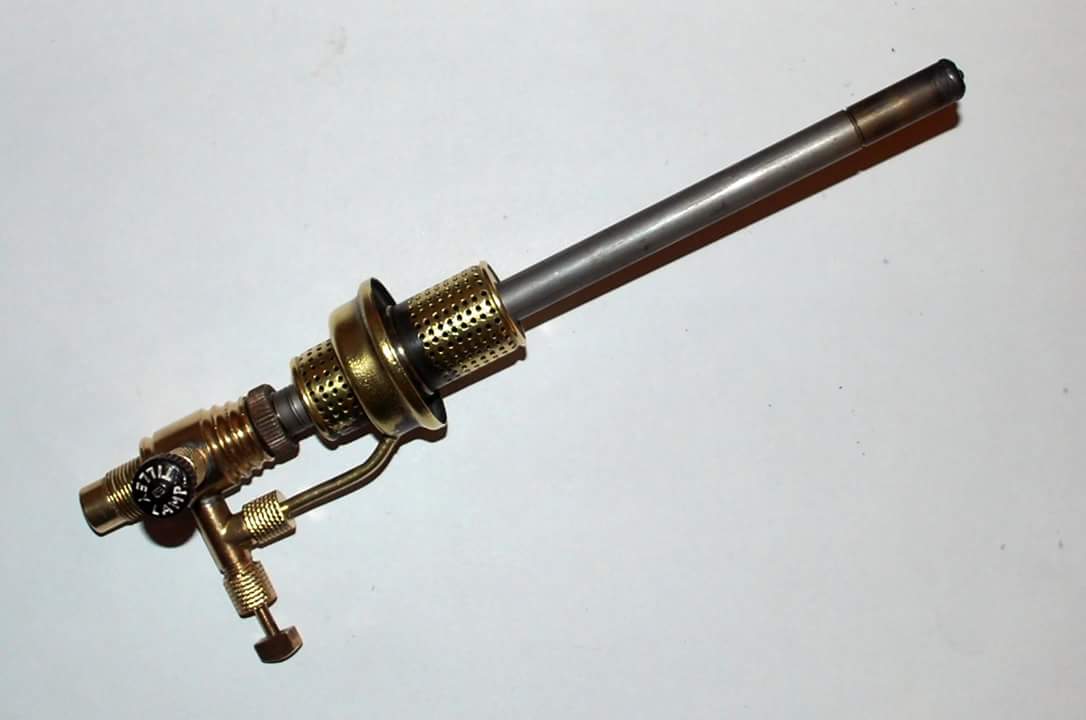

    Very interesting lamp and very well restored! Is the burner assembly different to the X246 ?
  9. Stuart Taylor
    Apr 19, 2015
    207
    Fife, Scotland
    The burner is the same as the usual X246. The control cock has an extra valve to allow Paraffin to the small tray at the base of the vaporiser. The tray contains a wick which provides pre heating without the need for me the.The lamp uses the longer 169 vaporiser.

    Hello that looks fantastic can you tell me what type of paint you used on the hood and base thanks

    There really isn't much you can do with the hood unless you have it re-enameled, which I guess is possible but I'm guessing expensive, I'm not the original poster but I did do a similar restoration recently and I used Ford Arizona Gold by Hycote (fairly common brand)

    6,040
    @Buggerlugs
    It’s hard to get an exact colour to the Tilley gold, but in Australia “VHT” brand Universal Gold is pretty close.

    And did you paint the hood? if so what colour is it? please

    There is no paint that will last on a Tilley hood if you use the lantern. I've tried many...
    The hoods were enamelled. These days I use stove black on the rusty bits.
