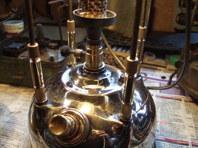

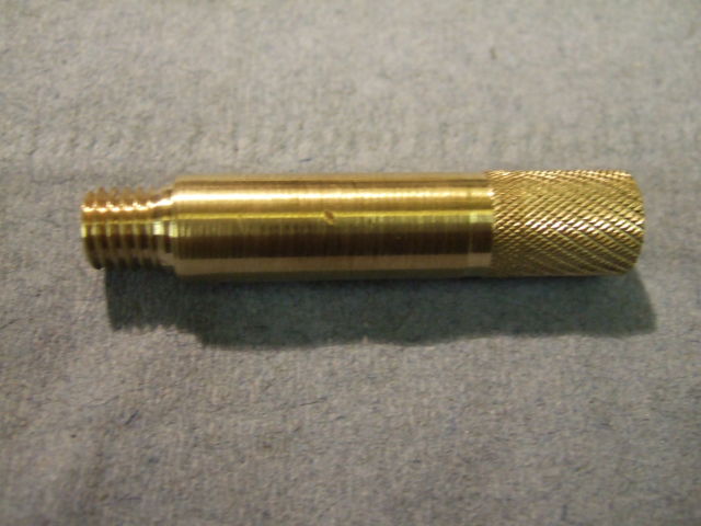

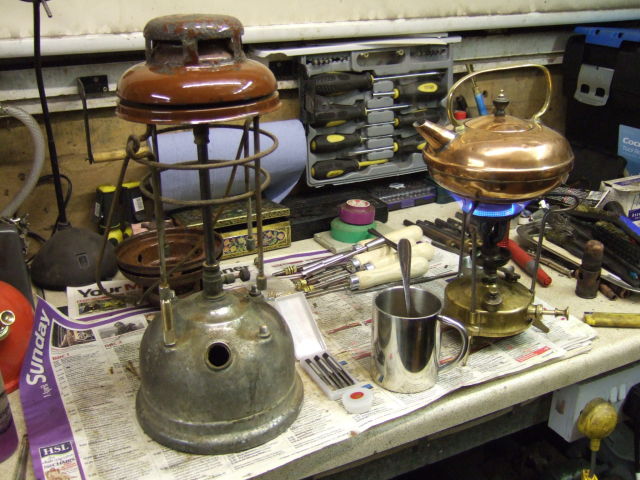

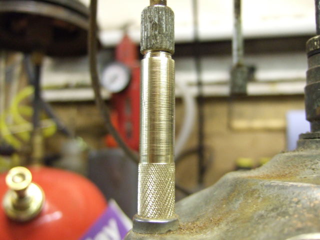

    I have just made my first set of riser pins to convert a Guardsman lamp to "BR49" spec using a Tilley 169 vapouriser , the Guardsman lamp seems to perform better with the longer vapouriser 8) :thumbup: but you need a set of the riser pins to raise the globe holder/cage so as it all fits together properly 8) :thumbup:
    Here are a few pic's of the first pin i roughed out , the next ones will be polished 8) :thumbup:
    MMMMMM & time for a quick cuppa :D while doing a test fit :thumbup:
    A set of pins to do the conversion will be £16.00 inc postage to the UK ( plus £2.00 if you are overseas ) shout me if your interested in a set :D :thumbup:

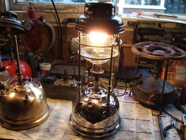

    The finished items fitted to a Guardman lamp
    Stu :D :thumbup:
