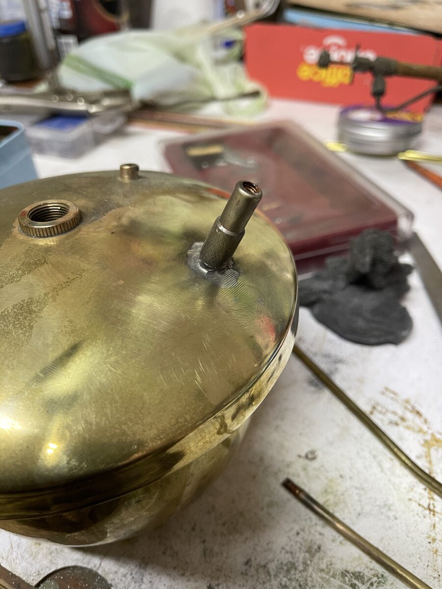

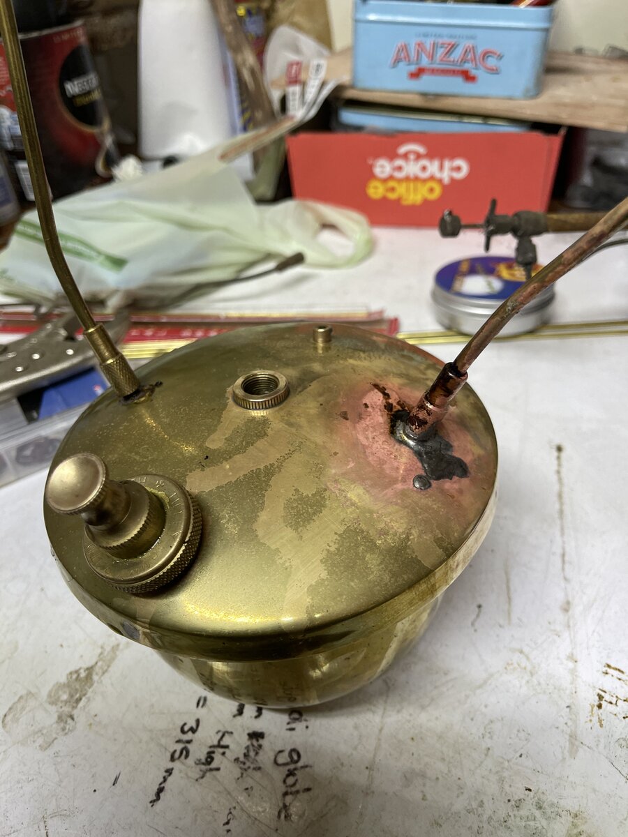

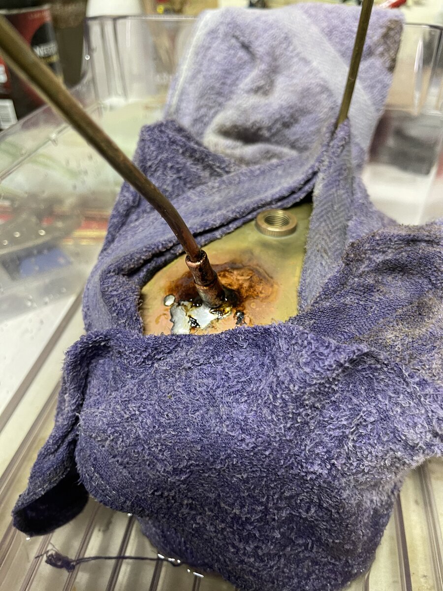

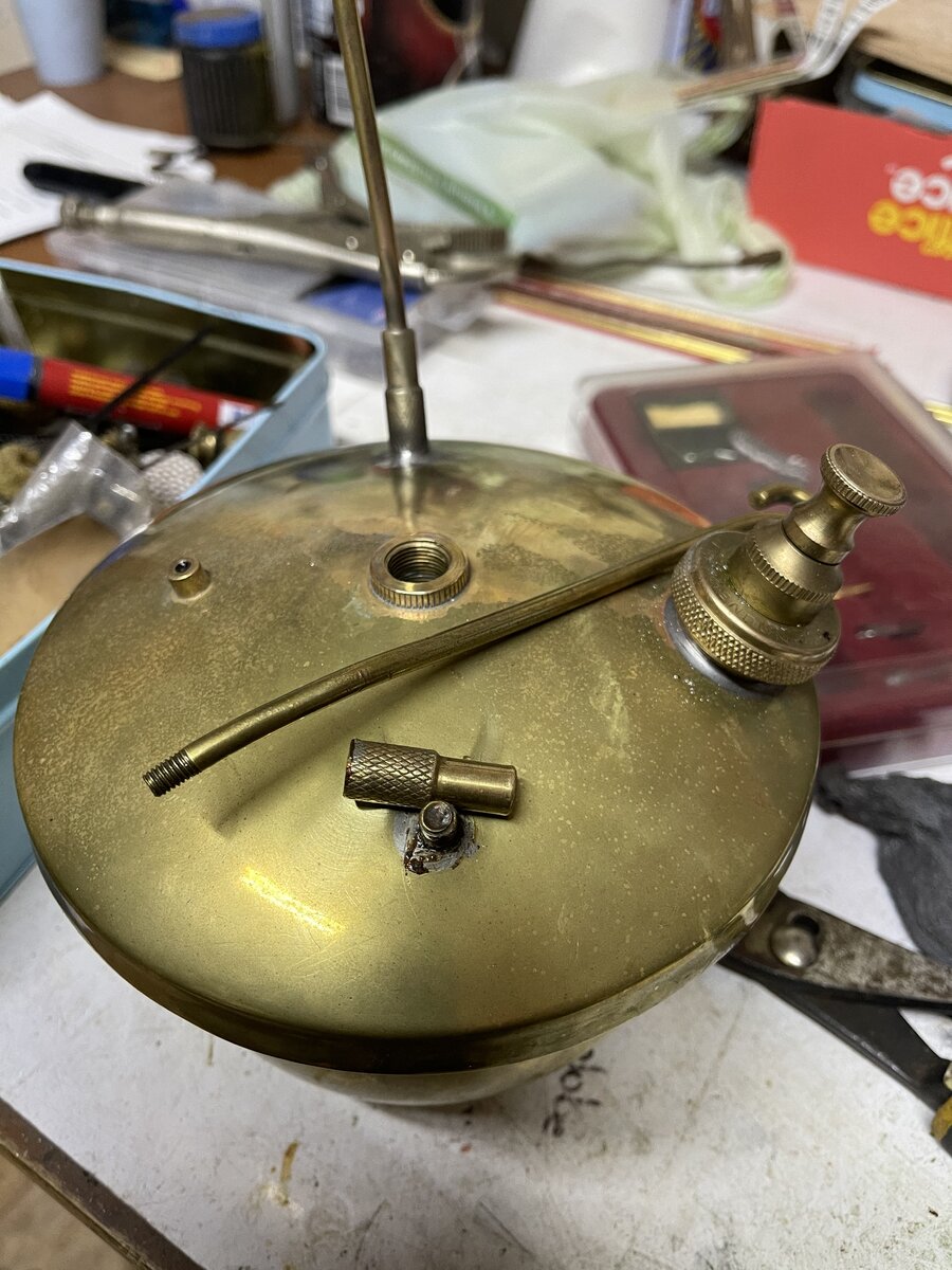

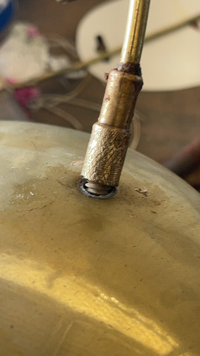

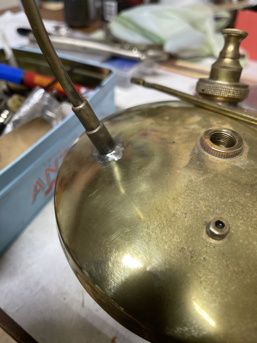

    Hi fellas, I’ve taken the time out to repair my Ex93,
    A note of future reference
    The bail arm screws into the bale lug that intern screws onto the font threaded lug.
    This is where I went wrong checking for leaks in the first case.
    Repair
    I covered the whole tank in a wet towel to help limit the heat to other parts
    a bit of preparation, I know it looks messy but it is set and stable. I water tested it a few times it didn’t leak. Successful.
    I set about cleaning it up, looks better the lug is now permanently attached.
    I’m pleased with the outcome
    1285F5F1-5C52-4081-9E09-36985A40EE9A.jpeg F5F5F554-82D9-482D-811B-72FF4D960FD4.jpeg 58473A3F-C5E7-4497-8512-516CBF053038.jpeg C50E9328-59E0-489A-A6F3-6C9CECBE4BC4.jpeg

    The repair looks good.

    It lives! Looks like a job well done :thumbup:

    Well done Darryl, well done indeed.

    Well saved!:thumbup::thumbup:

    Looks like a nice repair you've done!

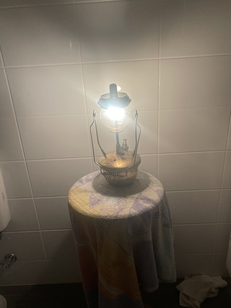

  9. Fireexit1 United Kingdom
    3,213
    The proof of the pudding, as they say is in the eating ! :D/
