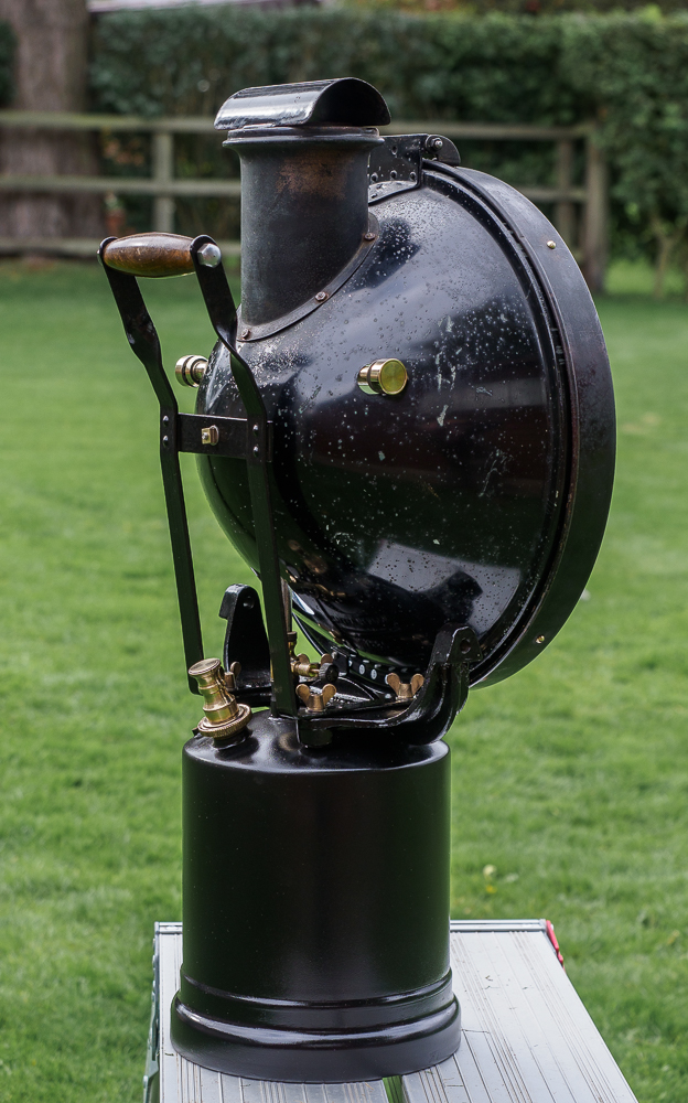

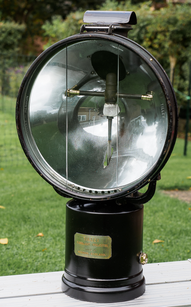

    I recently acquired a lovely old FL5 from a regular contributor to this forum. Apart from the short stand and the wire glass protector it is now finished. I did not want this lamp to look new so took the decision to leave the rear of the reflector as is (apart from cleaning). However the tank was in dire need of refinishing so I tried to create a "used" effect which I am pleased with. I believe it dates from circa 1937 but perhaps one of you experts will guide me further.
    Oh yes, and I got the fuel gauge working too.
    I fired it for the first time today and it runs superbly. I will try and post some after dark shots later.
    Anyway, what do you reckon?

    The FL5 was late 1934 to late 1936.
    The first ones had the single air tube burners, then there were transitional one with two air tubes and the hole in the reflector for the single patched up and then they went to double air tube like yours.
    The stands for these are the same as the FL6. Short and tall.
    Very nice lamp and very original.

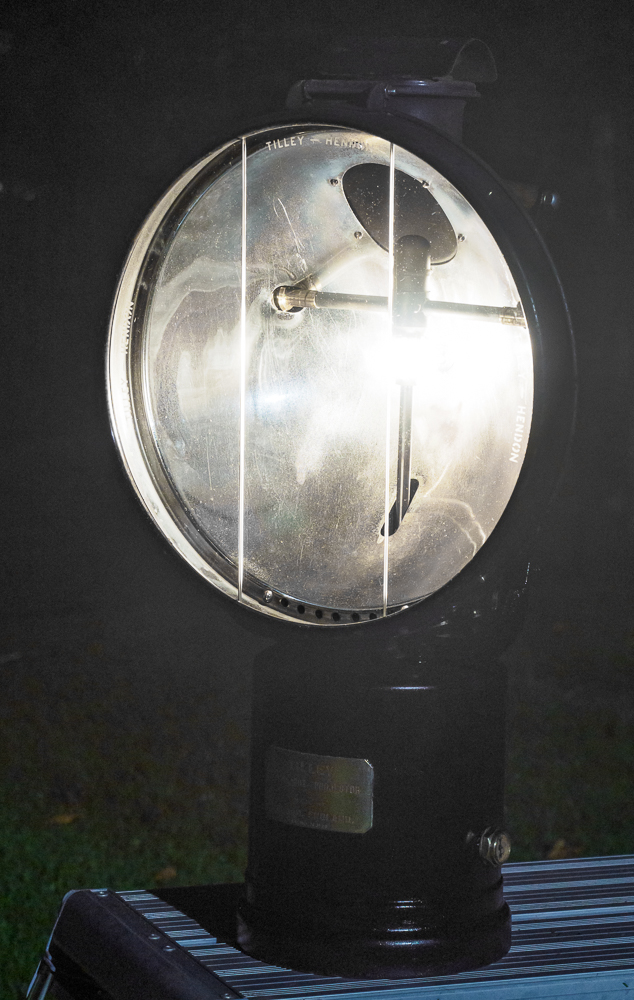

    As promised here are a couple of after dark shots. Whar a lovely light these lamps produce.

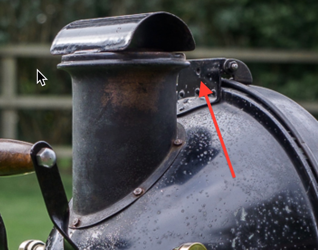

    If you were wondering why the hole in the door hinge, it was so you could take the frame from the FL4 and have a front to back handle.
    (Would be able to hang it far easier too)

    Thanks Anthony. My lamp doesn't have the hole on top of the hinge.
    It is such a wonderfully over-engineered lamp. The cast bracket atop the tank is immensely strong!

    Wow, you have great eyesight! I was looking for the "swelling" atop the hinge rather than the hole in the middle of the main part. The lamp is now reposing in my garage so I didn't have access.
