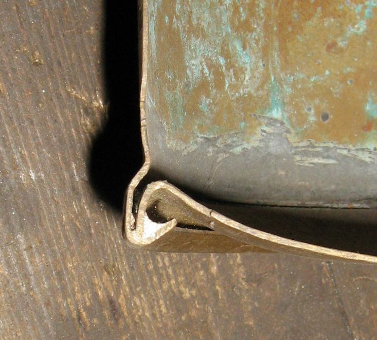

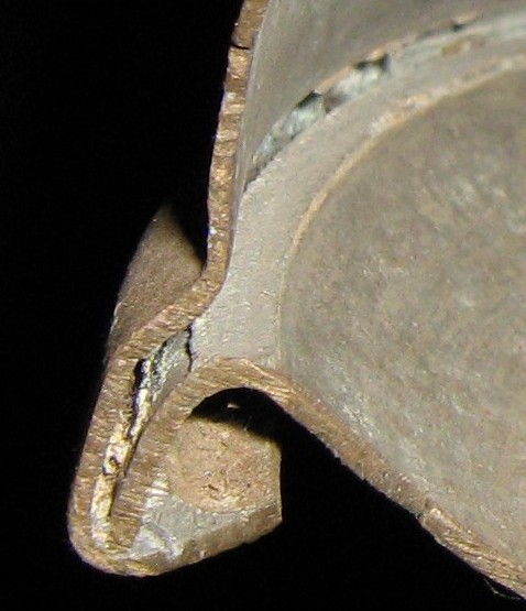

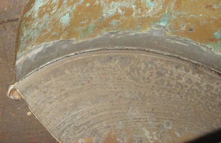

  15. BigStevie
    364
    Thanks for the photos Henry, very informative.
    Stevie
  16. AussiePete
    954
    Bloody hell, those pictures speak volumes. They would be very useful to new and old fettlers just as a reminder.

  28. MYN
    944
    This type of soldered + folded seam is quite prone to giving way as shown in the photos by @Henry Plews .
    Its not only found on the later Tilleys but also on others like the Petromax and clones.
    The subsequent result would be blown bottoms.
    Its might not only be due to an inherent design weakness but also the way and the quality of soldering. If it was not perfectly done during manufacture, it'll be a near irrepairable defect. Its definitely not easy to reflow the solder properly to wet all internal surfaces with the seam already folded. Or shall I say near impossible.
    A flattened bottom would quickly re-bulge once the fount is re-pressurized. That's due to the internal solder voids on the joint.
