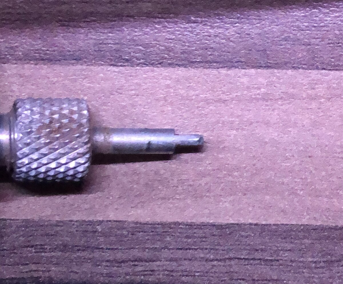

    My stem has not broken on the control, the stem coming out of the control is still intact. But, unlike yours, I don't have those indents in the end to engage the knob. Interestingly, my indents are most likely broken off.

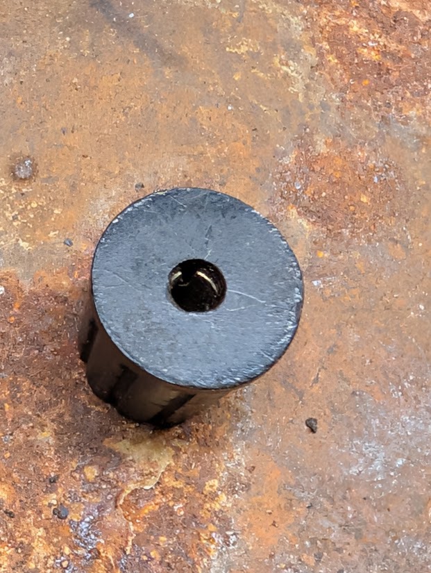

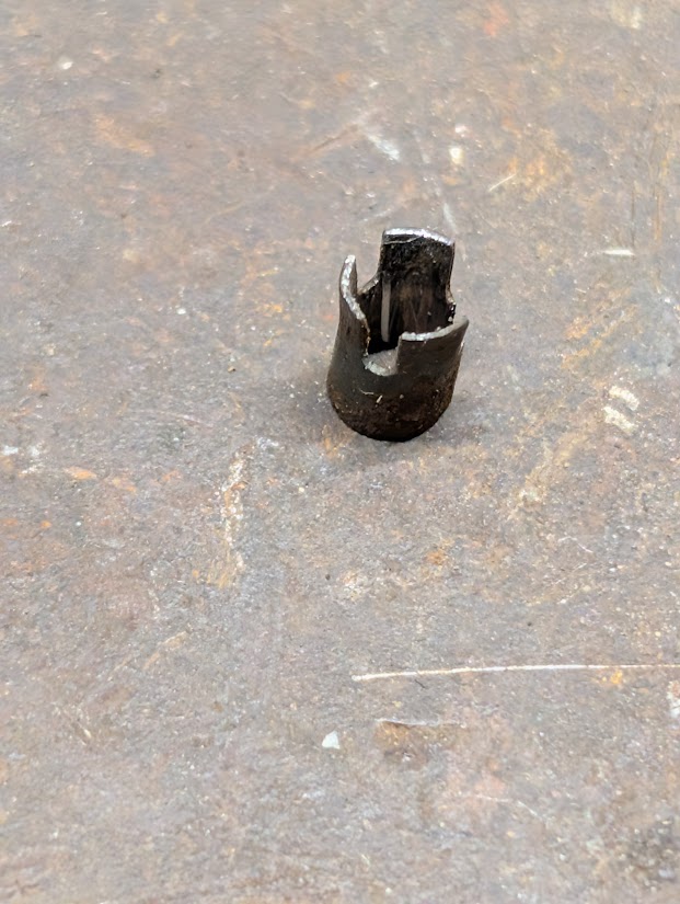

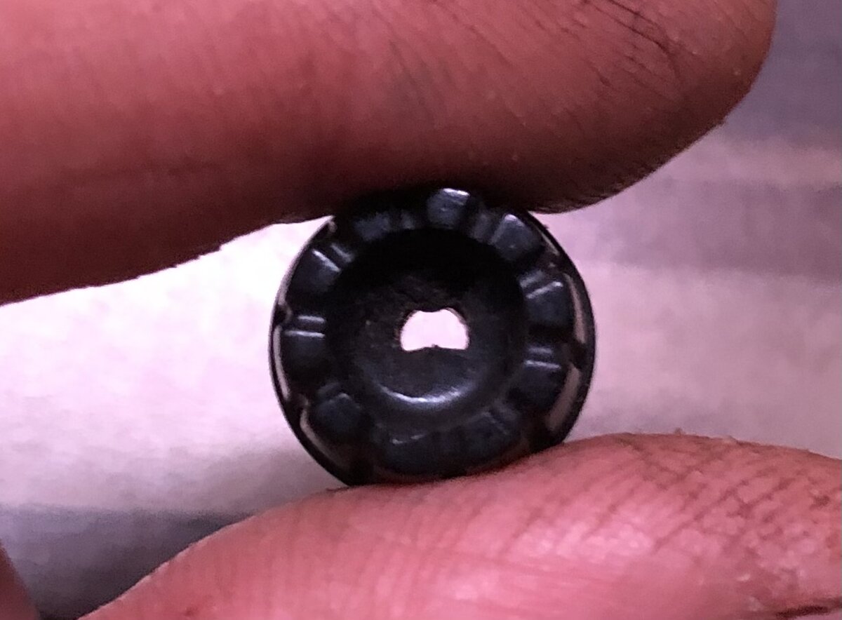

    This afternoon, I found that the spring? steel was still inside the knob, which is the same knob you're showing me in your picture.
    I pulled the steel out of the knob, and tried to tighten it with pliers, but that did not make it tight enough to grab the stem. I think my problem is that my stem does not have the indents that yours has.
    I'm attaching photos of my knob, in which you can see the spring steel inside, and then, the spring steel which I removed.
    My feeling is that this thing is going to continue to spin, since I don't have the indents that your stem has.

    i would carefully try to file them back on, if you have a small file?
    it’s good that you have the spring/spacer/clip thing

    I think I broke that shaft when I was removing the knob.
    Tom
  7. podbros
    3,874
    Pretty sure i have what looks like an unused one but with the tip missing somewhere so not uncommon?

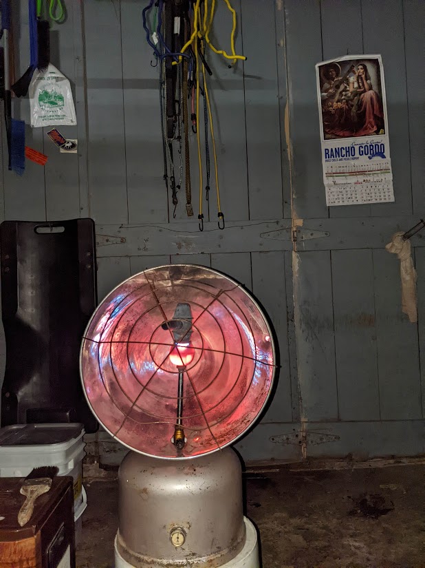

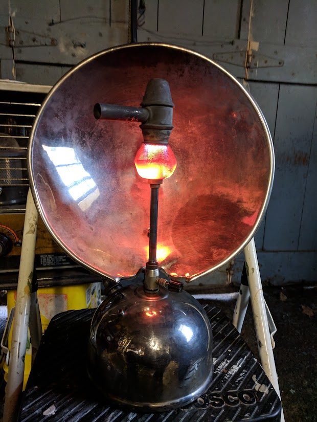

    I will post some pictures. I have 4 heaters. 1 small one, for which I also have the lantern head, plus three big ones, one of which, the one I've been playing with, is for parts. Im in New Jersey, and these things are hard to find in the US, or they cost a lot of money. Parts are expensive too, because they have to come from overseas. Unlike Coleman, which I can pick up at yard sales and flea markets, and use them for parts.
    Recently I picked up my two big heaters at a flea market in Pennsylvania, but like I said, one is for parts.
    I'm sending two photos of my small heater, and my large heater burning. Additionally, there's a video which I've texted around, but it seems like I'm unable to that here.
    I hope you enjoy the photos.
    Tom
  9. podbros
    3,874
    Thanks Tom !!
    great to see them doing what they were made for :thumbup::thumbup:
