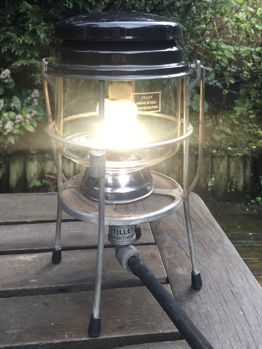

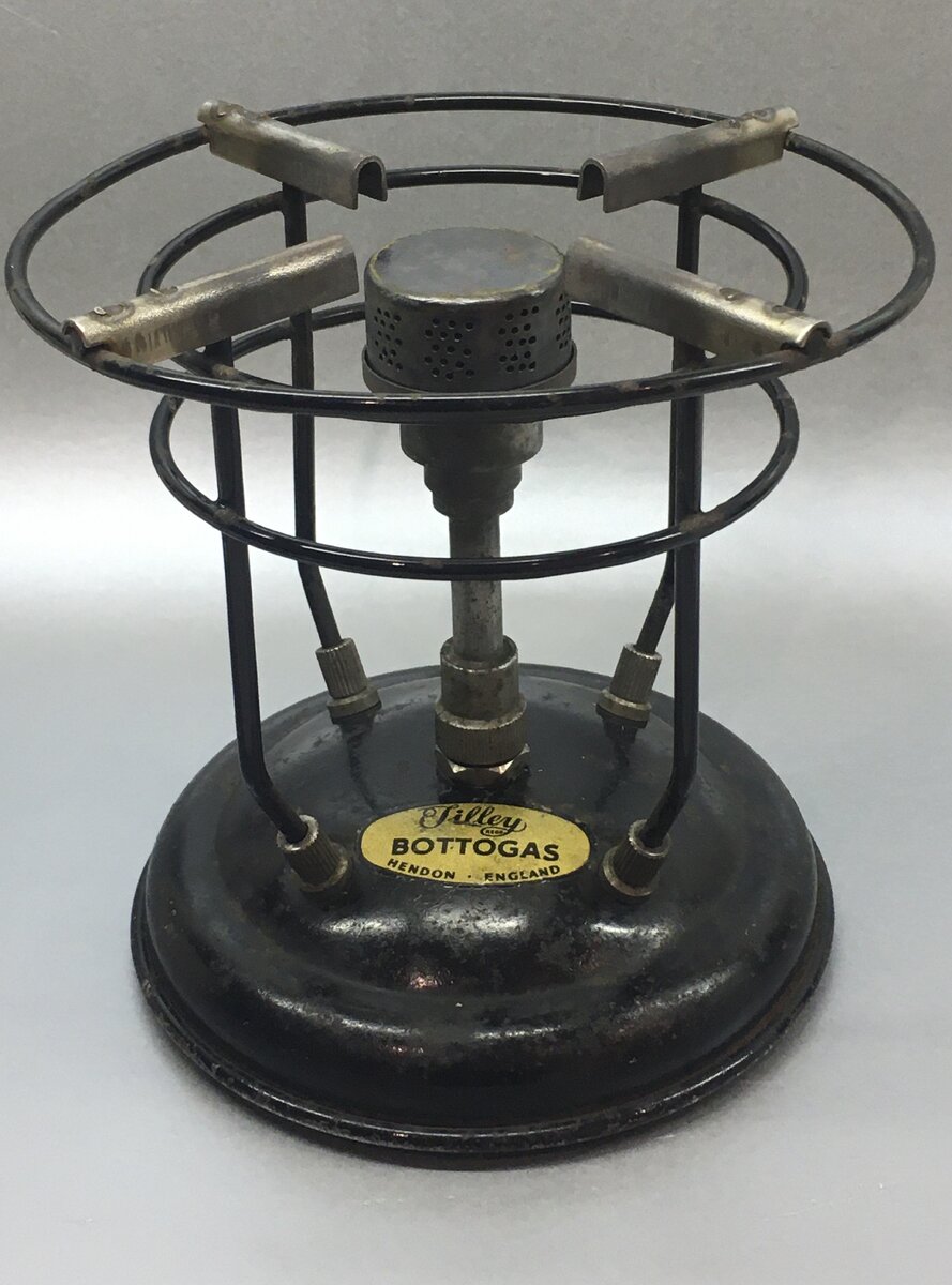

    Acquired by me as the Tilley/Bottogas stove, I’d already determined that the base plate fittings corresponded to the splayed frame attachments of a Tilley X246A, which is what I’ve utilised here, painted with gloss black brake caliper paint, together with a X246B hood and globe.

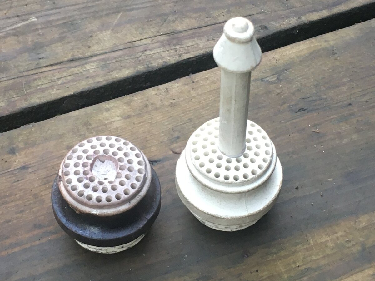

    The lantern ‘conversion’ from the stove is made feasible by the use by the latter of a lantern-compatible burner nozzle (left), though the nozzle (Tilley part 2084) required by the lantern (right) has the mantle support as seen in a Tilley GL602T butane lantern.
    Tilley GL602T.
    The jet nipple (No.11) 2088 and mantle 2085 are common to the GL602T also.

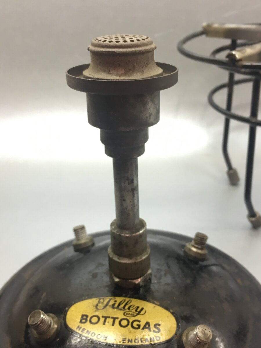

    Here’s the stove and associated components.
    The lantern-type nozzle serves as an inner cap for the stove and simply unscrews to substitute the Tilley 2084 pattern nozzle for conversion to a lantern.

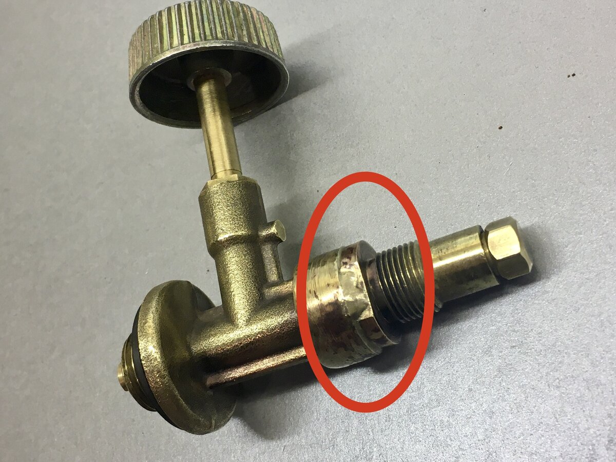

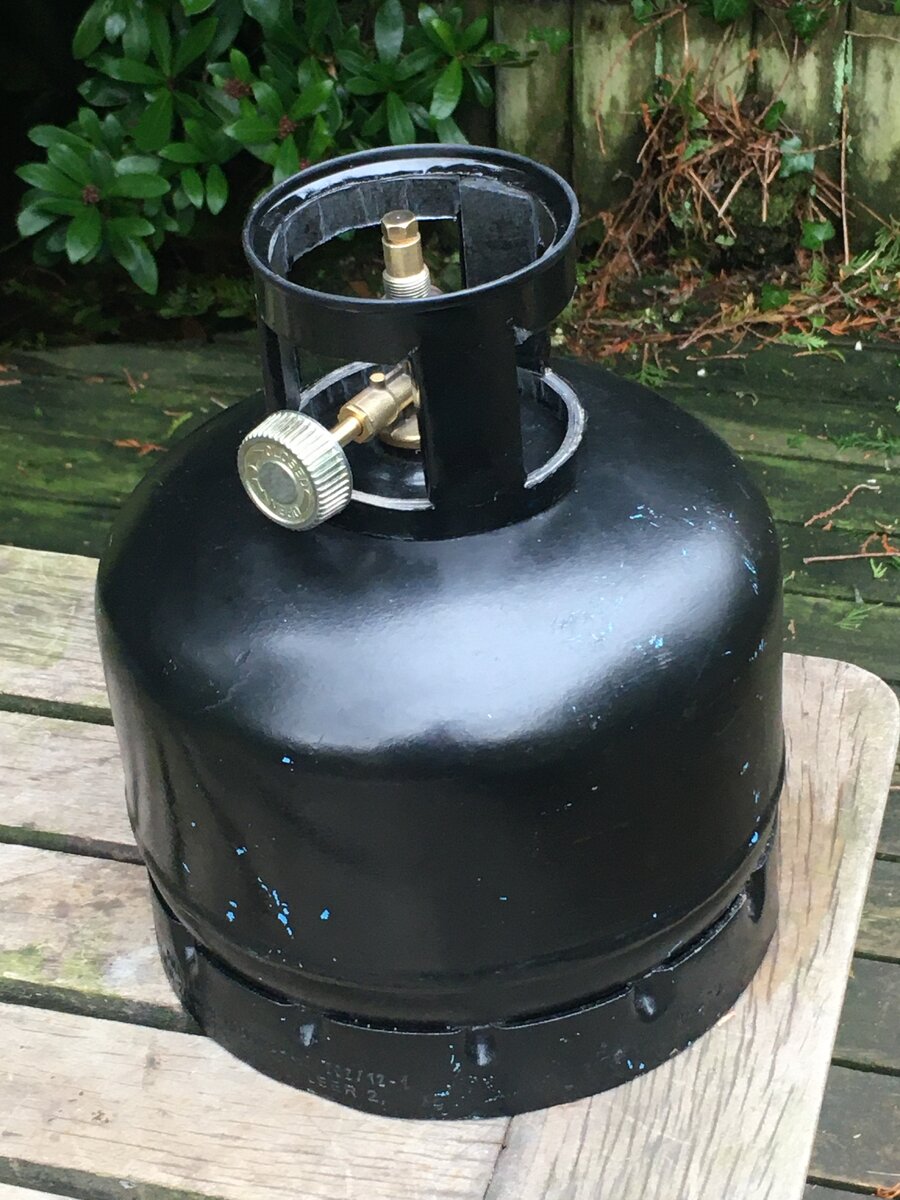

    With little or no chance of locating an original cylinder I adapted a control valve compatible with a Campingaz butane cylinder to accept the jet nipple mount for the stove. The joint ringed was hard-soldered.
    A Campingaz 904 cylinder (painted black) and a mock-up handle/support as a Bottogas cylinder would have had made a passable - but usable - substitute for the long-obsolete original.

    How long did this lamp burn for ?
  12. presscall
    1,543
    Lancashire, UK
    On the Campingaz 904 cylinder containing 1.8 kilos of butane and with a 0.2mm jet orifice, several hours Reinhard.
