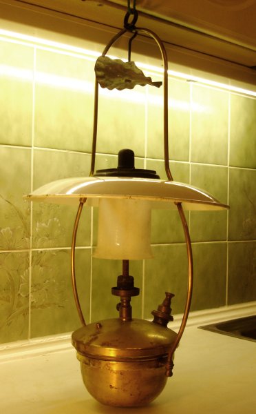

    My latest find is this KL80 which I think is a fairly early (1940 ish?) one due to the vitreosil shade, the "pringle" style heat deflector and the enamel shade. The preheater cup looks like it is off a Vapalux.

    Hello James, it's a fine example and it's fitted with an XN., control cock, so it's pre 1940, Jeff.

    Very nice KL80, luckily it arrived well which is a little wonder looking at the adventurous package.

    Now now Jeff [-X I have heard you say many time never date a lamp buy the removable part :lol: but I do agree with you :lol: :lol: :lol:

    You are correct of course and I assumed that the XN., control cock is complete, is it James?
    I have had Tilleys turn up which have the shallow control cock socket and the bottom half of the XN., control cock has been removed and it will then fit into the shallow socket.
    However, when that is done it's no longer a control cock, it's only a pricker control, Jeff.

    Yes the control cock is complete.

    Hello James, in that case your lamp is pre 1940, Jeff.
