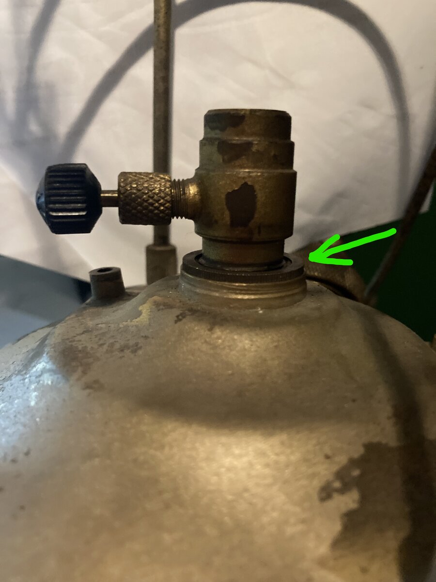

    Try screwing the control cock bush into the tank a bit more- there's a lot of thread showing in the photo, normally they're nearly flush.
    ETA; podbros just beat me to it!

    I have rebuilt four of these and all of them have the bush pretty much all the way in, like podbros and steerpike say.
  9. Tony Press
    8,114
    Now that it has been pointed out by @podbros, the control cock is set too high.

    Yes it does seem high but appearances can be deceptive. The socket in the top of the fount is only so deep, screw the bush all the way in and there will be plenty of thread showing on the control cock, screw the cock all the way into the bush and then screw that into the fount and there'll be plenty of thread showing on the bush.

    The adaptor bush flange is usually approx 1-1.5 threads above tank socket.(Loosen control cock and readjust) Try pulling outward on both sides of handle (does this lower the hood any)

    The flanged bush has no bearing on the height once the control cock is seated on its washer / seal ,if I screw the
    bush all the way home ,all that does is stop the control cock from seating properly .
    I will get an older cage and go from there . thanks all
  17. Tony Press
    8,114
    The bush is not meant to be screwed “all the way home”. It’s purpose is to allow you to ‘clock’ the control cock in the position of choice. This is achieved by screwing it down to a few threads above the tank fitting and then screwing the control cock down. The adjustment is then made by adjusting the relative positions of the control cock and the bush.
    I usually set my control cock with the knob in the centre of two cage legs at 90° from the pump on the right hand side.

    It's not the position of the bush that determines the height of the vaporiser. The seal there is on the cock not the bush/collar so the cock always bottoms out at the same height relative to the tank and frame. Because the bush has a much coarser thread than the cock it allows clocking the valve spindle but never alters the height. ::Neil::
