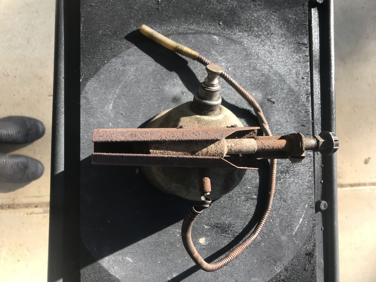

    I saw it and had to have it; now I need to see it alight. Missing the sniffer tube as always but I have an idea for a replacement.
    The newer style all aluminum pump is stuck together tight, as aluminum usually does. Has anyone got a secret to getting the pieces apart without destroying them?

    You will need this then John .... for when you get the sniffer tube sorted.

    Morning John,
    That’s a nice find :thumbup:
    I know some of the pumps had a screw down pump knob so may be worth a try?
    Heat is always good, perhaps just off the boil water first? Don’t know if that’ll improve things or make it worse :)
    They are common enough over here in Cheshire ;)
    12,285
    A fine fettling project.:thumbup:
    Try soaking the entire pump in vinegar, but check it regularly.

    What’s the length of that pump John?

  8. Rangie
    Rangie United States Subscriber
    Dec 8, 2012
    318
    Boil the pump in a pan of water, that's good for freeing aluminium.

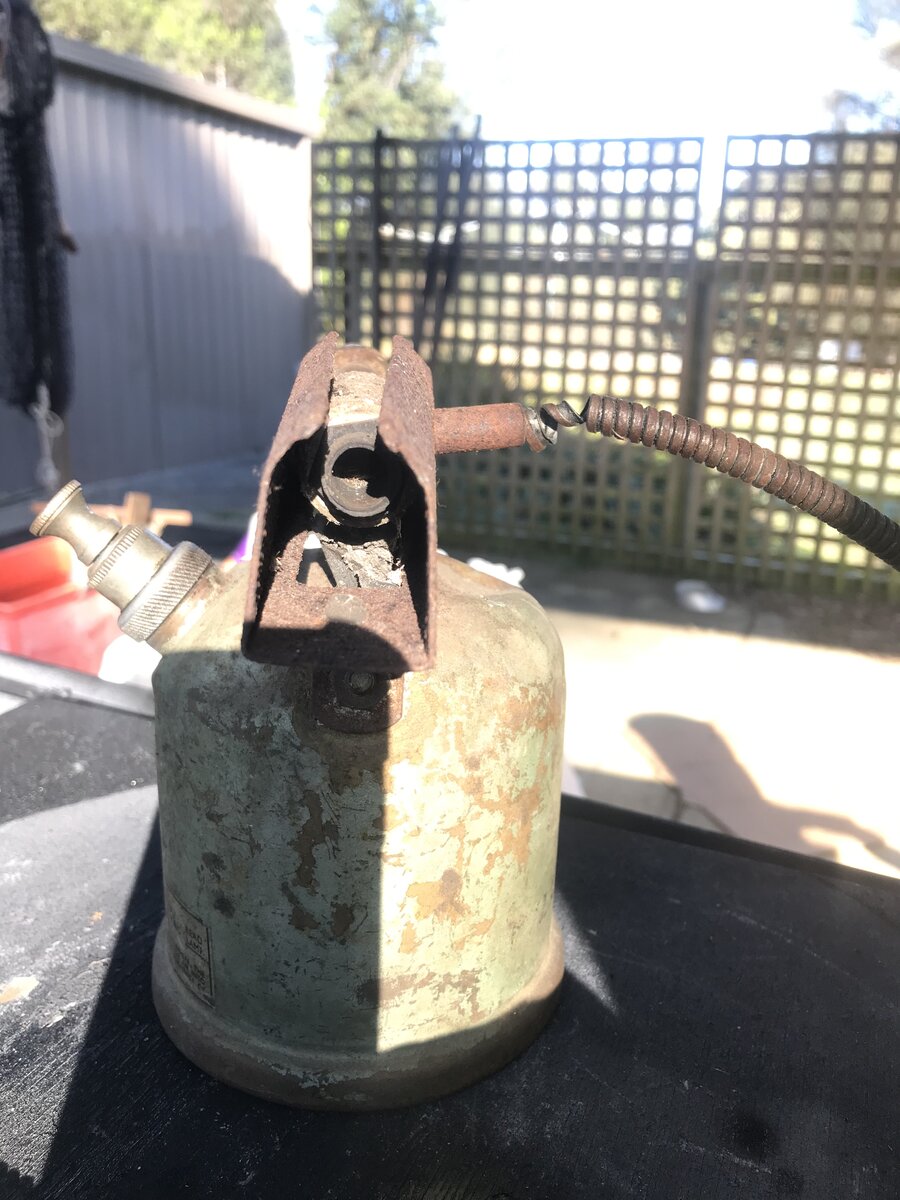

    :-k I wouldn't have thought anyone was seriously going to use an LD2 these days for either of its intended purposes.
    Is the burner 'shroud' on that version meant to be like that or has it taken a knock? On my LD2 MkI the two top edges are parallel...

    @Rickylee Yes, there is a burner part missing but best I can tell it’s just a tube to fit over the vaporizer and a tip to compress the flame. Should be able to knock one out without too much trouble, just have to muck about with the size of the hole.
    @Jean J I’ll have to measure when I get home but I figure somewhere between 10 and 12 cm. It appears to be all aluminum.
    Looks like I’ll be trying the boiling trick tonight; it’s currently soaking in penetrating oil.
    Sheet metal is easy enough to straighten and I like everything I own to have the ability to work; it cuts down on the spares pile. :lol:

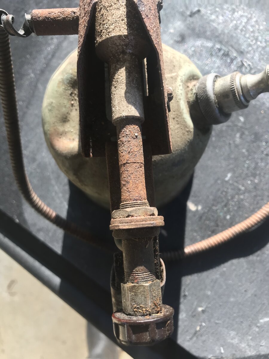

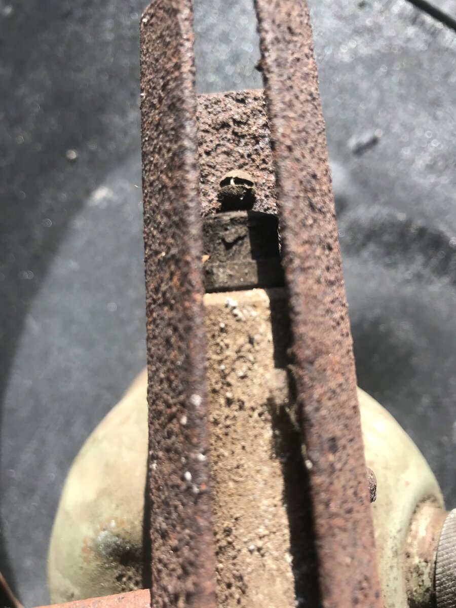

    This is the only picture that I’ve got so far; haven’t really delved into the gallery just yet.
    Appears to be a steel tube that is actually held in place by the hood with a brass tip in order to focus the flame.
