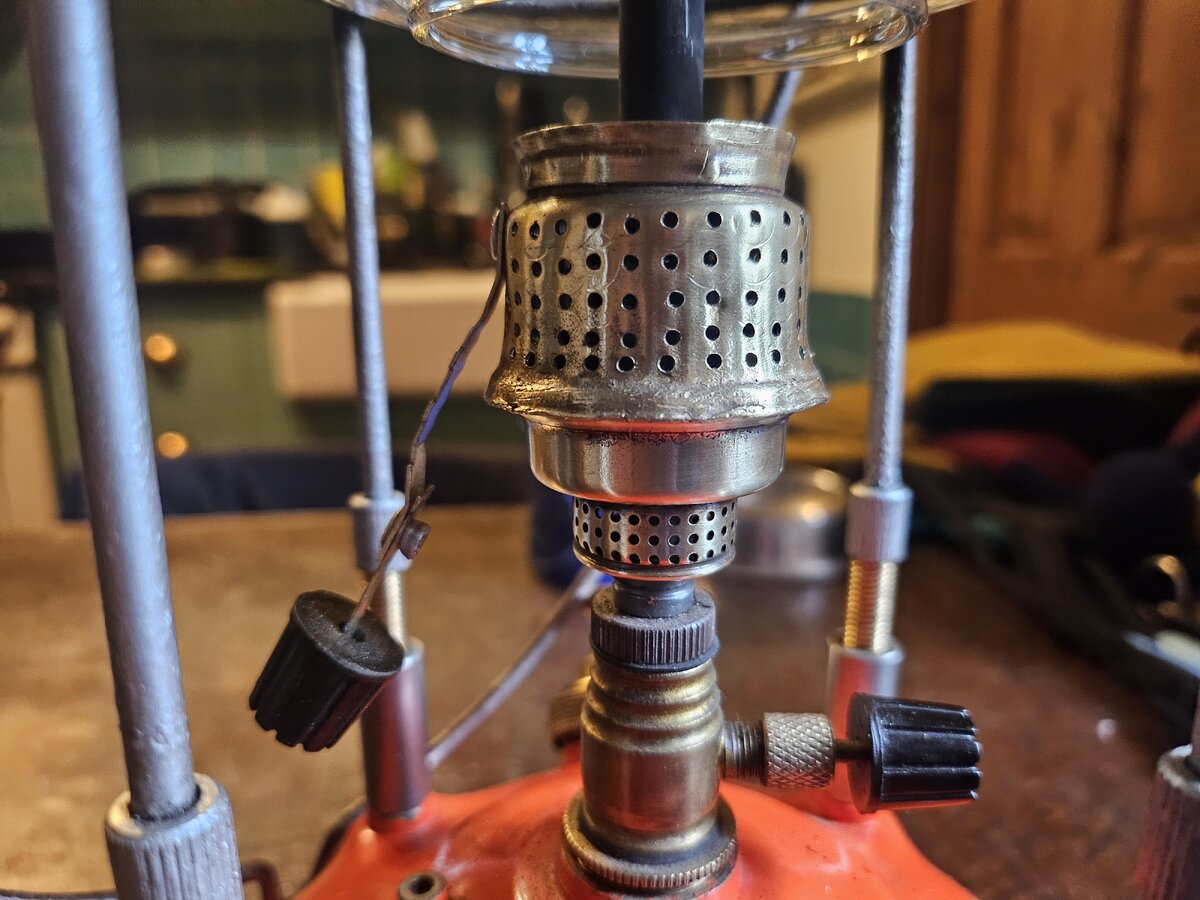

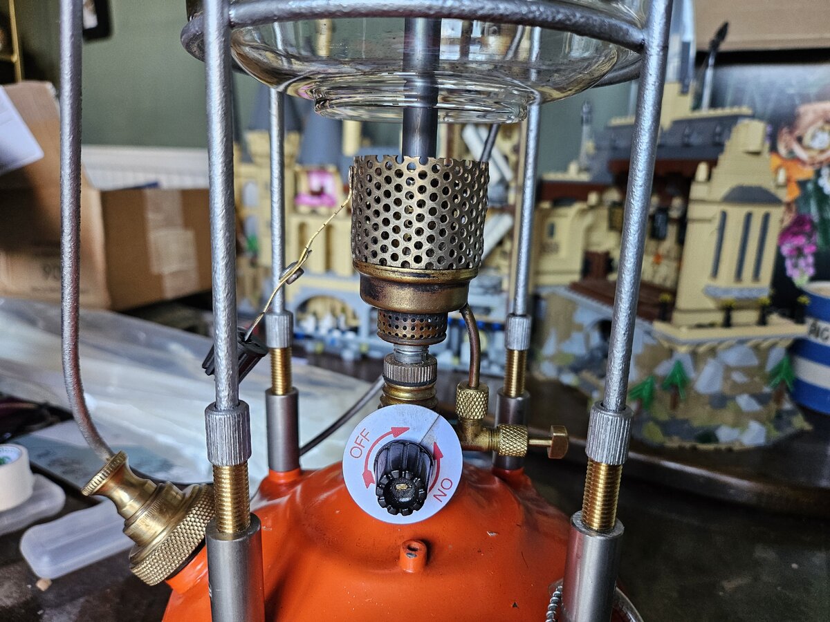

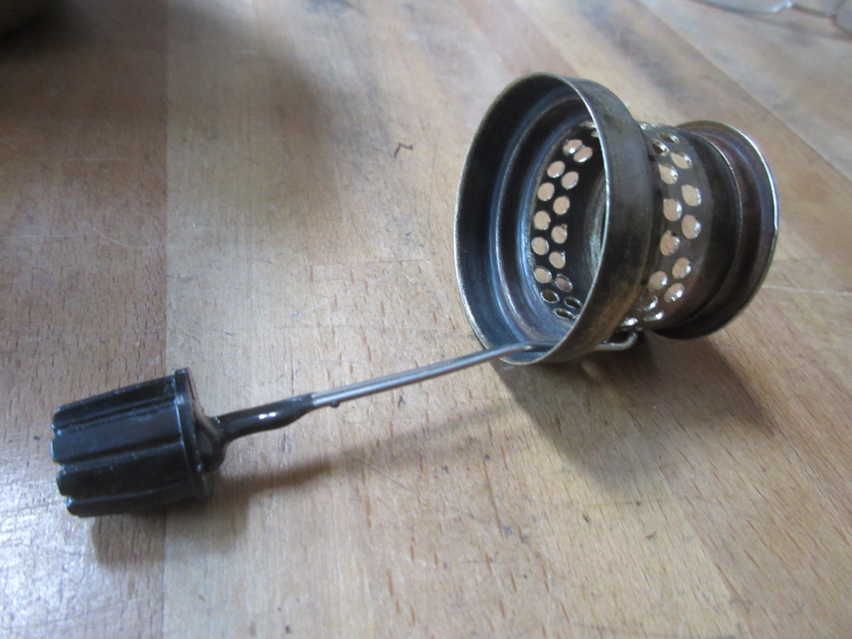

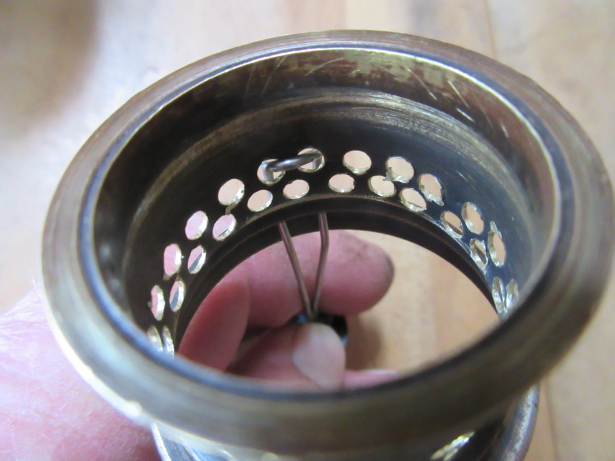

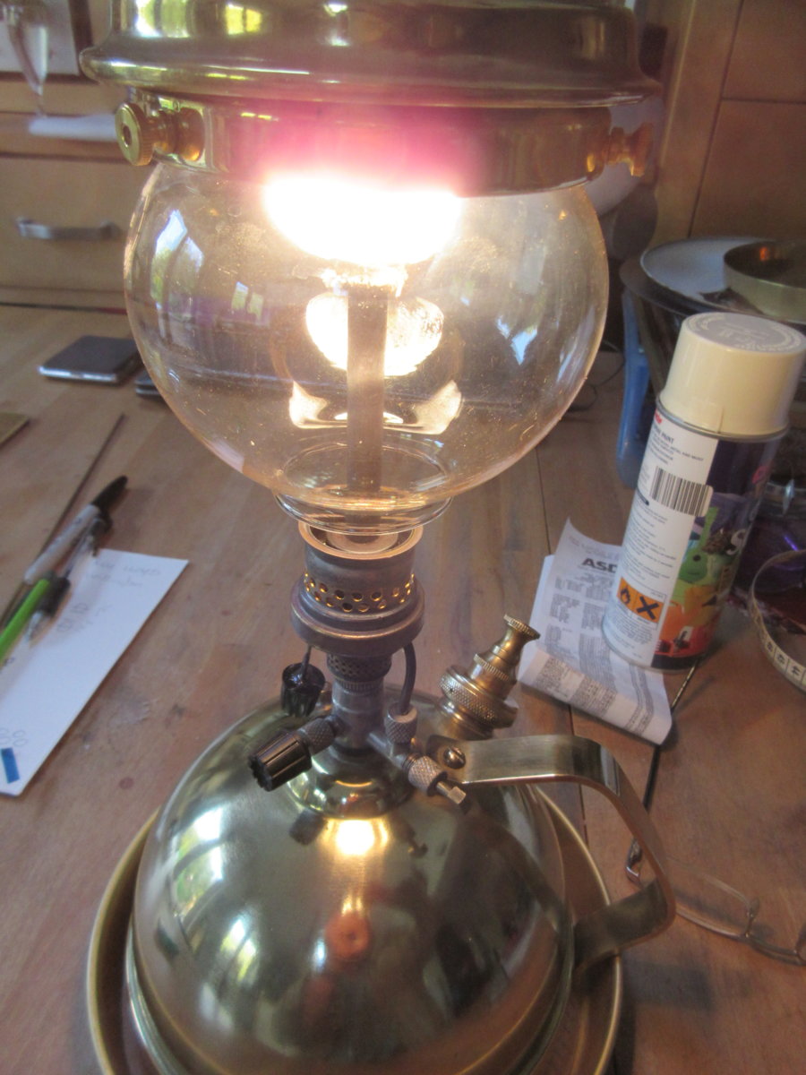

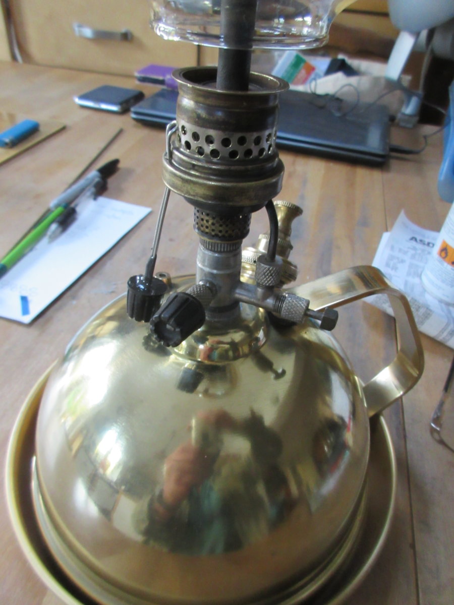

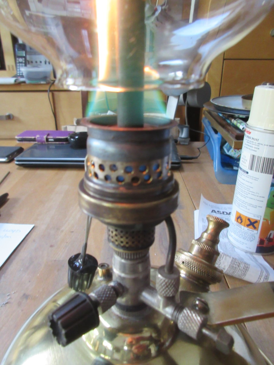

    Anyhow, I found that an Aladdin table lamp gallery plate was something like the right diameter, and just needed the outer perforated disc zizzing through with the Dremel, and a few(3mm) holes drilled round it to admit the air needed to burn cleanly.
    My first attempt at a handle became unsoldered very quickly, so I resorted to some 1mm piano wire configured so it'd pass through the holes and a couple more I drilled in the skirted area at the bottom. Some super-steel epoxy holds the knob onto the bottom. ( Leaning a IMG_6299.JPG IMG_6299.JPG IMG_6300.JPG IMG_6301.JPG IMG_6303.JPG IMG_6305.JPG IMG_6306.JPG IMG_6307.JPG little more towards authentic perhaps).
    Anyways, all is well, and all I need to complete this is the chimney collar, but the IL works Ok without. Yep, its pictured on a TL just for simplicity's sake.

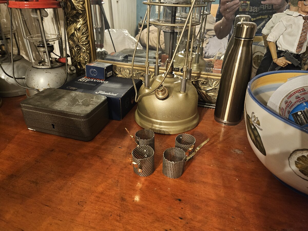

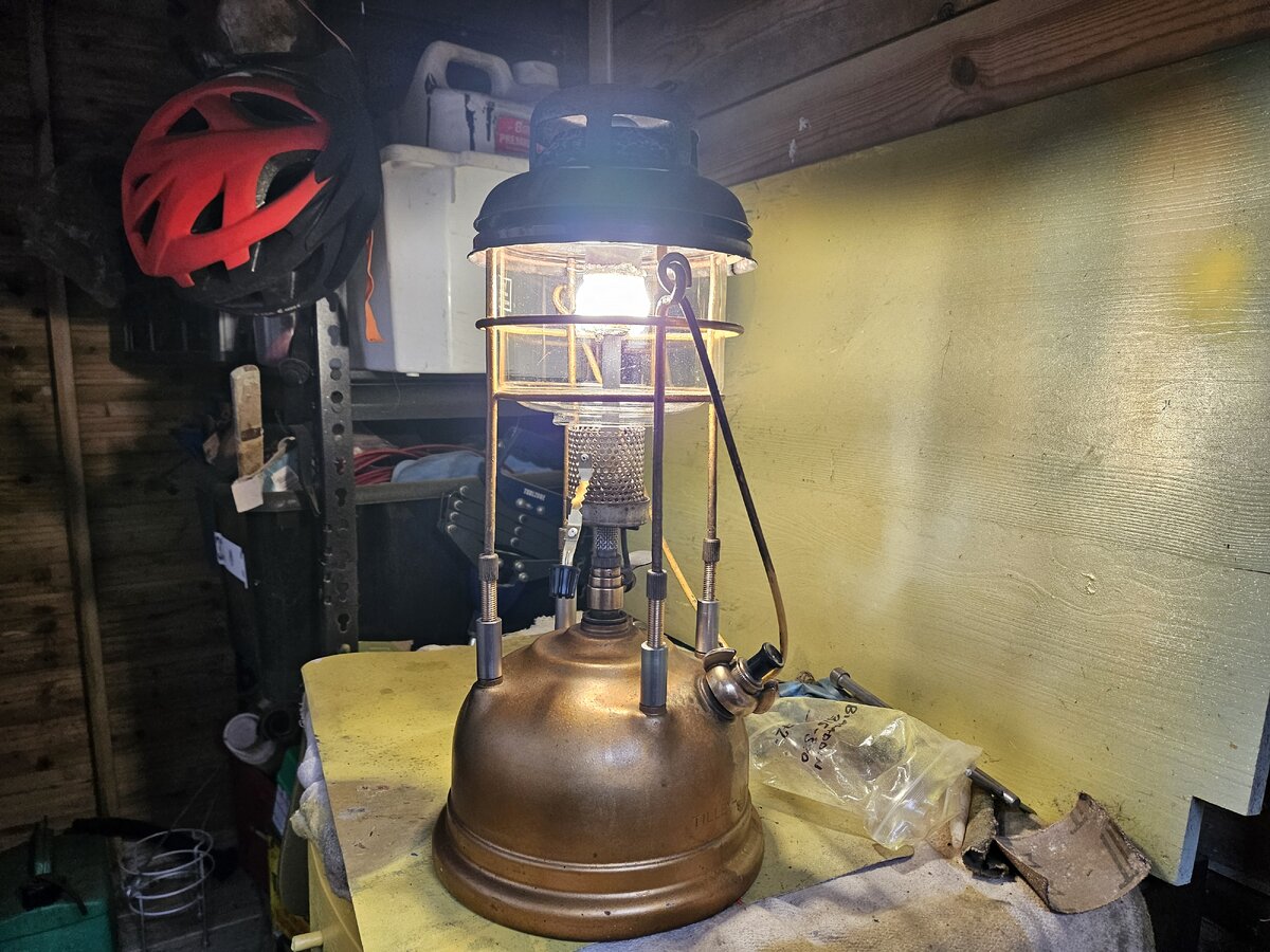

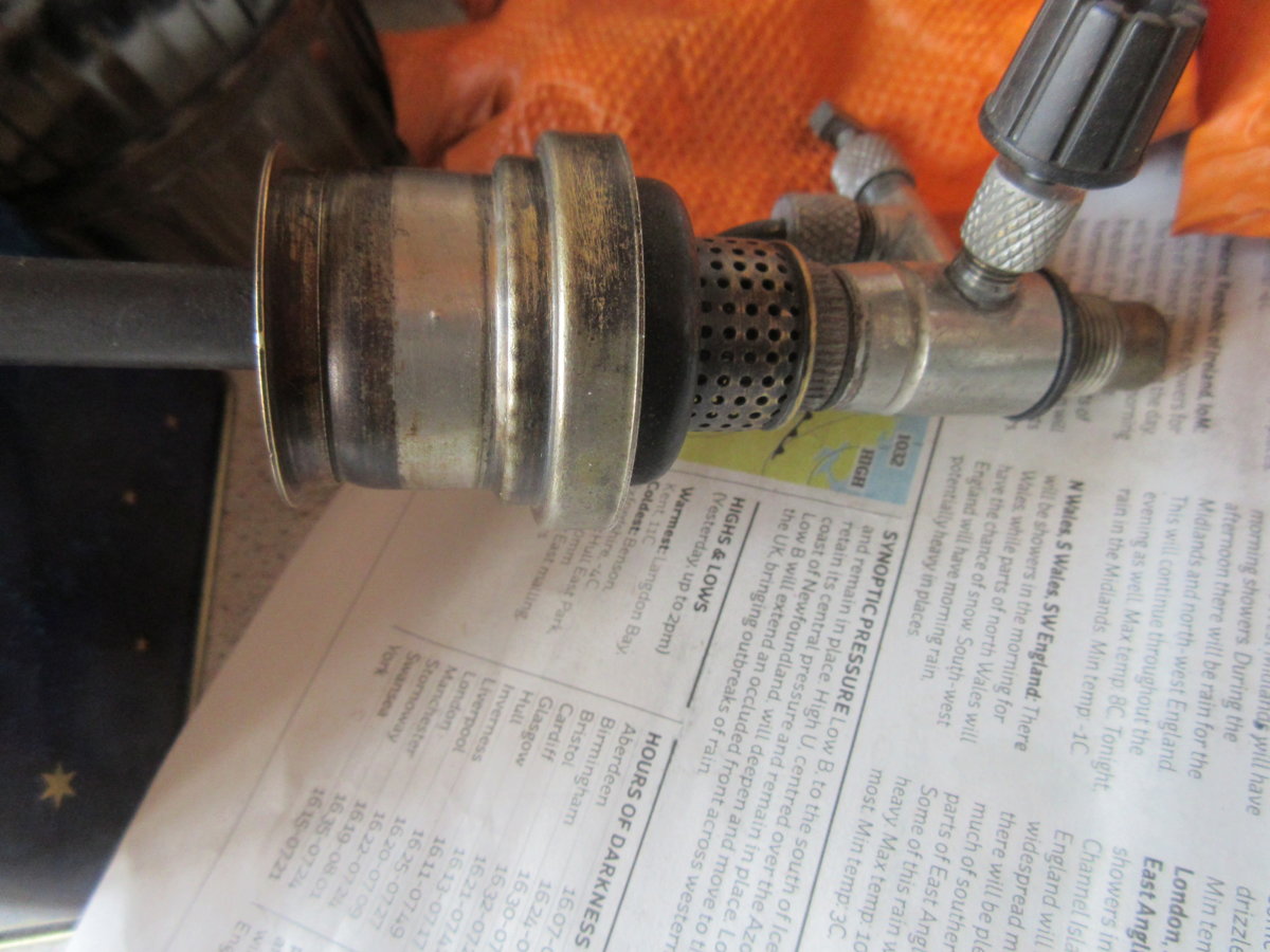

    Good lord, I only just saw this thread. I made my own too, but mainly to sit in a Vapalux spirit cup as a mock up of a BR49 with custom extension legs and 169 vapouriser. However, I also have one with 2/3rds of an original preheater, that I made one for which works ok, but can smoke a little. I'll make one out of an Aladdin gallery plate and see how it fares. Many thanks! 20250311_093728.jpg 20250313_153351.jpg 20250402_121828.jpg Pics for reference from separate thread.

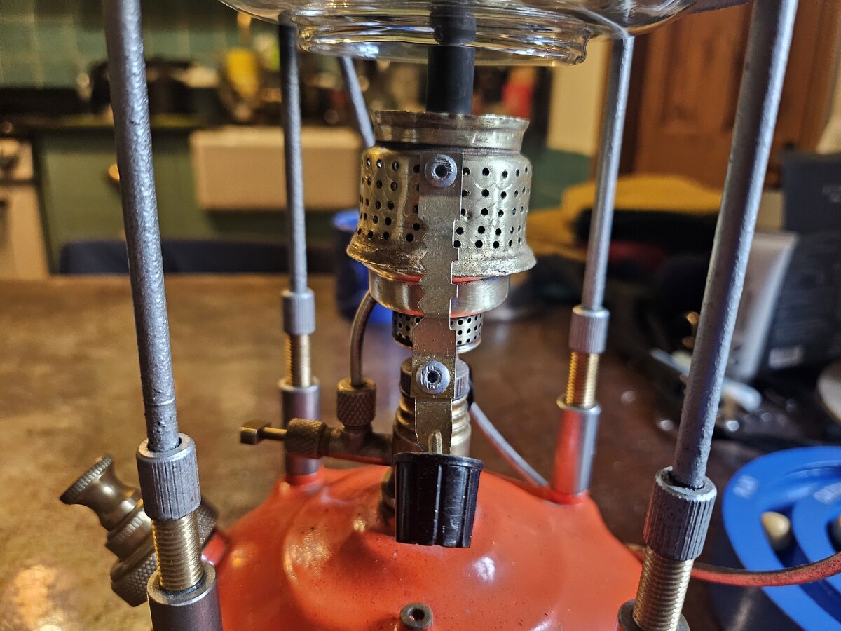

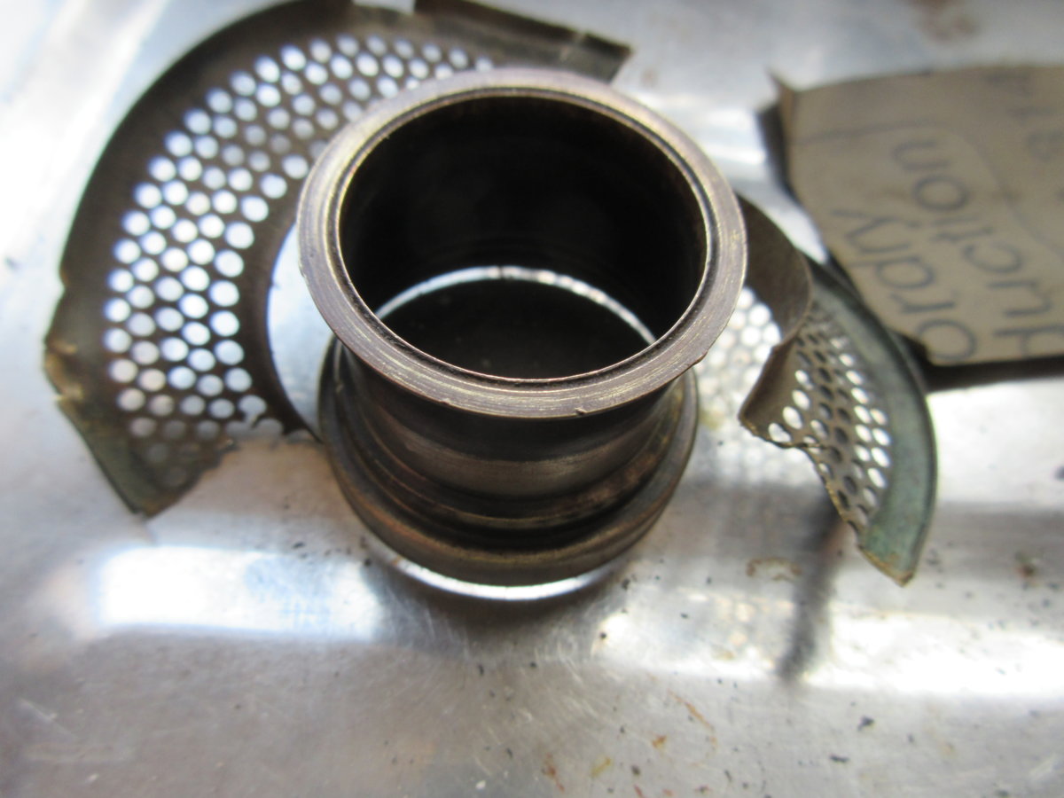

    I managed this, but unfortunately the skirt around the base of the Aladdin burner plate was different to the OP's. Nevertheless, I adapted it thus and it does mate over the surface of the paraffin bowl, or just about: 20260309_143834.jpg 20260309_143949.jpg
