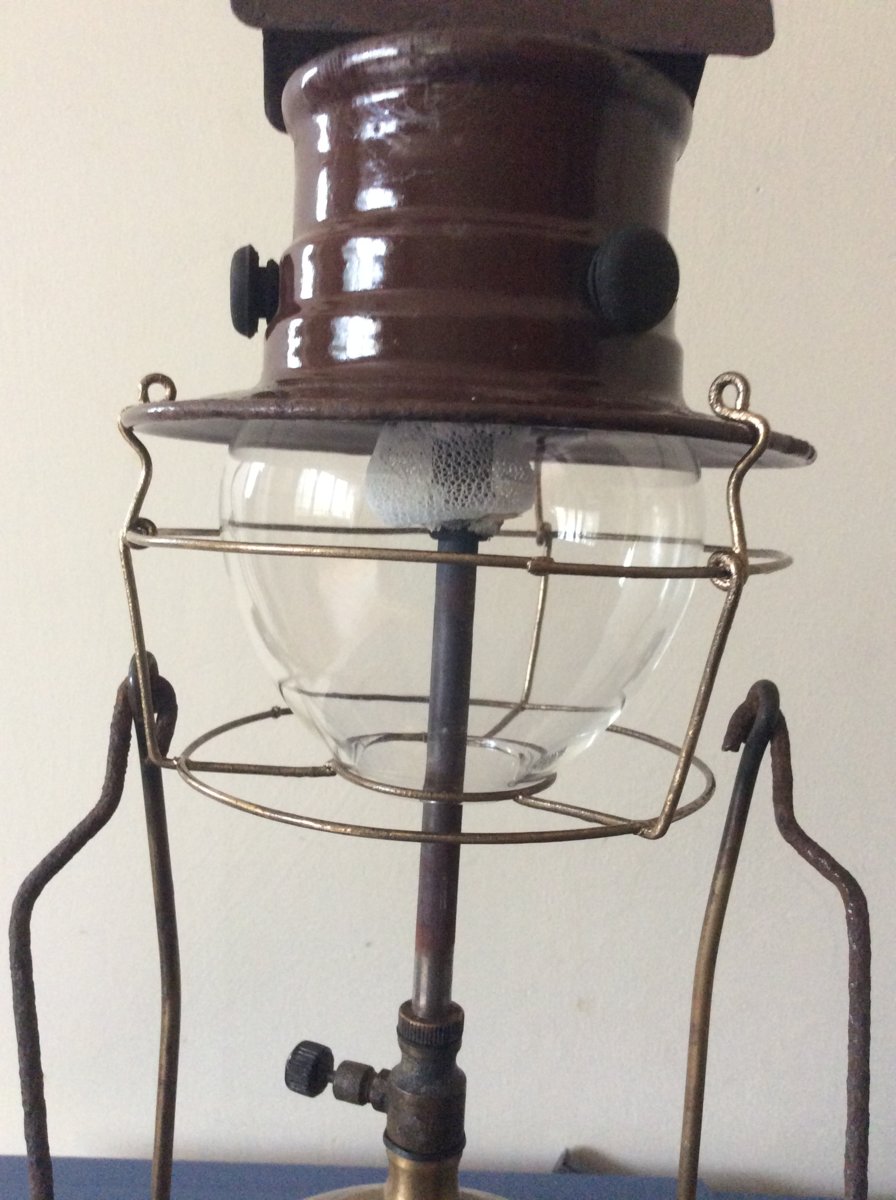

    I recently aquired and Tilley 'hybrid' A PL53 base with a 246 Hood & Burner with a home made glass cage.
    I have cleaned and flushed it through, but have a burning issue..... Lights beautifully as shown in the picture, but after 10 minutes running the burner starts to glow cherry red and the light output dims considerably whilst still holding good pressure :(
    I have swapped the burner and the hood with newer stock but the problem remains. The only way I can get it to run brightly for any length of time is to run the burner without the hood and glass.
    Any suggestions?

    Trial 1, Given 50 pumps on ignition and run for over half an hour. Hissing sound when releasing the pump to turn off. Light stays at reduced output until hissing almost stopped and fades to out.
    Trail 2, Given 50 pumps on ignition and run for over half an hour. Given a further 25 pumps, still burns at reduced output.
    Both trials repeated, output drops off over first 15 minutes.
    Trial 3, Burner and mantle carefully removed from hood, placed on vapouriser as before. Given 50 pumps on ignition and run for an hour, output stays bright and burner top doesn't glow.
    Trial 4, very carefully reinstall burner and mantle in hood repeat Trial 1 and burner glows again and light output fades.
    Same mantle used throughout. :-k

    After some more playing I have decided on one more variation - try a 169 vapouriser which the PL should be using.
    I have now aquired the correct hood and burner. Just need a cage and a 182 globe to return it to near original parts.
    Looking through the gallery I understand it is an early 1930's fount with riser, brass handle lower sections and iron bail with loose spiral handle. The control cock has a Bakelite knob so is a little later.

    A fellow Paraffinologist has gifted me a cage and after a very interesting trip to Base-Camp I now have a pre 1940 teardrop globe. Pictures to follow

    5A52CDB4-51C8-498B-B2A4-724181075C0D.jpeg 1B754AA0-1F93-4A7C-9134-1380C1E1D57B.jpeg All correct era parts, except the control cock.
